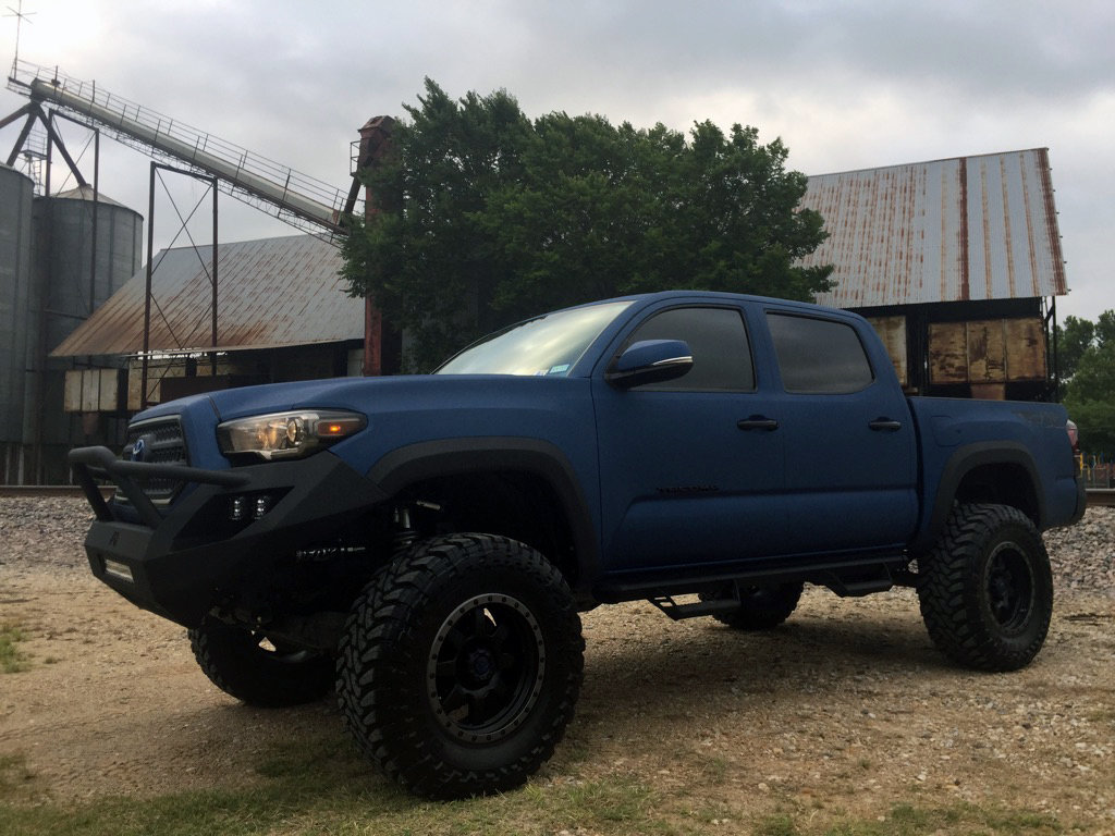

  1. Oct 20, 2017 at 8:10 AM
    Rob Daman
    Rob Daman The Taco Formerly Known as Hard Shell Taco
    Mar 3, 2017
    #212255
    5,840
    Rob
    So Cal
    17 OR 6MT
    a lot
    Awesome! I still have mine for high beams. That with my bi-xenon HIDs just light it up.

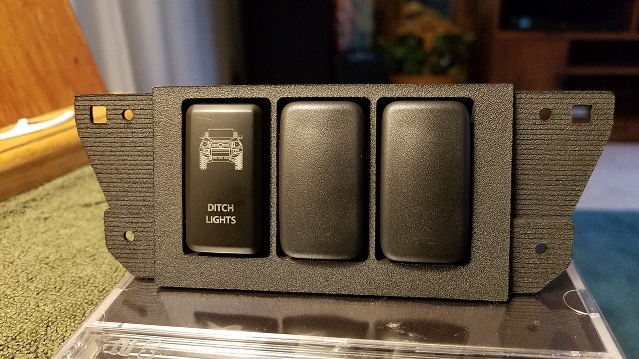

  2. Oct 20, 2017 at 8:43 AM
    ccallen
    ccallen Well-Known Member
    Apr 12, 2016
    #184076
    1,547
    Chase
    Missoula Mt.
    2016 tacoma TRD Off Road BBP
    SCS SR8's 17" TRD Adventure Edition
    Great looking rig! Really clean and subtle, I really like the tailgate!

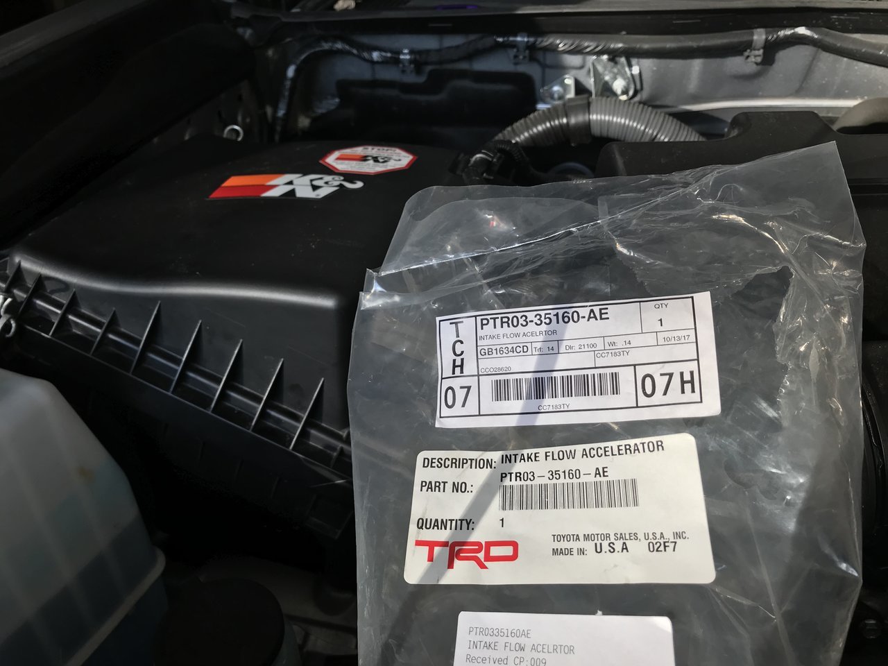

  3. Oct 20, 2017 at 9:01 AM
    jlusmc
    jlusmc Well-Known Member
    Feb 3, 2015
    #147827
    4,062
    James
    Huntsville, TX
    97 Reg Cab SAS
    Found this under the thread "K&N BlackHawk Series 71 Intake"
    "There's an intake rubber part that's called PTR03-35160-AE (Intake Flow Accelerator/Horn), it fits in that hole. It has a specific shape that will and should enhance air flow into the filter chamber. I think it's the money part for the TRD intake. You can purchase that separately and see what it does for you. It's # 8 in the diagram fits in that hole in the fender:"
    http://parts.conicellitoyotaofspringfield.com/oe-toyota/ptr0335160ae
    EPH, Hotmomma's Daddy and RobP62 like this.
  4. Oct 20, 2017 at 9:11 AM
    RobP62
    RobP62 NVR20LD
    Jun 4, 2017
    #220718
    41,519
    Rob
    Street, Md.
    TTC Member #0125
    Great post, love the diagram! One question, does the TRD intake just draw air through the bottom of the box from the engine bay without #8? Ok, two questions, does just the TRD CAI have that connection to fender opening or do all model CAIs have that? Meaning would this work on a stock Sport intake?
    Thanks,
    Rob

  10. Oct 20, 2017 at 10:55 AM
    jlusmc
    Feb 3, 2015
    #147827
    4,062
    James
    Huntsville, TX
    97 Reg Cab SAS
    My factory TRD OR's air box and the TRD Pro's (cannot comment on the sport model) both have the tube opening (that #8 attaches to) which is designed to pull air from the inner fender (dead space above the fender liner) but it doesn't completely seal the hole, so a good bit of air is still pulled from the engine bay. Part #8 places the opening completely inside the inner fender and seals the hole which in theory eliminates the intake of hot air from the engine bay, hence the "cold air" description.
    RobP62[QUOTED] likes this.
  11. Oct 20, 2017 at 11:08 AM

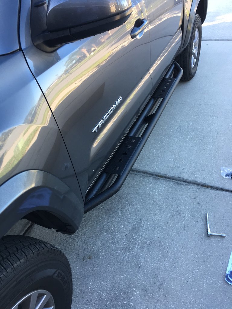

  15. Oct 20, 2017 at 11:39 AM
    Kevbulldog92
    Kevbulldog92 Member
    May 24, 2017
    #219803
    24
    Florida
    '17 MGM Tacoma SR5
    Did this last week. Tyger Steps.

  17. Oct 20, 2017 at 11:55 AM
    RobP62
    RobP62 NVR20LD
    Jun 4, 2017
    #220718
    41,519
    Rob
    Street, Md.
    TTC Member #0125
    Thanks, I'll have to look at mine the next time I get a chance and see if I have the tube below the box. Wouldn't mind doing this mod and adding a better filter.

  19. Oct 20, 2017 at 12:11 PM
    mrproduxn
    mrproduxn Well-Known Member
    Feb 22, 2013
    #98175
    6,382
    steve
    Retired DoD SE VA
    Tacomas 1987,2000,2008, 2016,2012,2008
    Retired/Hobbyist old as f***
    Sport has same fender port used with my K&N CAI
    RobP62 likes this.
  20. Oct 20, 2017 at 12:18 PM
    RobP62
    RobP62 NVR20LD
    Jun 4, 2017
    #220718
    41,519
    Rob
    Street, Md.
    TTC Member #0125
    Thanks Man! Just added this mod and part number to the master list then.
    Edit - Just called my local dealer, not in stock of course, and $36.83 + 6% tax (Maryland). LOL
