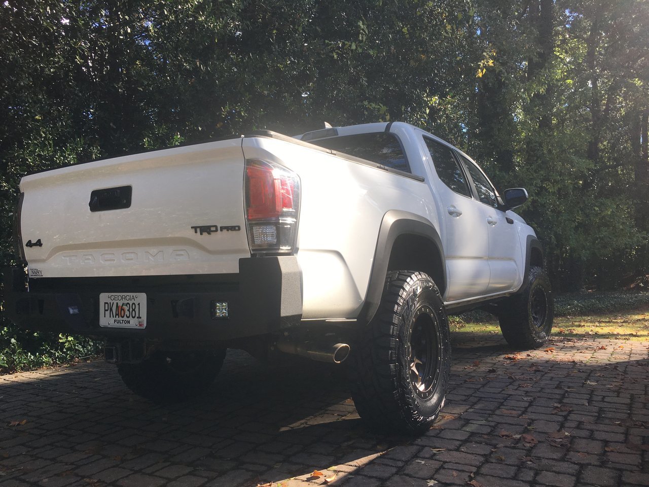

    So here it is. 295 70 17. For sure have to do the CMC and move some plastic if not trim. Need a place to put my spare.

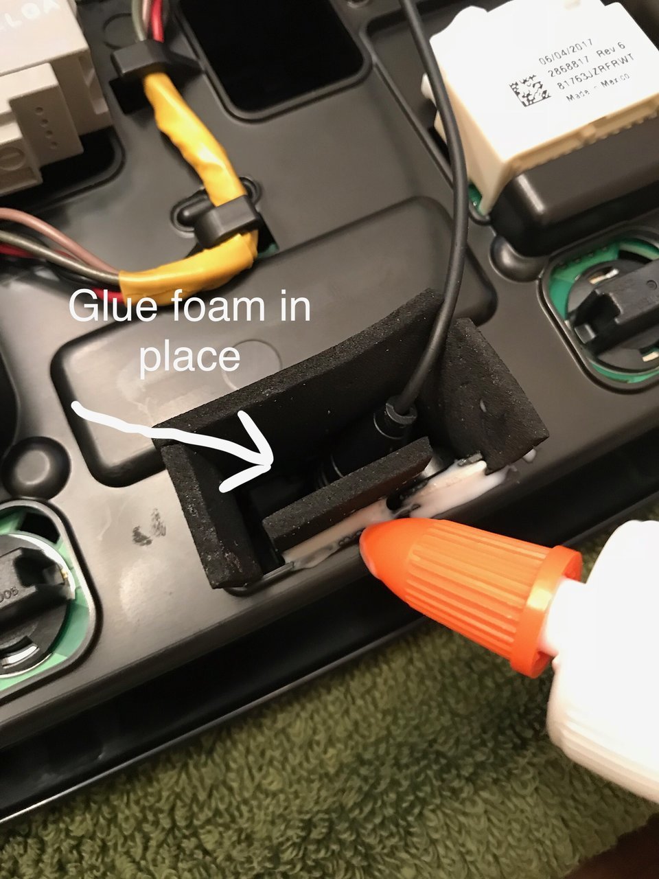

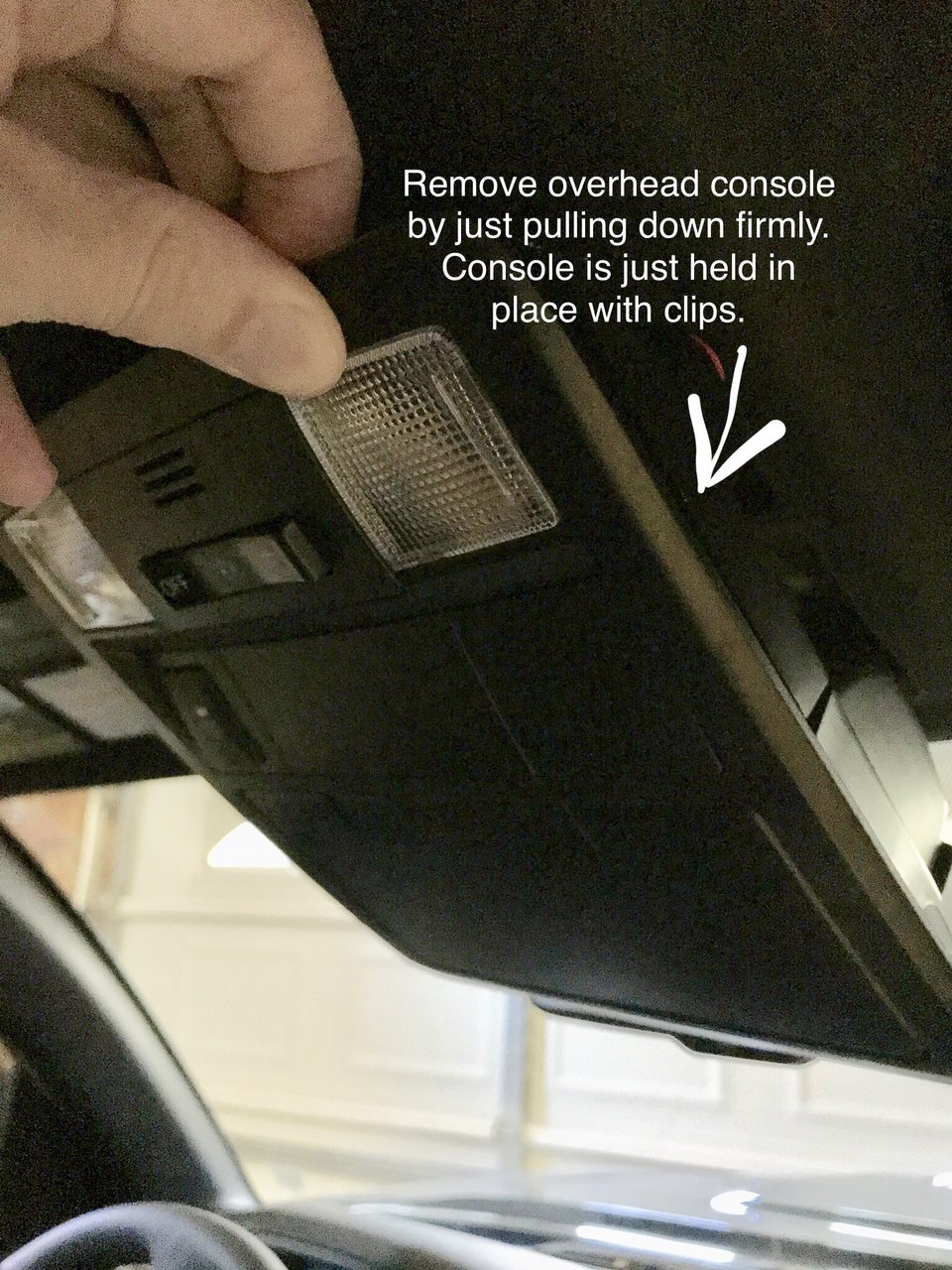

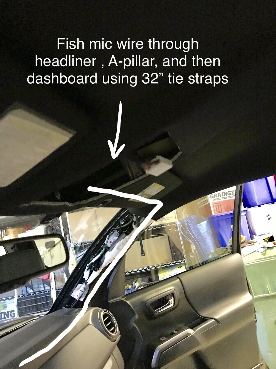

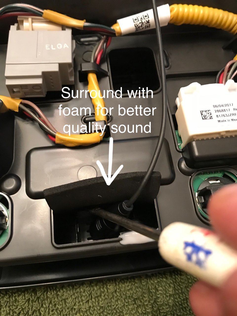

    Installed my Pioneer mic in the original factory mic location...
    ABDAAF9E-6062-47C3-8BFD-9B343CA5B189.jpg DDB9C032-DE03-4413-95C4-85C4190B713E.jpg CBF384E1-484F-494D-84B5-C97EE042A0F1.jpg904D631F-2645-4B53-9F24-33CB76C1BD7A.jpgFFB0311F-F09E-4EE1-A404-7B749316A0D5.jpg 52908FEE-D006-408B-80FB-3A1F46C14A12.jpg 38B08EE8-2EA9-4163-88EB-504B85BFB0D4.jpg 4DE1DD59-1CA5-4D5C-A015-CE3B68D0E44E.jpg 5BCB7406-A21F-4CFE-AC60-9487E76DC992.jpg
    Enjoy factory quality sound and looks from your new aftermarket mic. :)

    Where is the mic cable connected to? :confused:. Did you skip that step? Or is it just left dangling under the dash?
    *Edit: Also, what do you mean 'factory quality sound and looks' ? It's a mic. And I thought you concealed the mic surreptitiously in the overhead console so that it doesn't stick out in front of you. How do you enjoy it's looks?

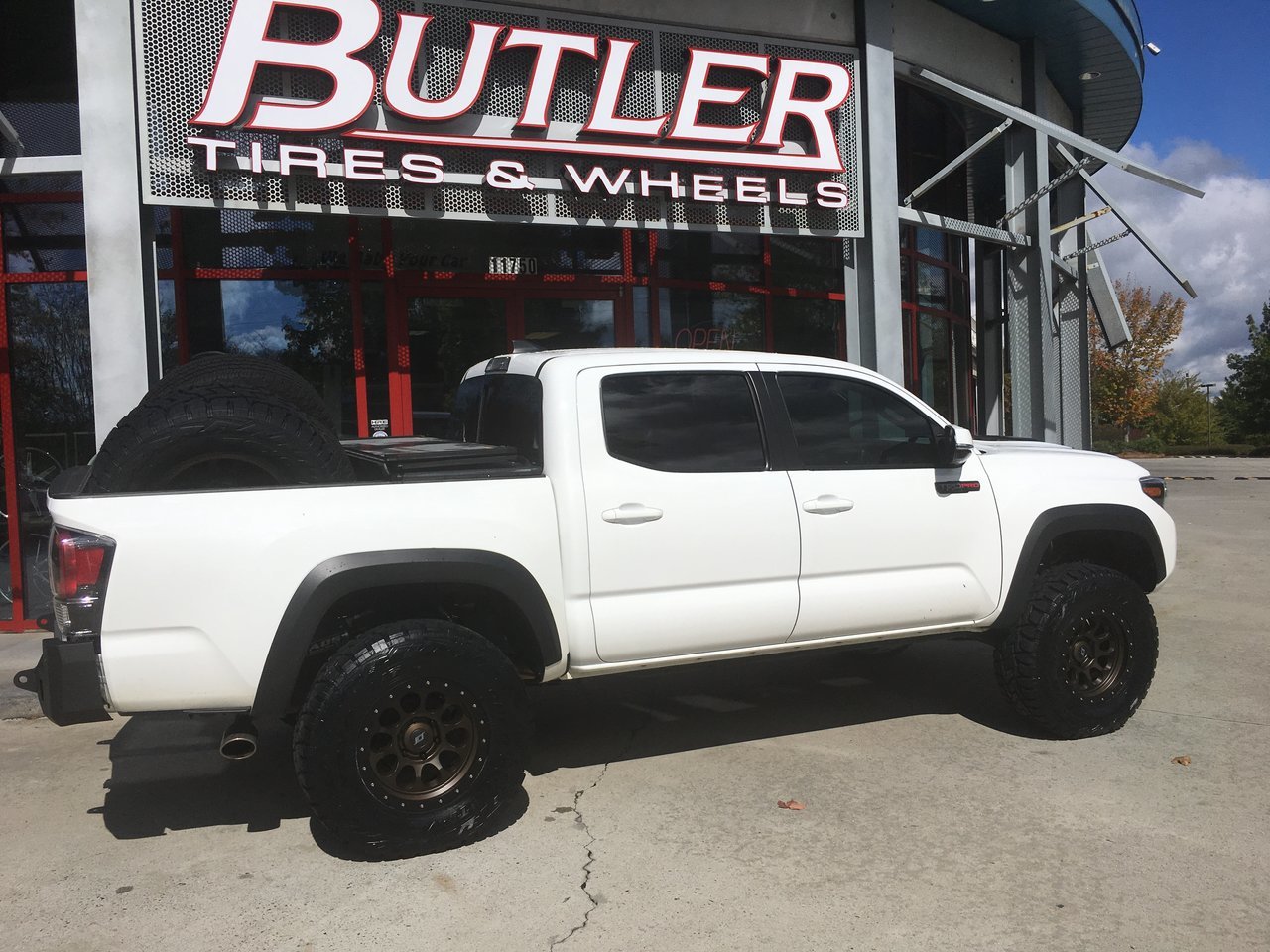

    I like how you mounted your spare. Looks familiar and now there’s two of us ;)

    Looks great. What size lift are you running? I have the same 295/70R17 and haven’t had to do anything to my truck. No cutting or trimming

    Thanks!! I’m running ADS. I got a little over 2.5 inches over the pro setup. It only rubbed in reverse at full lock. I just want to be sure for when I go off-road.

    Elmers school glue :rofl:
