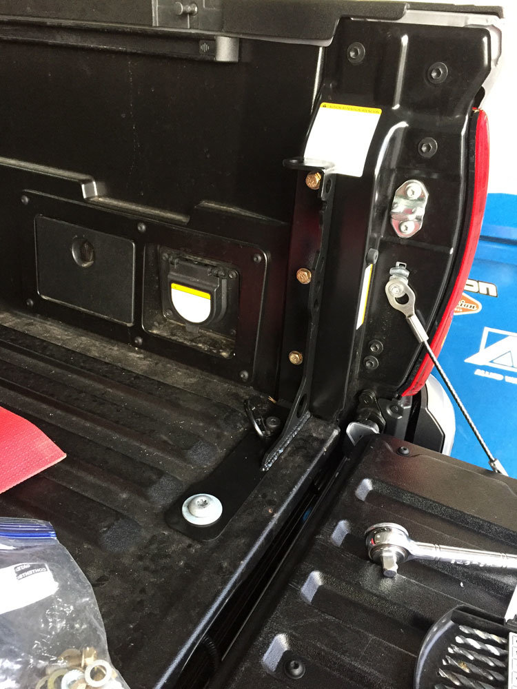

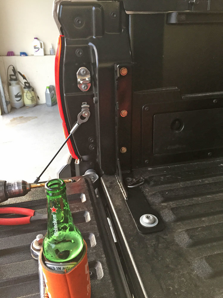

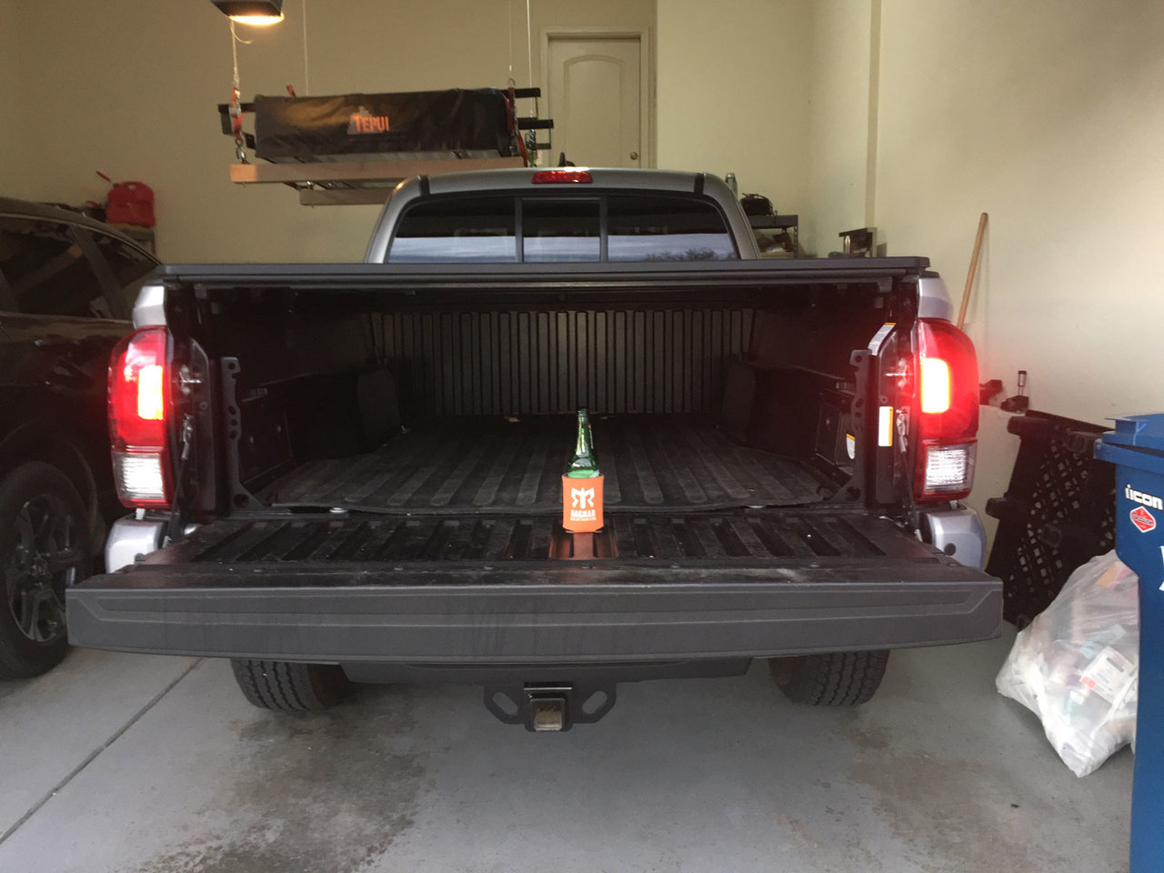

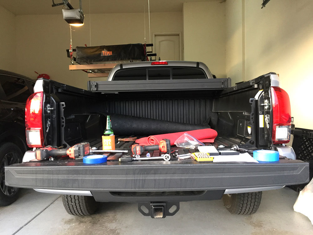

    Added bed stiffeners, love the built in bottle openers! Courtesy of @At The Helm ...

    How long did it take you to install? I’m getting mine tomorrow I believe :bananadance:

    Install was pretty quick, 30 minutes of actual labor. Of course you'll need to paint them which isn't included in that time. I recommend you fit them as bare metal, then remove and prime/paint them. I painted them first and then had to do paint touch up after, due to drilling the bed through the stiffeners, and cinching the bolts, then undoing the bolts to paint the exposed metal in the bed holes, then reinstalling.

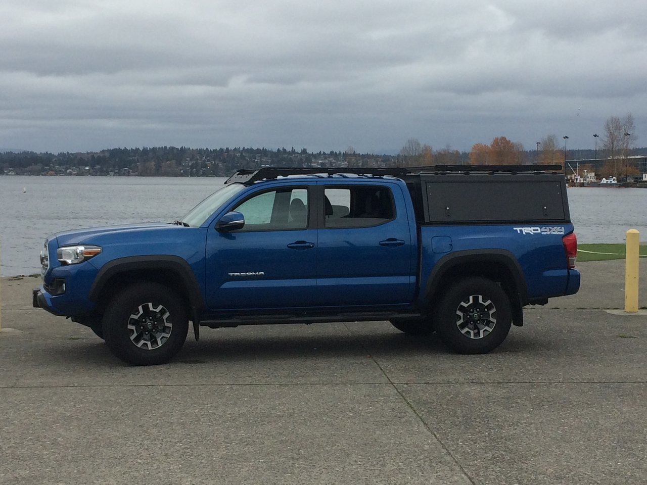

    Nice !! What canopy is that ? Alu-cab ??

    Yep - AluCab
    I started working on a set of bed drawers with integrated bed slides and a built in 16 gallon fresh water tank and pump. That should keep me occupied for a few weeks.

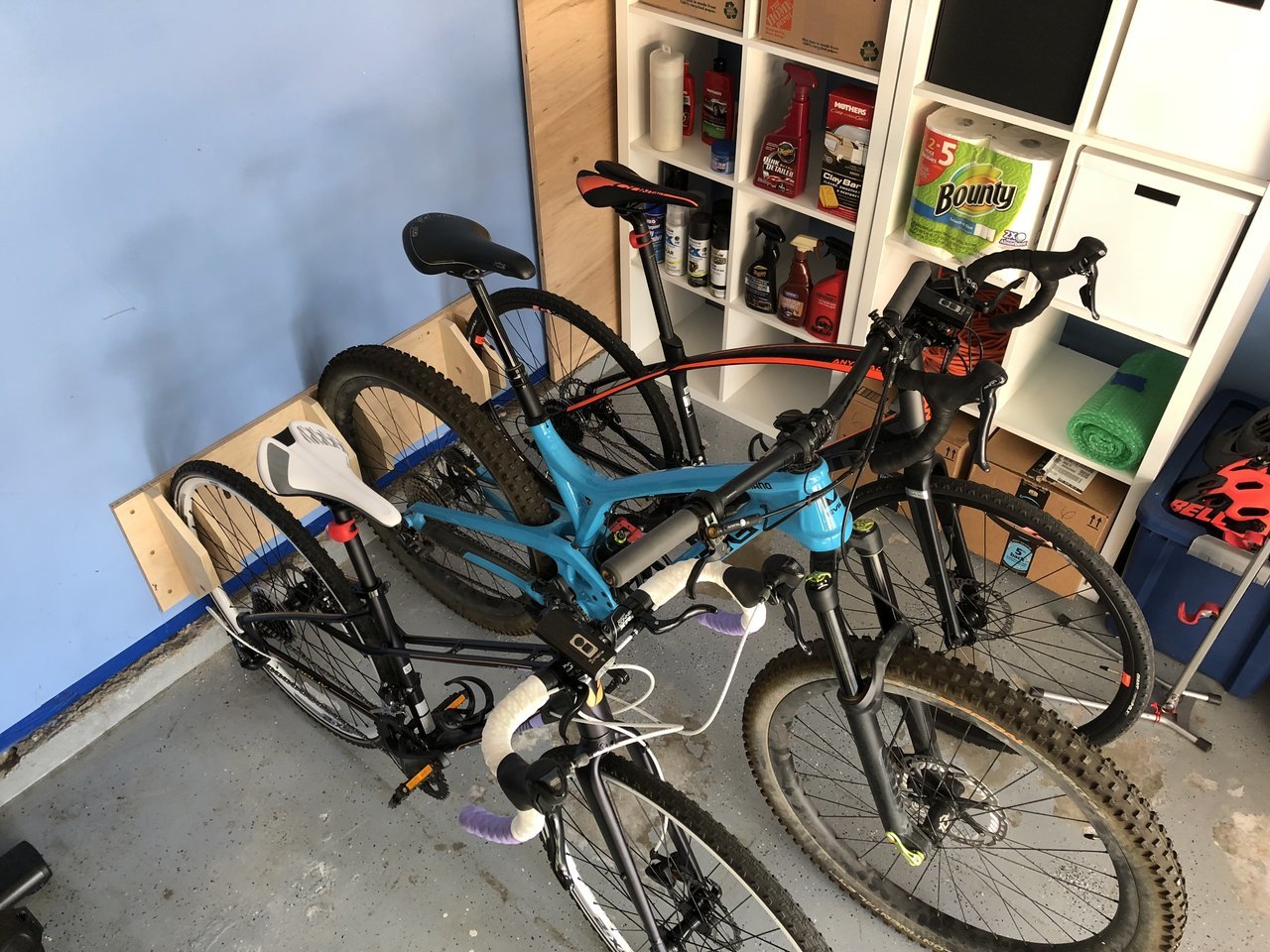

    Spent some more time not working on my truck.
    Started getting stuff out of boxes, made a bike rack.

    Is there gonna be room for the taco?

    I don’t park anything in the garage. I have a driveway, gate then room for 2 cars behind gate and ample street parking.
