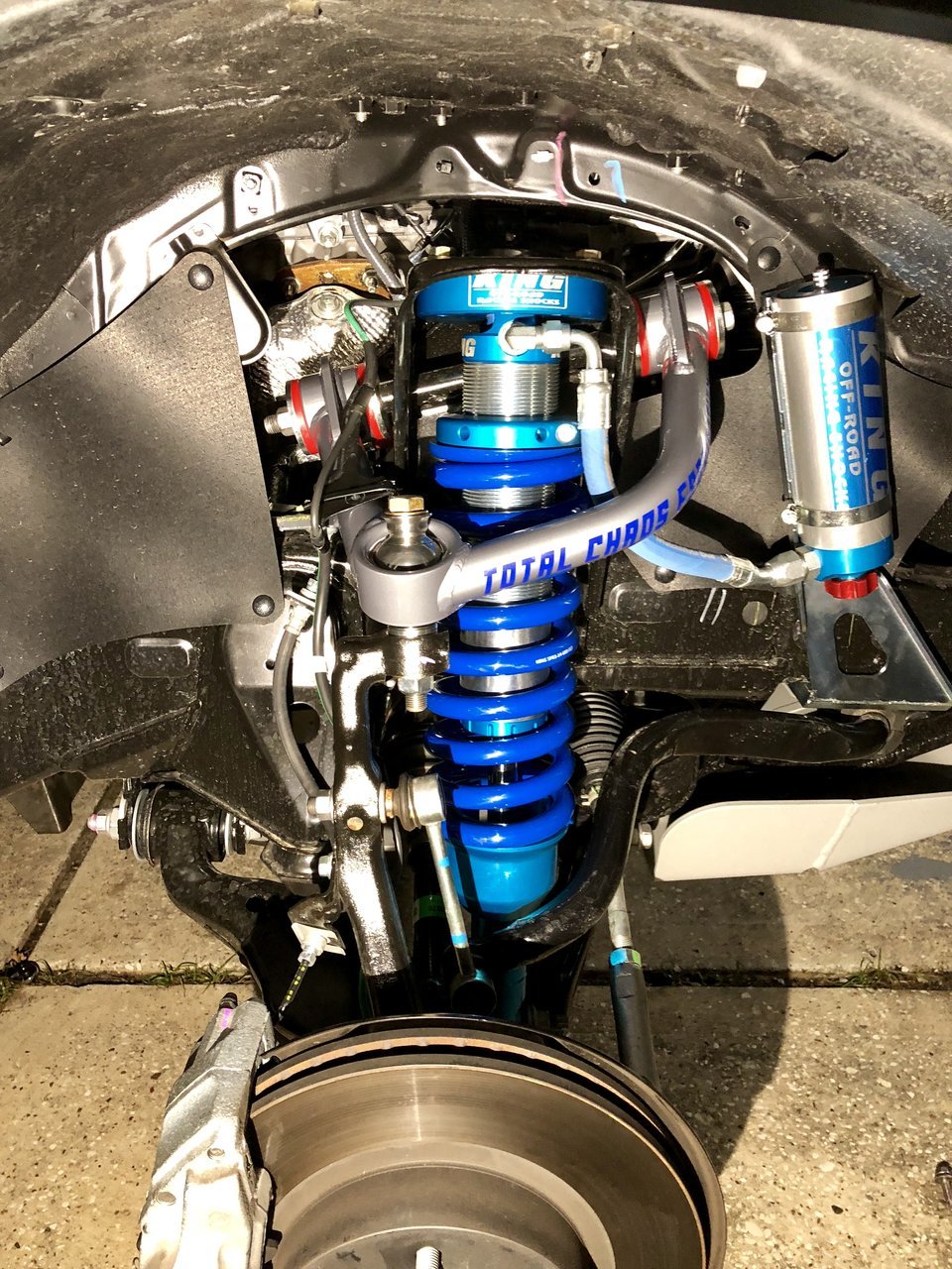

    Well, not my 3rd gen but I installed an Icon stage 6 front with delta joint billet upper control arms and stage 2 RXT in the back on a beautiful 2018 cement trd off-road with every option available. Truck is beautiful! A few small changes on the 18 on the inner fender well area.

    Finished the lift on my 2018 trd pro. Now i have abs and pre collision malfunction. Guess it could be true about tss lol im the first person to lift a 18 pro i assume so ill be the test bunny for you guys. Lets see what the dealer says tomorrow

    Told you they would be great. Not sure why ABS? Now just need some precut splash guards to cover the hole around the UCA. Looks great.

    Yeah i want those. Im ocd so anything to help keep it clean ill doit. Yeah im not sure why either. I didn’t disconnect anything. Didnt stress any lines to break anything either. I actually hope i did though so i can fix myself. If its not my fault and its just the tss then im sol lol

    Interesting. I lifted a 2018 trd off-road tonight and didn't get any tss or abs dummy lights.

    I really hope i damaged a wire because i can fix that. If its nothing i did then i hope toyota can reprogram or whatever they do to fix it

    It could very well be a damaged abs wire. I just spoke to the guy I did the install for and he said that he tested all the tss stuff on the way home and didn't have a single issue. His truck is high too, about a full 3 inches of lift up front. Fingers crossed yours is just the abs wire.

    I sure do hope so. The test drive was fine. It braked well and even my lane departure still worked. Everything lit up like a Christmas tree. Also it didnt let me go into 4wd.. it said 2wd -4wd malfunction

    Okay, that's making me think even more so that it's an ABS line. Same thing happened on my other buddies 4runner and it was the abs line
