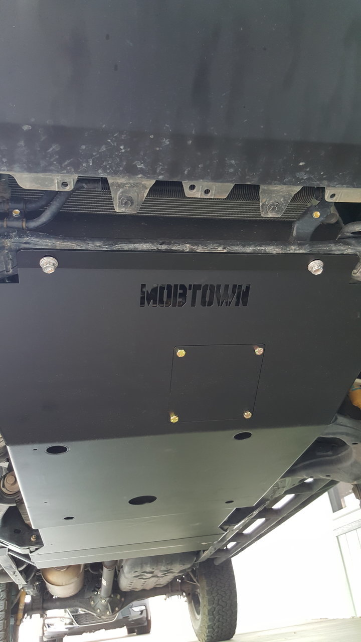

    Mission accomplished. Got my Mobtown skids installed today. Those skids are real beef it helps to have someone operate the floor jack and hand over tools. I ran into one snag though, the transfer case skid crossmember is supposed to bolt behind the brake line bracket on the drivers side. I had a difficult time getting it to line up and get the bolt started. It seemed like the bolt was too short to go through the crossmember, brakeline bracket and grab any threads. I ended up using a longer leftover bolt from the frame brackets that were removed and put a nut inside the frame. I'm going to buy a grade 8 nut and bolt to replace it with. 20180120_152855_030.jpg
