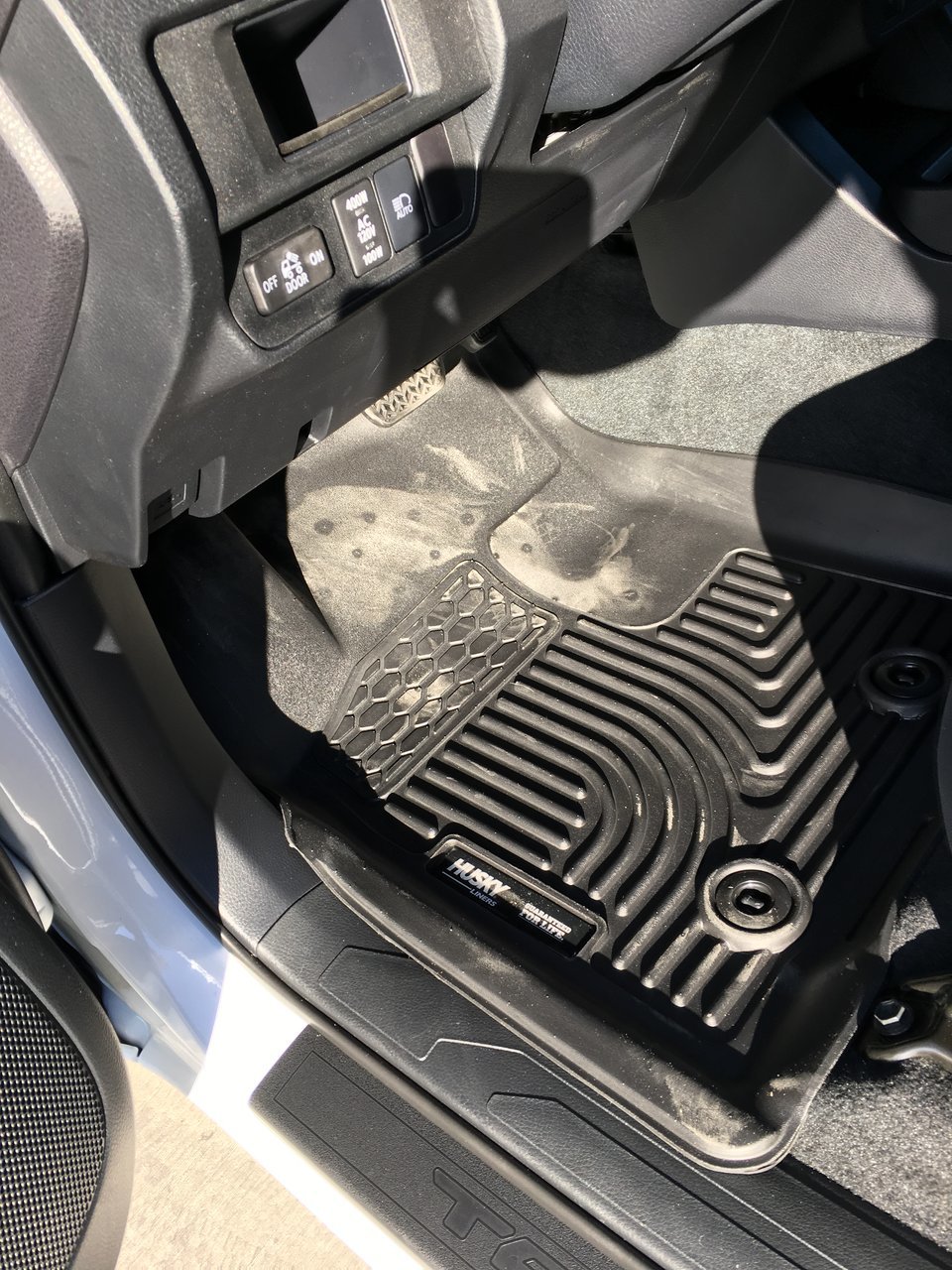

    Tailgate vinyl stickers, Husky Mats and AJT Key fob...first "mods"...more to come soon.

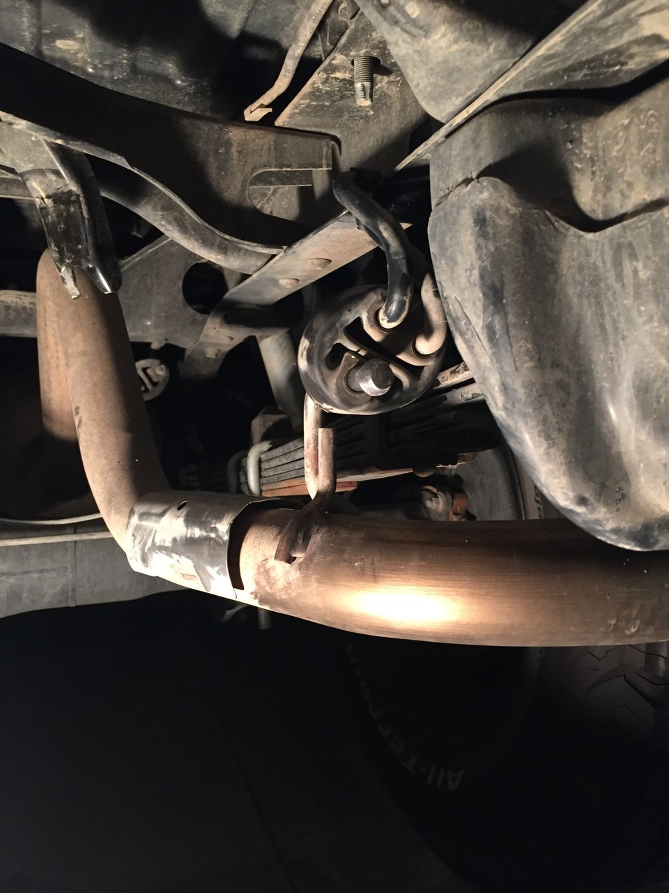

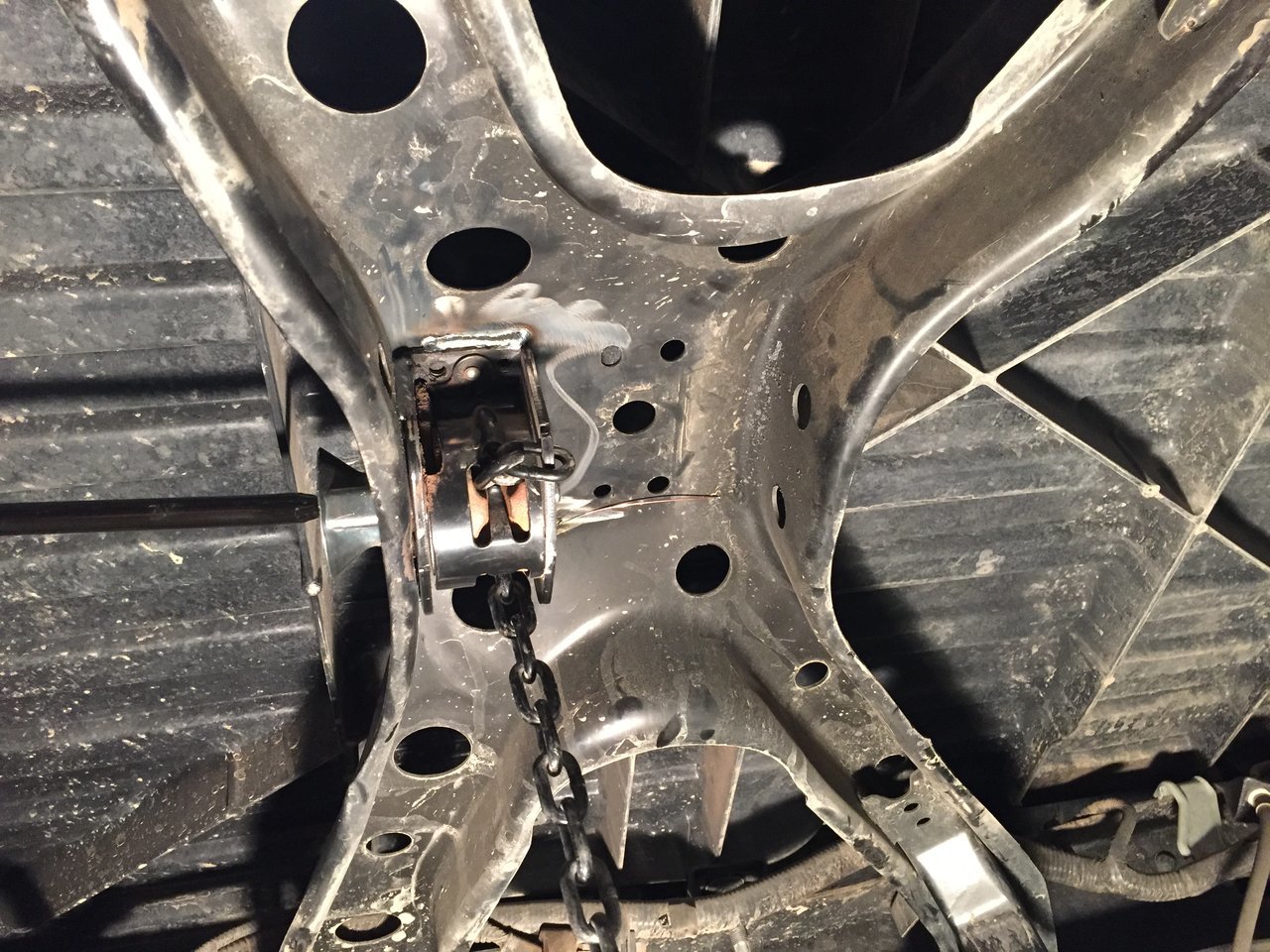

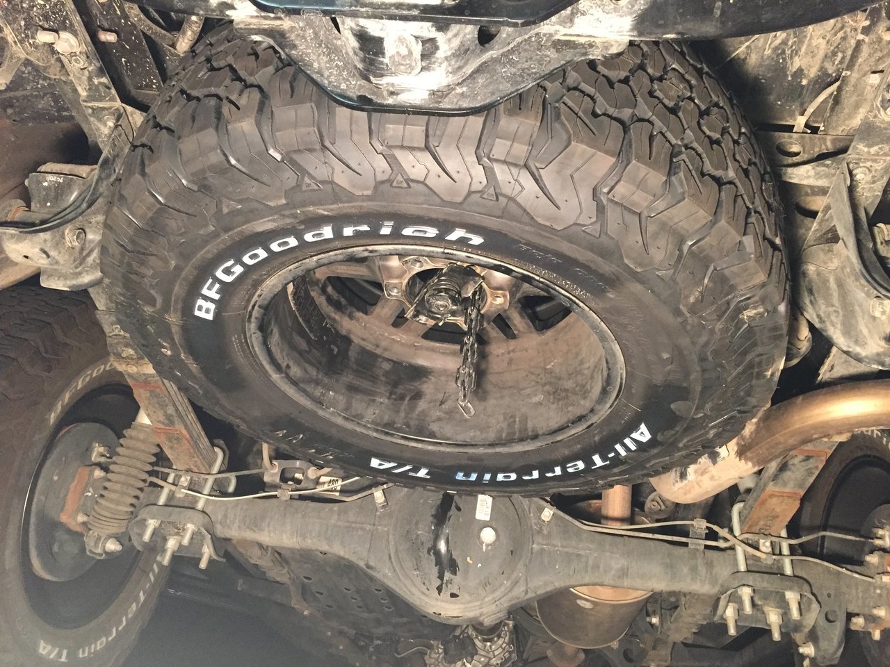

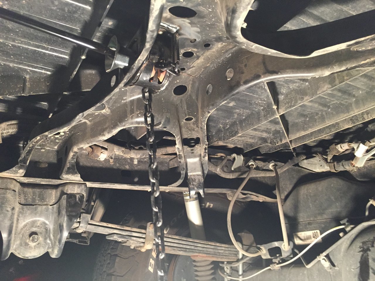

    I finally got around to properly fitting my 285/70/17 under the truck properly! I’m not sure how anyone claims to fit them with no problems. I think I did it “the right way”, if there is a right way.
    First, I removed the spare tire elevator, fished out the bolts (not easy), and had it welded a couple inches toward the rear of the truck. No need to smash down the two tabs, and PLENTY of clearance away from the differential.
    Next, we cut the exhaust hanger and re-welded it so the exhaust pipe is shifted a couple inches to the right. Nothing else. I thought maybe the tailpipe would stick out too far, but I barely notice it any different than stock. (My other option was to chop the exhaust over the axle, but this works.
    Here’s the finished product! The tire sits ½ inch behind my hitch receiver (ball mount fits, but longer ones might pose an issue on other trucks)
