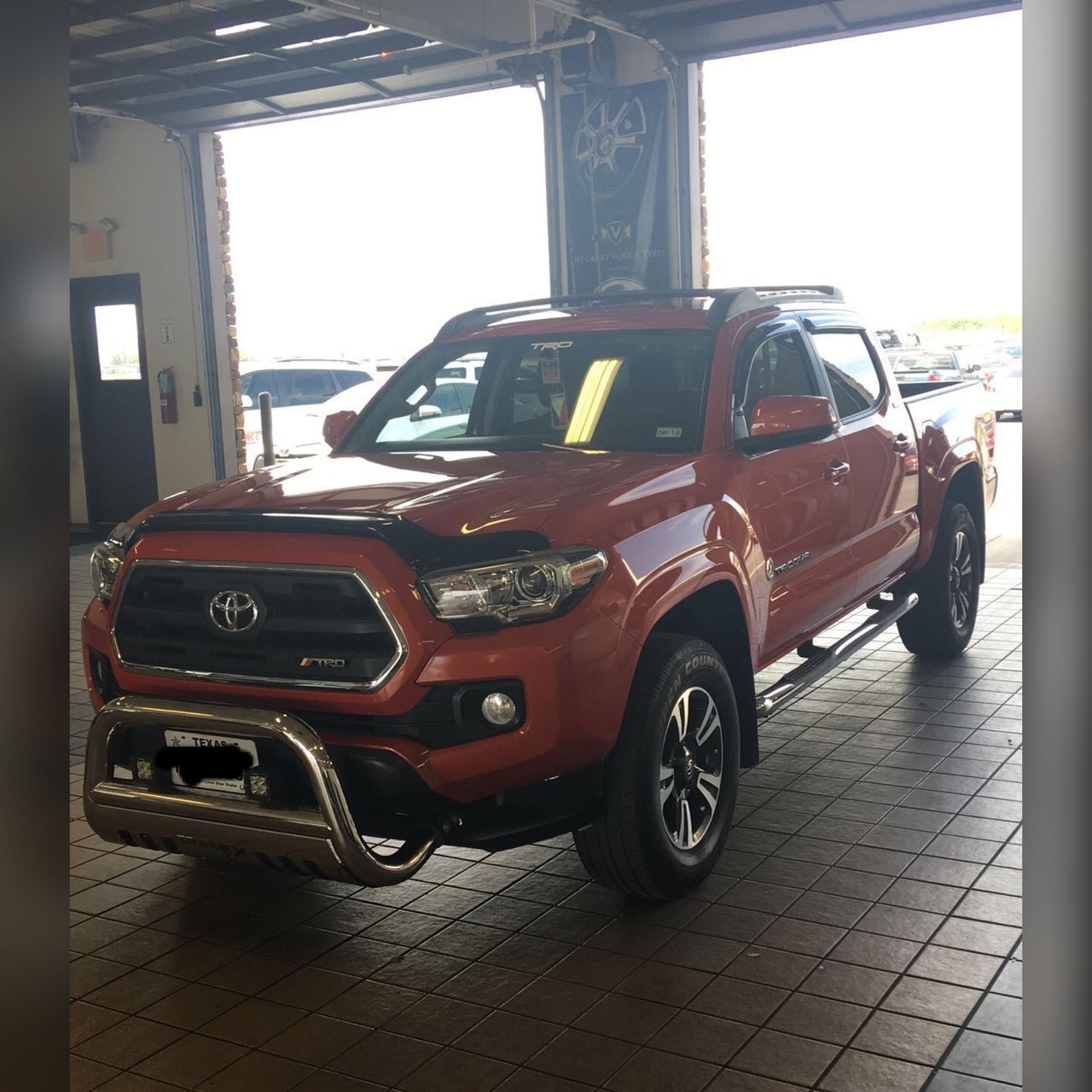

    Told my parents how I really wanted a roofrack and I loved how visually pleasing they look on Tacomas in IMO, so they made it happen!01AED751-8C46-4BE5-97A4-D663BB926268.jpg5CB3960C-DD82-47C7-B739-355350F2E8B4.jpg

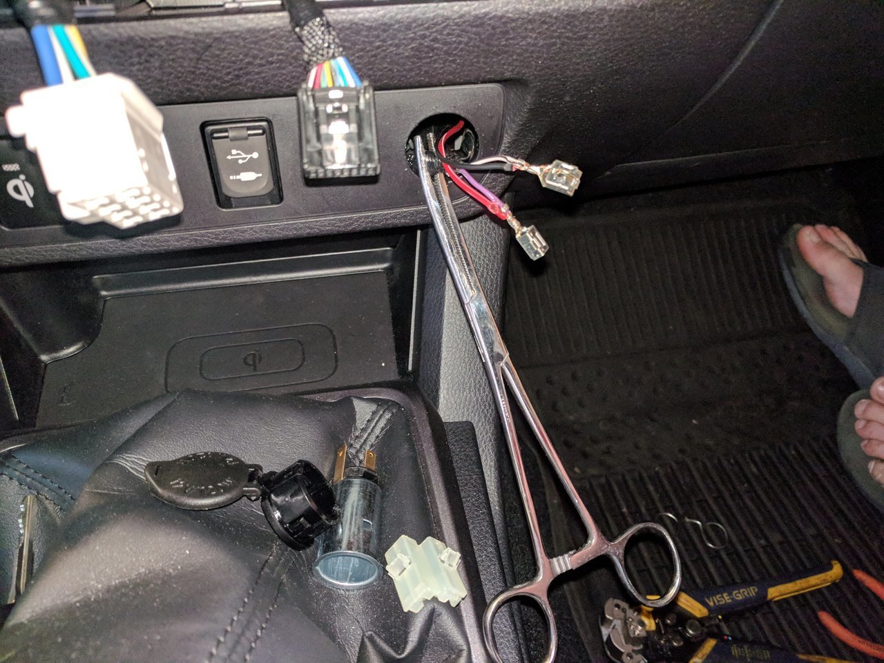

    Just a comment. You can push the power port socket out, but it is easier if you push gently on the two black tabs seen inside the metal part (top and bottom). This allows the center to slide out toward the rear of the truck. Then, the plastic surround can be pulled out toward the rear of the truck.
    Love that video.
    Here's a pic of it apart:
    I was scarfing on power wires for my front camera.

    So, first, forgive me for being slow/dumb, but how are you attaching a USB cable to the electric tabs on the cigarette socket? I would need another piece right? Or do I disassemble my cigarette socket adapter and hard wire something in there? Is there a negative/positive requirement? Thanks so much for all the help.

    You can see the polarity in my pic:
    https://www.tacomaworld.com/threads...-3rd-gen-today.399305/page-4106#post-17438970
    Red / Purple is positive and Black / White stripe is negative.

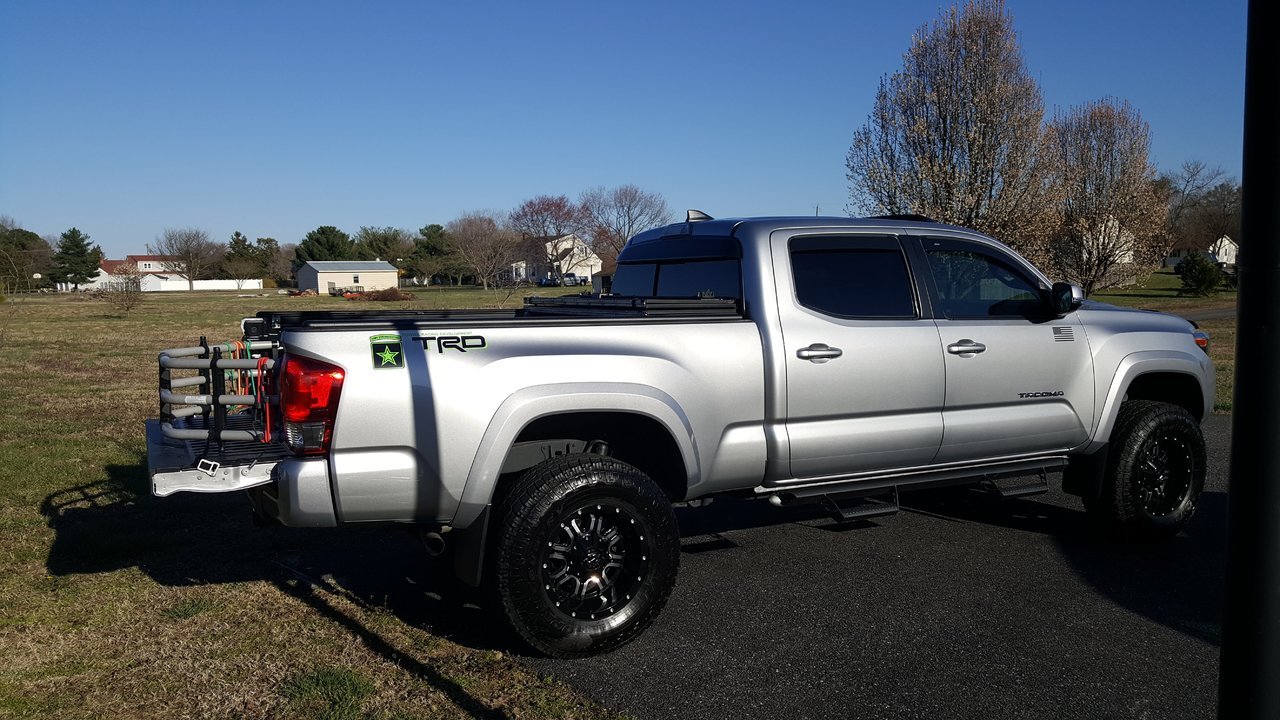

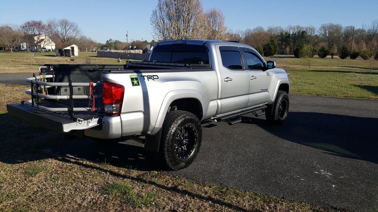

    Yes, they're Clazzios. They go great with my truck, it's trimmed in emerald green (in and out). not sure if you want inside or outside pics, so I included both.
