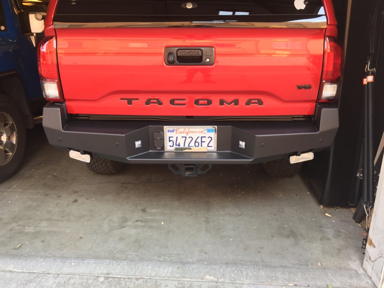

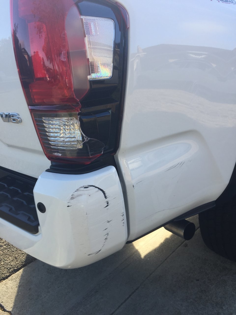

    Silver lining... Pelfreybuilt rear bumper... :D

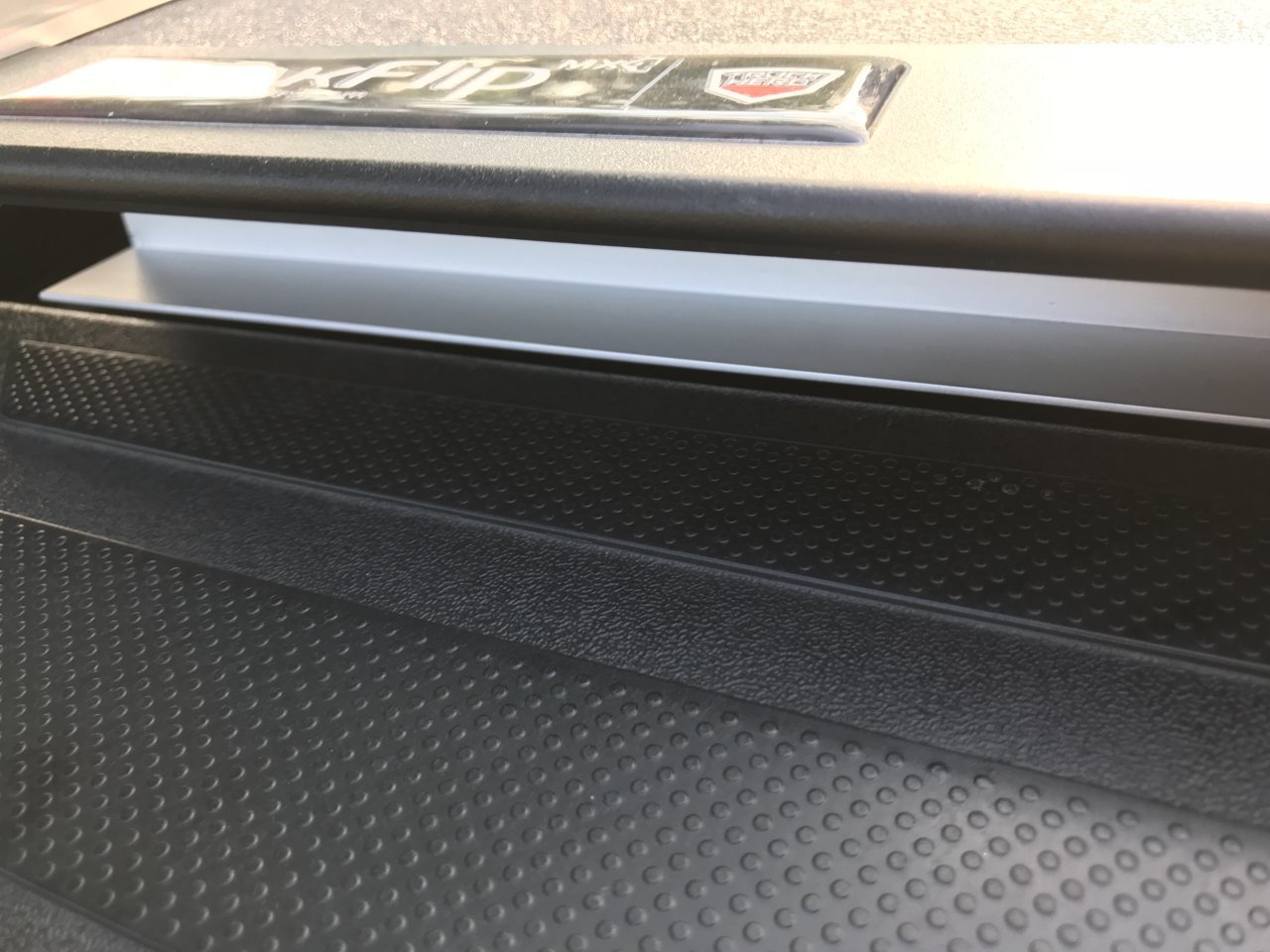

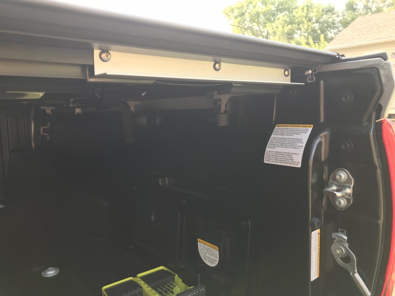

    What size of angle did you use? And how did you mount it?

    I used 1/16" x 1"
    Anodized Aluminum angled stock.
    SKU 608034
    Cost 8.99
    6 SS Screws and washers about 3 bucks.
    Came in a 3 foot section. Cut two pieces at 12 7/16. Lined everything up, measured some. Measured again. Penciled drill marks. Center punched them. Drilled pilot holes, then aligned the bracket up with the existing latch bracket assembly, made marks, center punched and drilled some holes.
    For both I gradually drilled using the next size up. I used Stainless Steel sheet metal screws with rubber washers to mount them. The bracket when installed, meets up with the tailgate with a very small gap in between. It was perfect, as you can see in the picture. Once closed more the gap closes. I just had it out a little more so you can see better. Overall a great and easy mod that increases the security of the BakFlip tremendously.

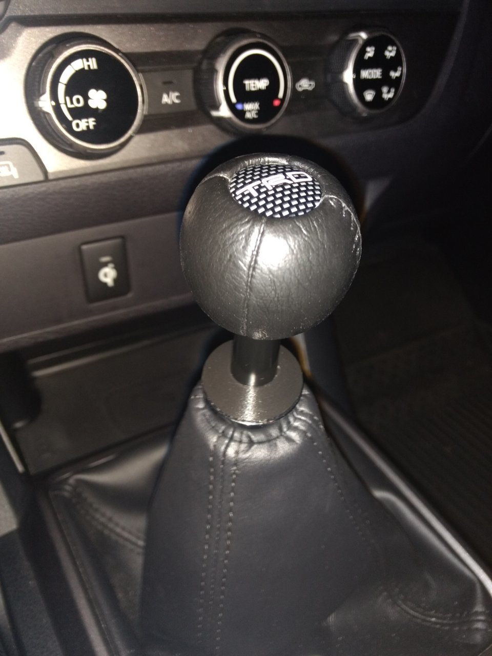

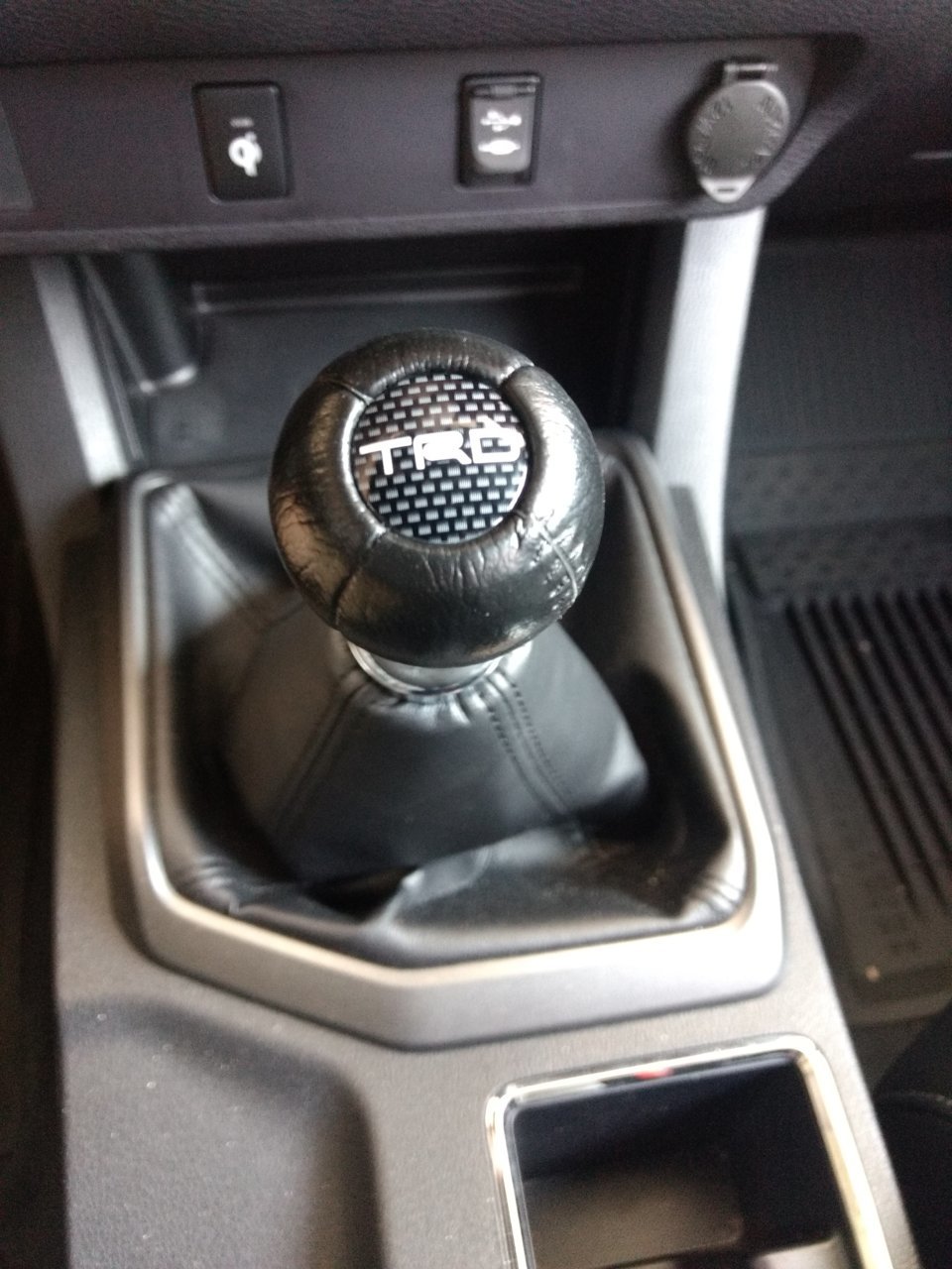

    Update:
    I 3-D printed a collar to hold the shifter boot instead of the grommet. I got the file from @duckytw . Looks much cleaner.

    Thanks! I work at a place where I can get all of that pretty easily. I will have to check to see how quick I can get the parts.

    No problem. I took my time and it took me about an hour and a half from start to finish. Using all hand tools. Let me know how it goes!

    https://www.youtube.com/watch?v=8B8kBhUynf4
    Check this video out. Shows how easy it is to get into a BAKFLIP cover without some sort of blocking mechanism. For an extra 14 bucks and some time it makes the BakFlip worth it!

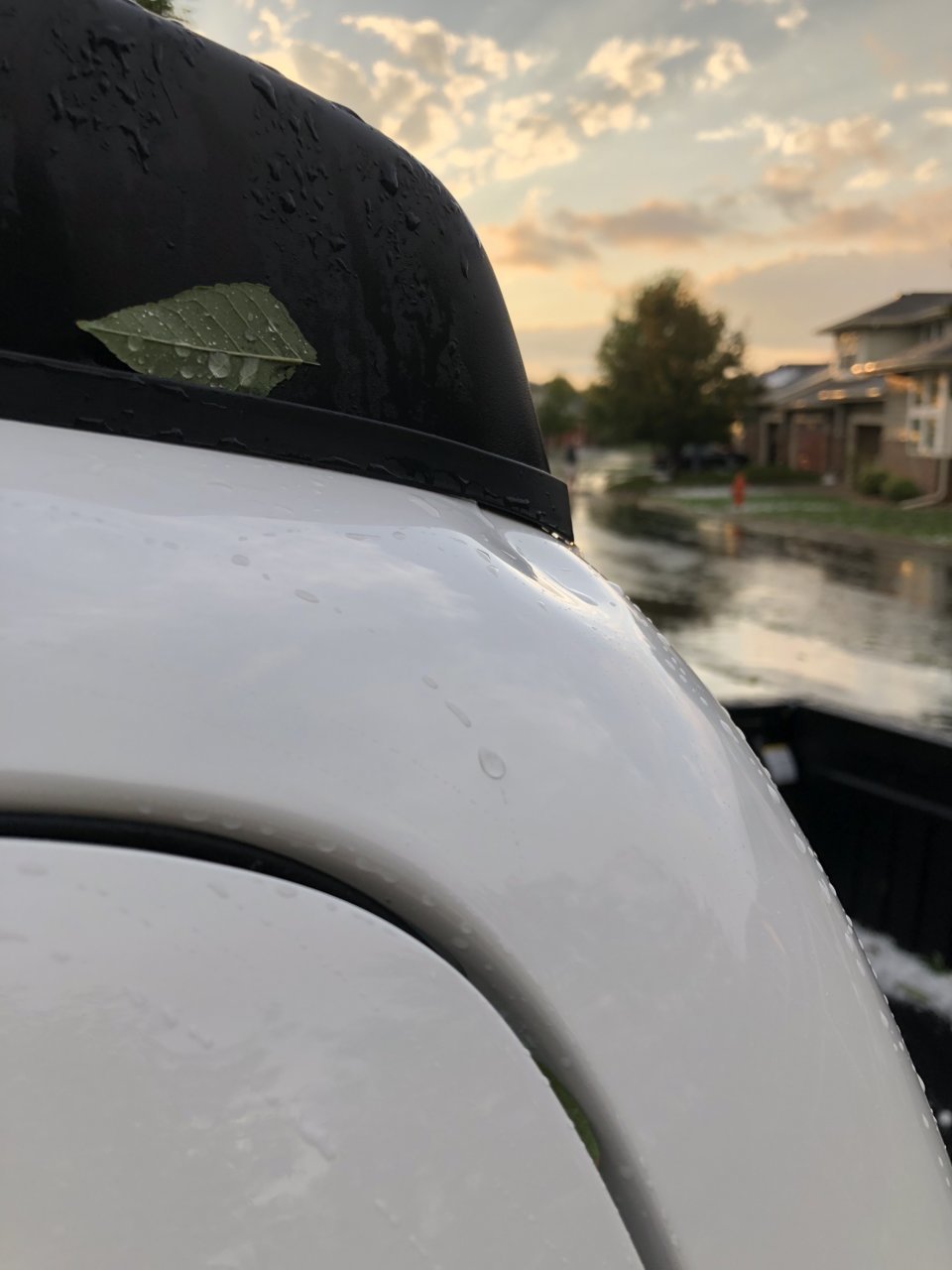

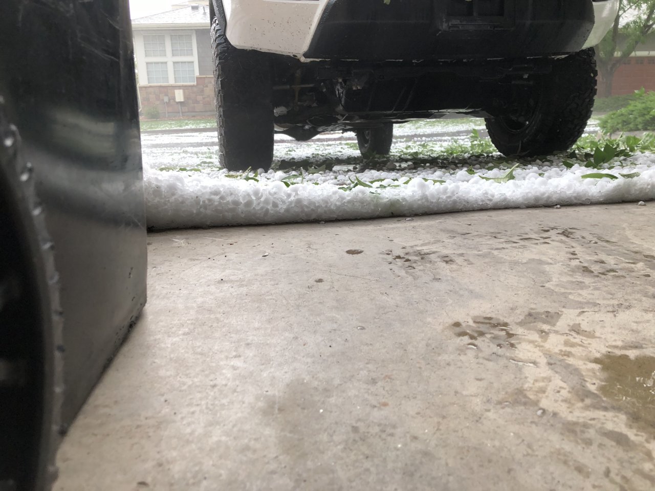

    Had custom dimpling added... for free

    That sucks! Damn!
