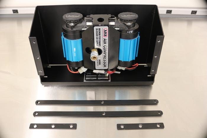

    I have been thinking about doing this exact same thing when I add my Expedition Essentials Bedside Compressor. I’ve been thinking about installing my 12V Pump inside the cubby instead of on that metal tray on the small cubby. It’s a perfect spot, but I question the fact that it’s out in the open. Installing it inside the cubby will get it out of the open, but then I need to add more door locks and I’m not sure if I want to do that again.
    Looks amazing!!

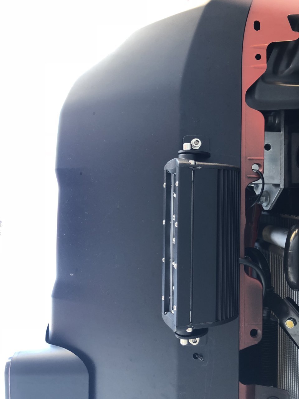

    I'd have to say for the money, those Northpole 7" lights look awesome no matter where you place them. I test fit a few locations until I decided on their current location and I may have to make some angle adjustments. I think I'd like them to point 45 degrees off center and spread my light pattern out a bit. The rear set are actually mounted into existing holes and I had to slightly enlarge the holes in the arms.
    The 31" bar is mounted with supplied hardware and it's quite rigid in that location without any additional support. I pulled the front grille off by undoing two screws and two of those pop out whatchamathingers after watching a Youtube. I was shocked how easy that was. I used existing factory holes or "mount points" where possible.

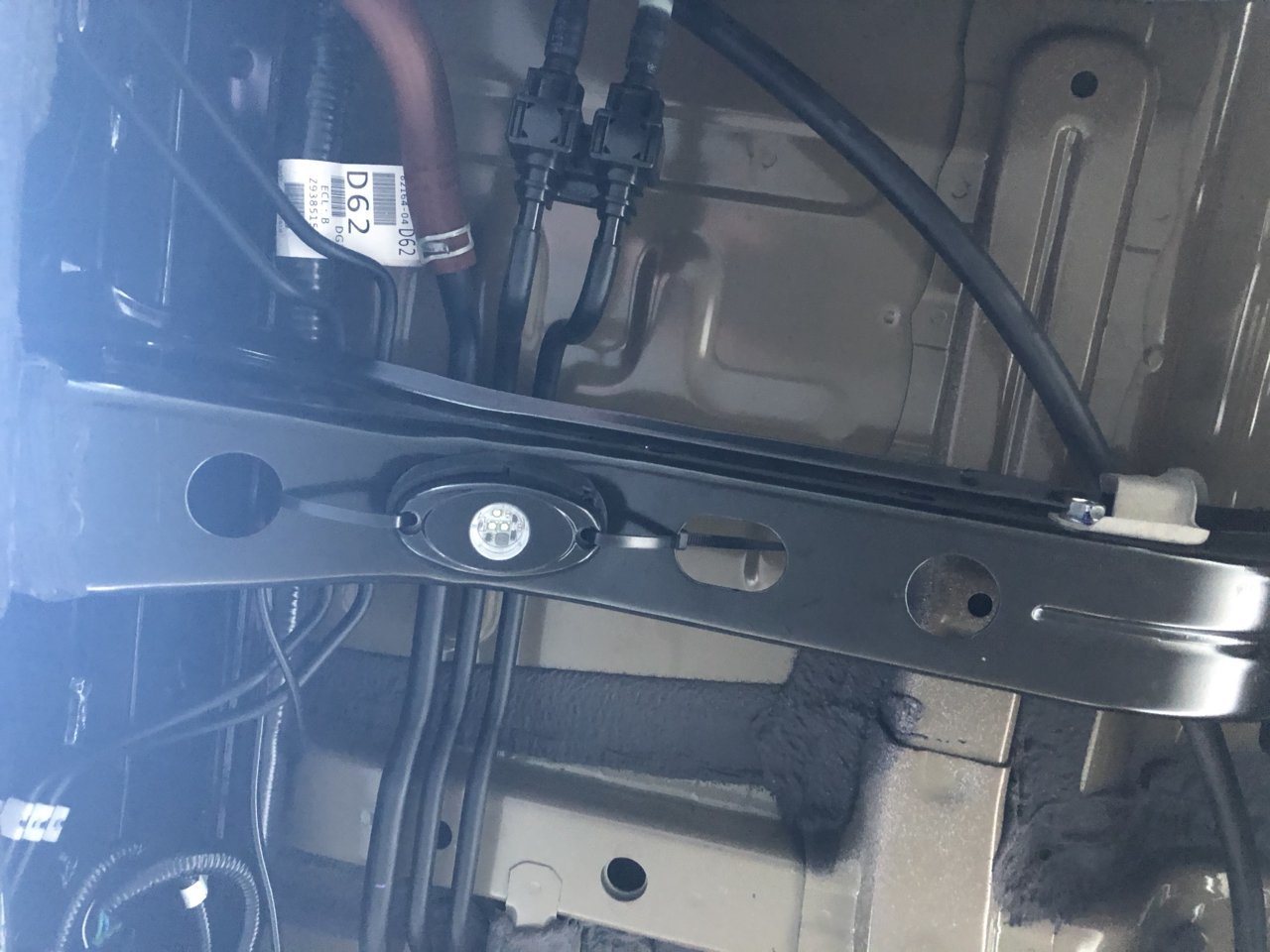

    The rock lights are spread out underneath at random ("uneducatedly" placed) spots. These will be rearranged after seeing their output at night. I only zip tied them into place as I wasn't sure about their locations. They are mainly near or on the frame in spots where I think I am drowning the light before it spreads.
    Here are some close ups of the install spots.

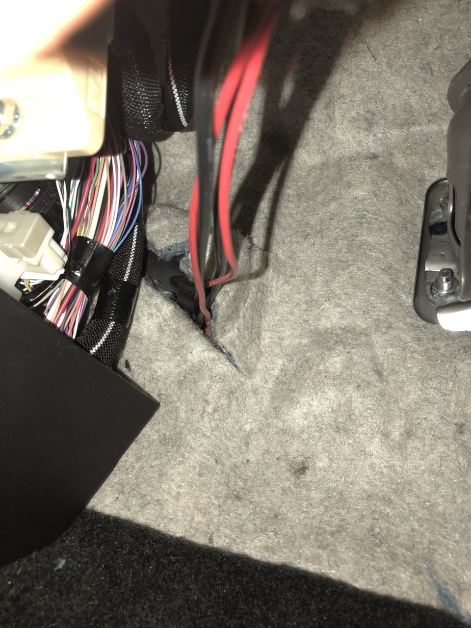

    One member had asked me to show where I went through the firewall and I tried to show that from the cab side. Full disclosure, that's where I took a short cut. I did not push through the grommet, I opted to go next to it. (I know...I know)

    Forgot your name when I read the reply, but hopefully this helps. This is driver side, interior view. You pull back a triangle of carpet and that will expose the firewall "rubber grommet" area I pushed through. As mentioned on another reply, I was lazy and went to the side of the rubber rather than punch through it. Time will tell if that was a mistake.

    Hey thanks Jeff! I just saw it and was going to post up.
    How many wires did you squeeze in there? Looks like a lot. I have 4. I think the switch wires are only 20 awg though.
    I need to get off my ass and get this done.
    Thanks for posting up.

    There are two LED harness wire kits (3 wires each, also wrapped in sheath) and a couple of .18ga wires going through that area. Sounds like you have plenty of room for your application. It does take some serious finger strength to help open the space and I also used fiberglass fish tape. Happy to help. I love car/truck communities!

    Yea, my only fear would be water penetration. Or vibrations on the wire insulation. Do you feel that will be a problem?
