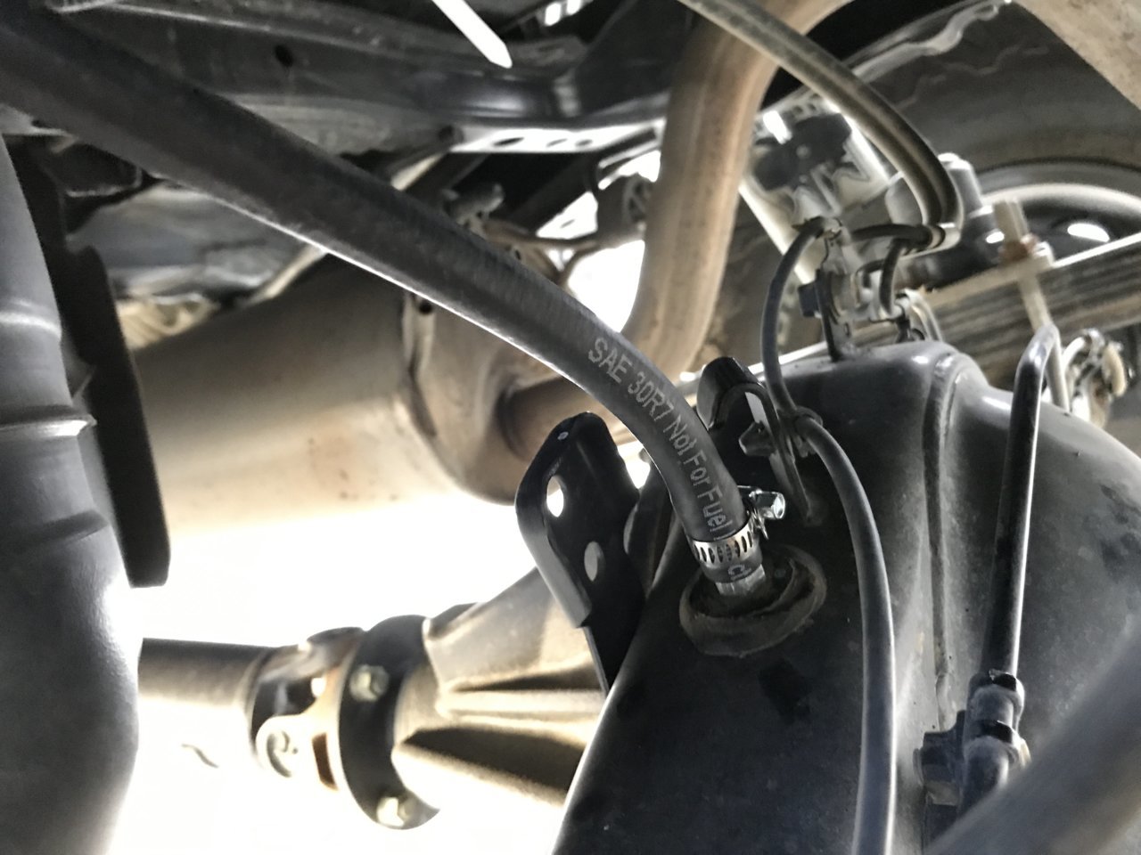

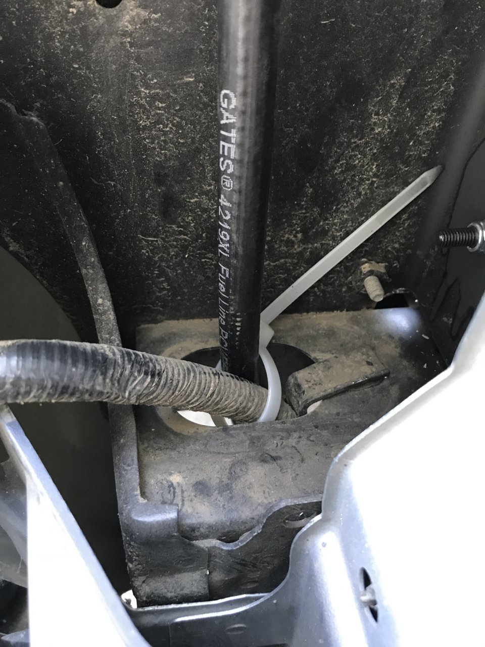

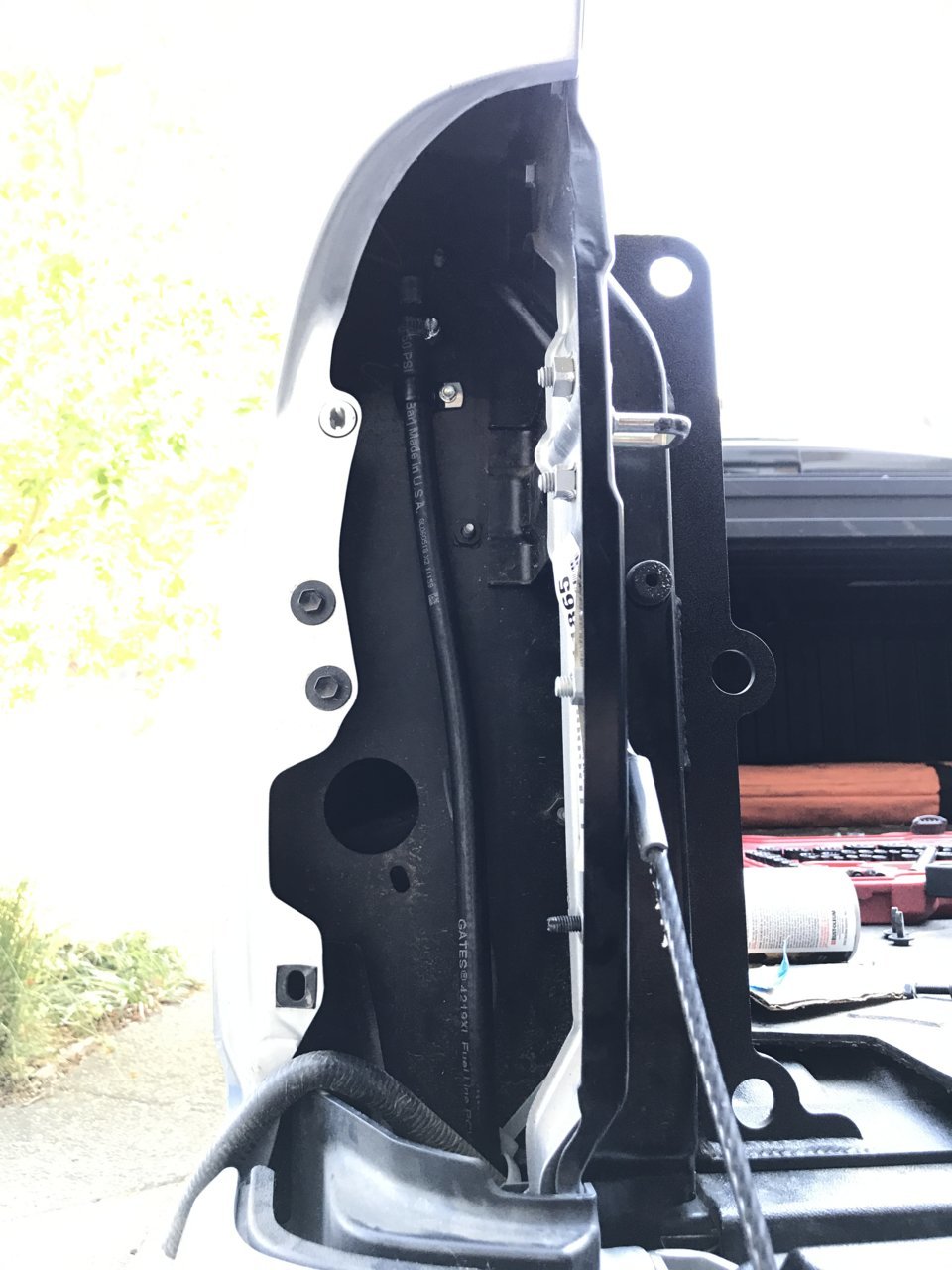

    Very simple. Just came out of diff, left plenty of slack for axle droop, zip tied to wiring harness and followed into the bottom of the tail light area. IMG_3404.jpg IMG_3401.jpg IMG_3402.jpg

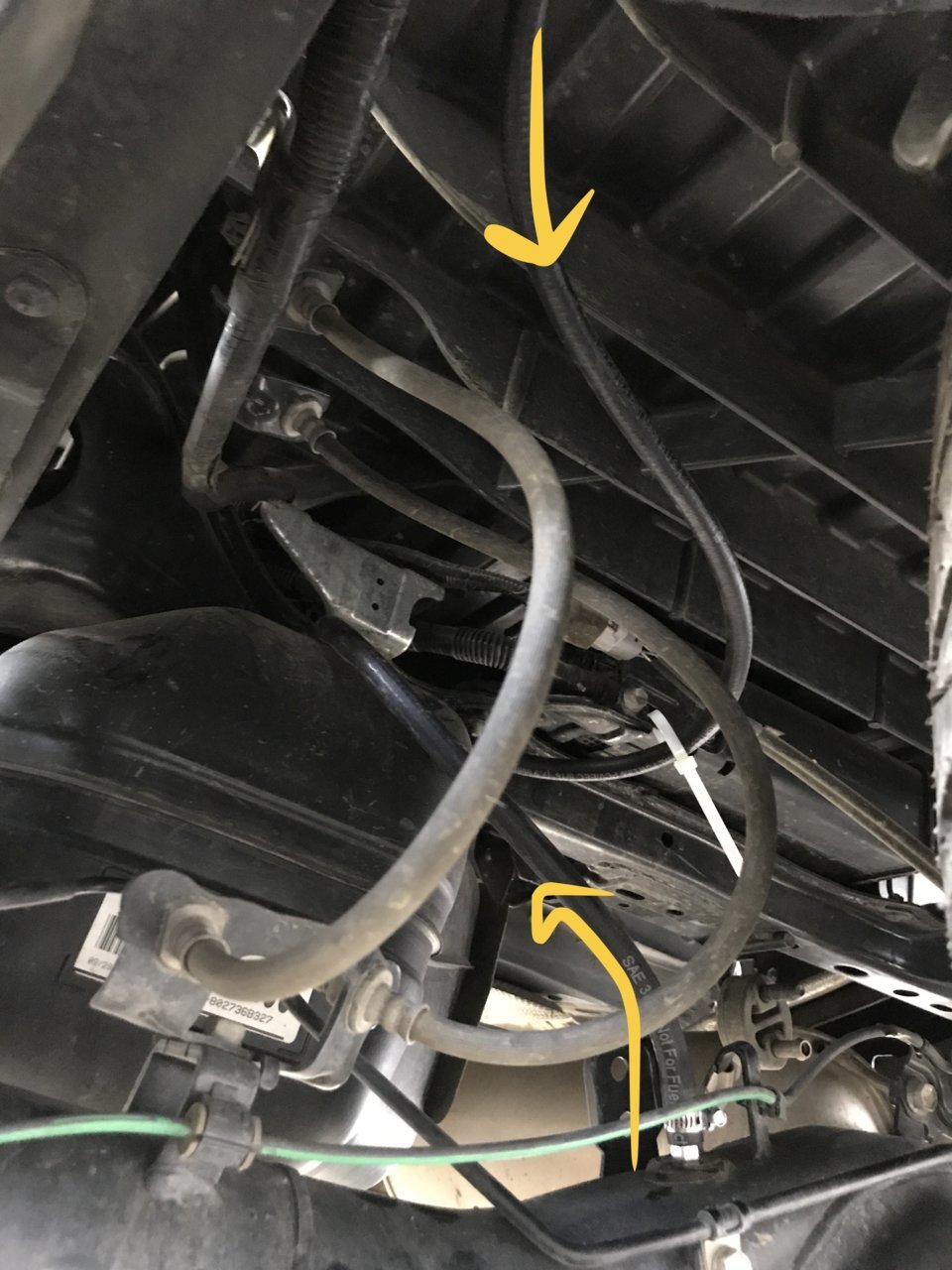

    Edit: you can see here how I coiled it to avoid the brake line and keep from snagging on anything at droop, by zip tying it to that bracket there. IMG_3429.jpg

    where are the parts number, I don't see them. also is that a 2 way breather?
