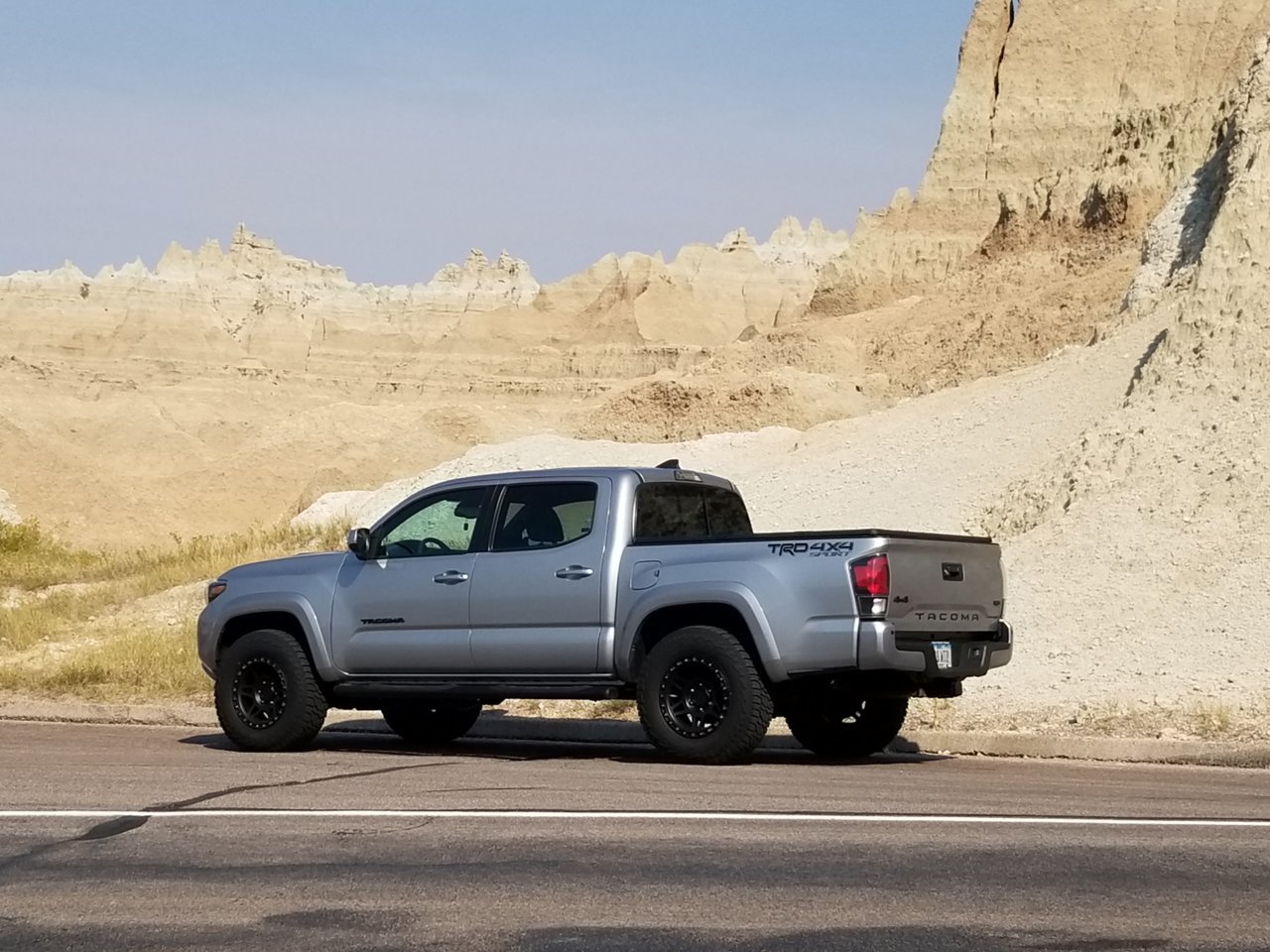

    Followed this dinosaur to the Badlands

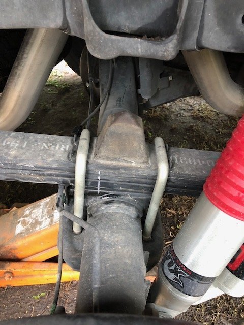

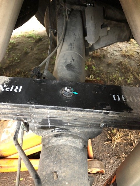

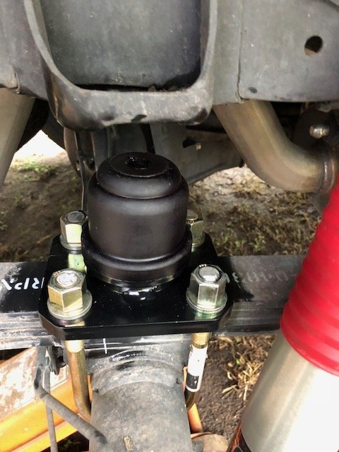

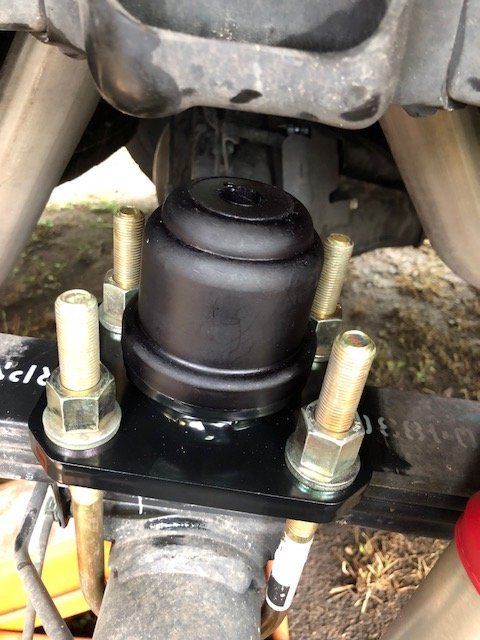

    Anchive Garage U Bolt Flip kit with Super Bumps.
    Raised wheel by axle. Removed wheel. Placed index marks (note white paint stripes on side of base and leafs) on all spring pack parts just in case anything shifts when OEM U Bolts are backed off. If things move and you can’t get them back you may end up with having a four wheel alignment done. Yes, there is an indexing post on the spring pad BUT if you ever had loose U Bolts the post and socket can be wallowed out. Removed OEM U Bolts and base plate. Install new parts and mark U Bolt protrusion. Cut excess off the new U Bolts or you’re going to get a very nasty surprise. I then torqued to 40lb, 60lb, and finished at 80lb per Anchive. Sprayed clear coat on ends of U Bolt and nuts to prevent rust. Re-torque at 100 miles and 500 miles.
    U Bolts OEM.jpg U Bolts OEM loose.jpg U Bolts removed spring pack.jpg U Bolts Archive Garage.jpg U Bolts Archive Garage trimmed.jpg

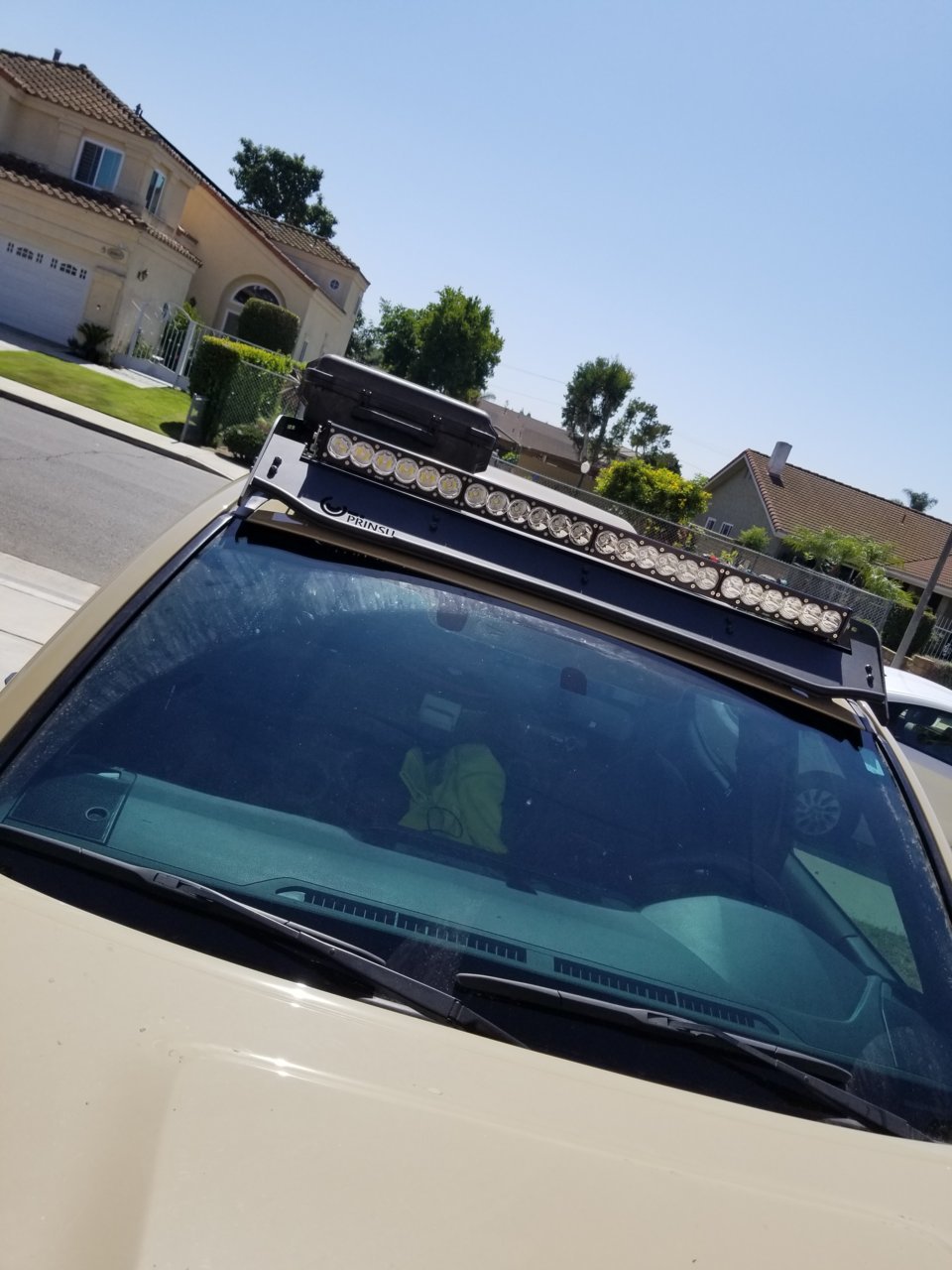

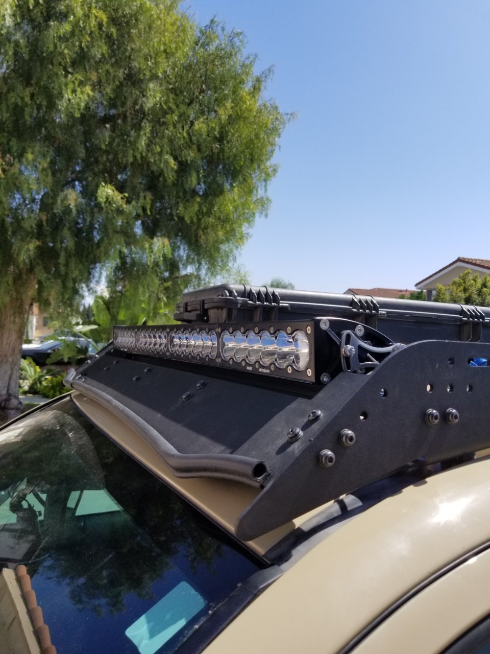

    My oldest son reminded me it's the first day of fall but it's over 80 today.

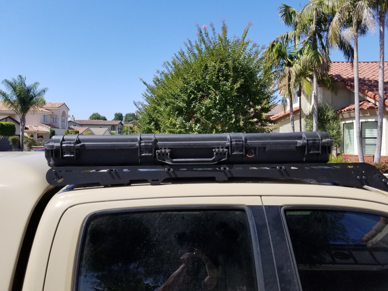

    I was sweating getting the Pelican case mounted as well as the Onx6 on the Prinsu

    Looks good. Checked your youtube channel but no video on it. How did you mount the pelican?

    The last photo was before final torque. After 80lb torque there was one thread. To answer your question no threads are needed to extend beyond a fastener.

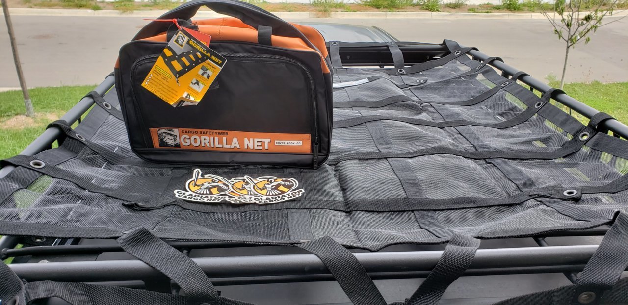

    The Gorilla/Gladiator Net came in today for my Bajarack. Very solid product. Its the rubicon model20180913_121524.jpg 20180922_112518.jpg

    I graduated aviation school in 1980. The reason you want visible threads in aviation is for torque paint if used and visual inspection without having to use a torque tool.

    Nah. He's got full thread engagement.

    Thanks. I just put it on today so it's going to be a little bit before I produce them for YouTube. Check my instagram feed and mostly stories for 'previews'.
    I used 1/4 inch carriage bolts and wing nuts for the case. my rule is measure 20 times, drill once, then hope I did it right. :rofl:
