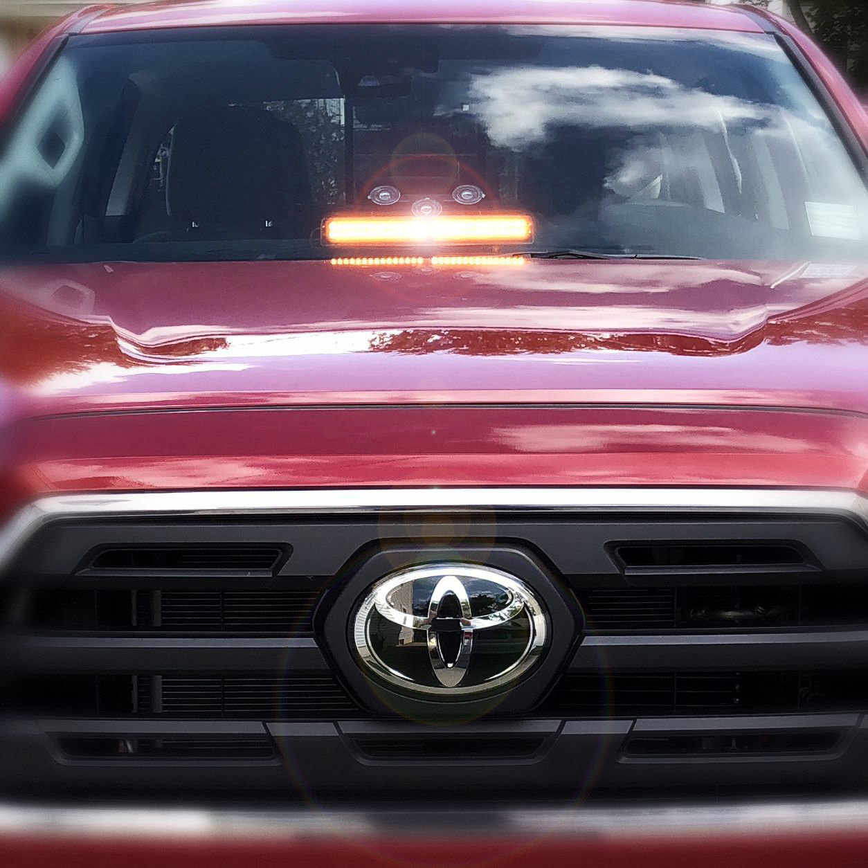

    Mounted my new Whelen Slim-Miser LED dash warning light (Amber/Amber)...

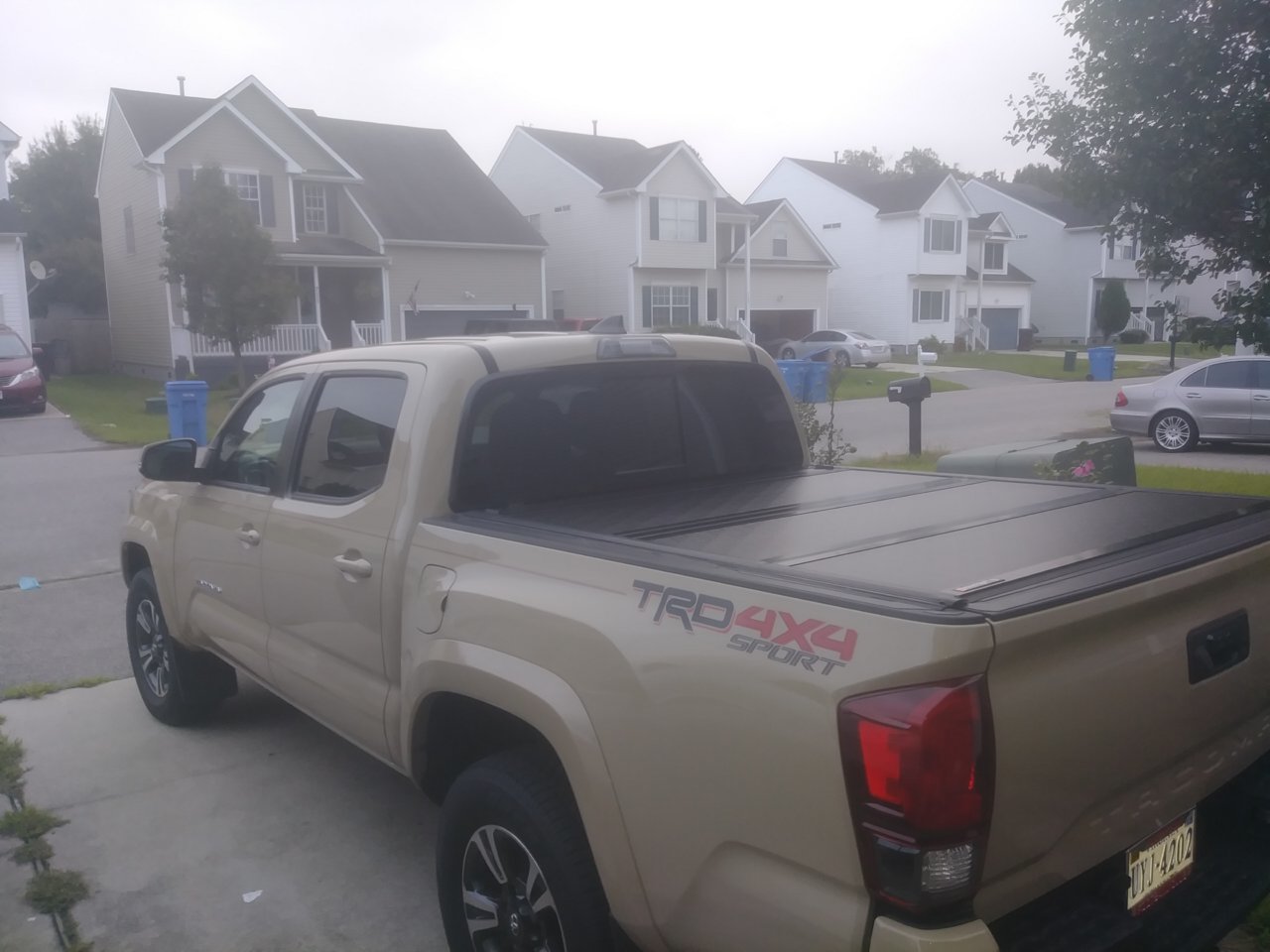

    -Bakflip G2 bed cover
    Bakflip G2. Installed in around 45 minutes going slow. If doing it again I would:
    1- leave the cleats on the rails for the tie down system. No need to remove them
    2- Use a T-30 not a 27 on the factory bolts. I stripped one but luckily Bakflip supplies longer ones for the install. I drilled out the stripped one and hammered a flat head screw driver in to remove the original stripped bolt.

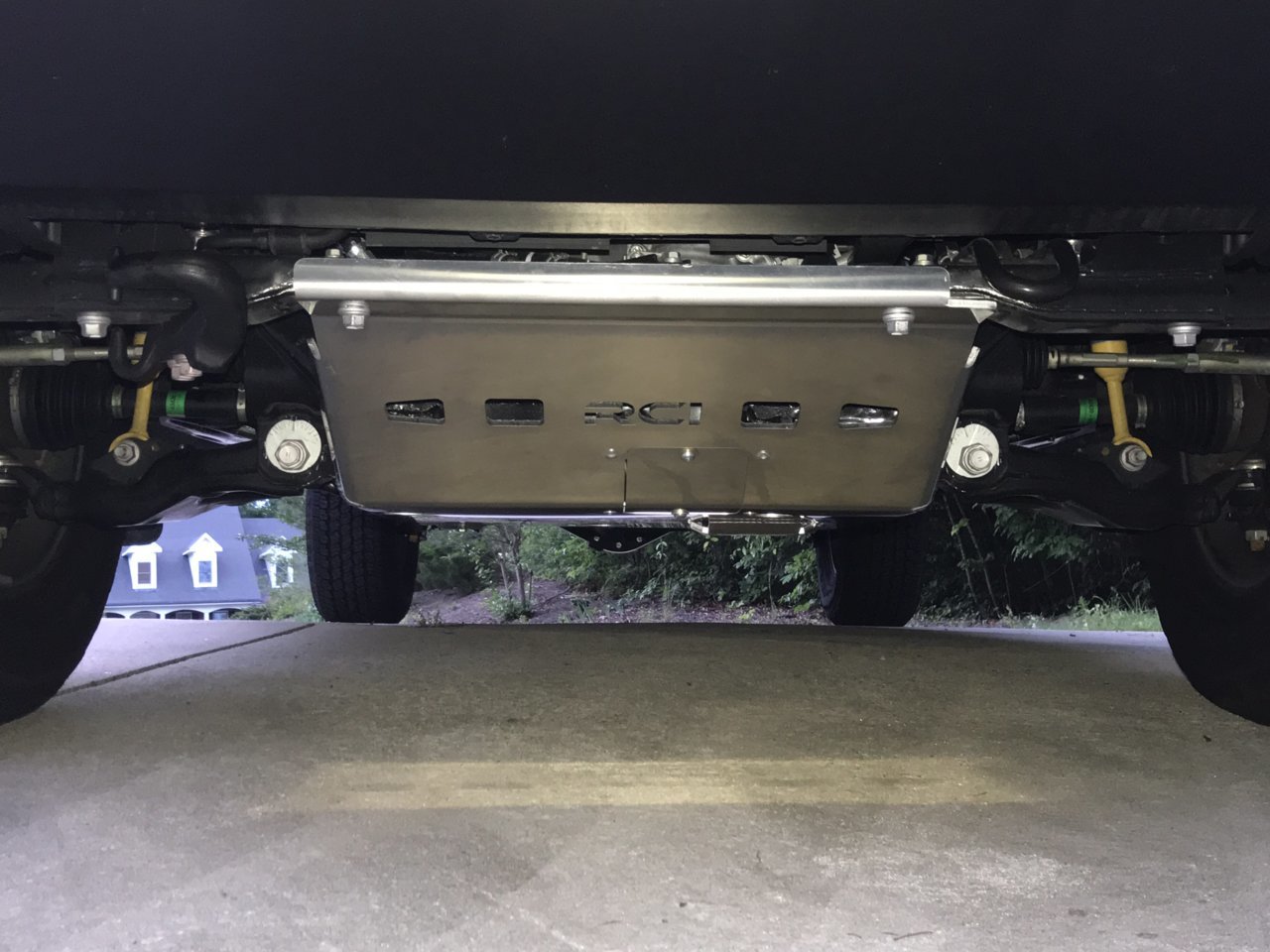

    Damn making want to sell my steel rci to get an aluminum one! Looks great

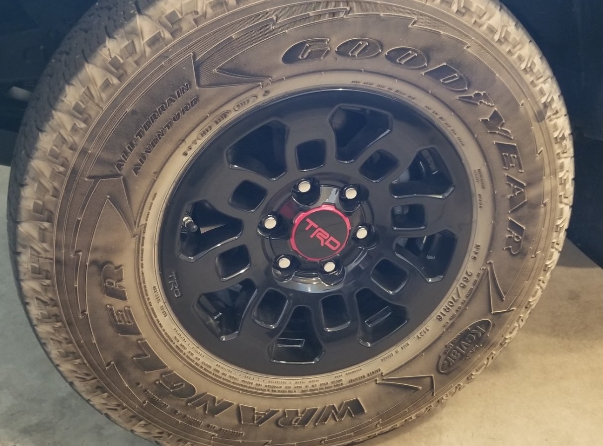

    Got the tires dirty. Pro tip; if you want your painted wheels to stay clean, use chemical guys ez creme.

    Wow ima have to try that out lol

    I’d put it on the roof or roof rack.

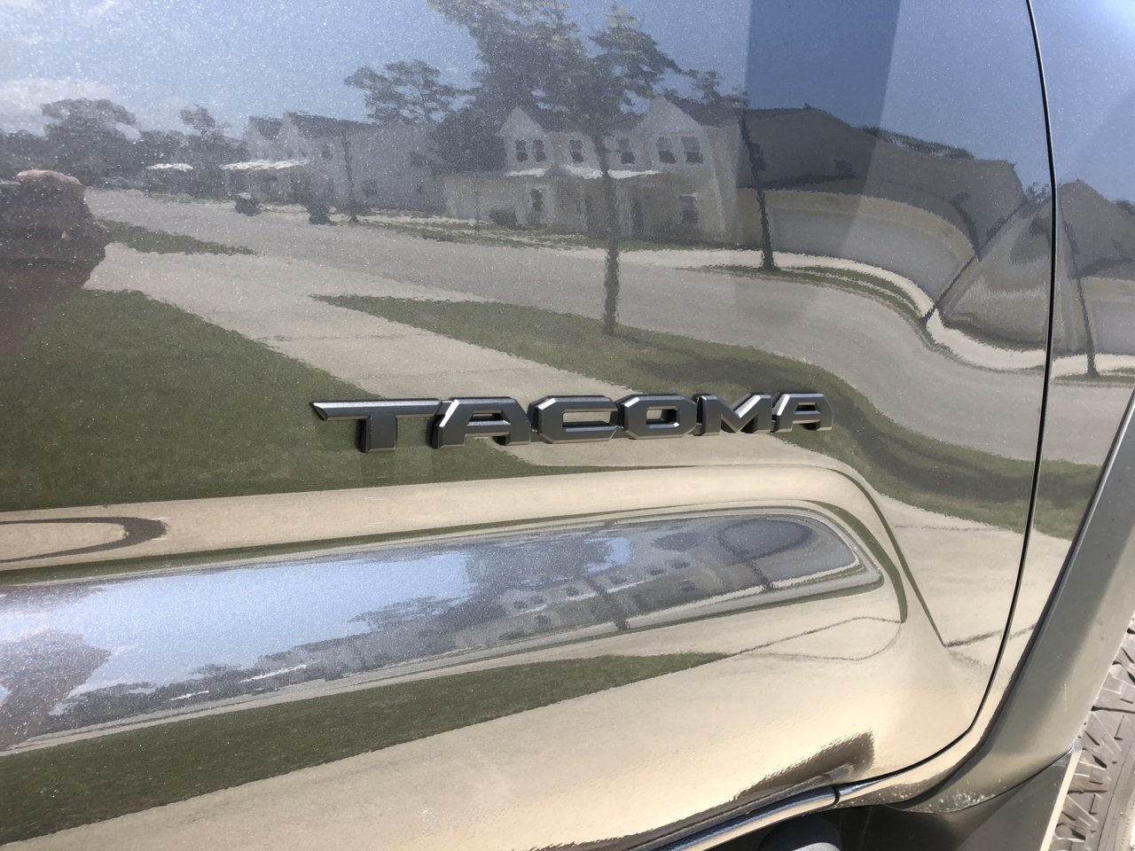

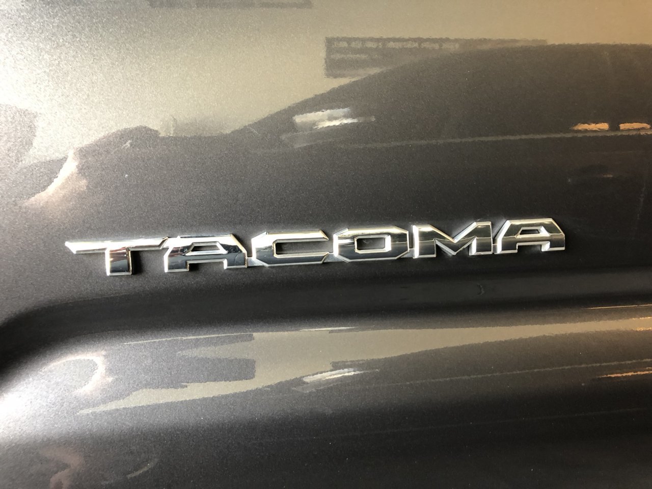

    How difficult is it to get the badges off to do this?
  20. Sep 29, 2018 at 9:23 PM
    DLRIII
    DLRIII Well-Known Member
    Feb 27, 2018
    #245744
    1,977
    David
    Baton Rouge
    2018 Quicksand SR5 DCSB V6
    It's not hard, but it's an hour of cutting with fishing line, then painstakingly scraping off the remaining adhesive. Recommend parking in the sun for several hours prior to warm it up
    Edit- goo gone removed the adhesive aftermath well.
