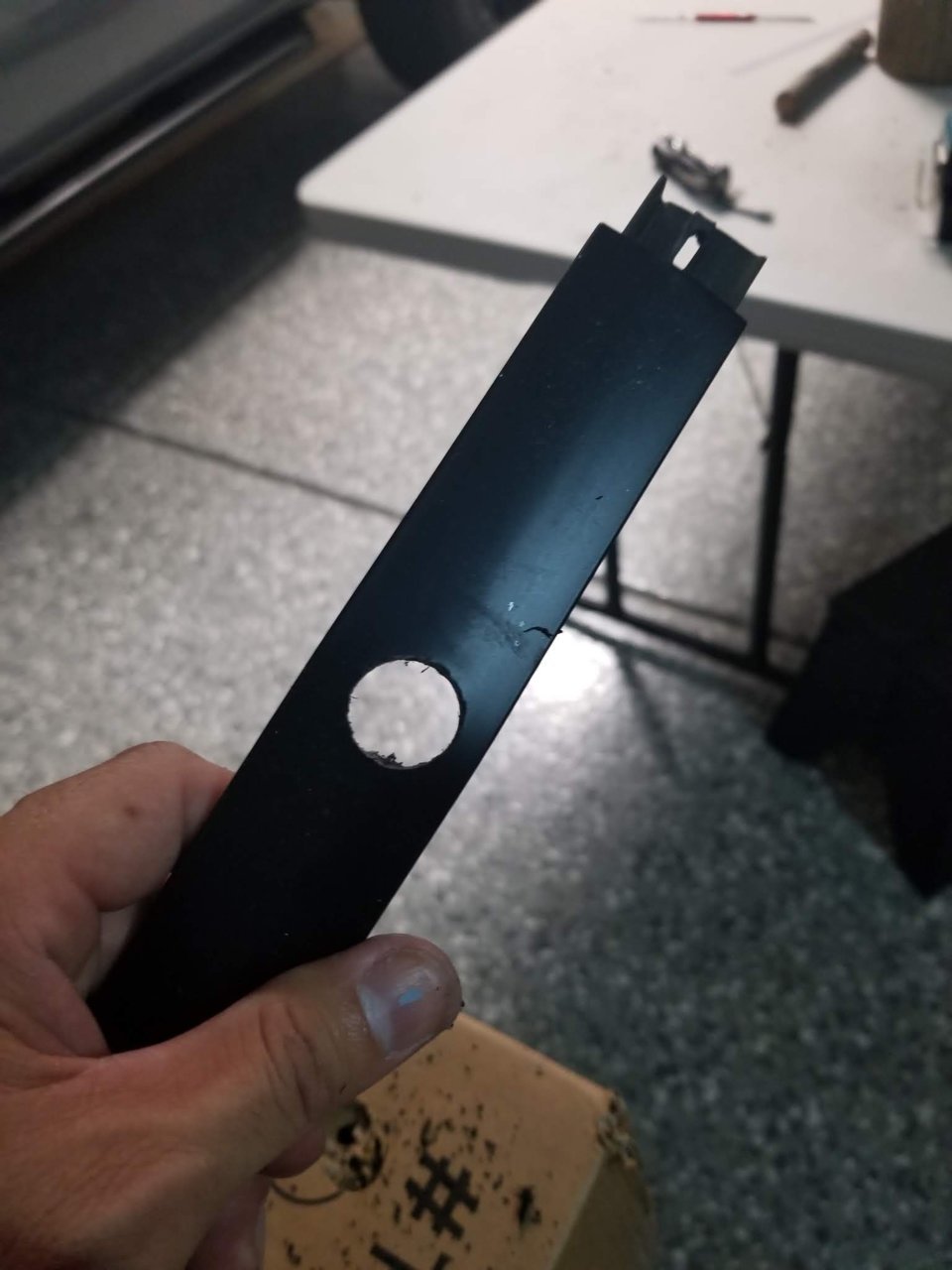

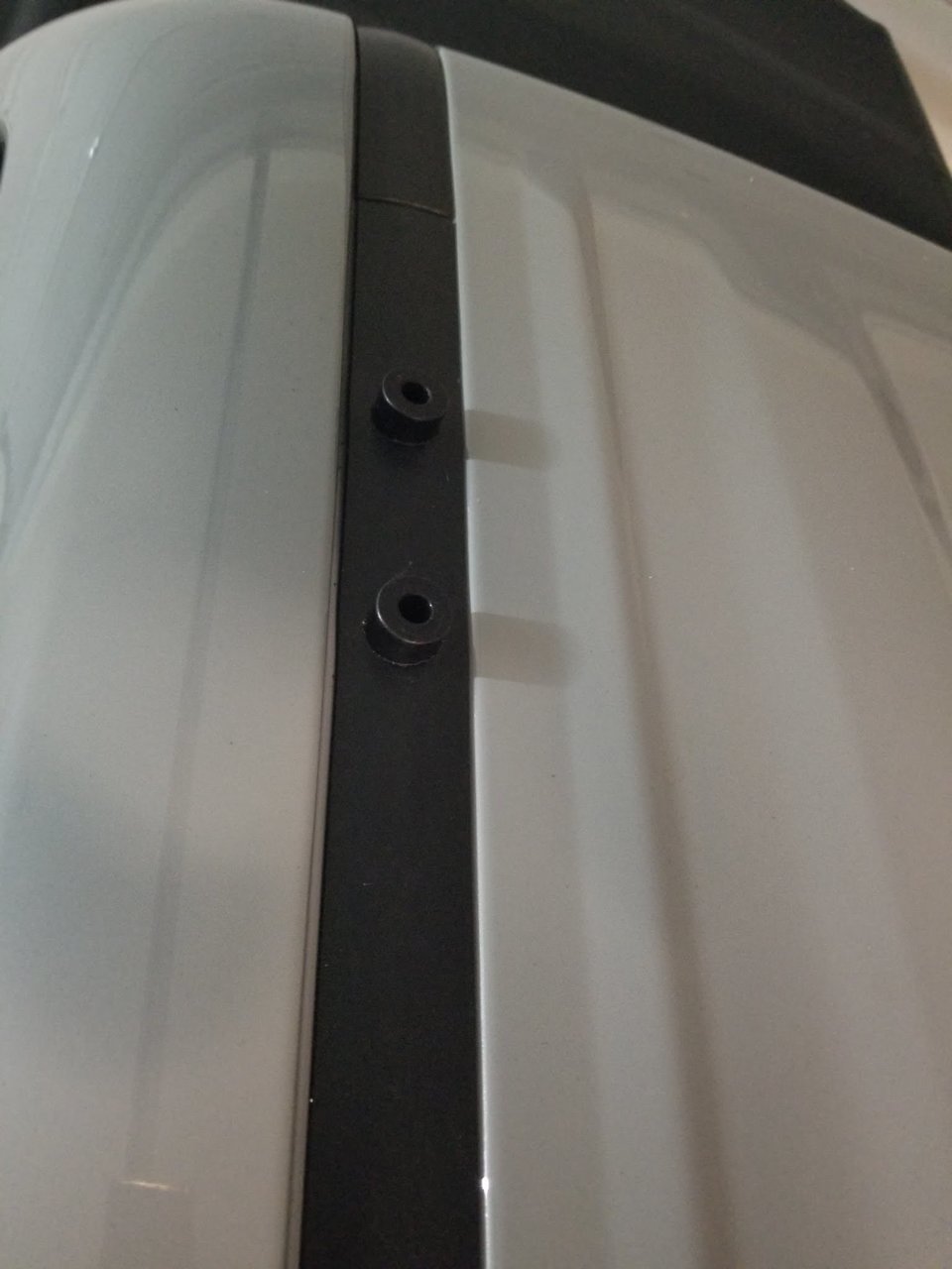

    You'll have to remove the stripe and drill a hole where the mount points are. I got the following hole saw that worked perfectly to complete the job.

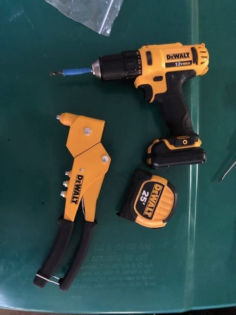

    YES do not use sheet metal screws or self tappers use the supplied Rivets and use a real good Rivet gun this is not for the weak hands to do. I used a Dewalt Rivet gun I got from Home Depot because the head of the gun turns to any position and this made it so much easier.

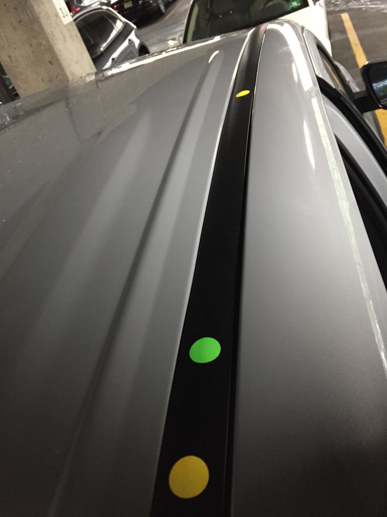

    Hi, the method I followed is pretty similar to what's on this YouTube post https://youtu.be/F7g1rGOQqJU Also, FYI, Prinsu has free shipping just for today.
    With respect to drilling, I found using these neon dots helpful.ad96bc10-2e8a-4b2e-98e6-b30410e9365b.jpg23e93c95-8891-4c91-a6cd-8106e249d8ee.jpg
