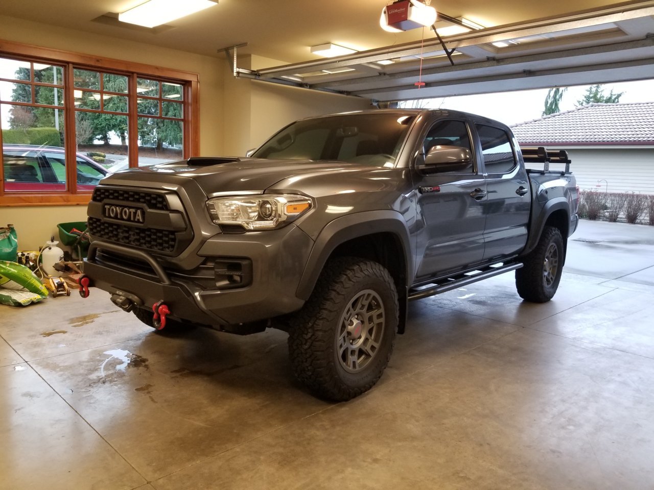

    Lift is approx 3” front / 2” rear. Also have wheel spacers 1.25”. I have no rubbing so far, but haven’t been off road yet. Steering wheel at full lock, there’s a 1/2 inch of clearance.

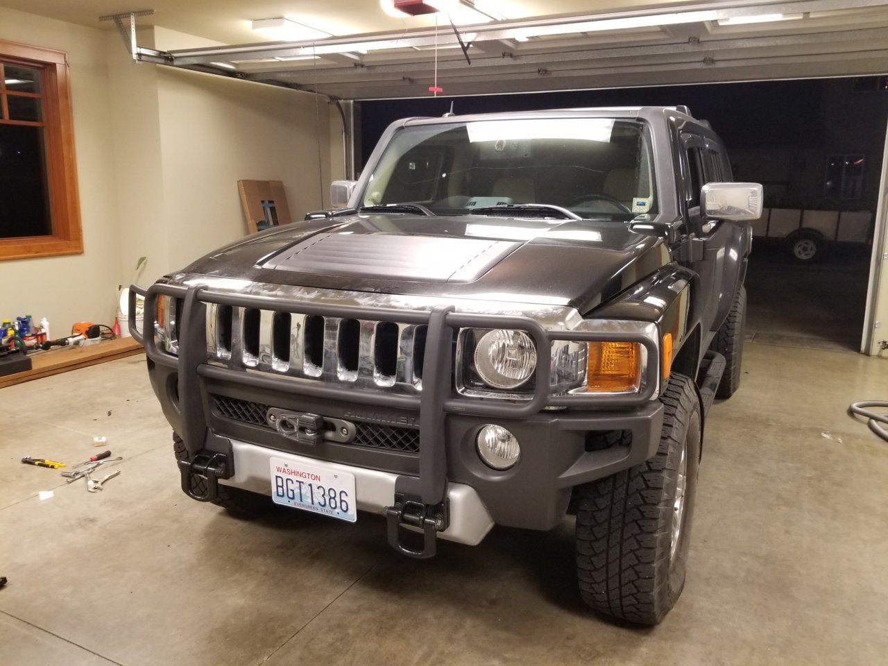

    Installed a hidden winch on my step-mom's 2008 H3 Alpha
    Not a Tacoma, but it was a similar project as my previous SSO Slimline and winch install. She saw mine and had to have it on her rig.

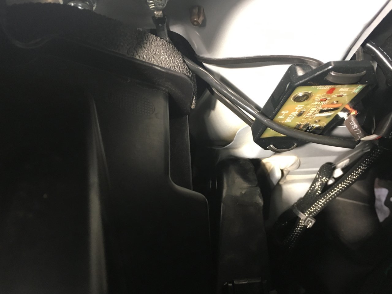

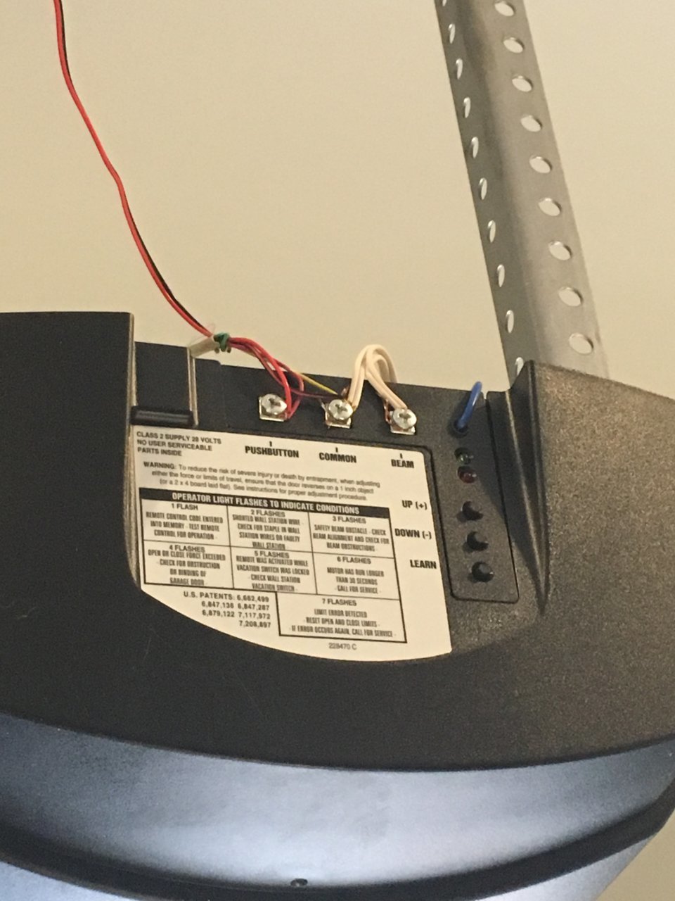

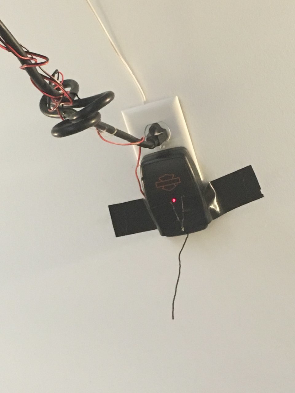

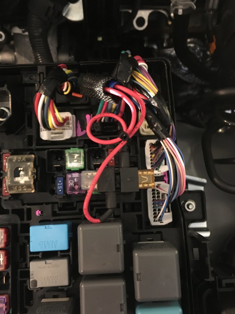

    So I was looking at the homelink mirror which ranges in price up to $289 but I remembered I had a hidden one on my Harley. Figured it couldn't be any different and the Harley shop sells just a transmitter since the receiver can have multiple programmed to it. Pretty easy install just Ground, Power and High-beam power and zip and tuck the wires and that was it. Only works if the truck is in accessory mod or cranked up. Now I have a hidden garage door opener that doesn't take batteries or take up a switch space in the cab. Just tap the brights and good to go.

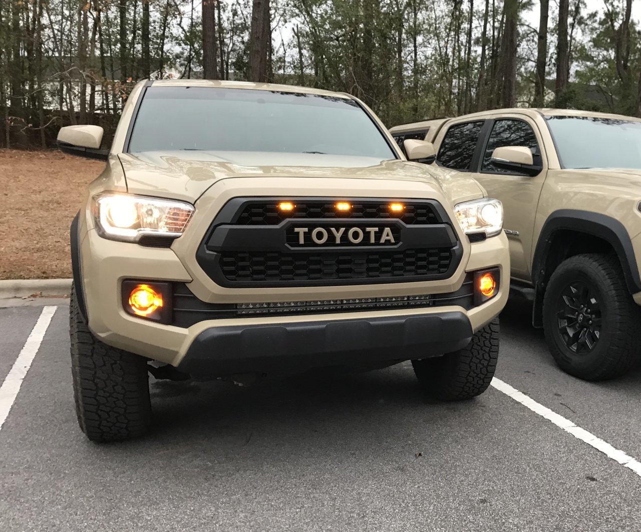

    Finally got the Runnin4Tacos Raptor lights installed and the fogs aligned properly.

    The amber fog lights with the Raptor lights tie it all together nicely. What made you decide to go with Runnin4Tacos vs Yota LEDs?

    I wanted them on the top row (after putting these in, and having to modify the grill and lights, I imagine you could probably modify the Yota LEDs the same way. At my time of purchase, I was not aware of that), and I also liked the wider LEDs from Runnin.
