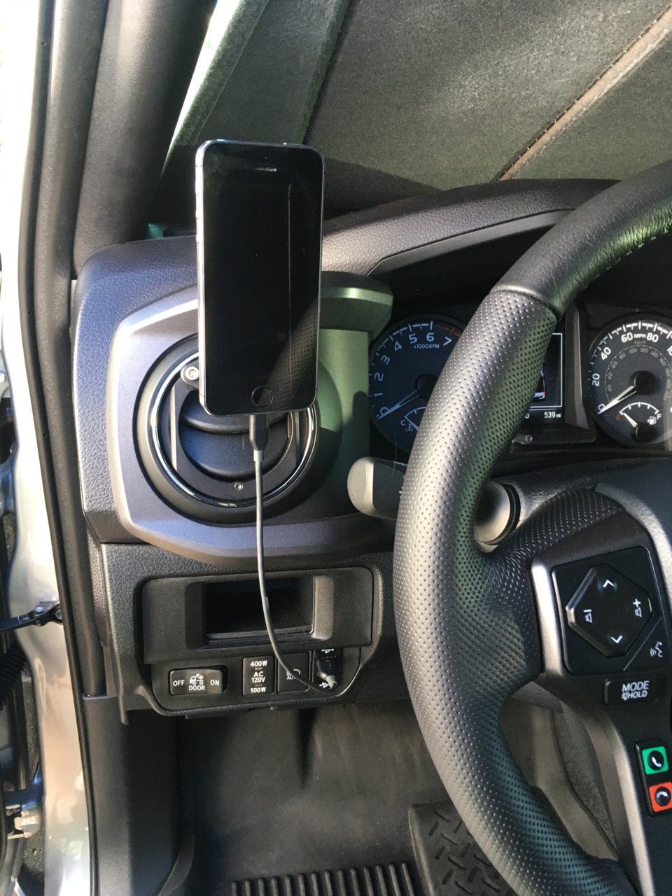

    Installed the Duel USB on left the side Dash. Meso Fuse Box Cover is a must for Add A Fuses:

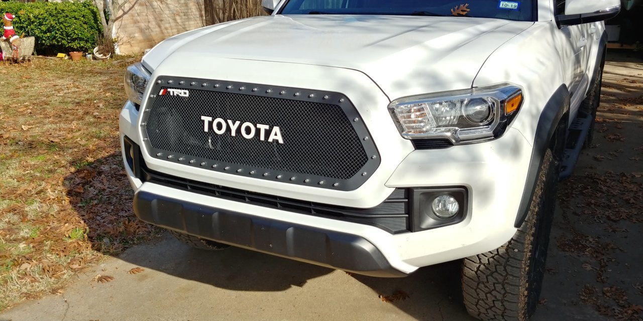

    what grill is this? I like the look of it. thx

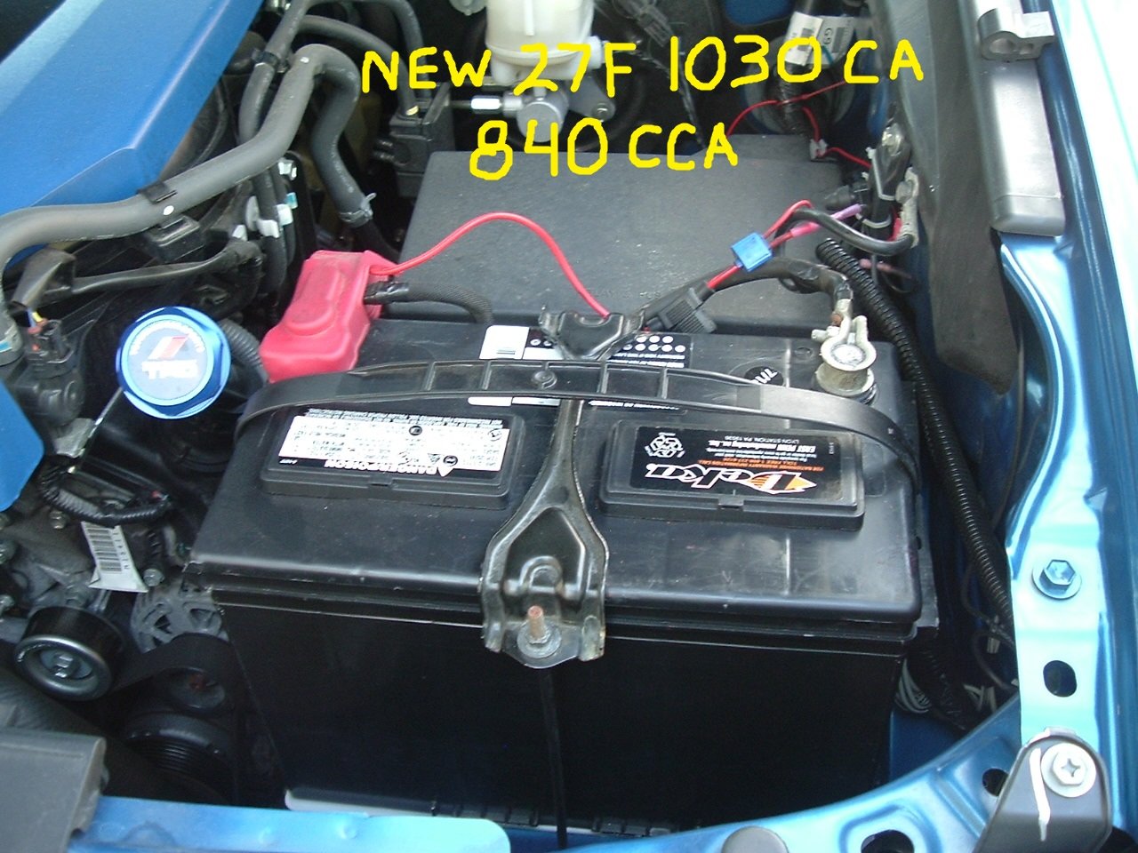

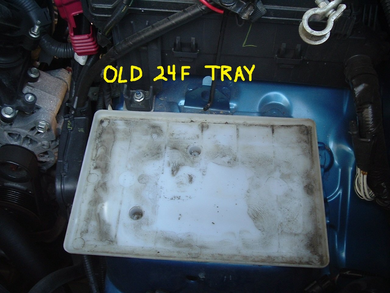

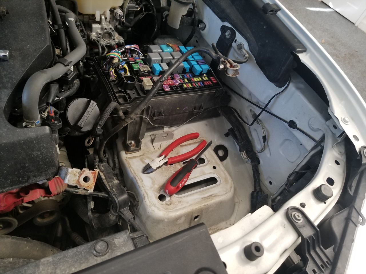

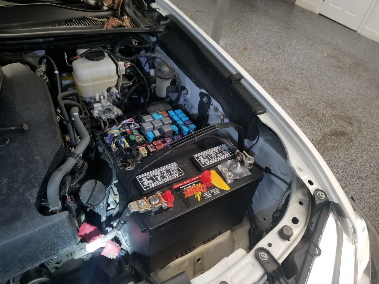

    Working more on the Group 27F, I took apart the factory battery wire harness. I won't have to extend either cable doing it this way. I do need a tray for this bad boy... thinking some 1/4 plate tacked to the factory sheet metal. The positive power cable comijng out of the fuse box will need to be extended a 4" and replace. Will post back next weekend after I make this cable and batt tray/plate.

    Just wondering why you're doing it the hard way. The Group 27RPG has the (+) and (-) terminals swapped and the Gen2 oem (okay, it's plastic) battery tray is for the larger battery.

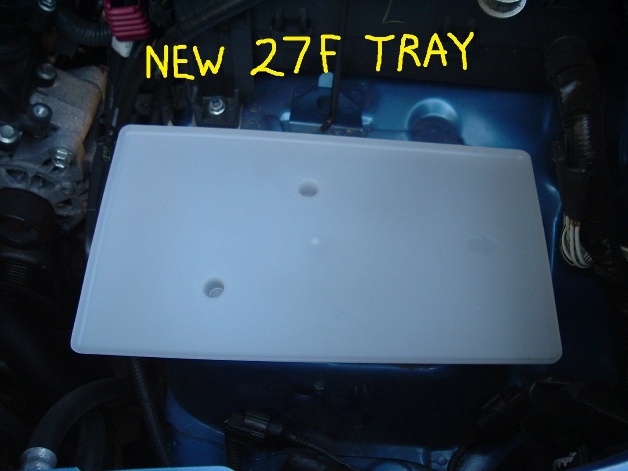

    I just bought the Toyota 27F tray. Drops right in the same holes as the original. Made for 2nd gen V6 Prerunner or 4x4 with tow package. Stock cables.

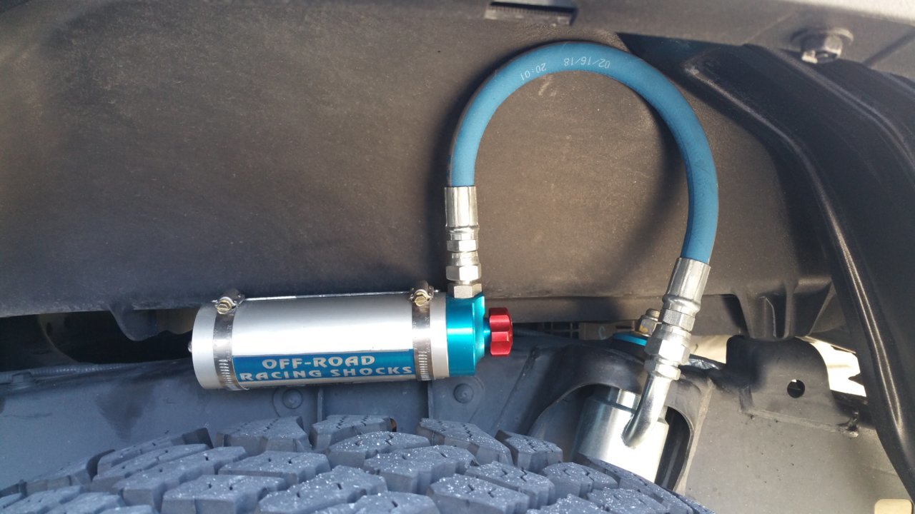

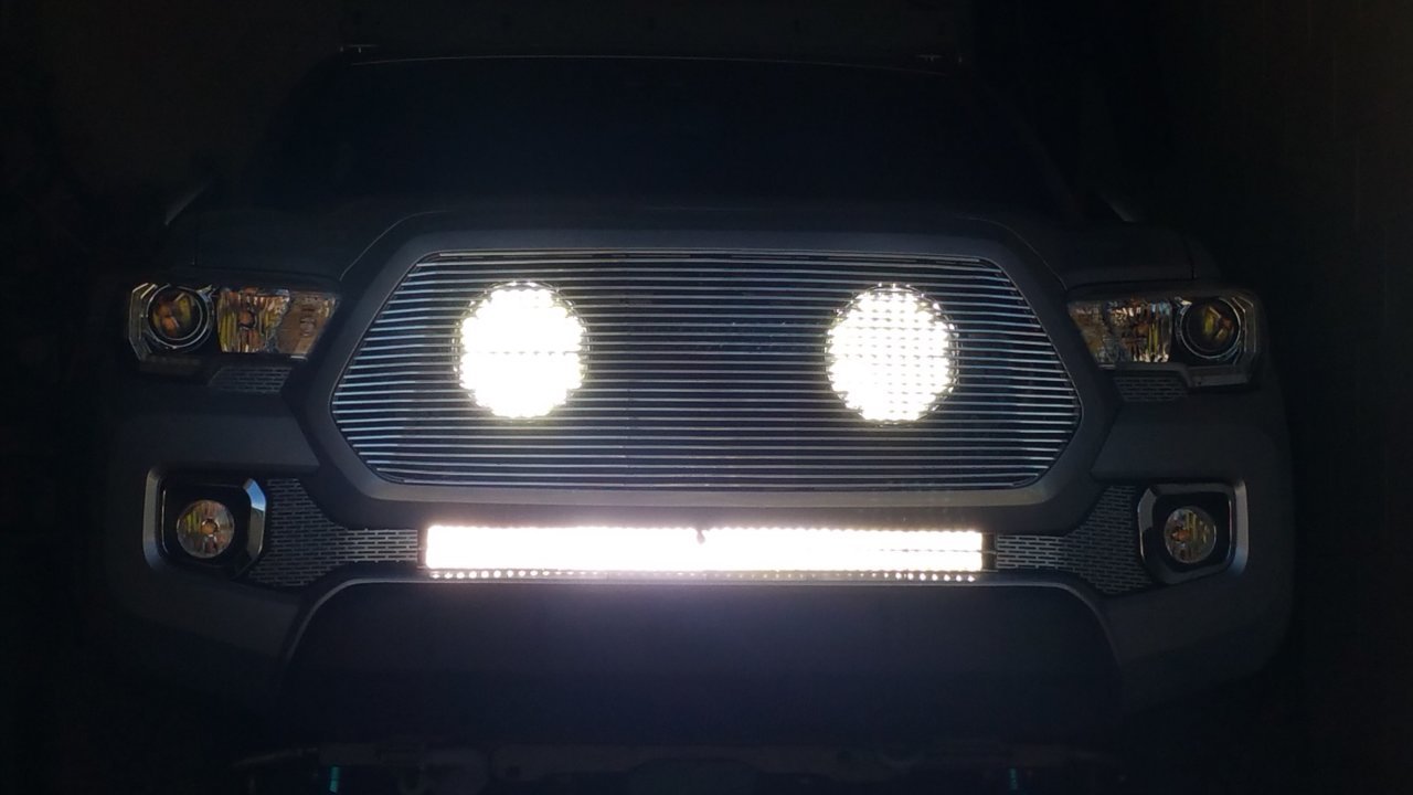

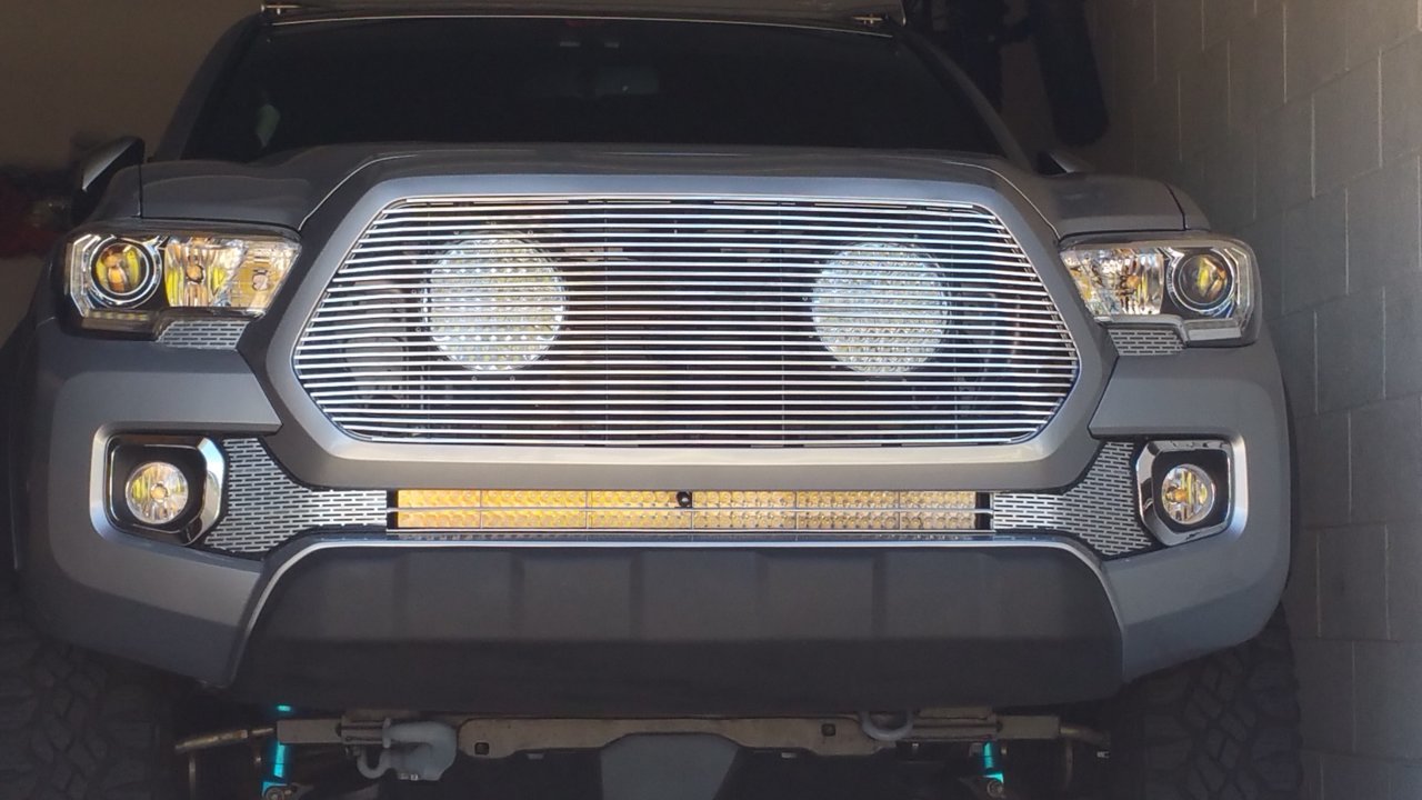

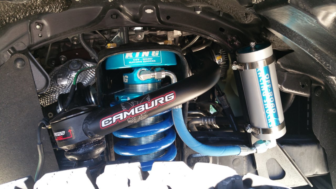

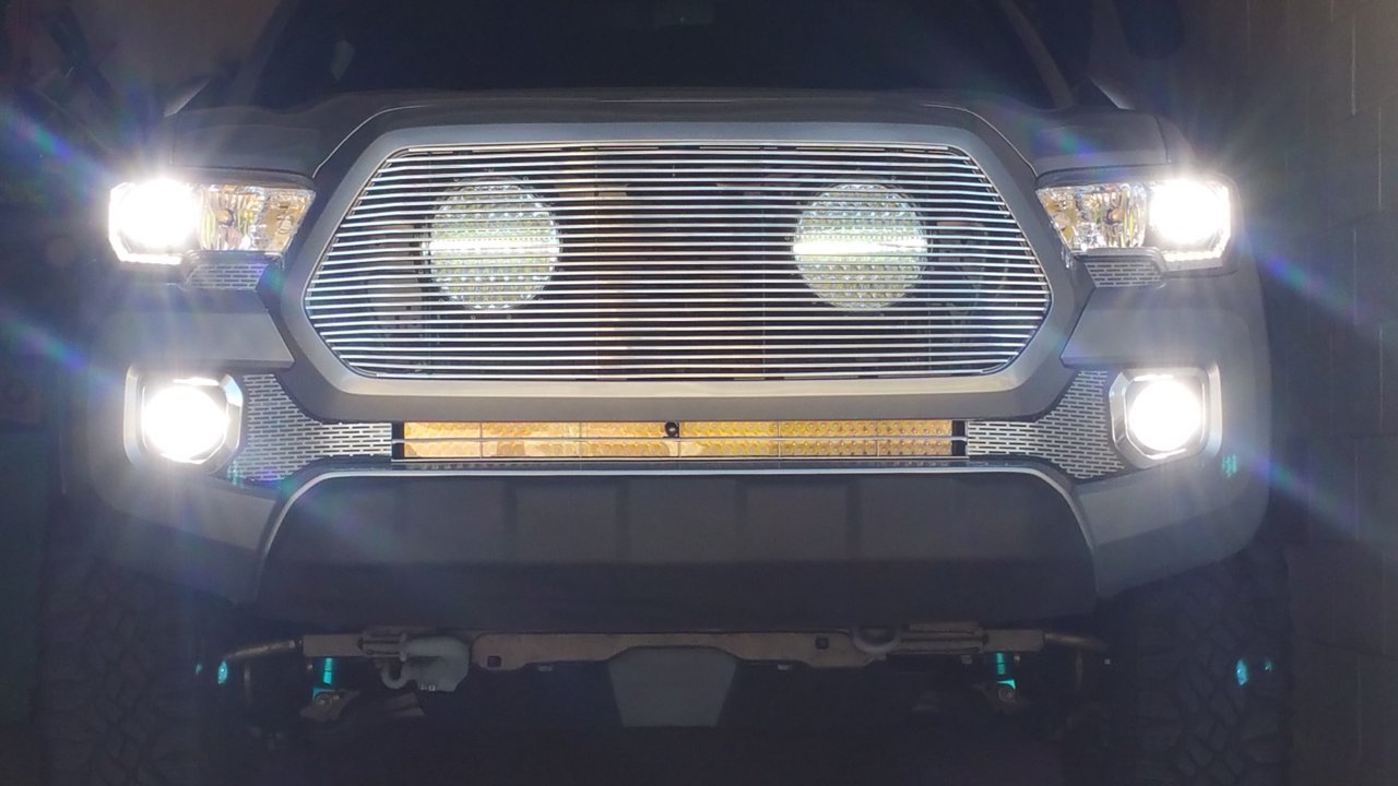

    A few new mods installed! Kings, Cam & all LEDs are switchbacks white or amber color...
    20190105_125443.jpg 20190105_125429.jpg 20190106_112858.jpg 20190106_113119.jpg 20190106_113209.jpg

    Deep cycle using a 27HDC115- 115Ah @20hrs this thing is beefier

    I love the look of my custom grill pieces on your truck. This is the first truck I’ve seen with them installed. How do you like them? Pretty easy to install? I still get asked daily how people can buy all of the pieces.

    Thanks, this location isn’t for everyone, but it works for me.
