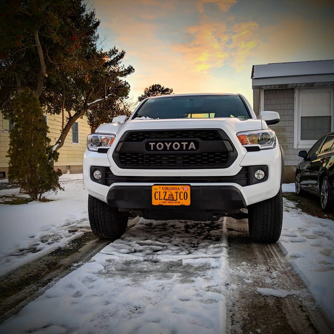

    Added the CaliRaised Faux TRD Pro Grill today in the snow. Also have the Kobalt 12V air inflator from Lowe's I'm going to be working on wiring up to a switch.

    Nice. Like the Don't Tread on Me plate.

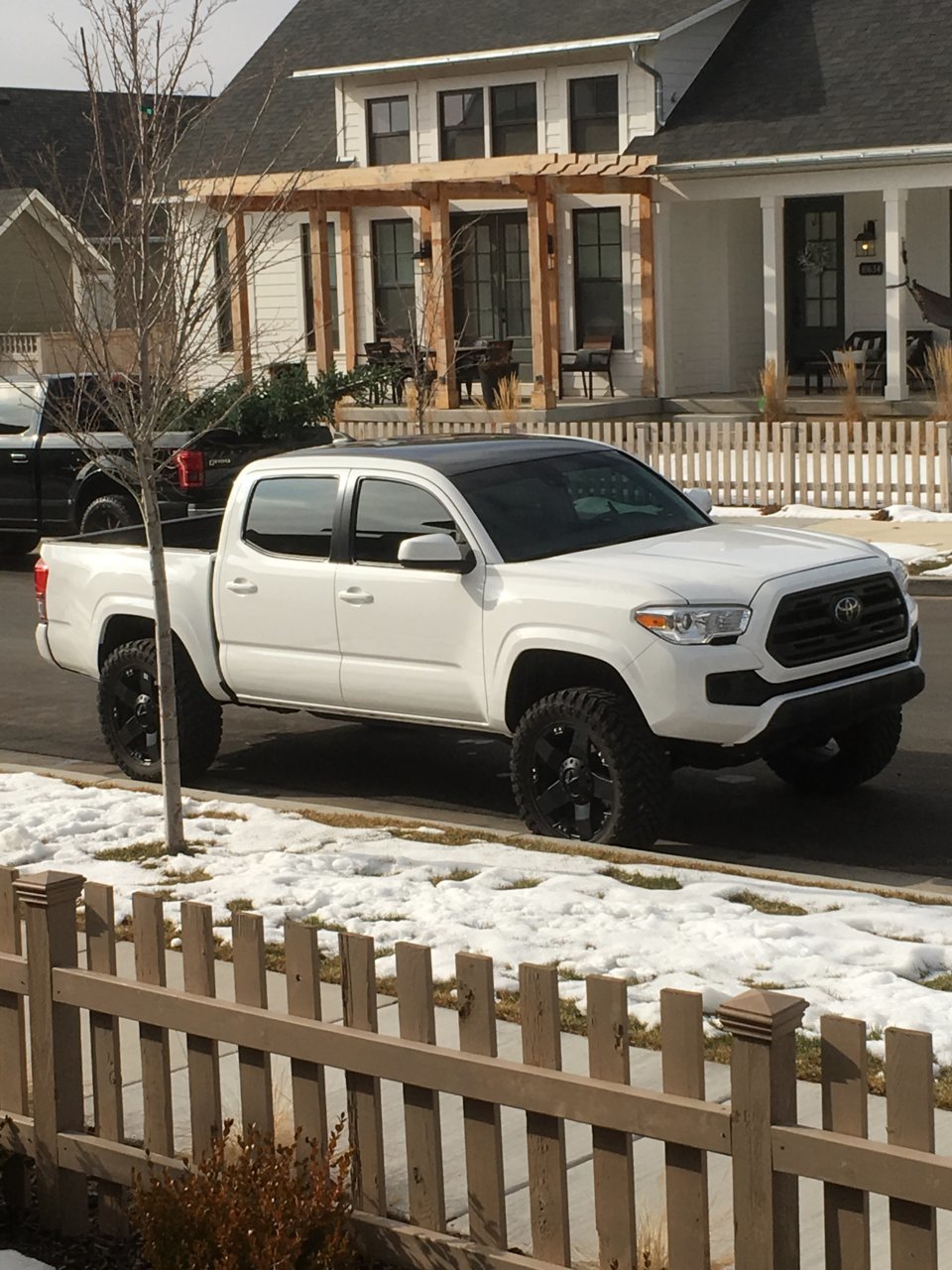

    3” front lift, rockstars on 33s, tint, and black roof

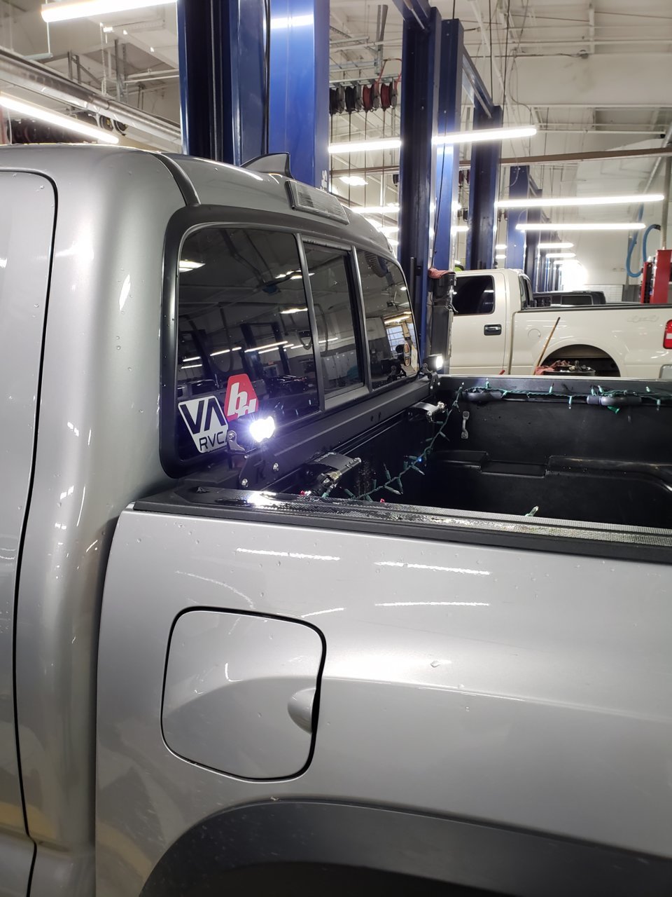

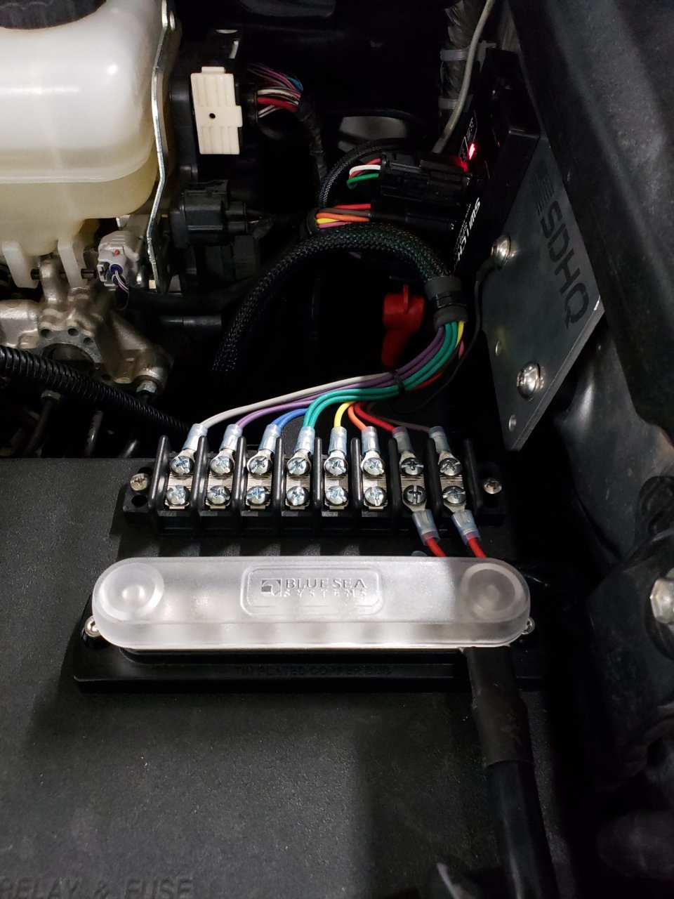

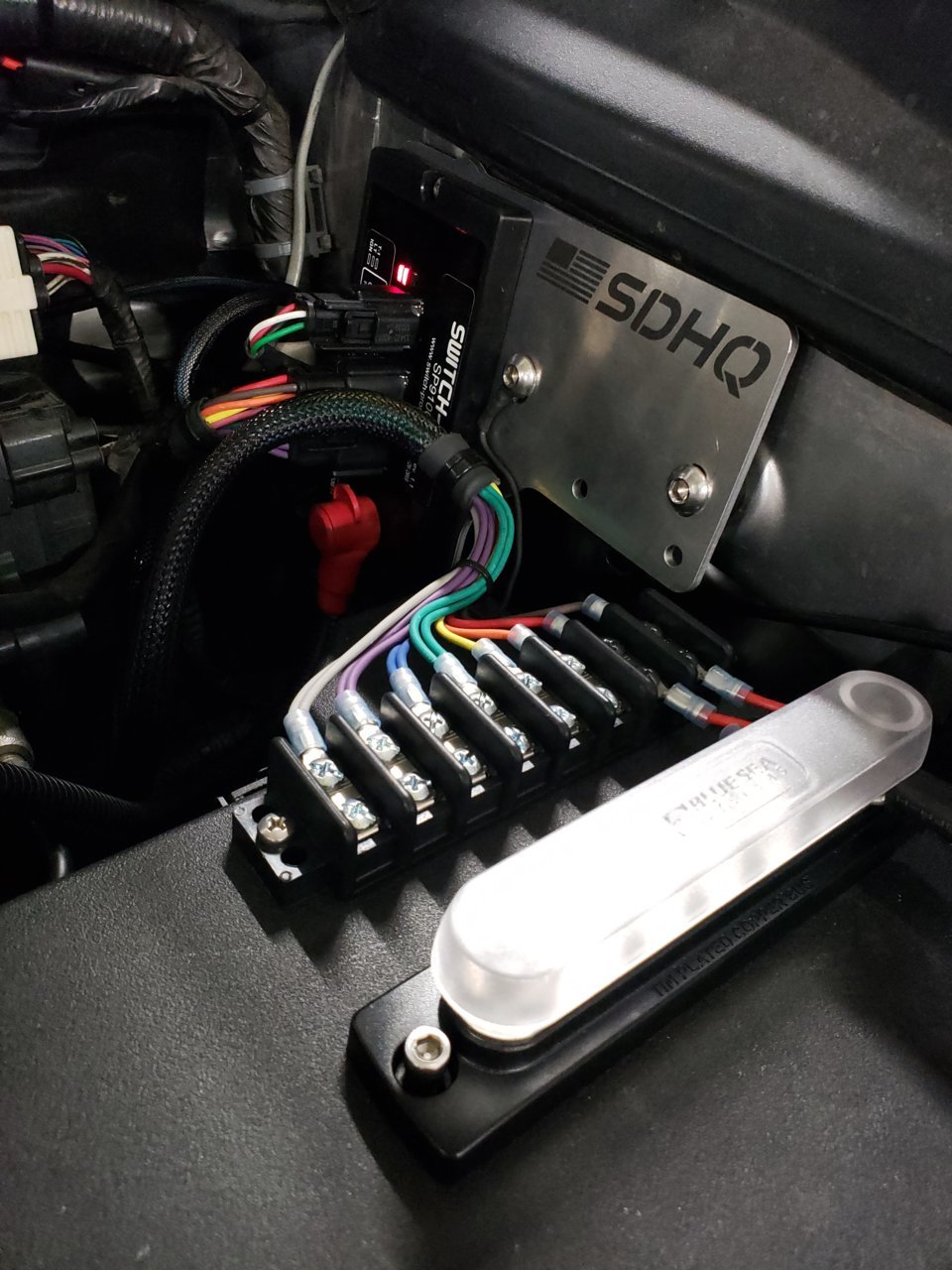

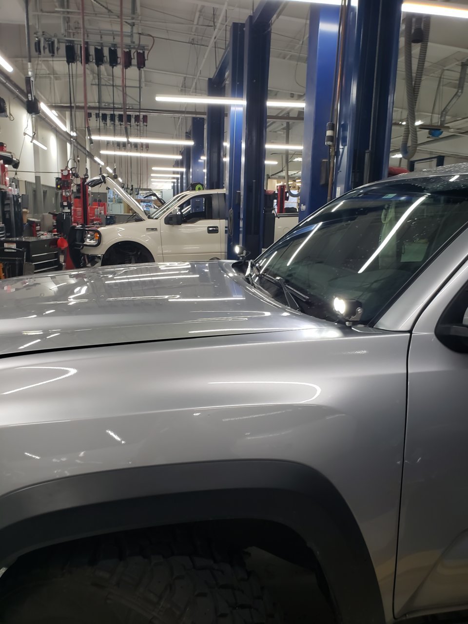

    I got around to installing my SwitchPro 9100, and my Baja Designs S2 Sport lights! Mounted on Rago brackets.
    20190115_173436.jpg 20190115_173425.jpg 20190115_173418.jpg 20190103_165926.jpg 20190103_165945.jpg

    You've inspired me. Thinking about switching things up from my bed divider now.

    sorry im a noob with electrical. is this where you connect all your aux lighting? is this the aux fuse box?

    Yes to the first part, essentially on the second part.

    I need a clean up kit like this...I have at least 6 aux harnesses and a rats nest of wires...I don’t even know where to start...where did you get this rainbow of simplification I keep seeing in peoples pics...and did you install it yourself or is this a pro job?

    A Switch pro 9100 is a customizable switch panel with a distribution panel. A Power tray is a distribution panel but you need to use your own style switches.

    So i have ditch lights and bumper LED bar, both have the wiring harness. If i got this kit i use the wiring harness they gave me with the lights and with some work i connect them all into this switchpro? there a lot of splicing i assume?

    Nope, not a ton at all. Hot goes to a bus bar that goes to the switch-pro, cold goes to a cold bar that gets grounded.
    here:
    https://www.tacomaworld.com/threads/bkf-build-and-shenanigans-thread.544105/#post-17616766
