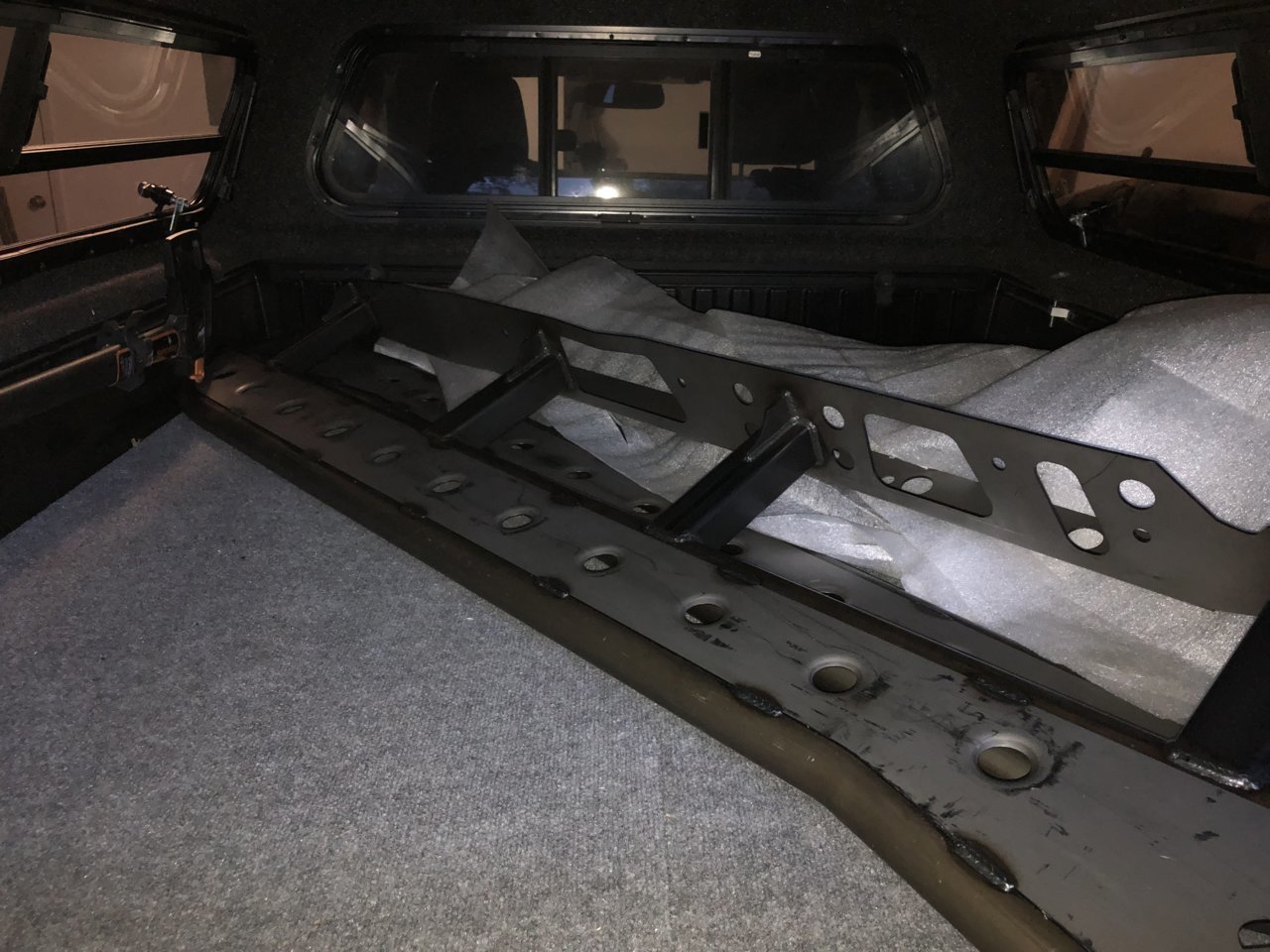

    Got my All pro sliders from summit racing yesterday. They have a sale and have free shipping! Saved a ton of money there. Very excited to get these painted and mounted up. Just need the weather to cooperate.

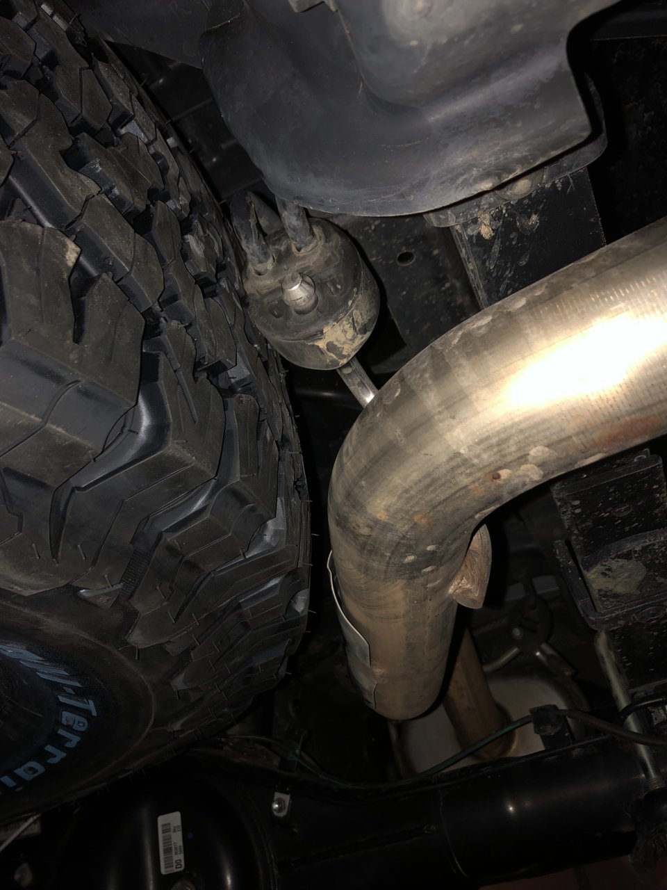

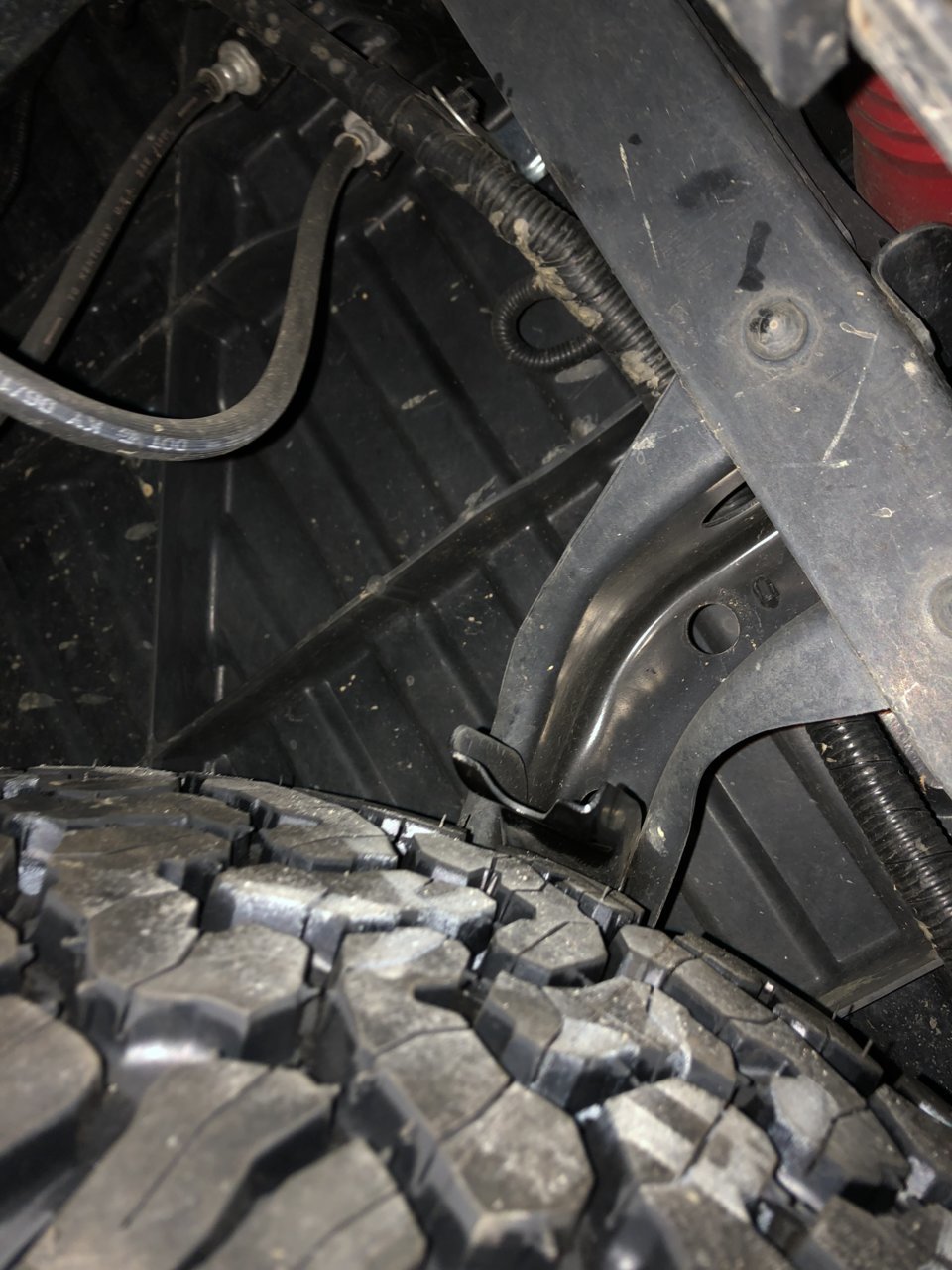

    I relocated my spare tire crank back an inch by drilling 2 new holes and using the old rear holes. Slightly bent the muffler-side tire locating tab out a bit, driver-side tab doesn’t even touch. 285/75/16 fits great now.

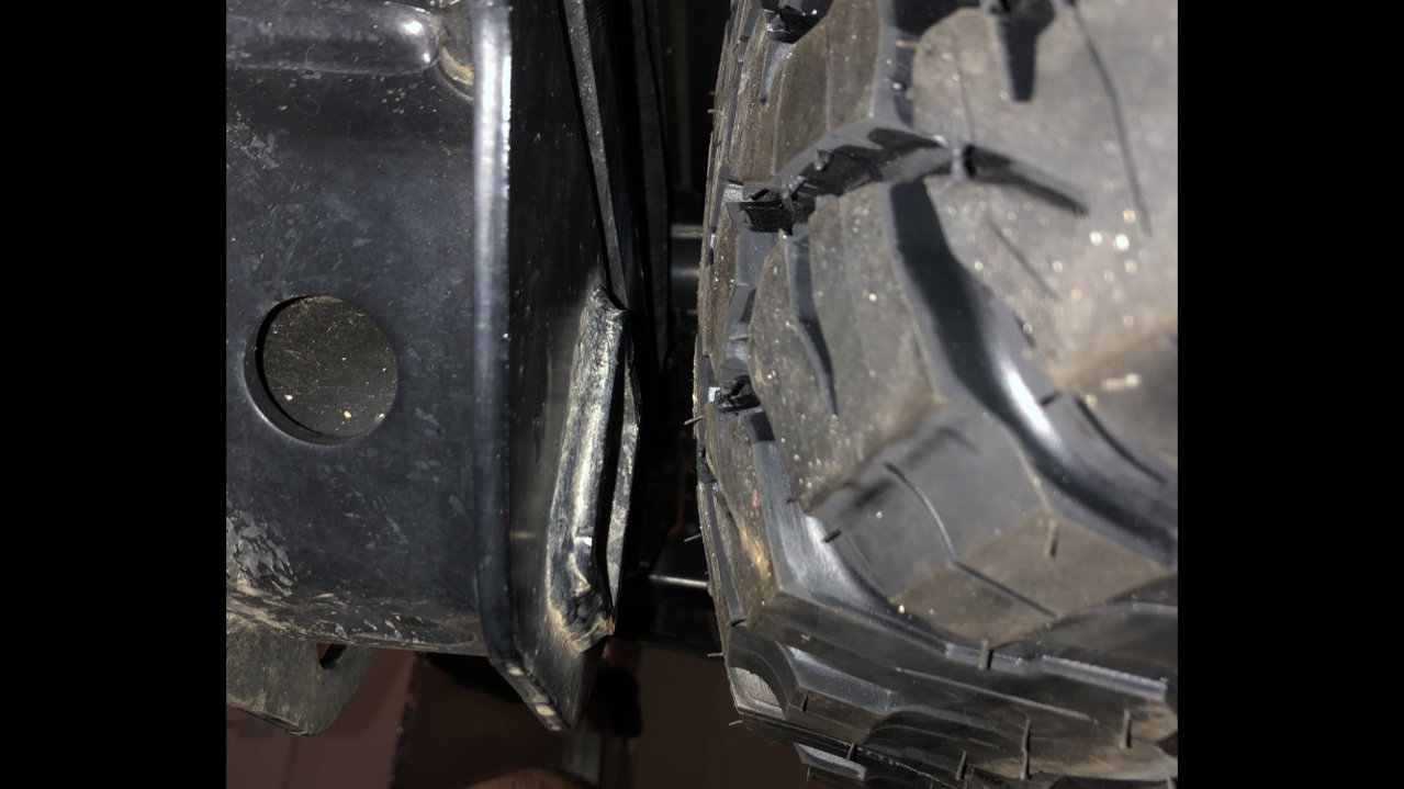

    1. Damaged both sides of my predator tube steps. Need to purchase rock sliders - which isn’t necessarily a bad thing...

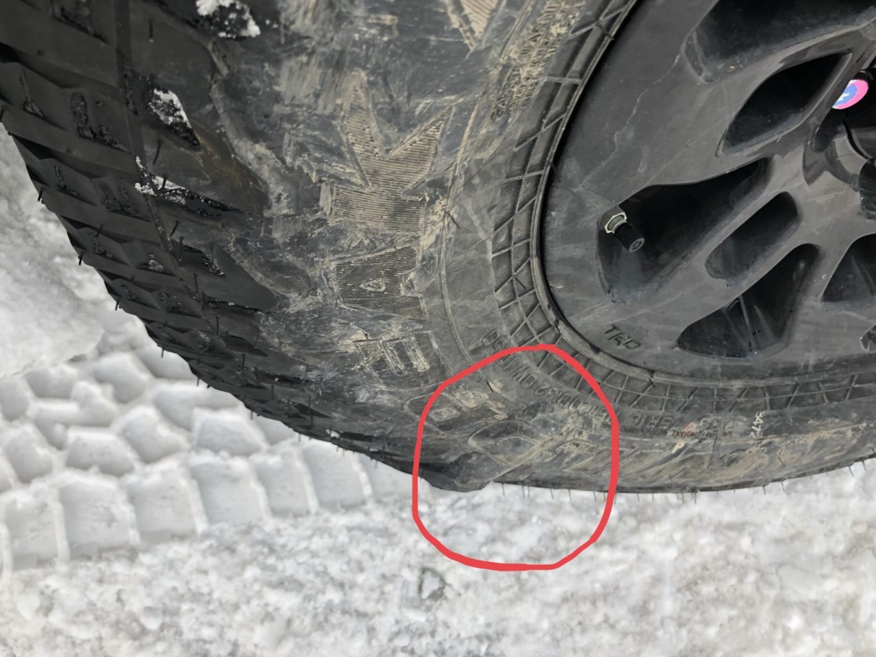

    2. Falken Wildpeaks developed a bulge at the sidewall.

    bummer about the tire...and too bad about the steps, you could have sold them and put a nice dent (get it get it!!) towards some sliders...
