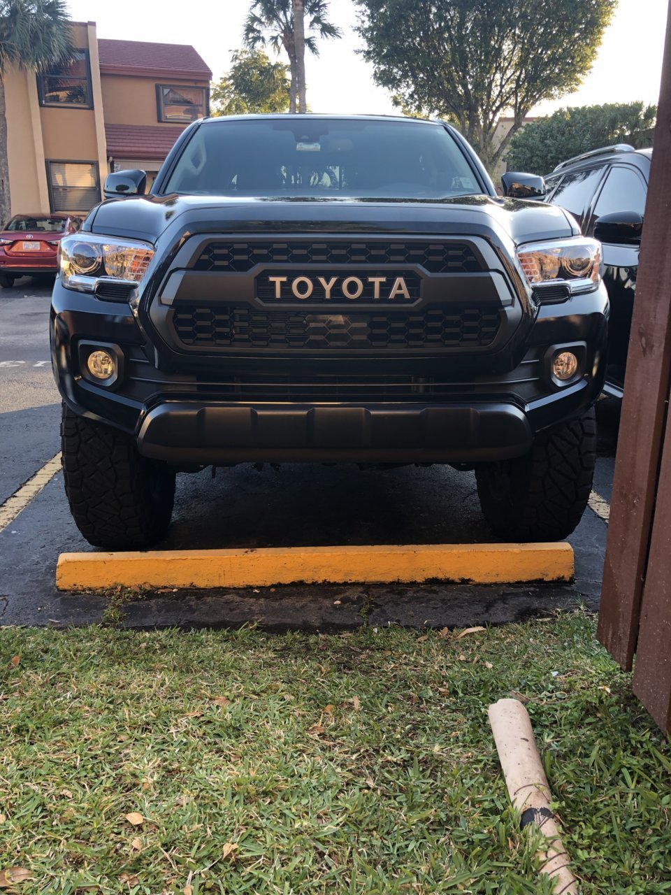

    Pro grille in. Having trouble with the garnish cover though. Won’t click in.

    couldn't get mine to click in either.. it's wedged in pretty good that i can't pull it off. should be ok

    I had the same problem with a non-OEM grille. Got a hold of an OEM and it fit like butter.

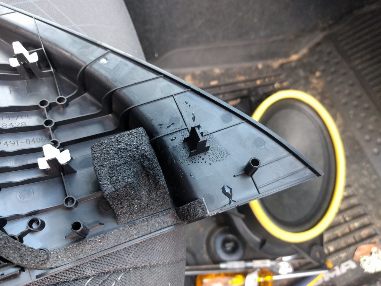

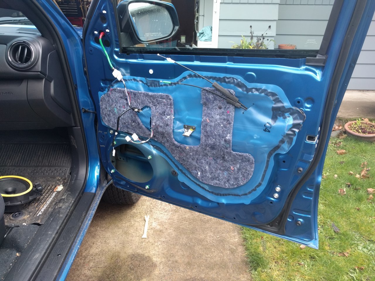

    Popped out the passenger door speaker to roll my own adapter this week. Decided for < $15 to just order a set instead. Fair bit of moisture inside the panel when I got in there. It rained pretty good here Friday & Saturday and the truck hadn't moved since Friday afternoon so maybe that's normal?

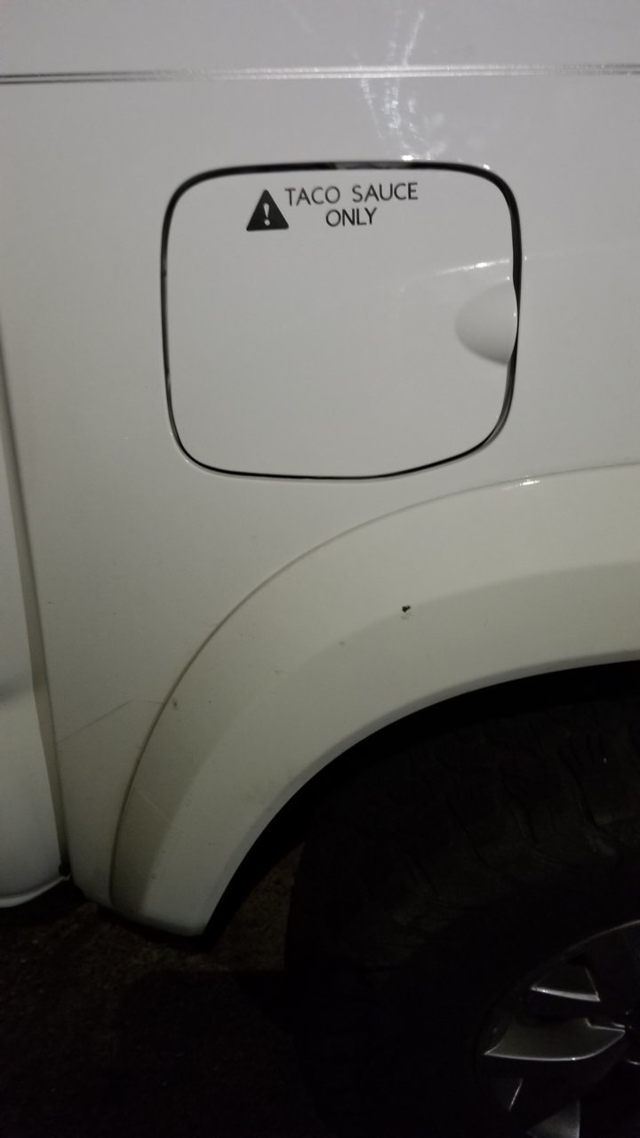

    Bad night time pic, but just checked the mail...saw this on here a week ago, and had to get one from ToyoDecal on Etsy.

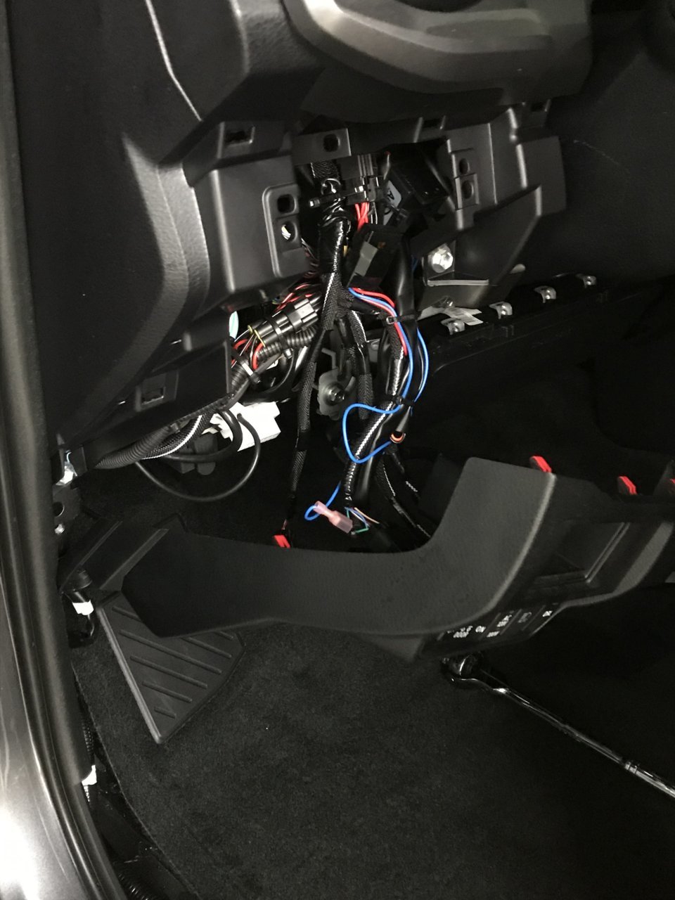

    Finally finished removing my original/stock 2n1 led/fog lights ie harness/switch (will put up fs later).
    Wasn’t bad pulling the kick panels and dash as I was thinking.

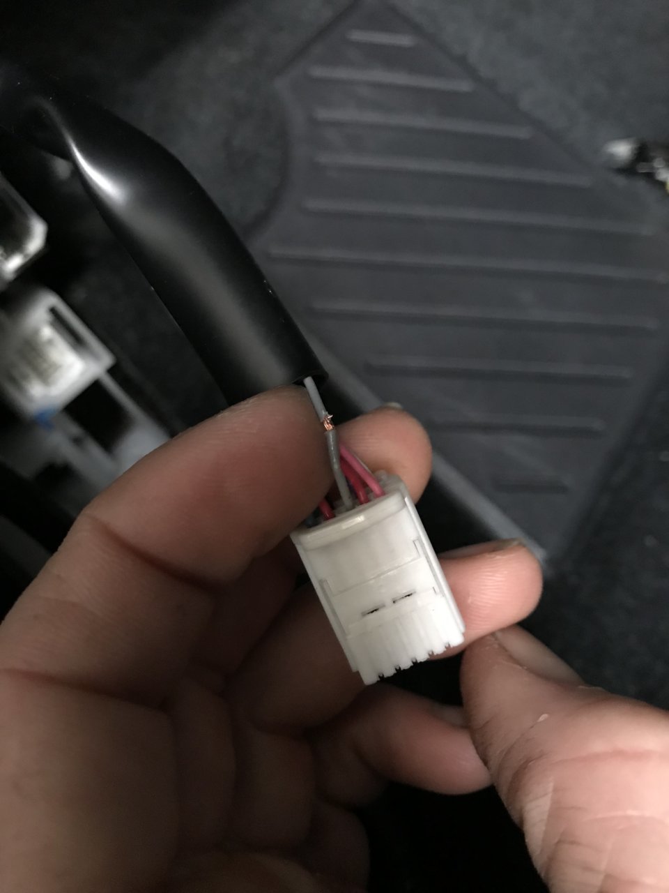

    This is why I hate t-taps- they cut a couple strands of wire. I put some liquid tape over it but would like to fix this (pull terminal cut/add/solder and reinsert). Anyone know what this plug/wire is for (in case I have any connection issues)? Says it’s the ic3 connector pin 8 grey wire. 3rd up from the bottom
    Now I need to either get a blank switch to cover the hole or finally decide on a button layout and get a @mesojdm custom panel
