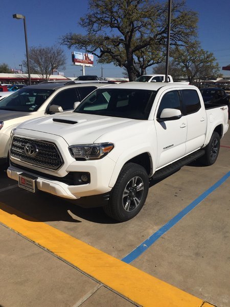

    Picked up this baby today. So excited about it.

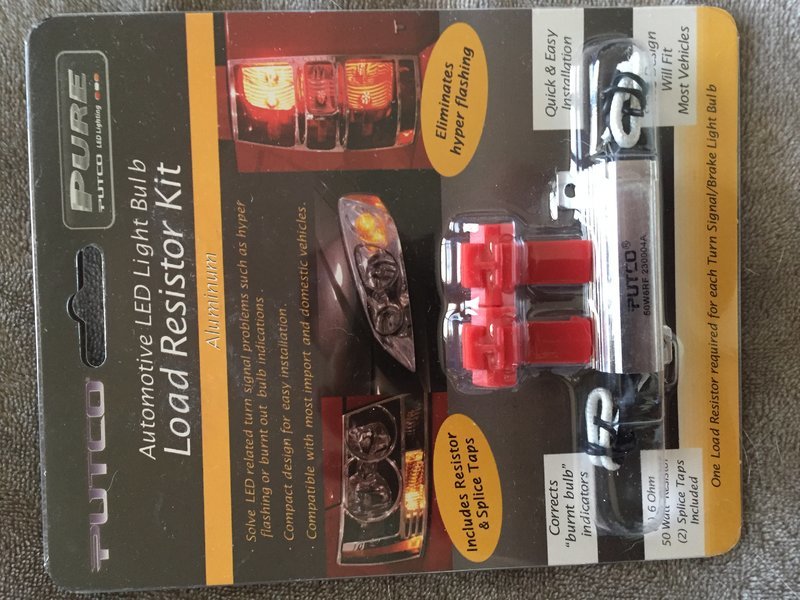

    Hey, I replaced my turnsignals with same bulb and im getting hyperblink. doesnt matter if the lights are on or off, drls, or just fogs... they work fine for lock/unlock, hazards, and right side but not for the left. are you having any problems yet?

    There is no turn signal relay on the 2016s. LED bulb draw less volts so your truck thinks the bulb is burned out. You have to install a resistor on turn signal bulbs if you use LEDsimage.jpg
    Also check when your turn signal is on that your 3rd brake light on the cab doesn't flash. If it does your bulb is in reversed. LEDs are polarity sensitive. You can get away with brake lights and reverse lights with no resistors but not turn signals. If you do brake lights check when you turn on just your running lights that the 3rd brake light doesn't come on. If it does polarity is wrong and your truck will go into stall mode because it thinks your stepping on the brake and accelerator at the same time. I think superbrightLEDs.com or one of those companies gives a tutorial on putting in LEDs. Or if you do a search here there is like half a dozen threads on putting in LEDs. . If your going to do LEDs I would recommend VLEDS tritons. More expensive but guaranteed for life. Very bright and the company is great. A few vids on YouTube might check out. One last thing. Resistors get hot. Don't let them touch anything that could melt. Line insulation of other wires etc. gorilla makes a heat resistant mounting tape you can get at most hardware stores to stick them to something metal.

    Thank you very much for the info! If I change the bulb around, it doesn't even come on so I didn't think to check any other parts/lights. I just put them in the way I think they go, if they don't turn on, I switch them around lol

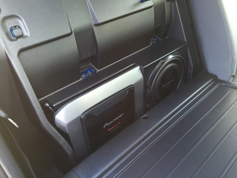

    I installed a sub.

    How's the sound quality? Link to the model or where you bought it? I'm looking for a similar solution - nothing overly powerful, just something to add a little more bottom end.
