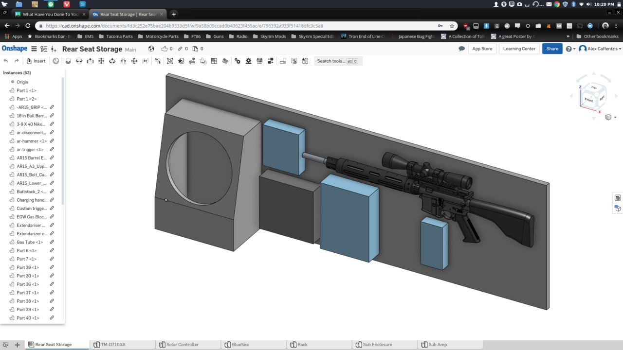

  15. Apr 6, 2019 at 8:13 PM
    nola_jim
    nola_jim Well-Known Member
    Nov 25, 2018
    #273827
    170
    Jim
    New Orleans
    2017 Toyota Tacoma Off-Road, 6 Speed MT
    Cosmetic
    3D scanned the rear-seat storage areas today and will start designing some new organizers or shelving system for them. It was time to straighten out all the junk back there.
    Any suggestions for how to best use the space back there?

  17. Apr 6, 2019 at 8:29 PM
    BEAR_KNIFE_FIGHT
    BEAR_KNIFE_FIGHT bearly famous
    May 21, 2016
    #187524
    2,627
    Alex
    Minnesota
    2016 TRD OR 4X4 DCSB Slowsand, 2017 WRX WRB
    I'm building a full replacement system for back there -- subwoofer, amp, uhf/vhf box, solar mppt controller, gun.
    You know, the basics.

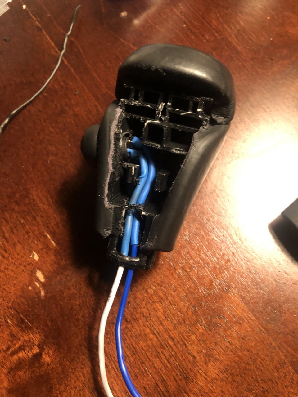

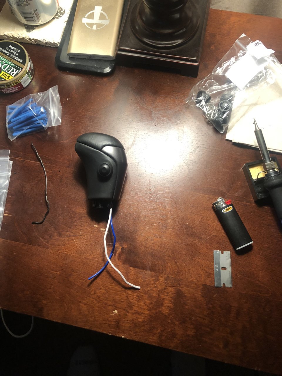

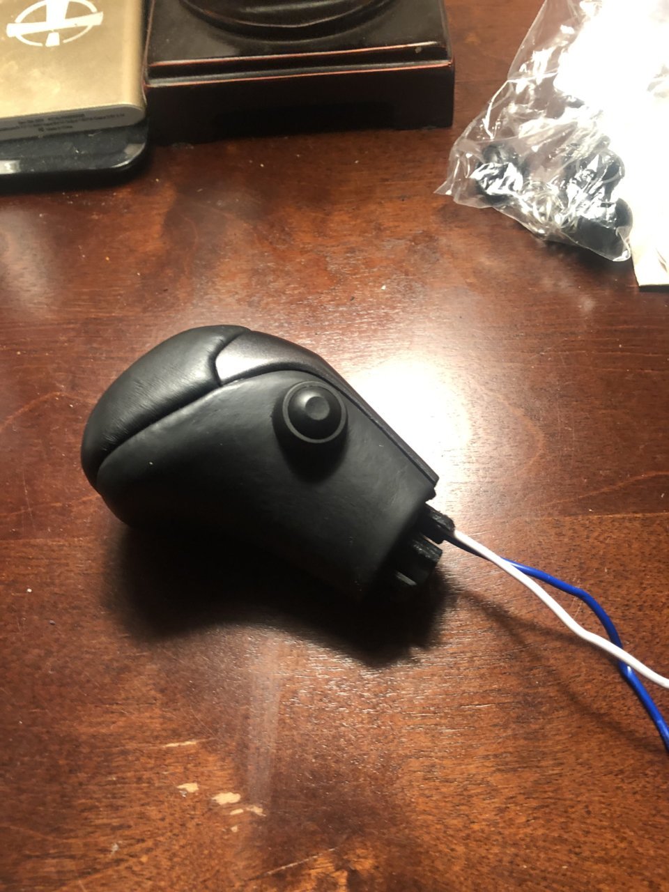

  19. Apr 6, 2019 at 8:47 PM
    PapaRee
    PapaRee Pro Tuner
    Oct 31, 2015
    #168275
    3,250
    Kreg
    Prairieville, Louisiana
    2016 Black TRD Sport, Tuned, BHLM OEM LEDs
    GTS Dobinson's lift, 33"-Wildpeak Atw3-18x9 -6 Offset ,265/70/18 tires, Raceline Assault wheels, Backflip G2 bed cover, Magnaflow exhaust, Pro tail lights, Pro fog lights, Pro grille, Raptor grille lights, Predator side steps, RedLine Hood Struts, Toyota bedmat, tinted windows, Retrofitted-BHLM-Amber Halo-Amber DRL-HID headlights, LED Highbeams, LED Hood Scoop lightbar, LED hidden bumper lightbar, LED under hood light, LED Bed lights, LED license plate lights, Tacoma tailgate 3d letters, Tacoma glovebox 3D letters, removed air dam, Custom TRD Sport emblems, Pro Shift Knob with Meso ECT Stealth button, Meso LED dome and map lights, Meso V3 smoked mirror turn signals, Meso Stage 2 Tail lights, Meso Mirror Puddle lights, Meso KC-5 Brake/Cargo light, Meso center console bucket with OG lid, Tailgate PNP kit, Garage door opener button in overhead console, Meso Minimalist keyfobs, Matte black Pro hood decal, KTJO4x4 Led door handle LED lights, Pioneer 6x9 3 way front speakers, Rockford Fosgate 6.75' rear speakers, TacoTunes tweeters, AJT black vent rings, JDM Gas cap cover.
    Got my little push button momentary switch in today and wired up my ECT switch on my shift knob. Solder and shrink wrap on my connections.
    Pulled the ECT button out and tapped into pin #1 and #4. Ran my 2 wires under the wireless charger, into the shift boot and up to the shifter. Then put it back. Works like a charm. Don’t have to take my eyes off the road to push it.
