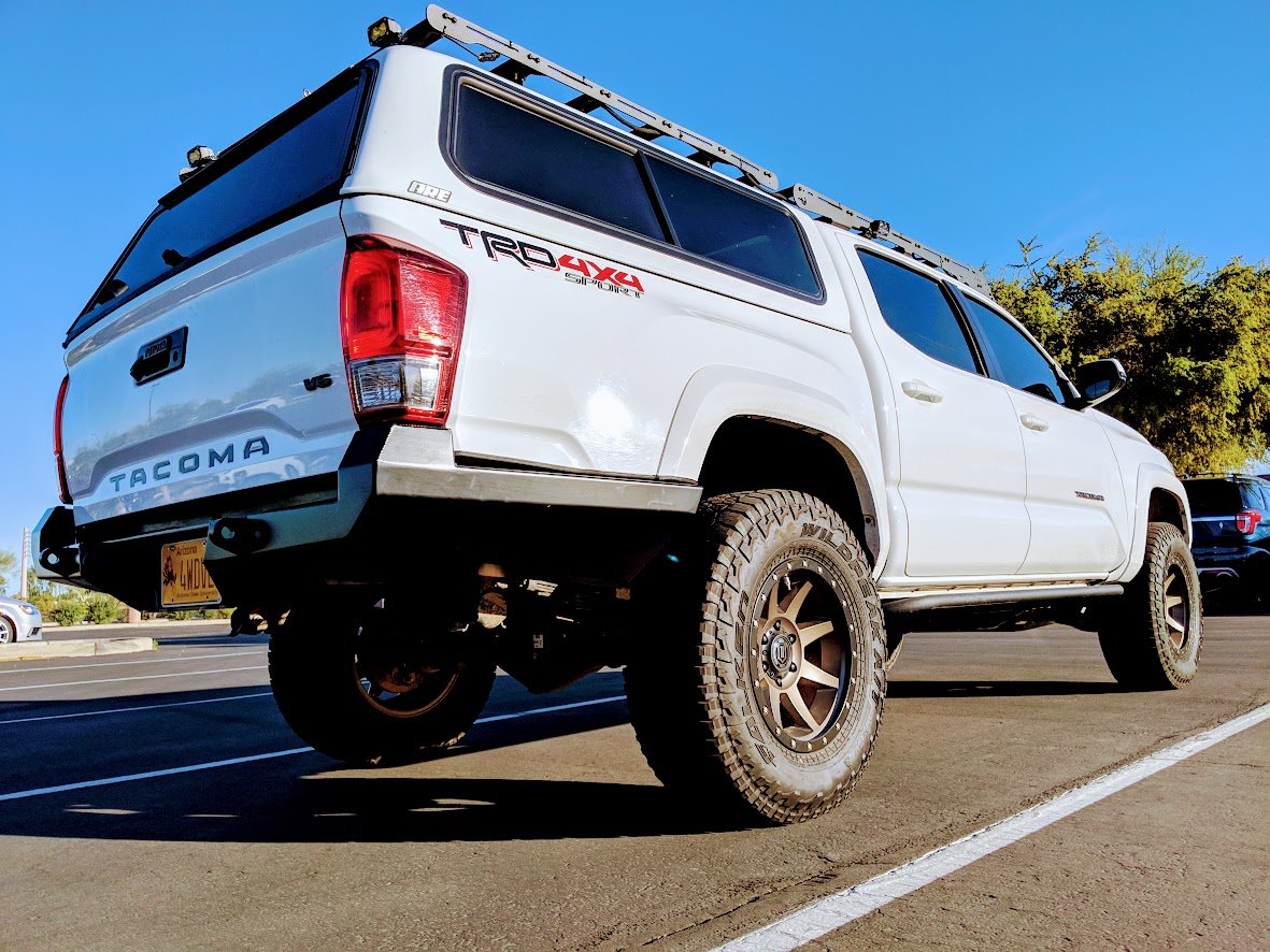

    Did away with the bedsides for a CBI high clearance rear bumper

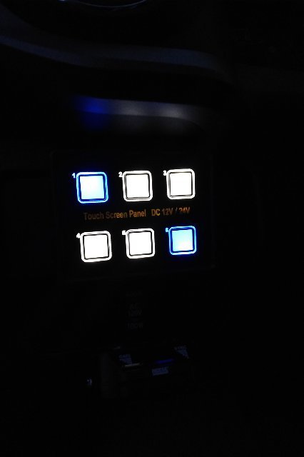

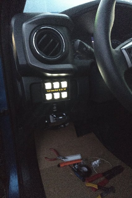

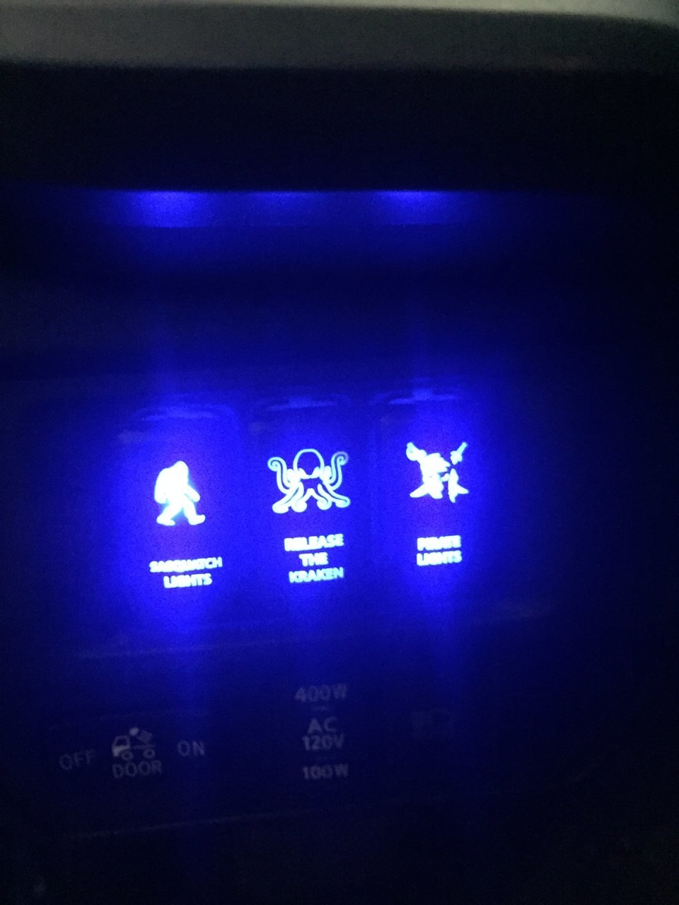

    I installed this soft touch controller instead of using rockers. Just need to label the buttons still.

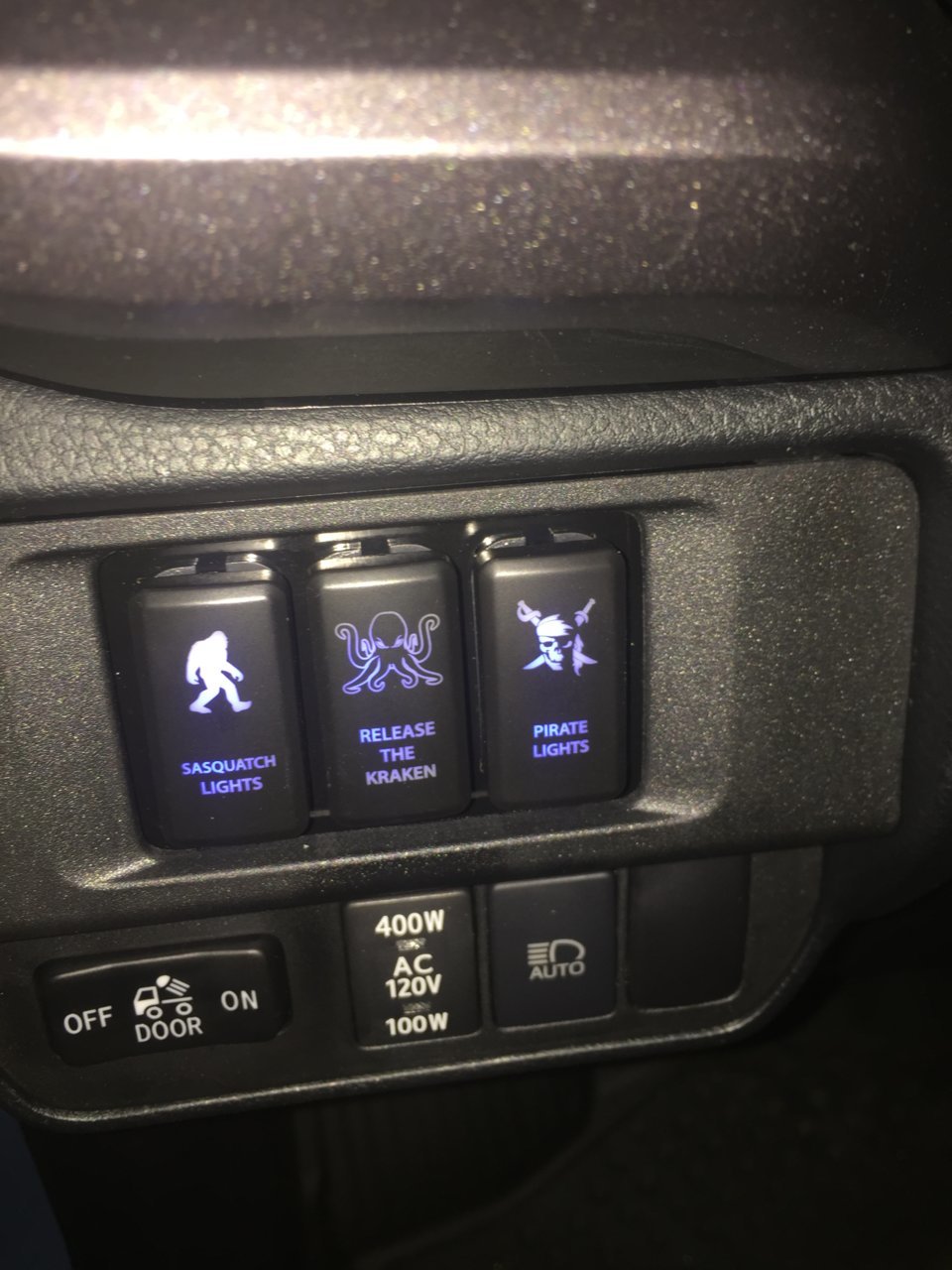

    My switches are not rocker, they are push switch. Good thing about yours is the option that you can hook more stuff. I still have one more in the bottom at original blank spot and if I need to add something in the future I can use that.

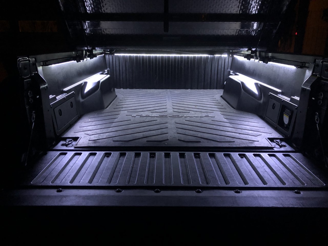

    Installed a Pro Skid and some of MattGecko’s bed lights tonight. Took a while, but ran ground back to the battery with the positive cable instead of putting a hole in my frame for chassis ground.

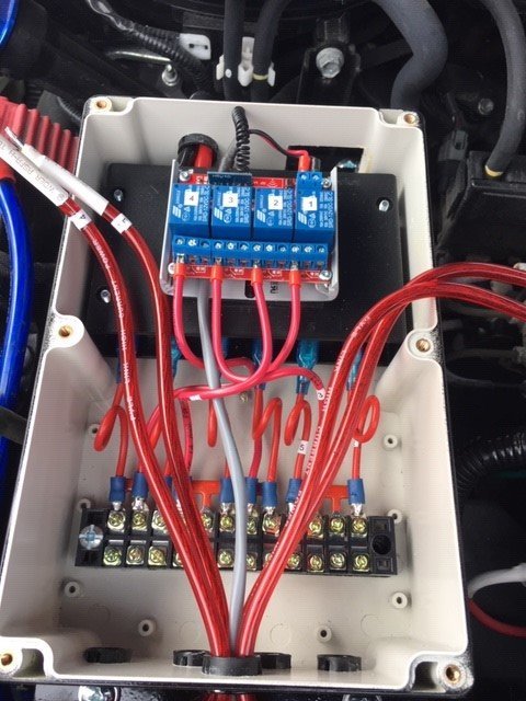

    Hopefully not to much to ask but can you show a close up of the shock mounting points and also a pic of the hood partially closed to see where it is going to rest when the hood is closed?
    This is what I'm needing to know. Will it clear my fuse block mounting point(I utilized the same holes as a clutch slave mounting bracket)

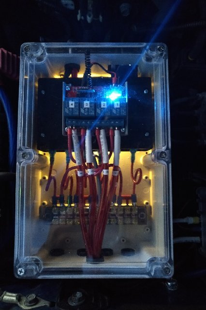

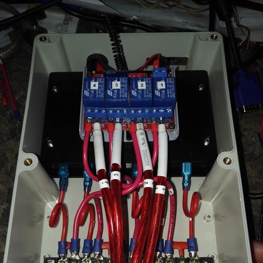

    The soft touch controller I installed connects with a VGA cable to a 6x relay module I installed in a project box under the hood.

    The 6x relay box is the black unit. The blue relays are Wifi triggered!!! Tested tonight at about 50' with the hood closed. Gotta love Amazon for cool stuff.

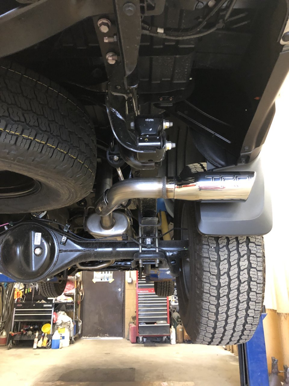

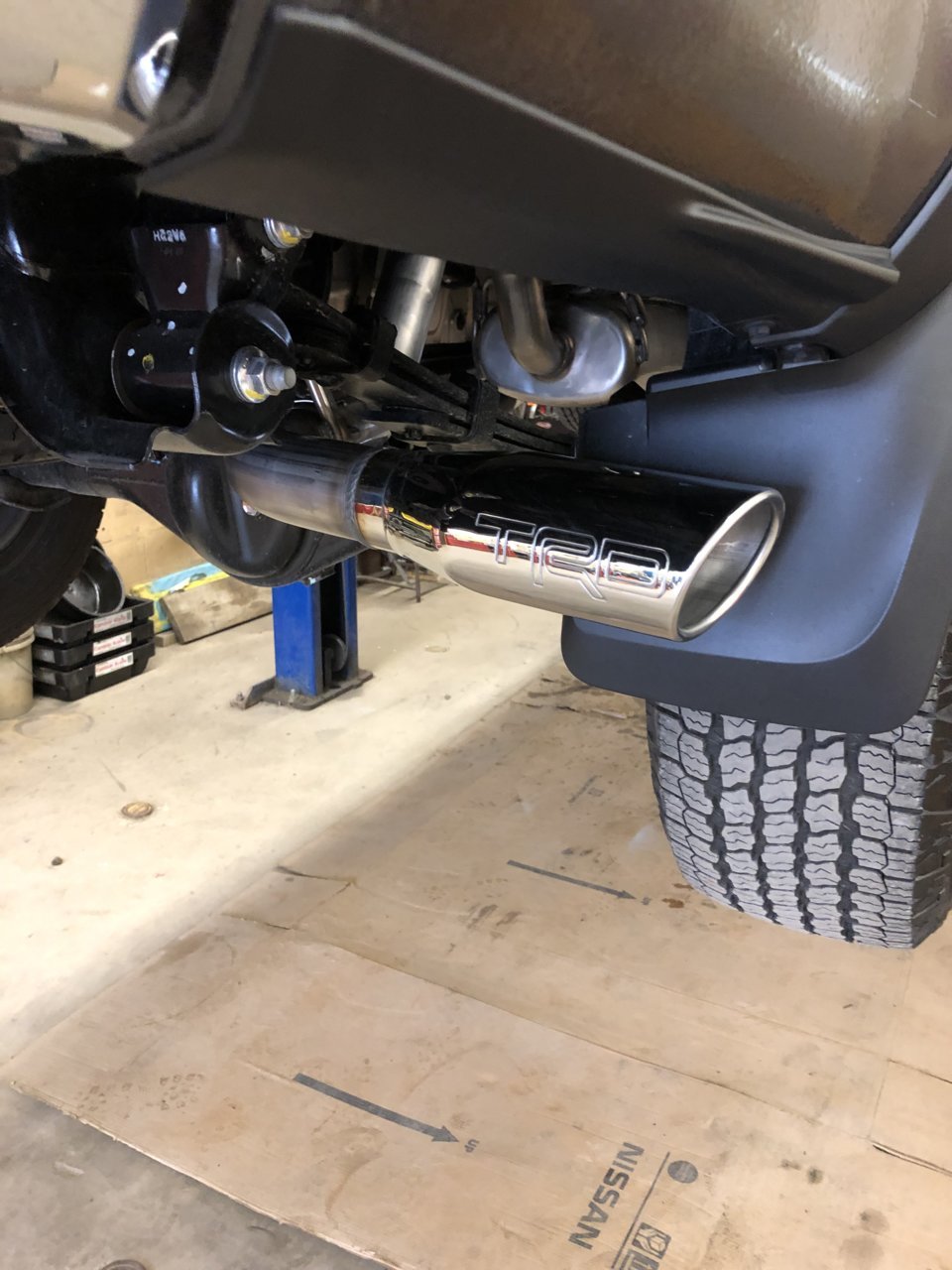

    It’s what would be considered a catback. It’s basically a mid pipe, muffler, tail pipe and tip all in one. It bolts on right after the two exhaust banks converge into one. And no it doesn’t come with a gasket or hardware. You reuse the isolators and the bolts. Since my truck only has 650 miles on it I reused the gasket but you may want to get a new one if your truck has more miles on it.

    I installed it today and I love the sound. I wanted something quiet but with a little more tone when you romp on it. It’s just loud enough to be satisfying without being annoying. But man does it look good tho.... upload_2019-4-8_23-27-14.jpg
