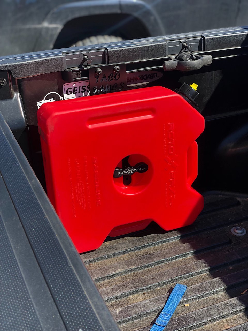

    Made my own mount and installed a 3 gallon Rotopax. D892F961-A0E2-443B-8C65-586FBD76F978.jpg

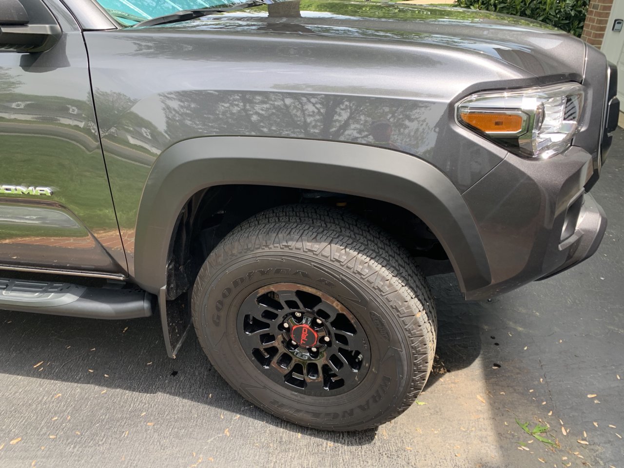

    Added the Tacoma TRDwjpNqQNBQHme3gTXhcIHiQ.jpg Pro wheels today.

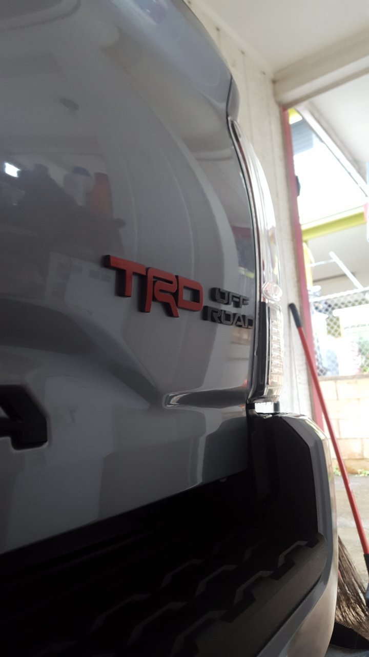

    Believe it or not, I had to fight a Veloci[Ford Ranger]raptor to get the two side badges. The rear ones were my reward.
    Jk I got the side emblems from @runnin4tacos. I think they got a sale rn on it btw

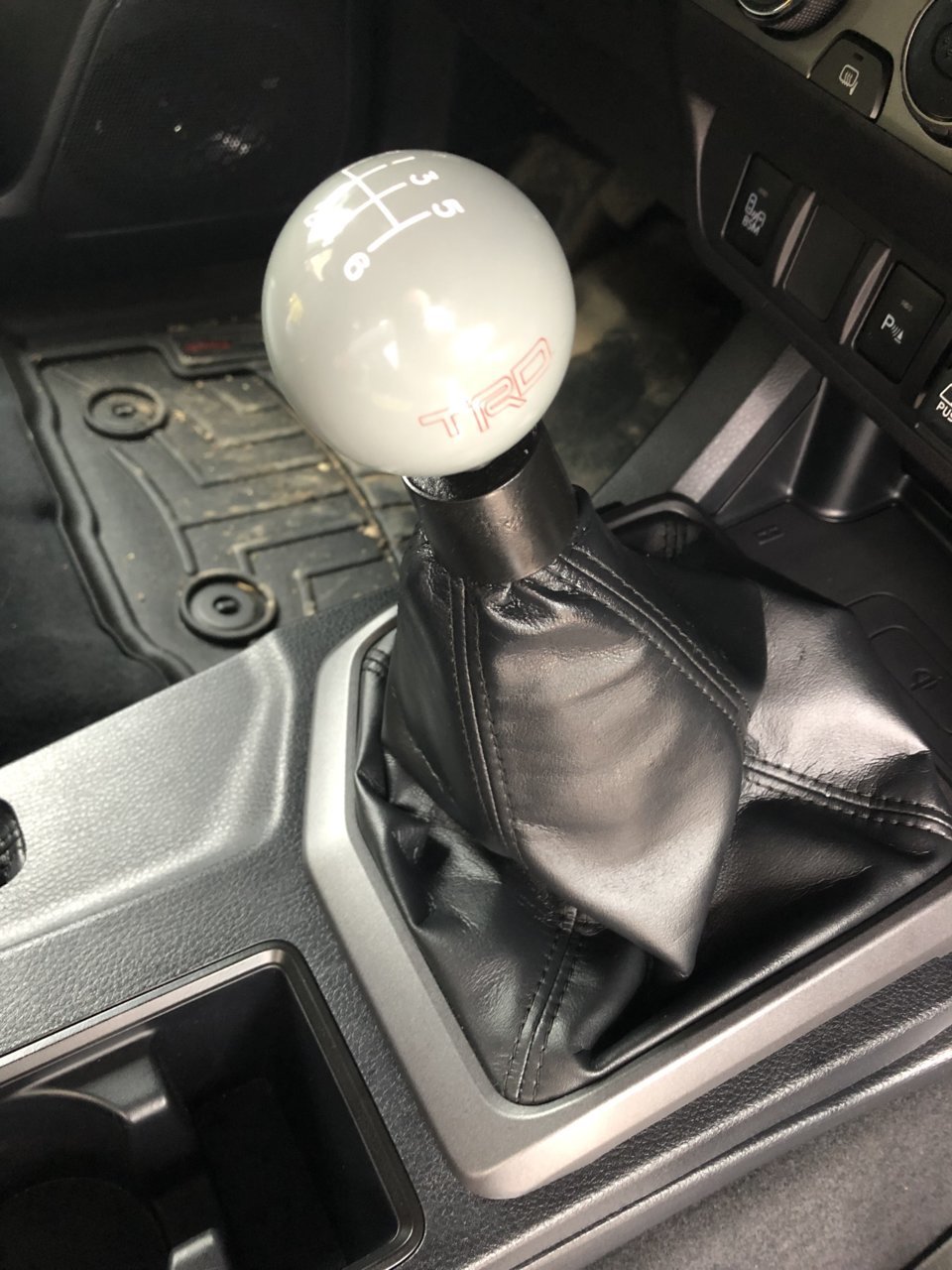

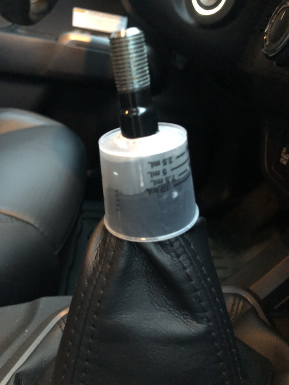

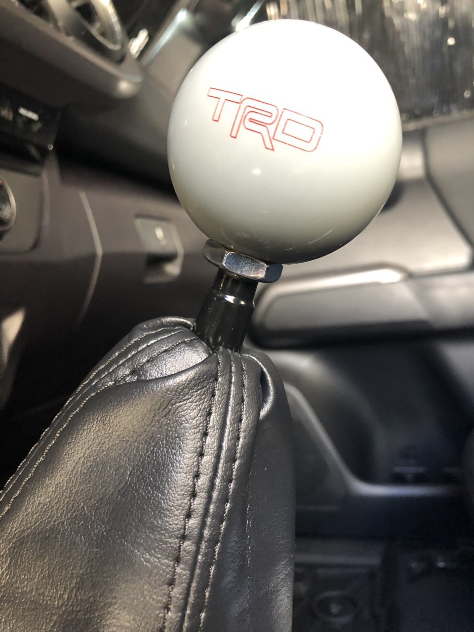

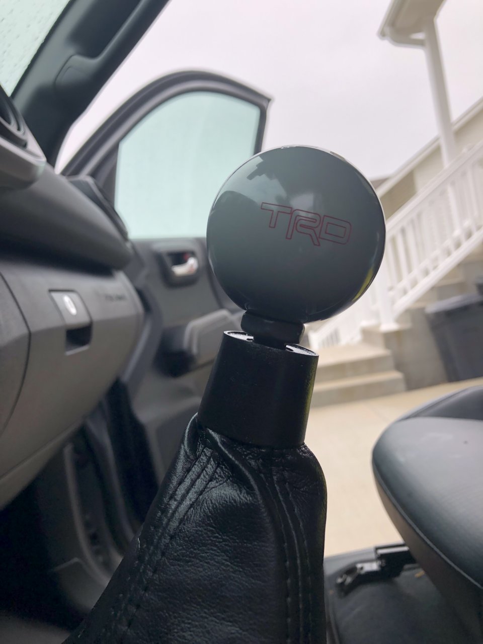

    It's taken a while, but I finally came up with a solution.
    Well, a couple months ago (I just couldn't wait any more) I installed the FJ Cruiser TRD Pro shift knob. I knew I would have to revisit the shift boot, and had been thinking about it ever since. In the mean time, I just zip tied the boot to the shaft:

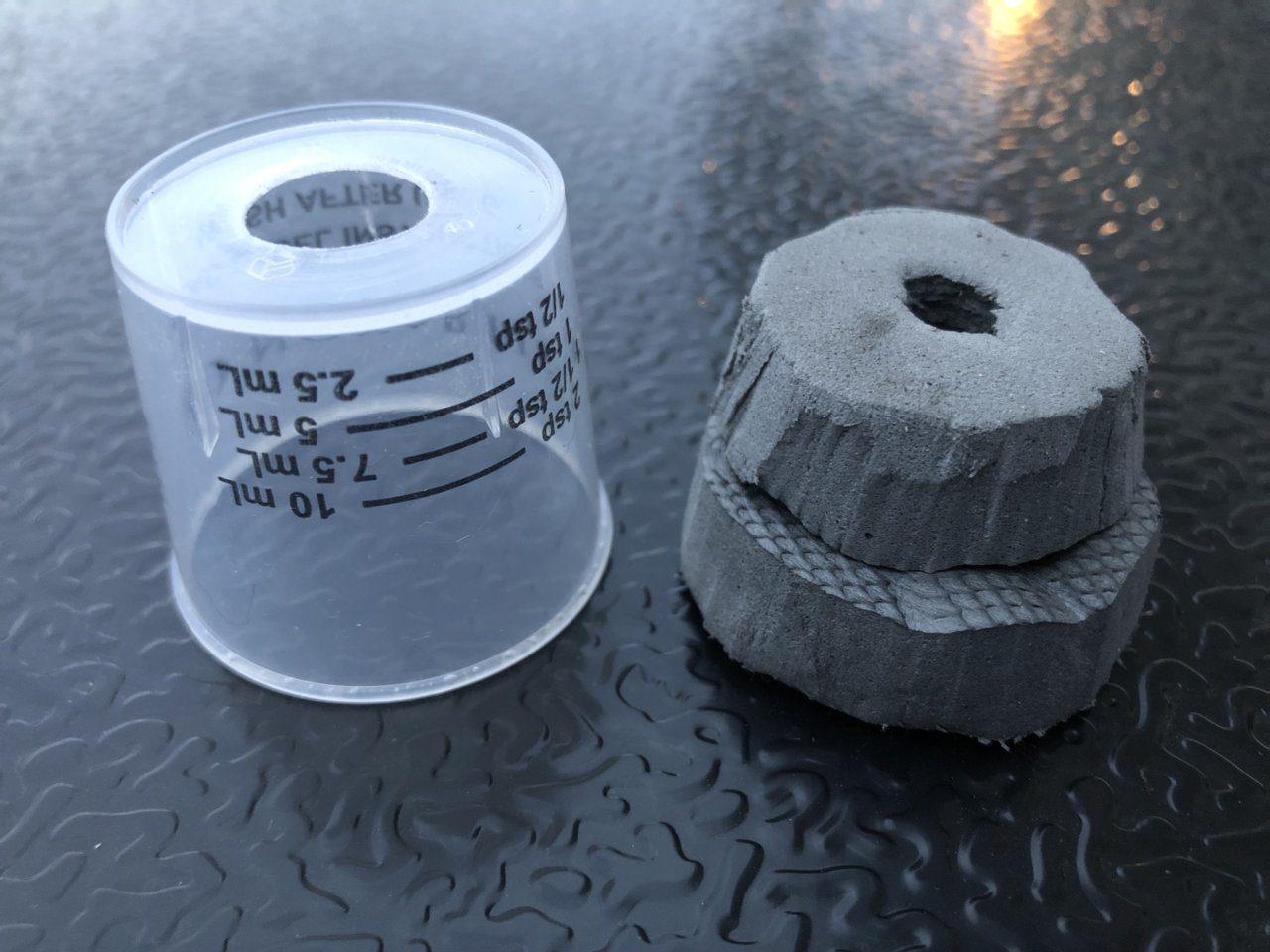

    Yes, it looks like a Walmart granny with her tee shirt tucked into her panties. It just wouldn't do. I also had to do something about that chrome nut (you know, the Toyota war on chrome and all, I had to stay faithful to the cause) I was going to derp the nut, but being eager to eradicate this evil silver stuff, I just slipped a piece of shrink tube over it and called it a day. I finally had an idea as I was dosing out some children's Tylenol to my son. I decided to use a medicine measuring cup to make a collar for the top of the shift boot. I cut a hole in the bottom (now top) of the cup, and cut some fender washers (for lack of a better term) out of a piece of EVA foam (harbor freight anti-fatigue floor mat that I purchased to shadow my tool box).

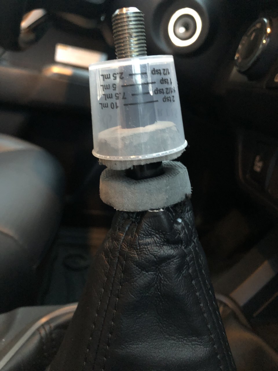

    Then crammed it all together for a test fit:
    Not perfect, but close enough. I then derped the plastic cup, used a little calk to hold it all together, sandwhiched the top of the boot between the two pieces of foam and pushed the cup over the whole thing. Yes, the humidity was high when I derped the cup, so I will probably redo it eventually. End result:
    EDIT: All of you 3D printing geniuses, there's probably a market for a collar that would clip to the stock shift boot collar for anyone using an other than stock shift knob.

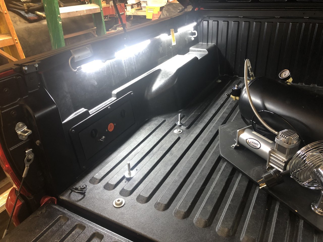

    I wanted more light in the bed when the cover was raised so today I wired up a set of LED strips that I found at AliExpress.. i’m Not fond of pin switches so I used a set of magnetic garage door switches to make the connection. Lots of light back there now. 57B57B9A-A2F2-473B-8A34-8EAC95555831.jpg 09CB8D00-4D58-4A60-BAEA-3D88E20A13A0.jpg
