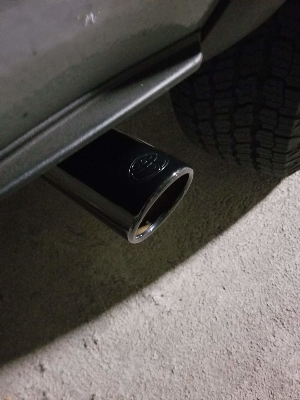

    Replaced the chrome OEM exhaust tip with the OEM black chrome one.
    Also installed the TacoVinyl grille with color matched emblem /w TSS. No more chrome left on the exterior! Loving it.

    Looks good :thumbsup:

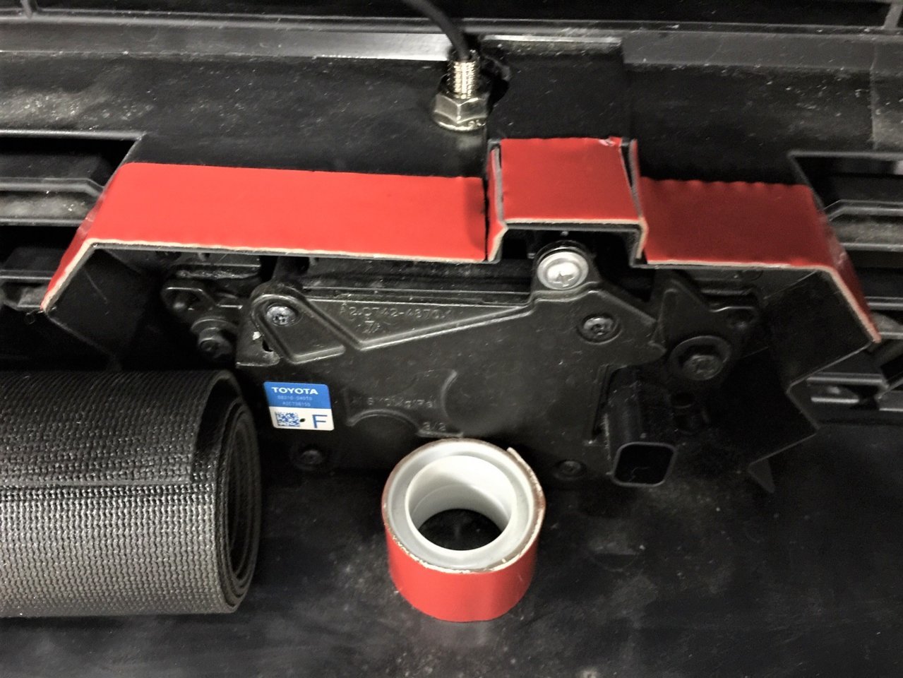

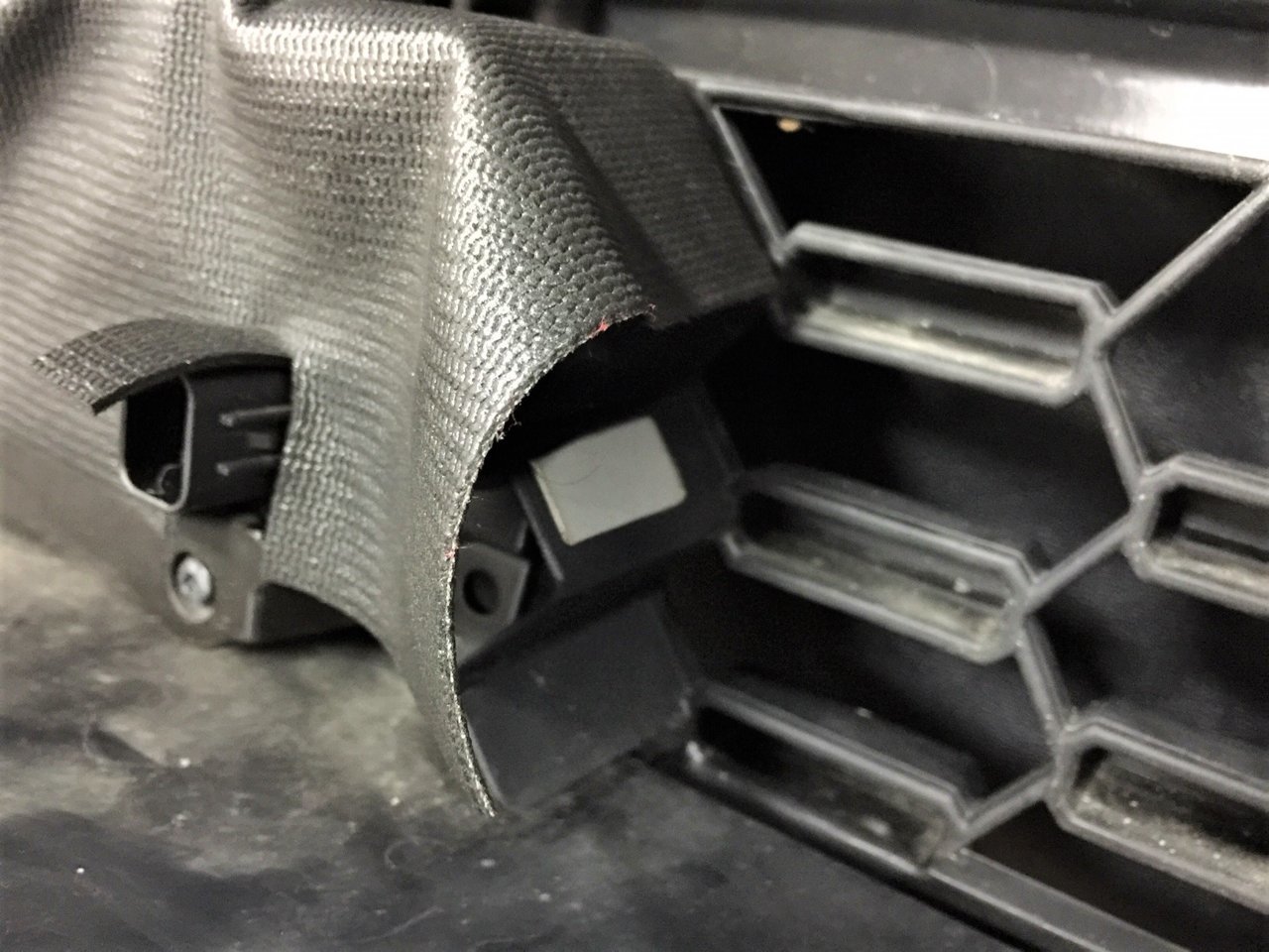

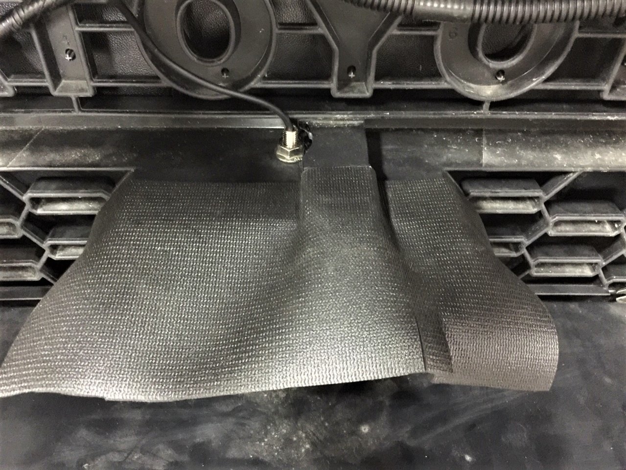

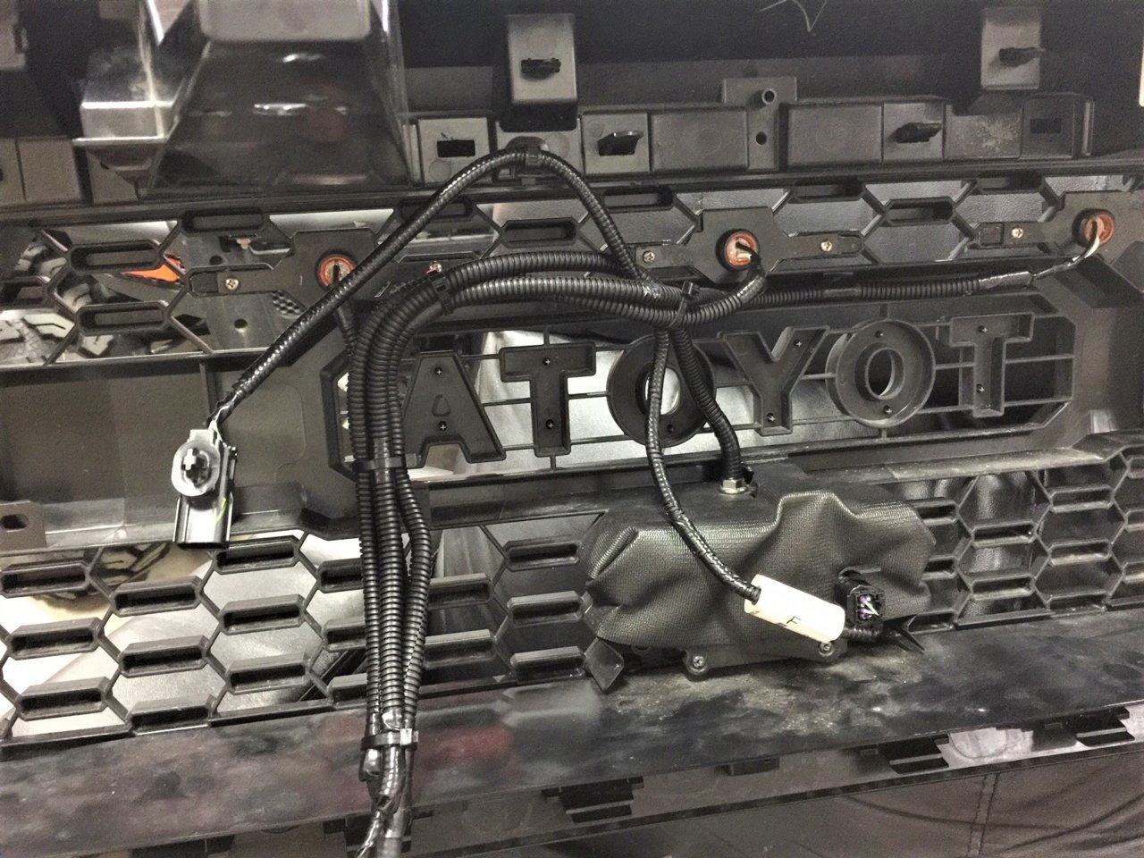

    Since I don't care to engage with dealer BS, I decided to cover my front grille TSS sensor to prevent water infiltration and errors.
    Used a piece of rubber mat and taped it with 3M double sided tape, here's what it looks like.
    Cost: $0.00
    Effort: 15 minutes
    Result: Priceless

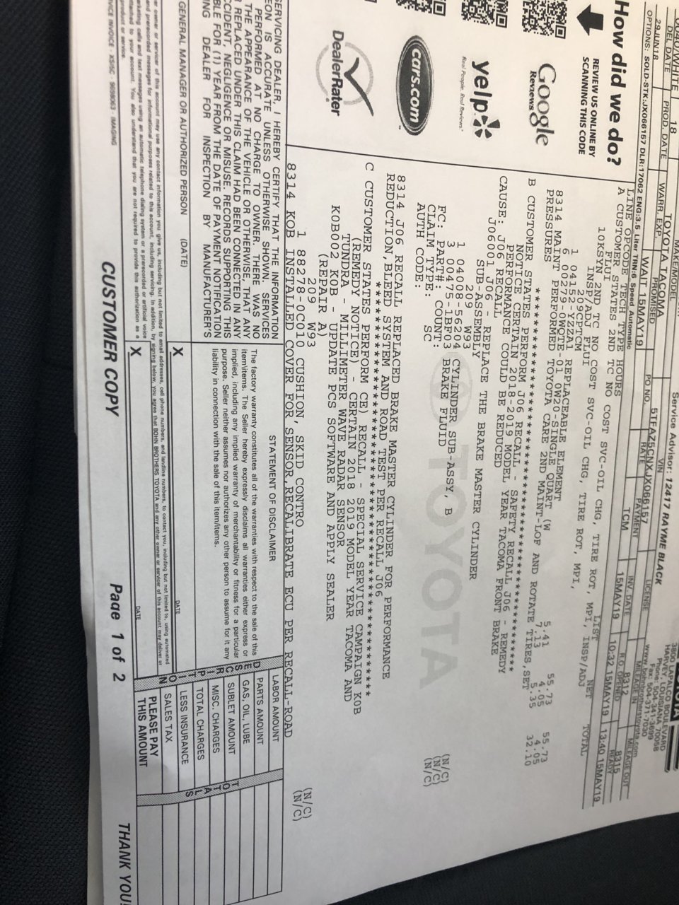

    Yeah im not even sure exactly what was changed honestly.. the tech came out and asked if i changed the grill (which obviously i had) so he could use the right part number.. they also reprogram the sensor but i dont know why bc i had zero issues before ... here is a pic of my paperwork
