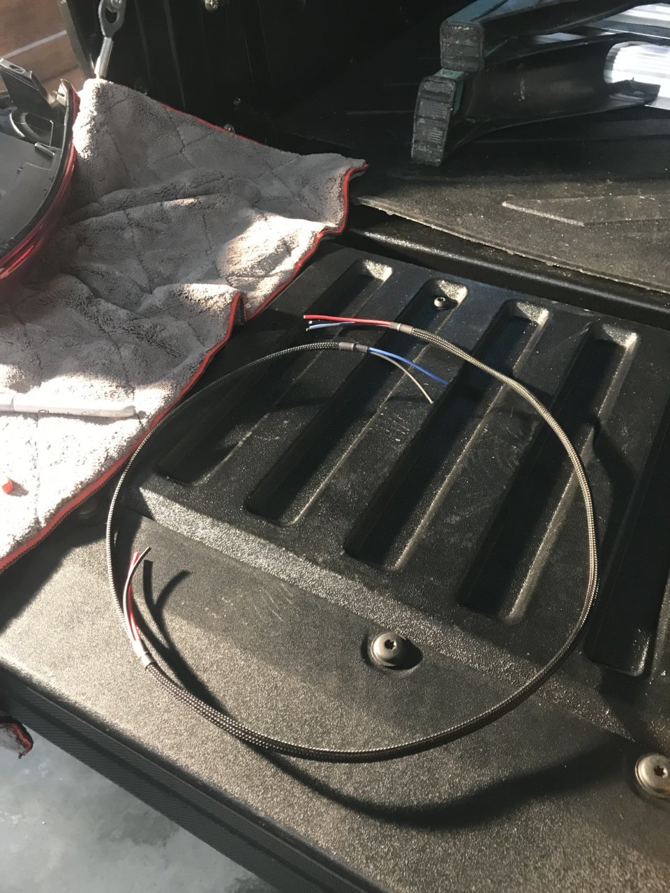

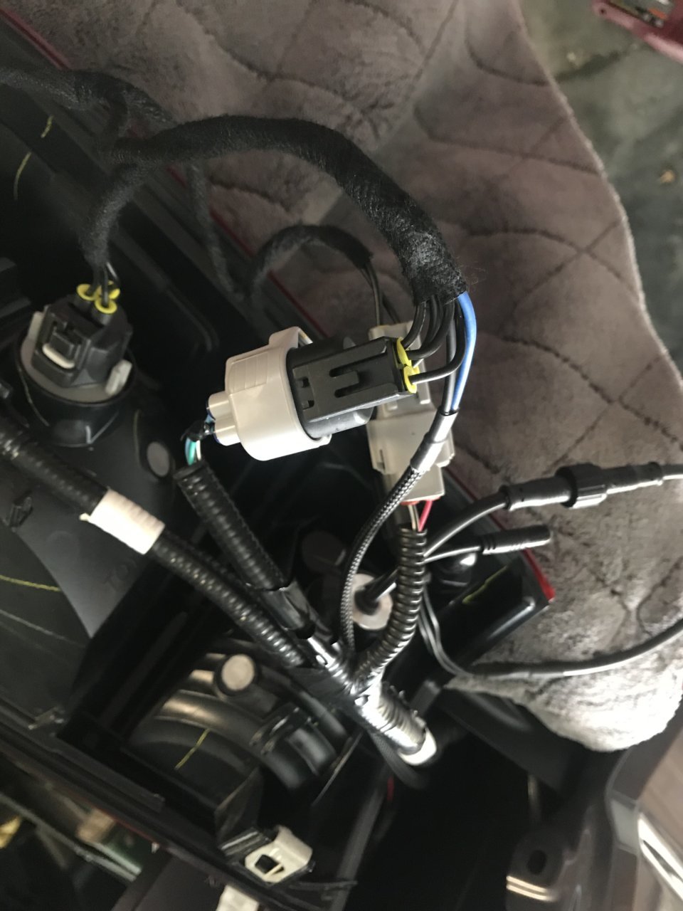

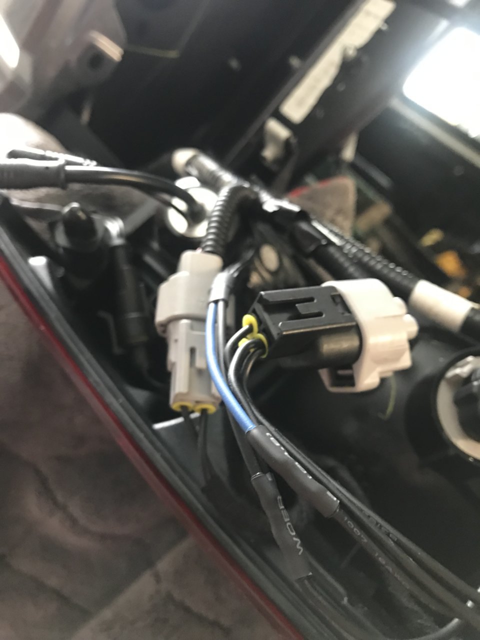

    Finally wired my cap/shells 3rd brake light, only took me 6 months :anonymous:
    I didn’t want to tap into the factory harness so I knew that when I got the totaltail stage2 that’s what I’d tap into. Made up my harness and added another power/ground for future dome lights.
    When I get ready for the domes I’ll tap into the 2 wires that run into the drivers tail and run it to the battery for anytime power.

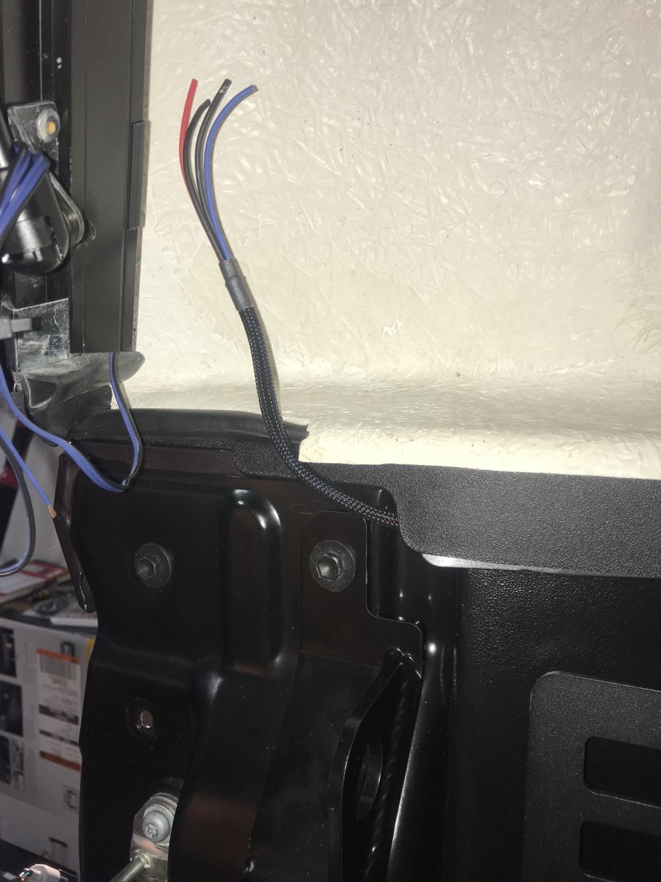

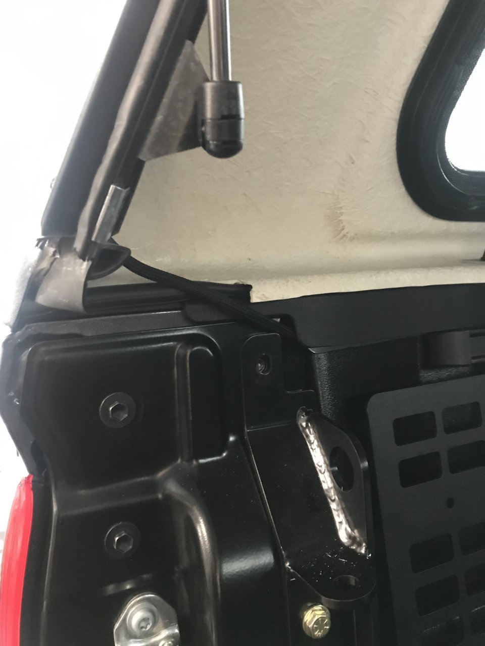

    I want to get a Deutsch 4 pin connector. This is where I fished the harness out, there is a small gap but the harness was thick so I put a 18” flat head behind the metal siderail/lip and opened up slightly. I also took the 10mm bolt out of the top of the total chaos stiffeners Hoping it would widen the gap but it really didn’t. I’ll probably shape the lip back in but leave enough to not pinch the harness.

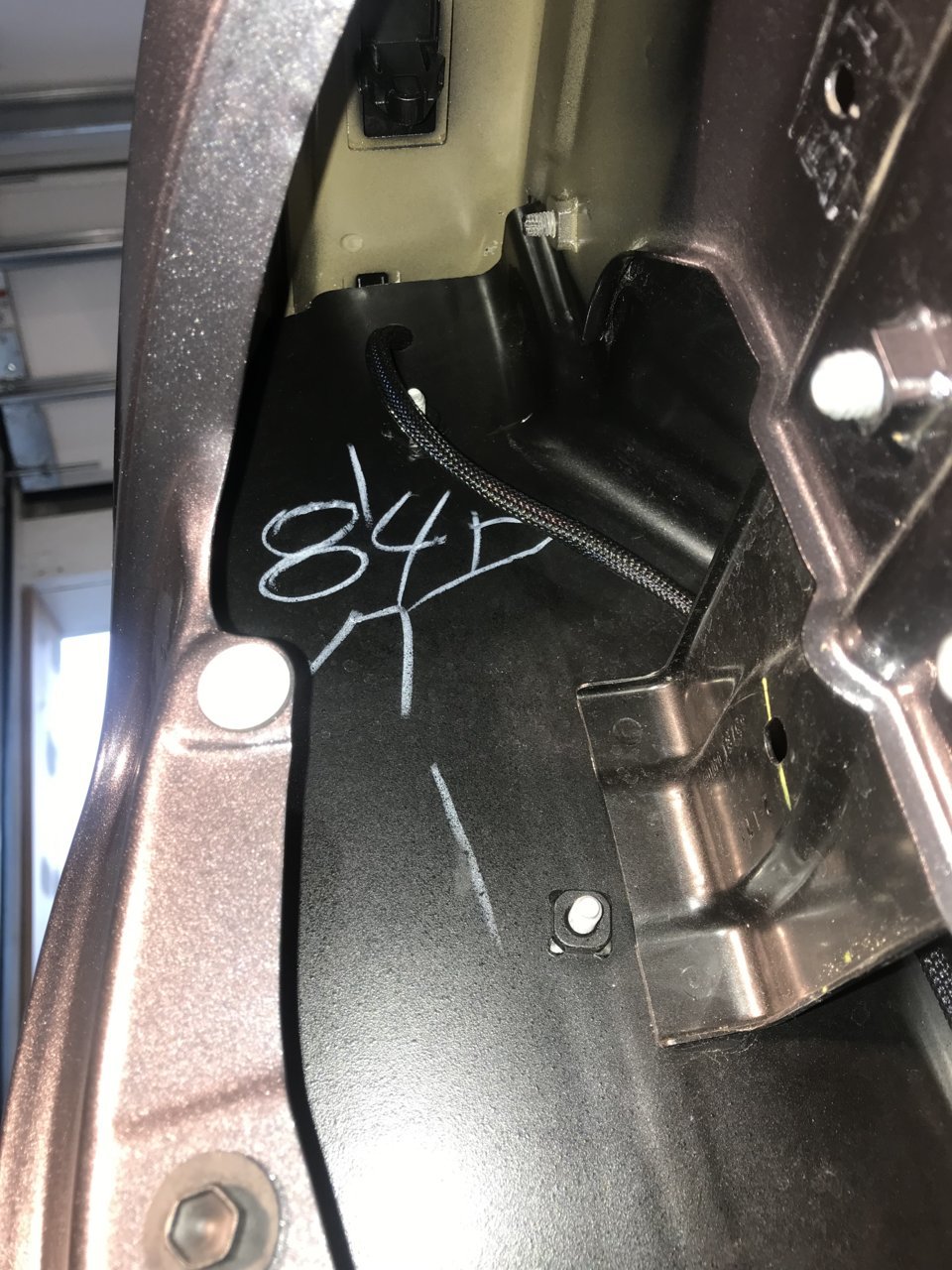

    Ran it through the hole there. Might look into a grommet but not sure if it will work, it was a loose snug fit as it was (if that makes sense)

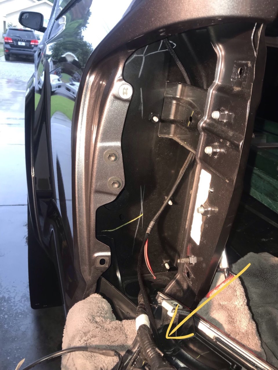

    Ran it behind the bracket and under the taillight harness in the mounting clip on the actual taillight (yellow arrow). You can see the red/black wires that I’ll add to for the domes.

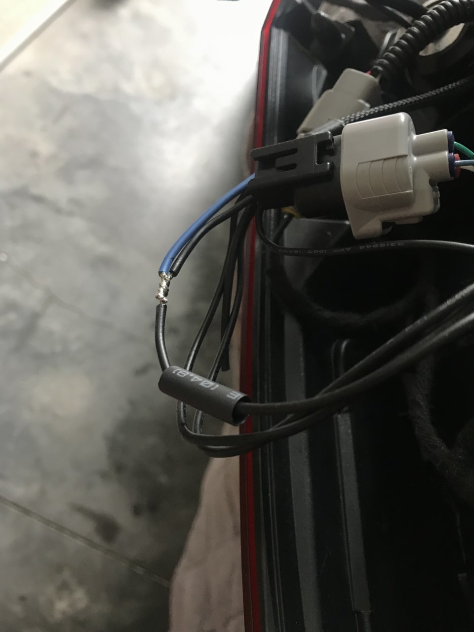

    I removed all the cloth tape for that connector so I could put on an adhesive heat shrink (never leave it close to where your going to solder… ask me why :rofl:). Traced the blue wire to Meso’s harness and cut the wire, slide heat shrink on and solder. Do the same for the white/black stripe. Blue to blue, black to white/black stripe.
    Connections done and sealed.
    Re wrapped Meso’s harness with cloth tape.
    Temporarily connected until I can get those Deutsch connectors. You can also see that bolt I sheared off on the top of the total chaos stiffeners :annoyed: edit: the bolts for the taillights look exactly the same as the one I sheared off and the pt# for those are

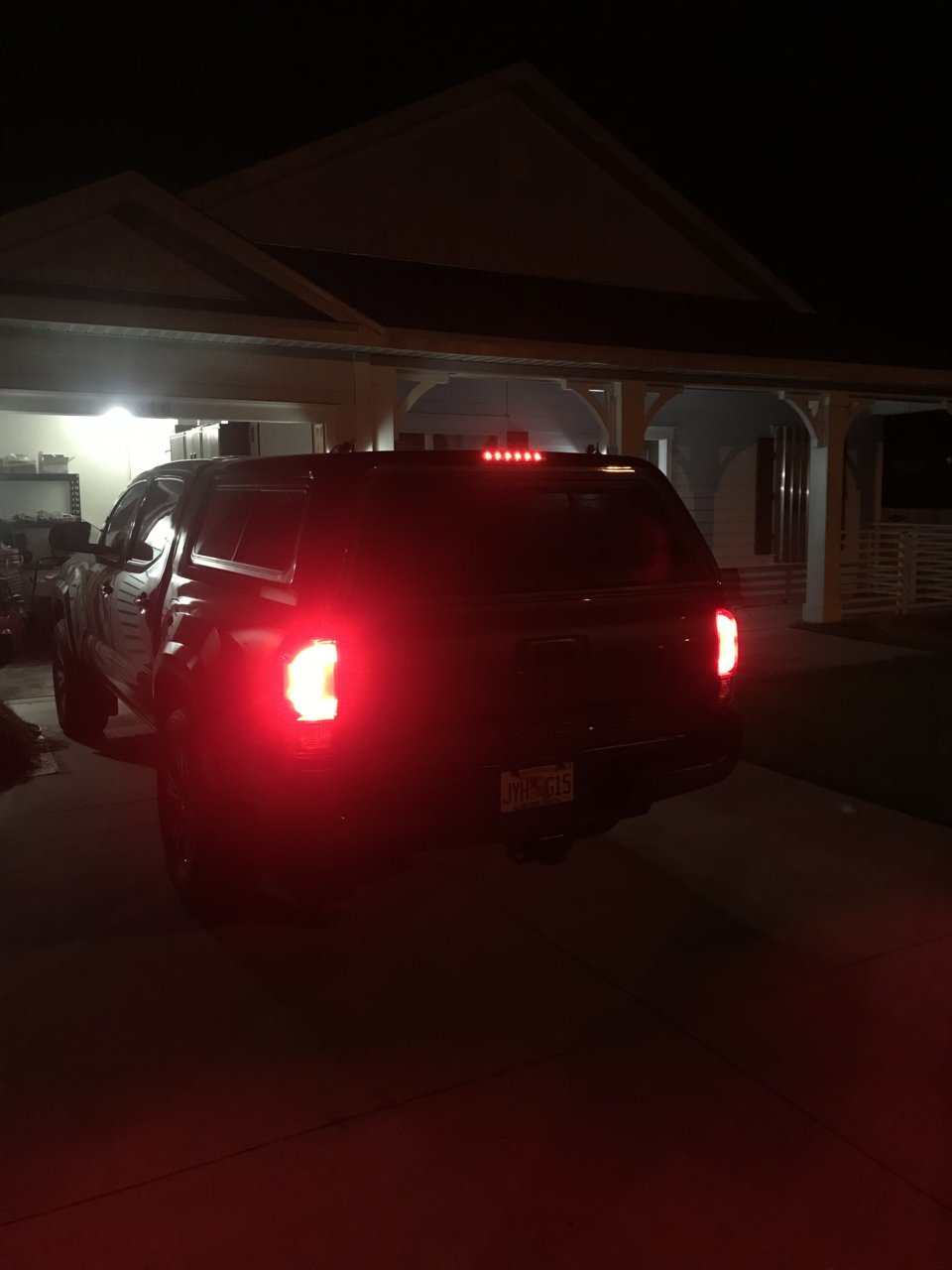

    And done… now I need the Customs in @MESO :boink: that 3rd brake light can be so much better. My birthday is coming soon ;) and I’m ready to be the next creative project.

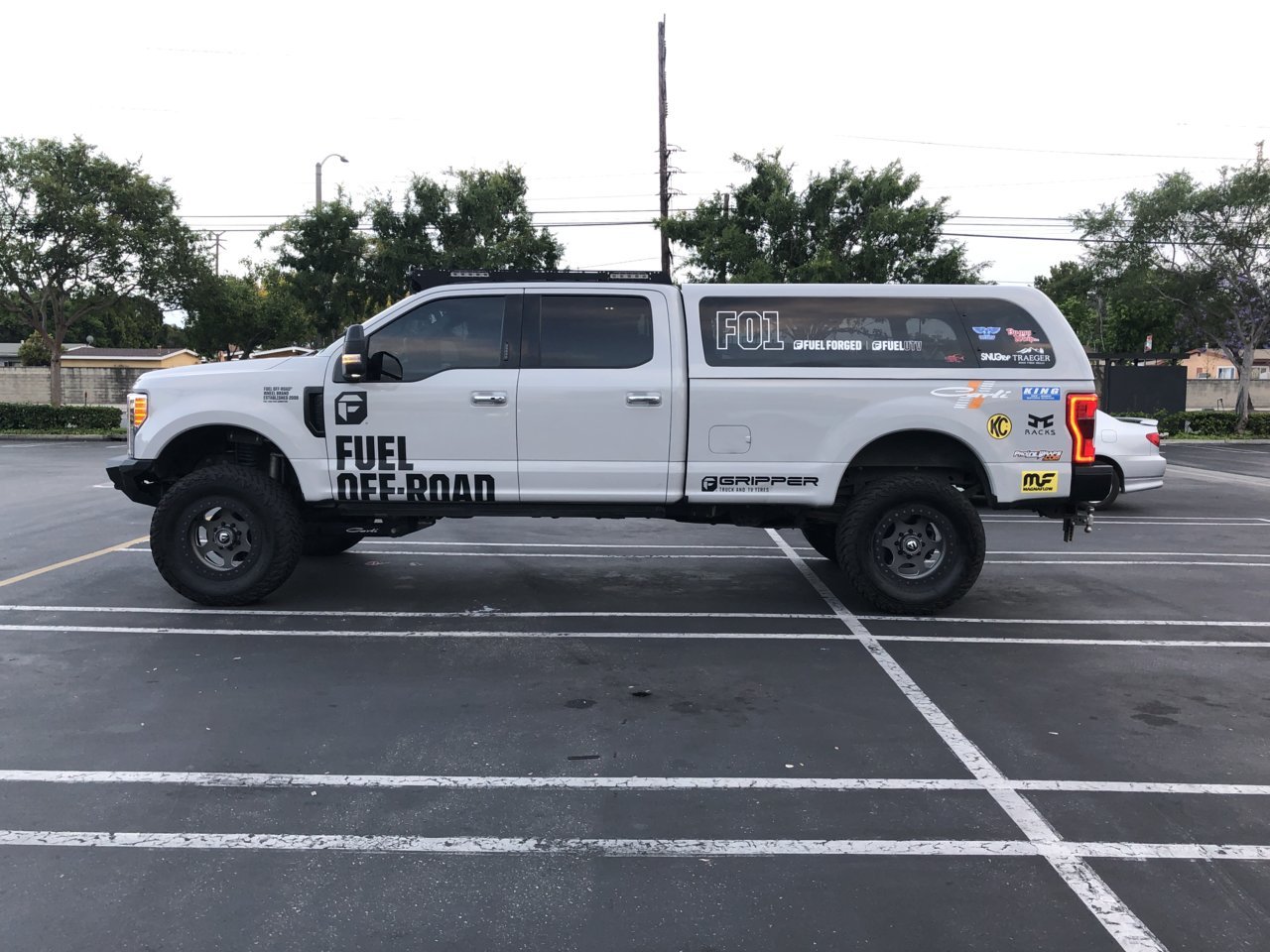

    Will do! I am adding a Four Wheel Camper so my setup should sit about 1 inch above stock ride height with my Icon Stage 6 front coils with 700lbin springs and the stiff rear leaf setup.

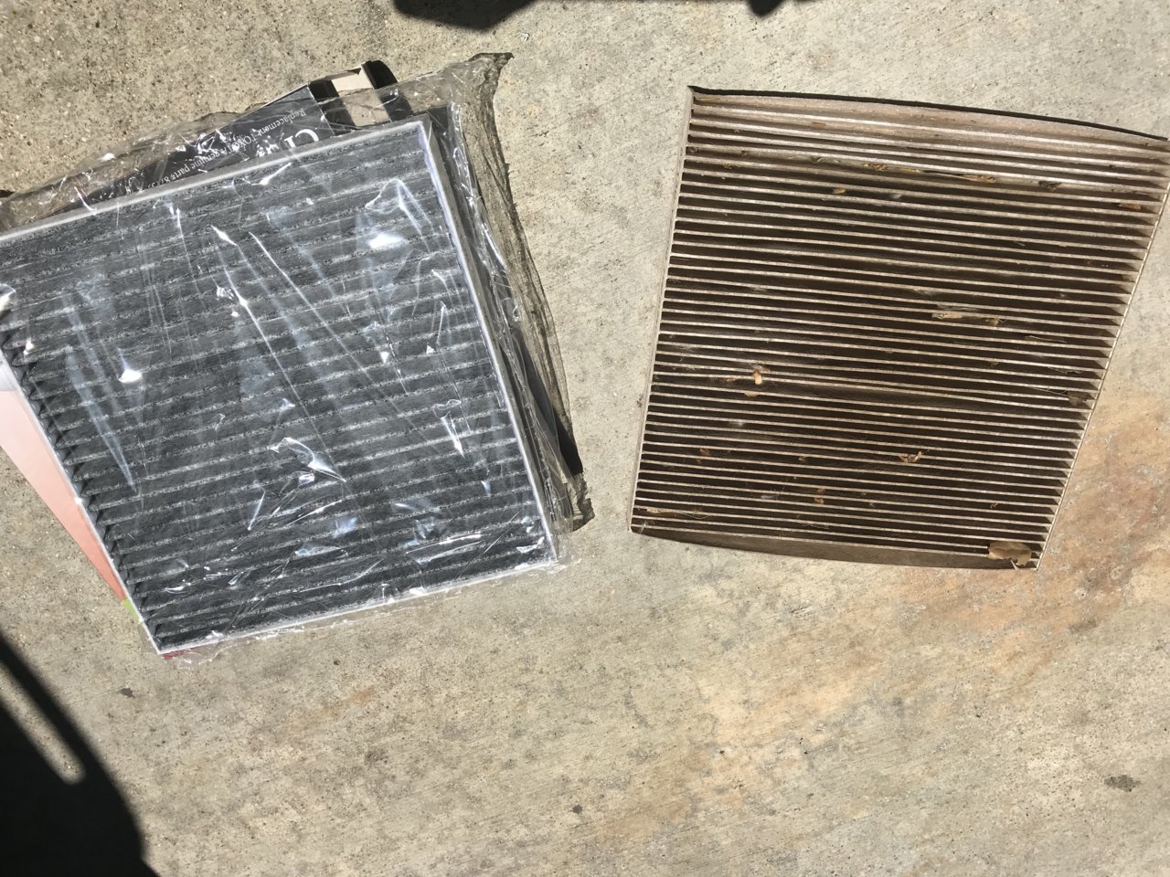

    How many miles on that filter ?

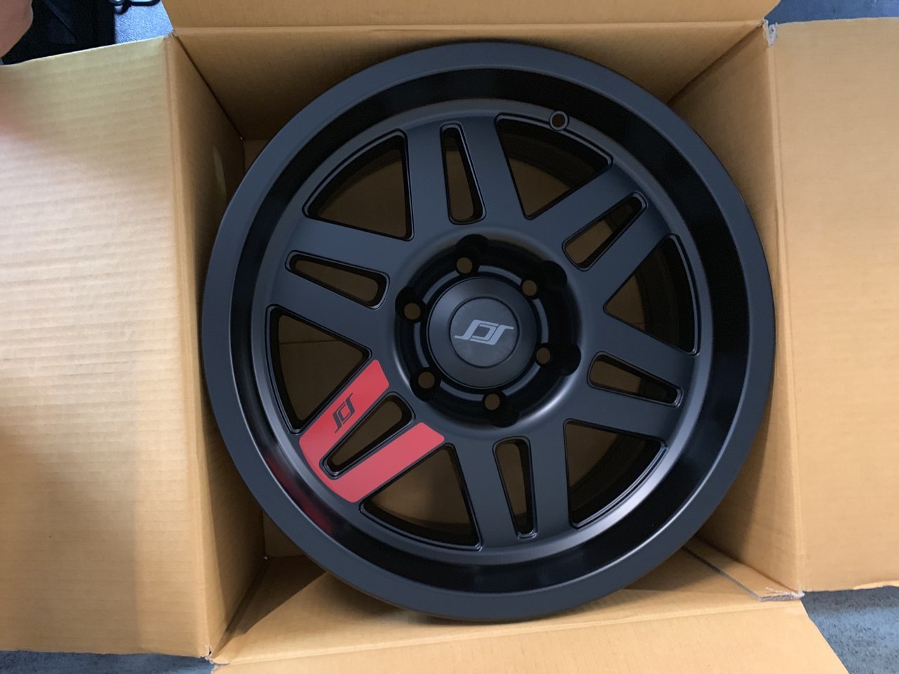

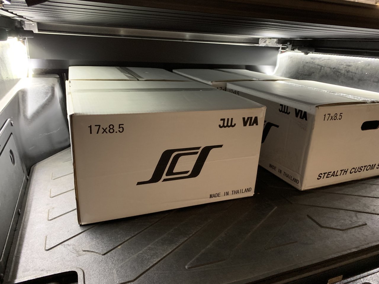

    I can't wait to mount the BFG K02's on these Stealth 6. Got an appointment at the tire shop on Monday...:woot: :woot:IMG_1402.jpg IMG_1403.jpg
