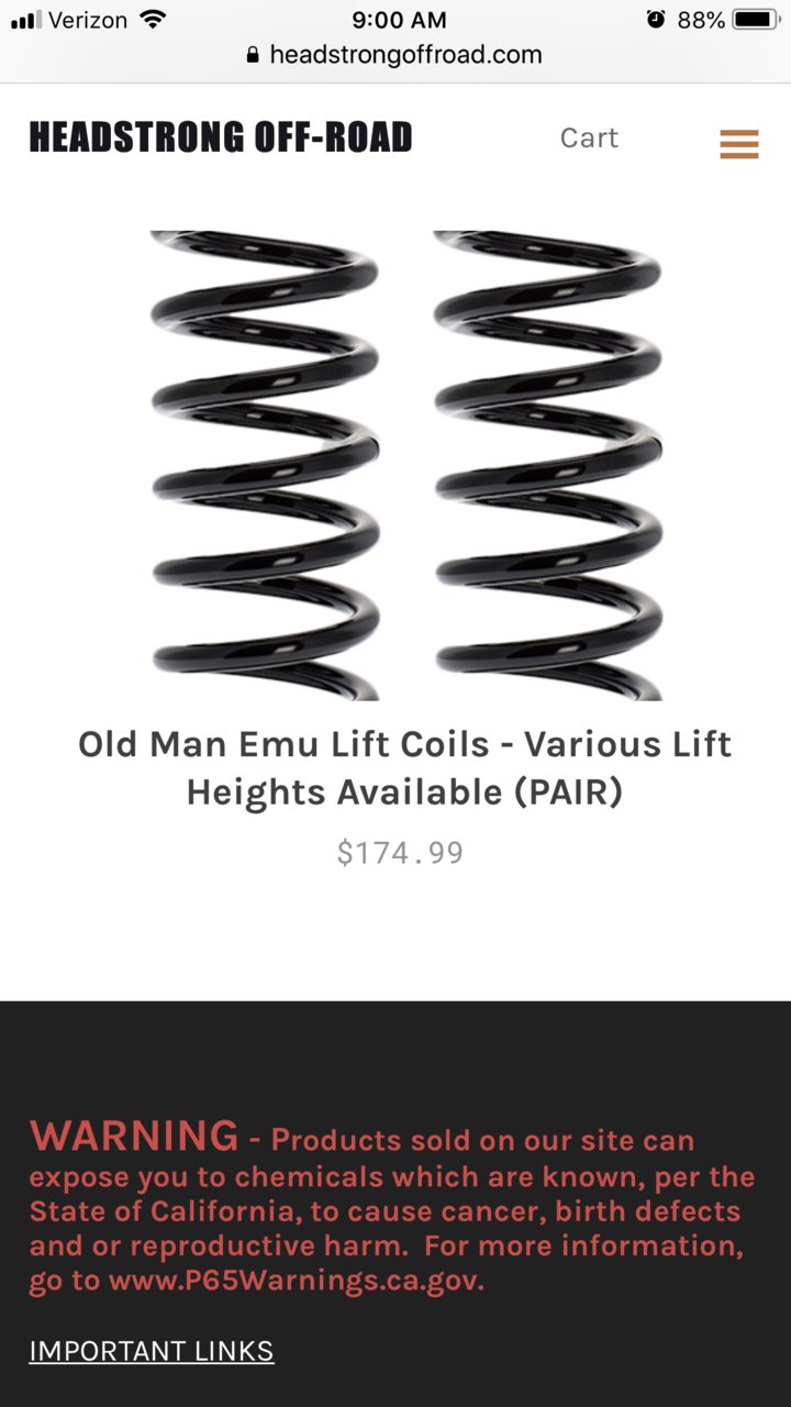

    I appreciate the input from those who responded. One other thing. Are new coils a must or can I use the stock ones? I may call headstrong tomorrow and discuss things further with them. Thanks

    5100s are designed to be used with stock springs but if you want lift with less preload you can buy aftermarket springs such as eibach.

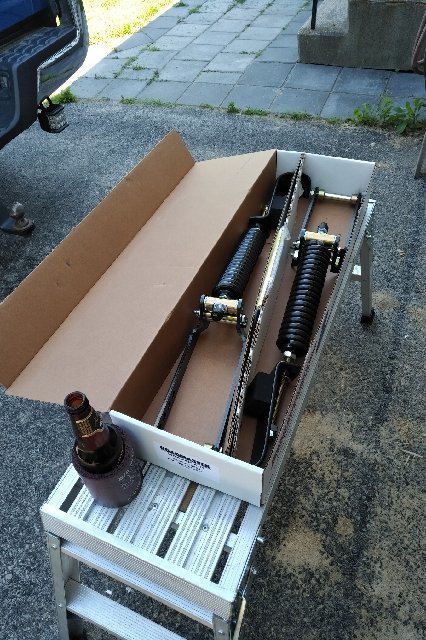

    How much work is involved with moving the OEM spings to the new 5100 shocks?

    Thanks. I'm a suspension dummy so can you explain to me the the advantage / disadvantage of either spring and how it effects the ride?

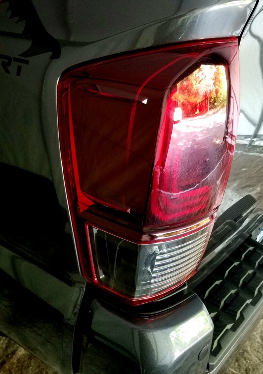

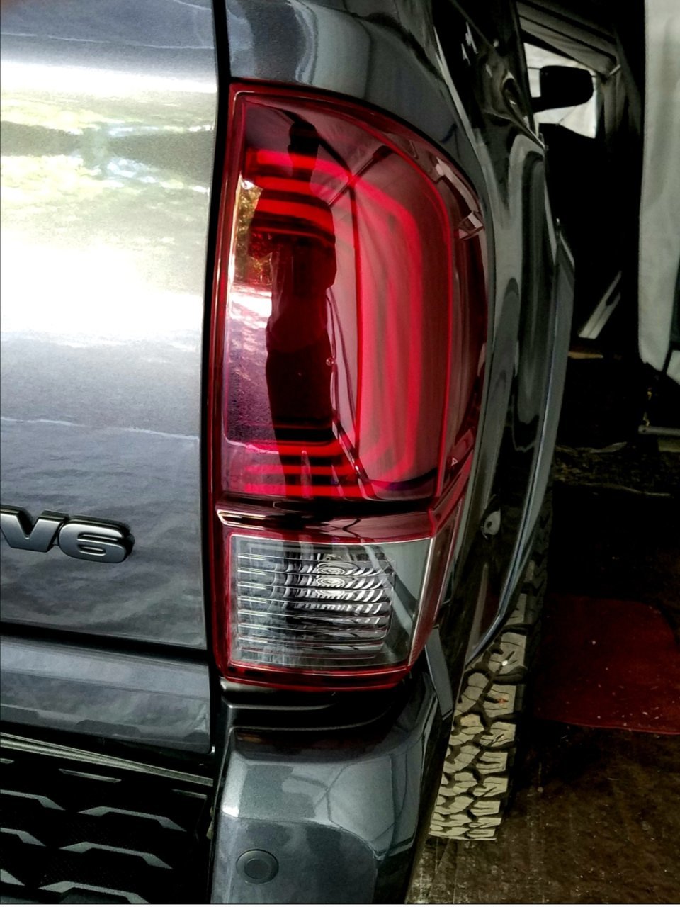

    Polished and sealed headlight and taillights. Will seal again just before winter.

    All I did was clean with alcohol. I brush painted them with touch up paint. I’ll see how long it lasts.

    Use spring compressors that can be rented (for free) from your local auto parts store, compress the springs, disassemble shock assembly, move parts over to new shock, reassemble, then release the tension from the spring compressors.
    There is also a no spring compressor method that you can find videos of on YouTube.
    If you've never done suspension work before find someone in the area with experience to help. It can be dangerous.
    Stock springs on 5100s have to be compressed/preloaded (via moving the spring seat up on the shock) which can lead to a stiff/harsh ride. Aftermarket springs won't need the spring seat moved up as high to achieve the same amount of lift which should translate into a better ride.
    Pros/cons-
    Stock springs = free but harsh (maybe)
    Aftermarket = extra money but better ride

    With the 5100’s you can use the stock coils.

    I just got them so I could keep the stock strut assembly together in case I ever need to swap them out in the future.
