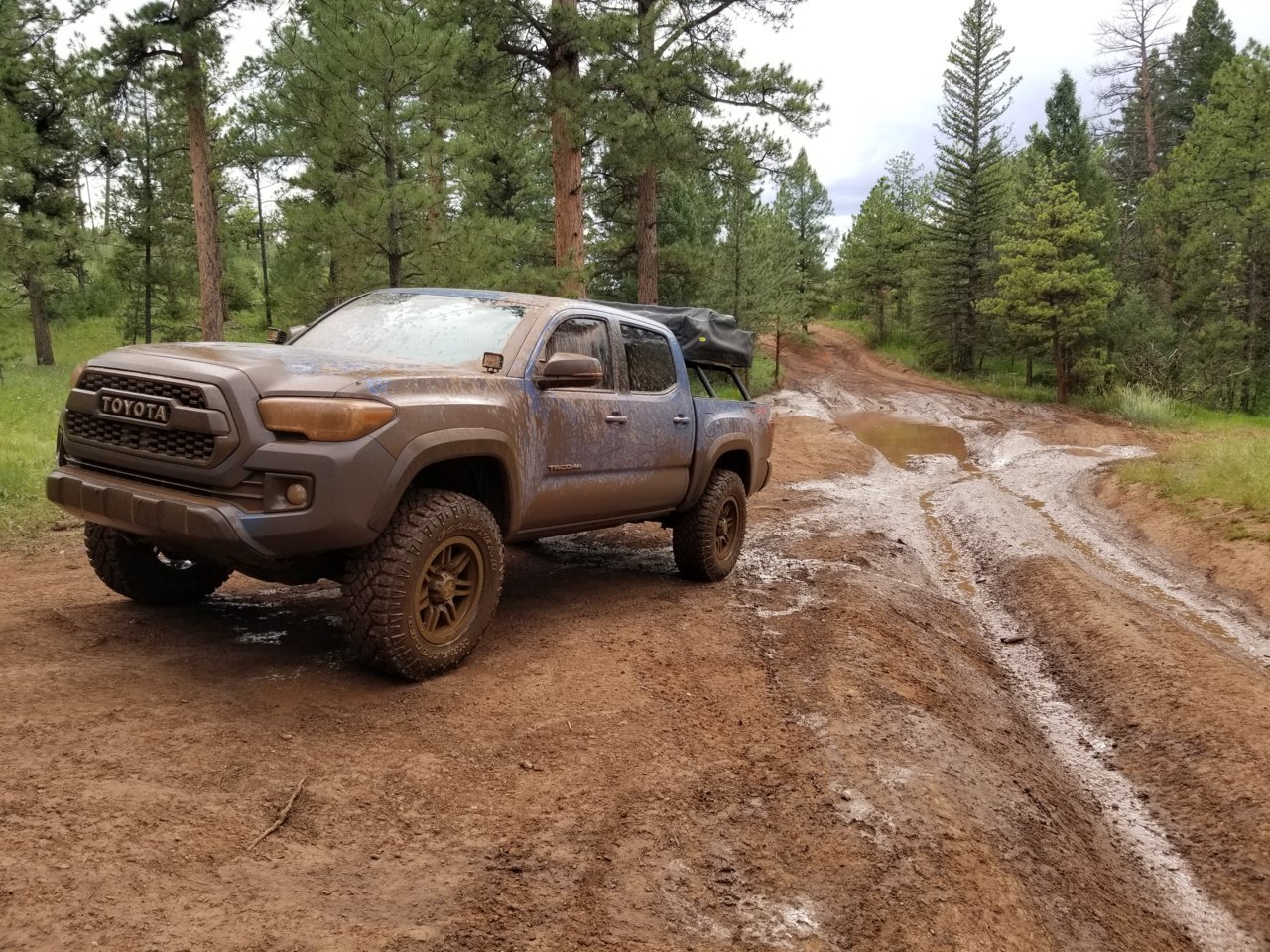

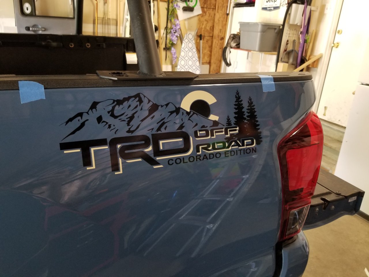

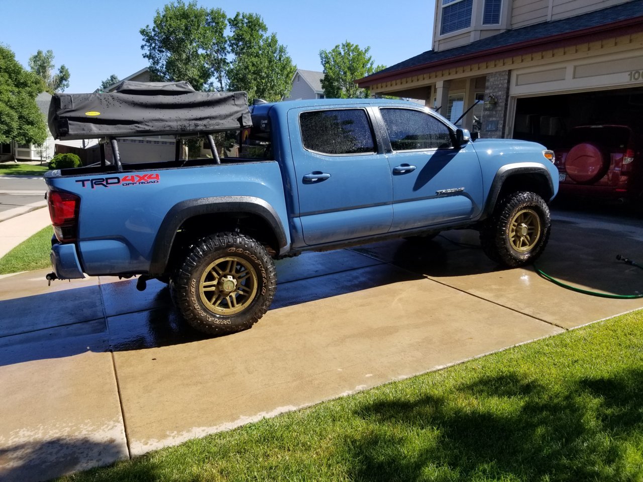

    Gave her a good wash after a weekend of offroading and added a new TRD decal just because
