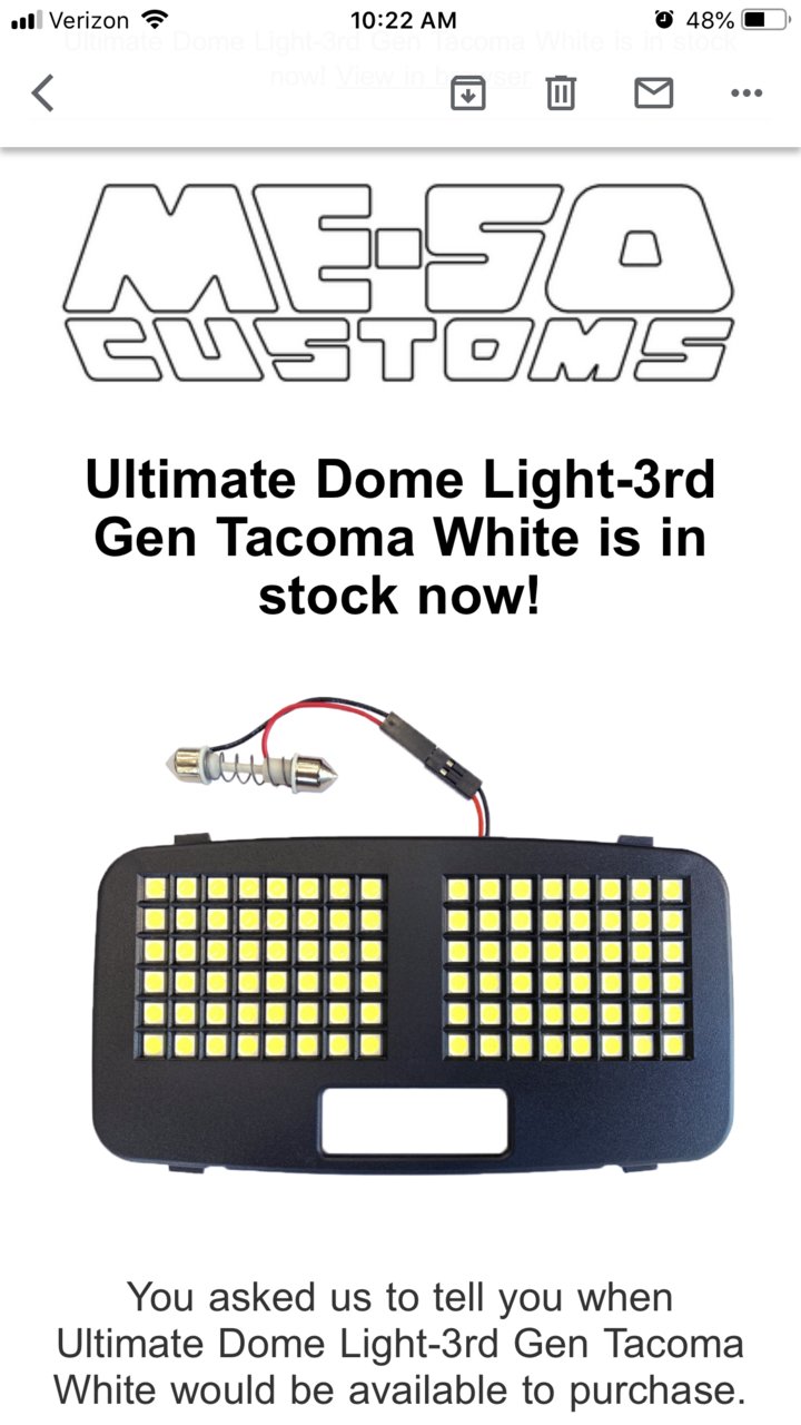

    just order a 12 pack of Disco led lights to replace them candles from the factory to lighten up the interior a little.:rofl::rofl:

    Dam it I gotta stop reading this forum! Ordered some as well.

    FYI, meso puddle lights are available as well...

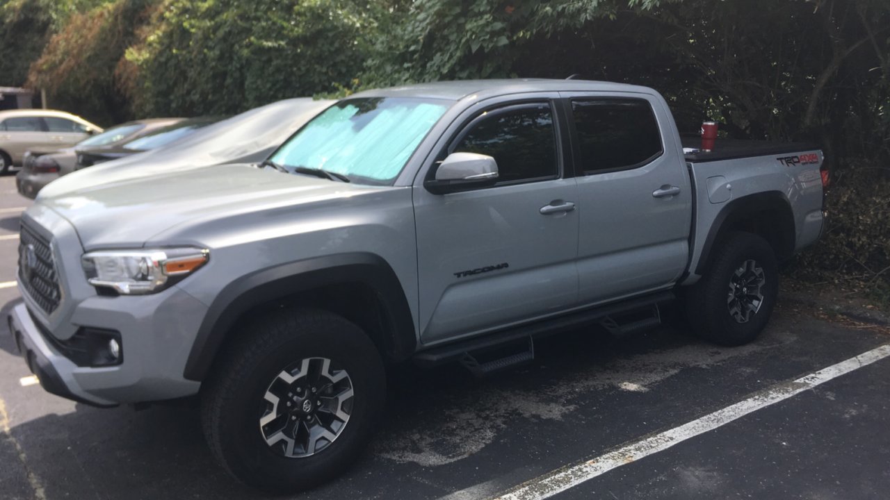

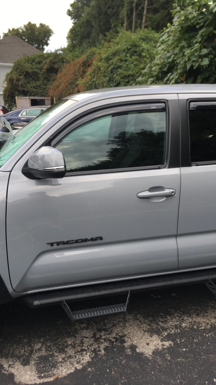

    Finally dipped my badges and am ordering some ecological tpo bumper caps next

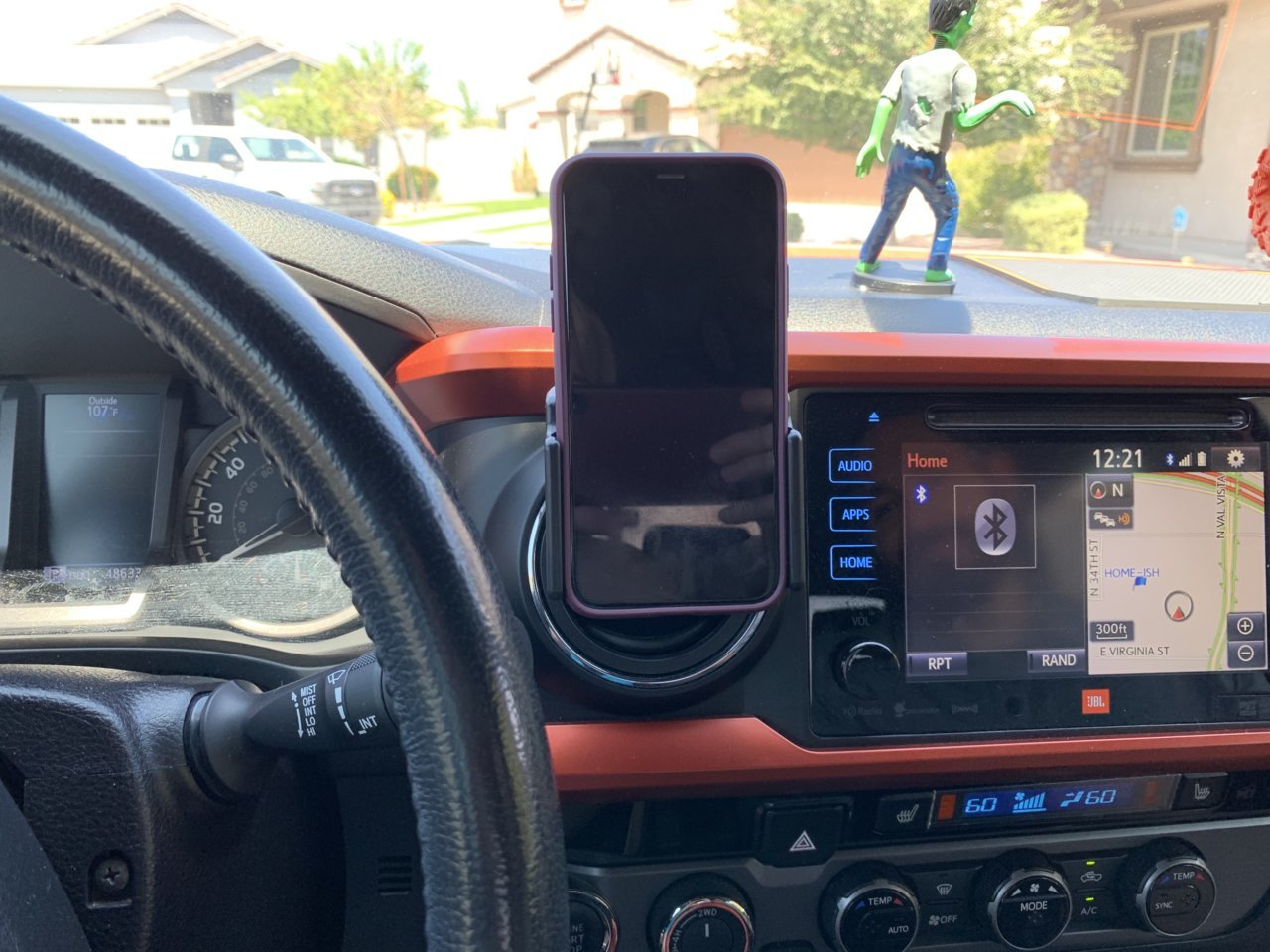

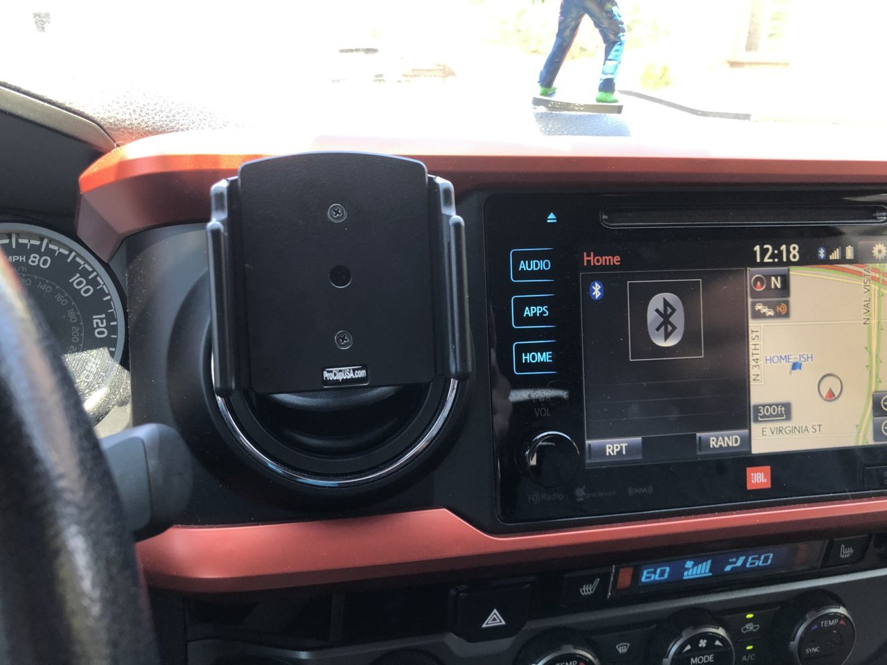

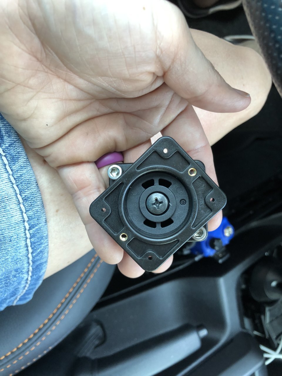

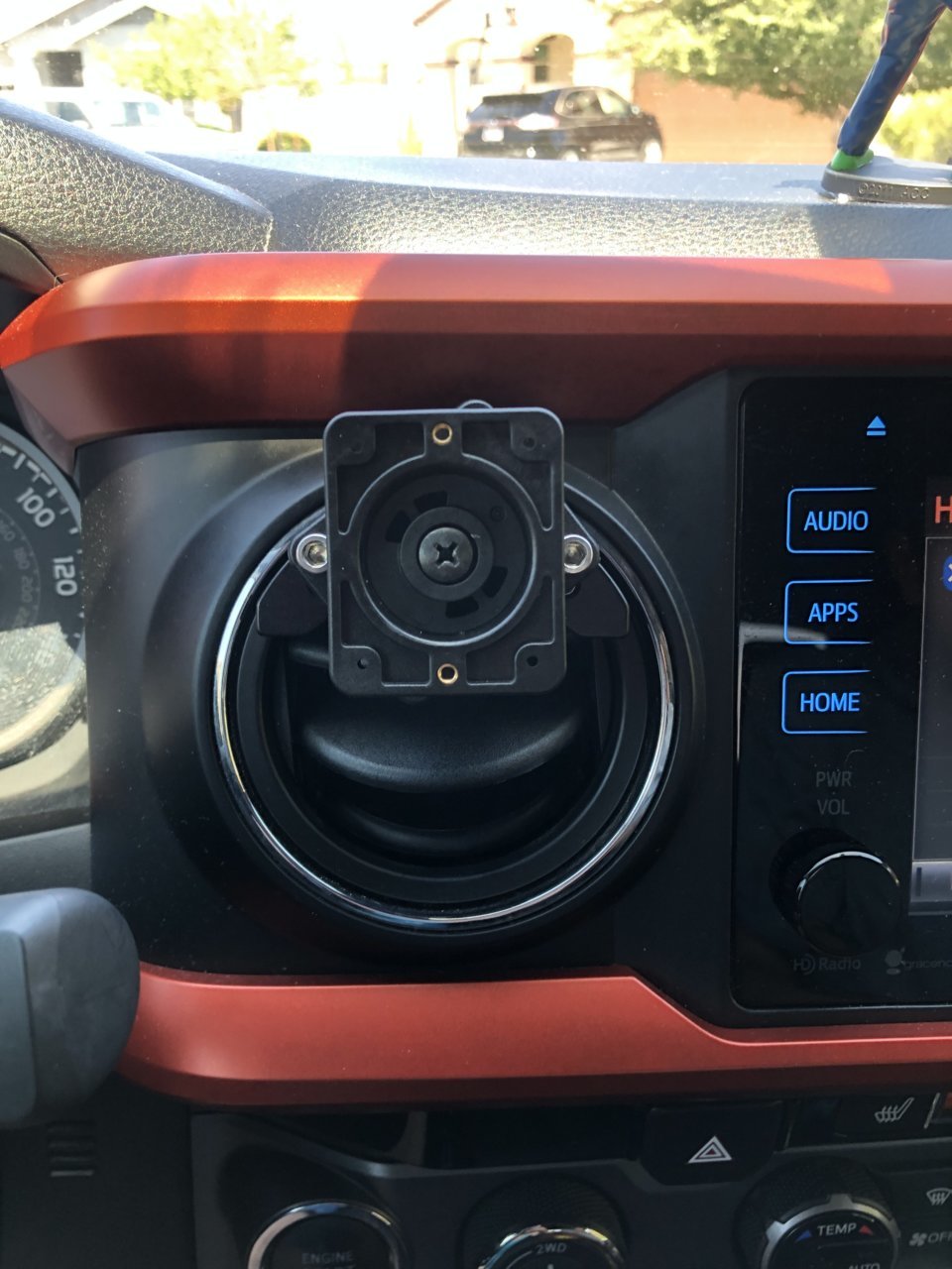

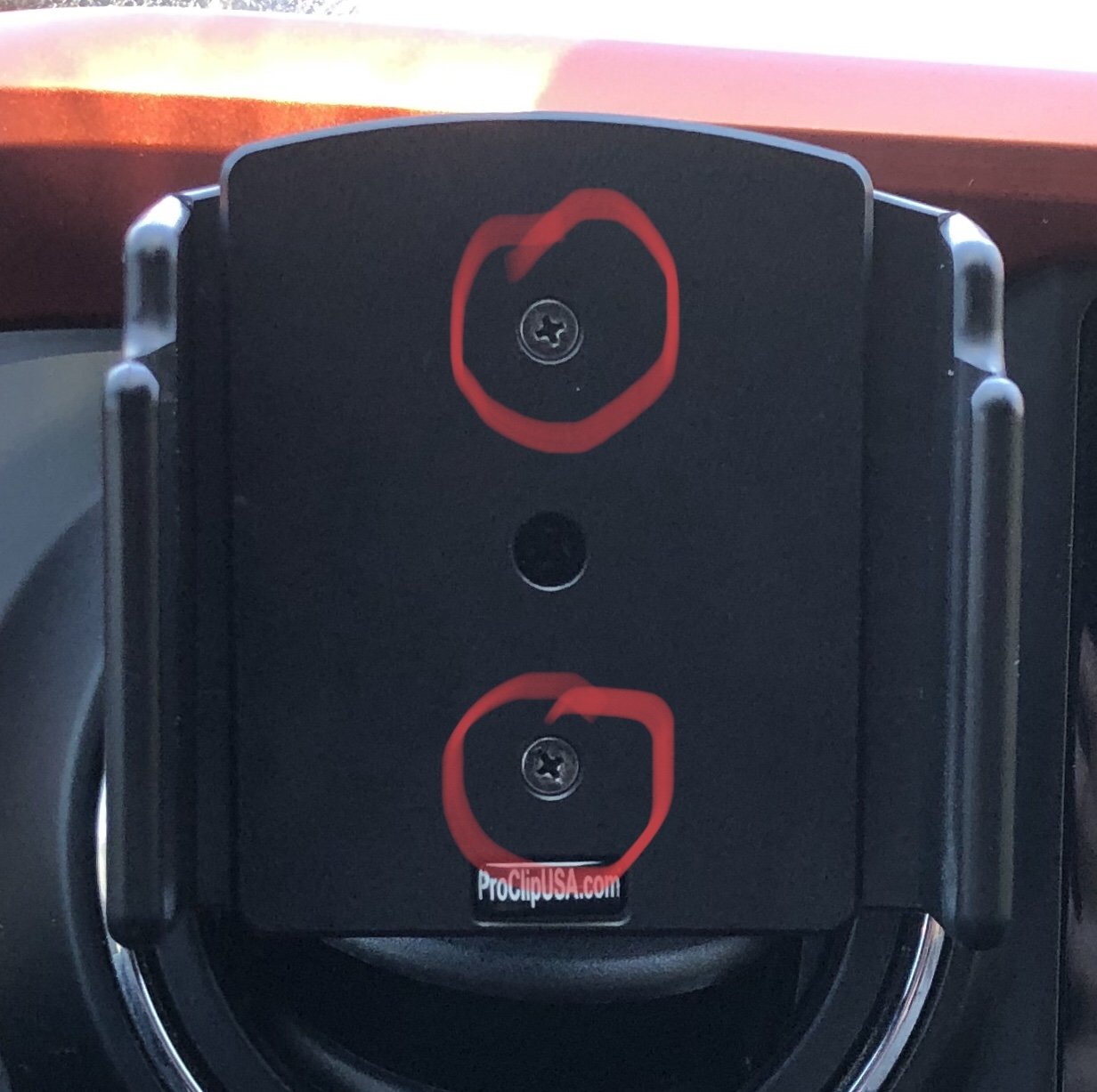

    Finally figured out a way to mount my phone to my satisfaction!
    Combined the Hondo garage Unholy 2 mount and a proclip Iphone mount. You have to remove the 2 front screws on the proclip mount to get the base off. Drill out the 2 opposite corners of mounting base as they line up to the 2 mounting holes on the Unholy mount.(you can’t see this once phone mount is back on).
    Attach the mounting base of the proclip mount to the unholy mount using the 2 thumb screws that come with the unholy mount (through the holes you just drilled out).
    Install the phone base back on using the 2 screws removed at the start.
    So sturdy and leaves are flow from the vent.

    Looks good!! :thumbsup:

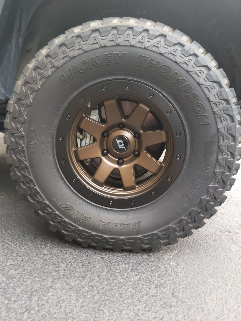

    Love to see how they are long term. Hard to find color matched in wheels I like. It’s always something lol

    Did you take them off to dip or just leave them on?

    But seriously, it’s well worth the investment for the MESO lights! :thumbsup:

    Well done! :cheers:

    @MESO needs to add a slider dimmer switch to them. Or maybe a switch to go from red to white. I like my night vision.

    Great idea. Gonna try this out since I have a Proclip iPhone mount from my previous vehicle.

    I left them on, but I put sheets of paper and tape around it to eliminate the spray off to the sides. I Used 5-6 coats and it peeled off easy.

    Thats how this came about. Came across The proclip from my husbands car he couldn’t use!

    No issues with in between the A and stuff? I thought about trying it on but felt like some of those in between of the letters would be a pain in the ass.

    Just use a toothpick. :thumbsup:
