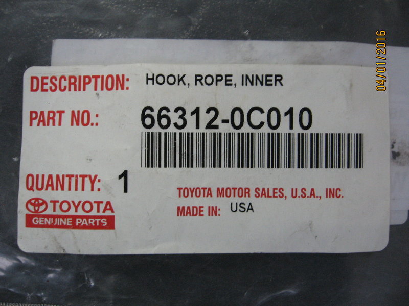

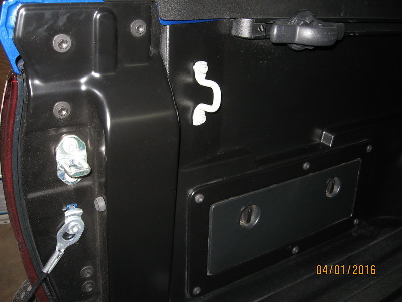

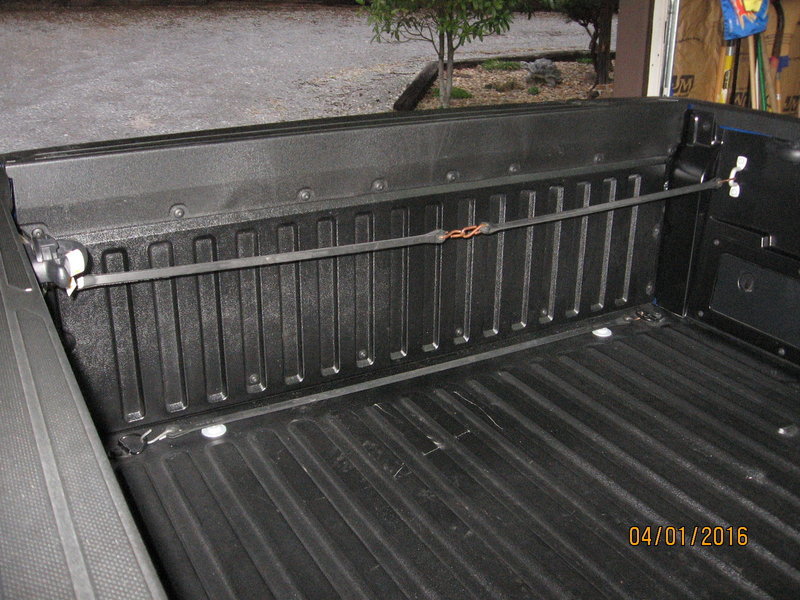

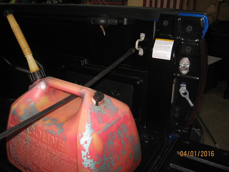

    I put a set of new "Rope Hooks" in the back so I can get much more usage out of the bed....Gas cans, Walmart bags and sooo much more.

    They come in very handy. Do these require drilling and tapping. Is there a predetermined spot for them.

    Where did you get them from?

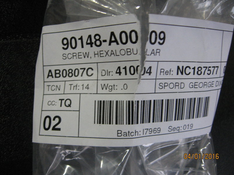

    I got the "Rope Hooks" from my local dealer....2 Hooks and 4 Screws were $48.29...See pictures for part numbers on those...
    I got 4 big washers 2" in diameter with a 3/8" hole in the center, 4 stainless metric nylon lock nuts to fit the Toyota screws and 8 smaller stainless washers from a local hardware store....Measured where I wanted the hooks (used painters tape and an ink pen) and just stepped up my drill size till I had the right size hole the screws would fit in...No tapping...I put 2 ss washers between the hook and the bed to match the look of the other OEM hooks and another ss washer between the nut and 2" washer on the underside.
    I just centered them on the angled panel....There is no predetermined holes or markings, just eye it up and measure...(make sure they are straight up and down)....The hardest part is getting your arm up the inside of the quarter panel to put the big washer, smaller ss washer and lock nut on...
    The original OEM hooks in the front bottom have only an oval backing plate that is about 1 1/2" x 3" or so...I think the larger washers I used are just as strong if not stronger, covering a bigger area so as not to crack and pull through.

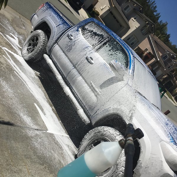

  13. Apr 1, 2016 at 6:21 PM

  15. Apr 1, 2016 at 6:25 PM

  16. Apr 1, 2016 at 6:29 PM

  17. Apr 1, 2016 at 6:30 PM
    Brobrady
    Brobrady Well-Known Member
    Dec 6, 2015
    #171602
    103
    What foam cannon do you use?
