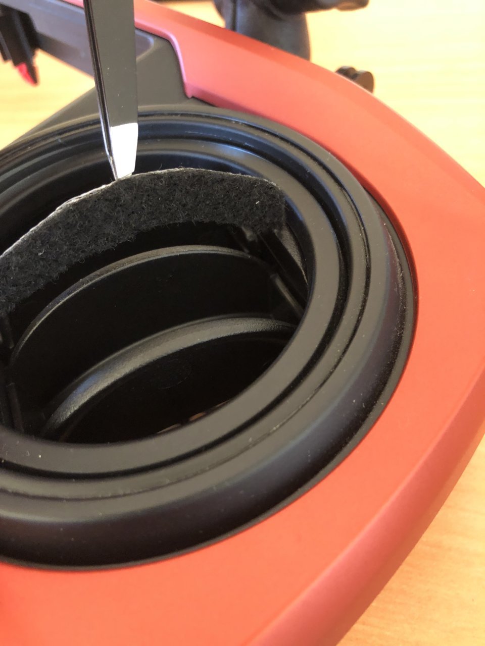

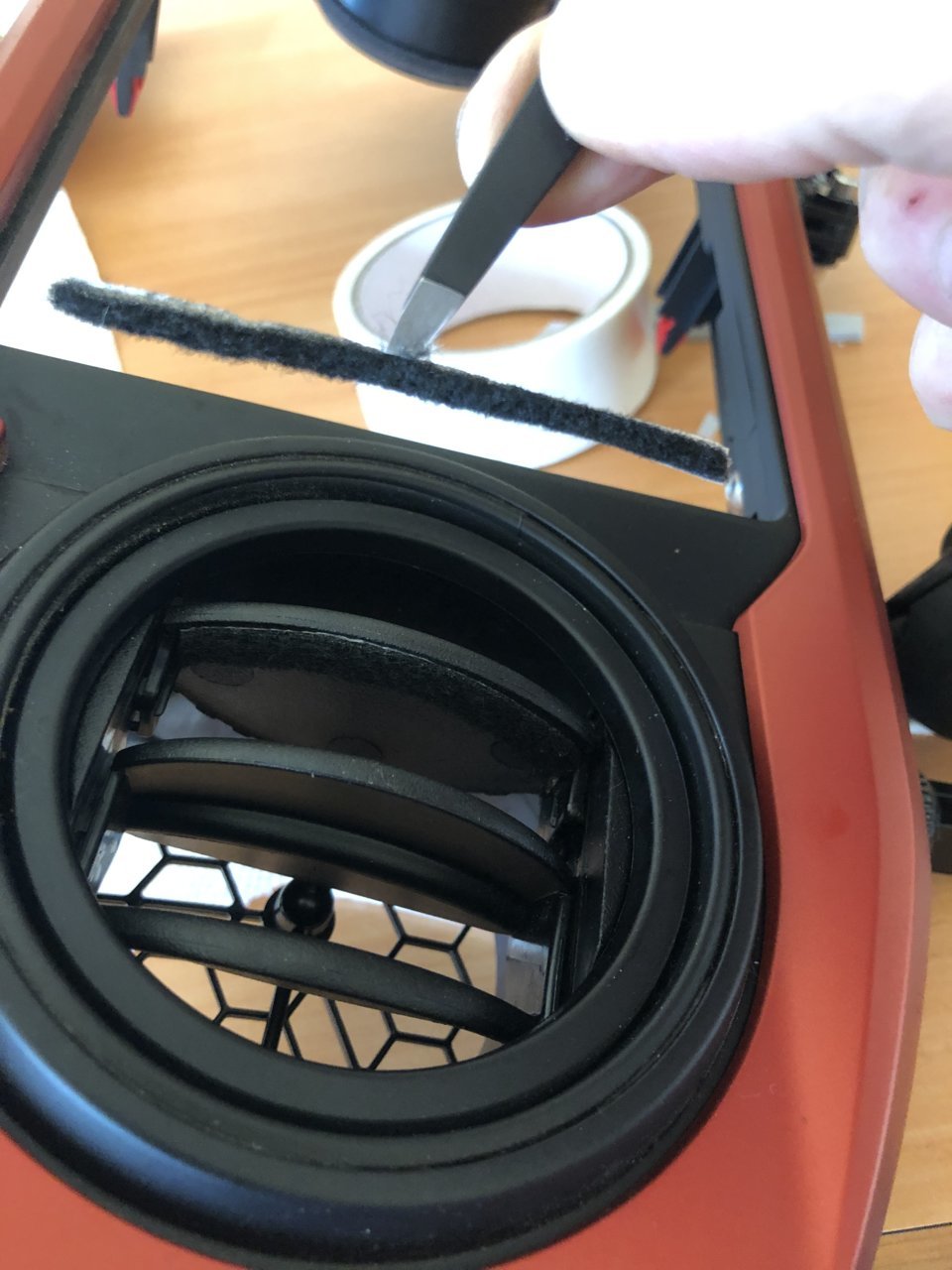

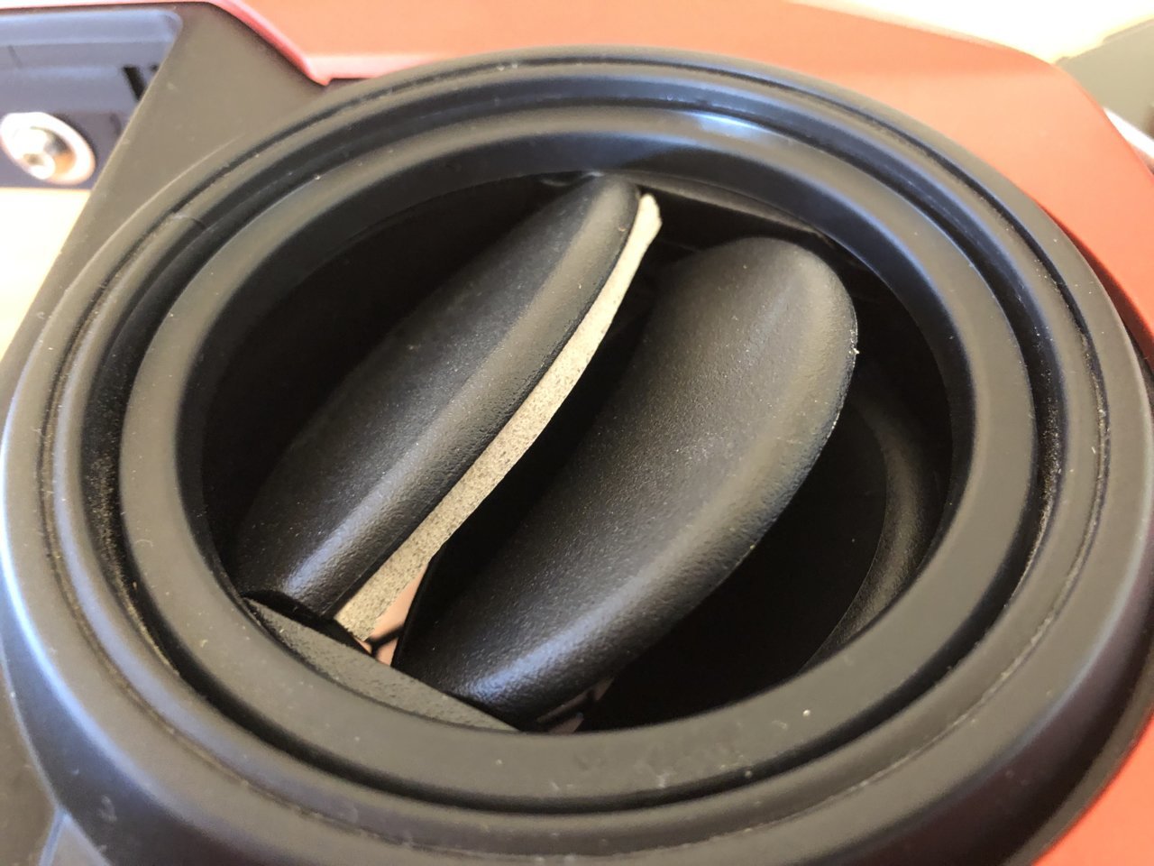

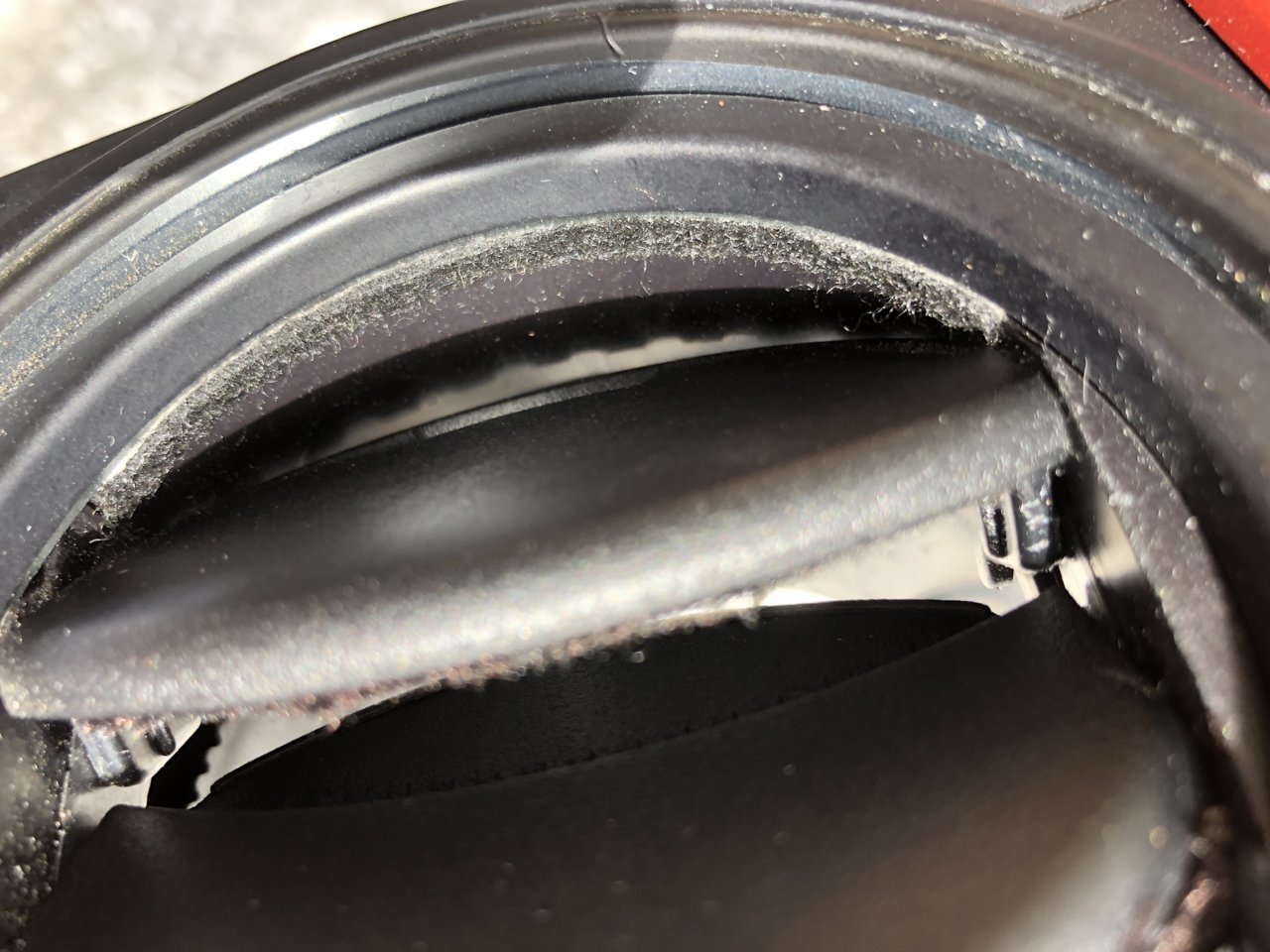

    Had a go at solving the leaky air vents today. First I tried some foam draft excluder, but it is too thick.
    Next I tried some auto carpet which is fairly thin like felt and used some carpet tape, which is double sided and very sticky.
    Only one louvre actually closes on the other, so it is simple to fix.
    I used thin strips around the circumference to try and catch the drafts at the edges.
    This kind of works, but creates a problem. Now the vent will not rotate.
    The final problem was the straight edges near the hinges. The carpet material was too thick for this area. So I tried filling the space with four layers of electrical tape.
    Testing this out it seems like it has halved the leaking air through the vent. This means that with the air con fan at approx 50% you can feel the leaking air at about 6” from the vent, compared to about 12” from the vent.
    Is it worth the effort? I’m going to have to test it out on the wife before I put effort into her other vent.

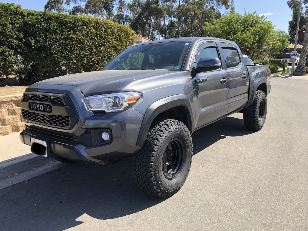

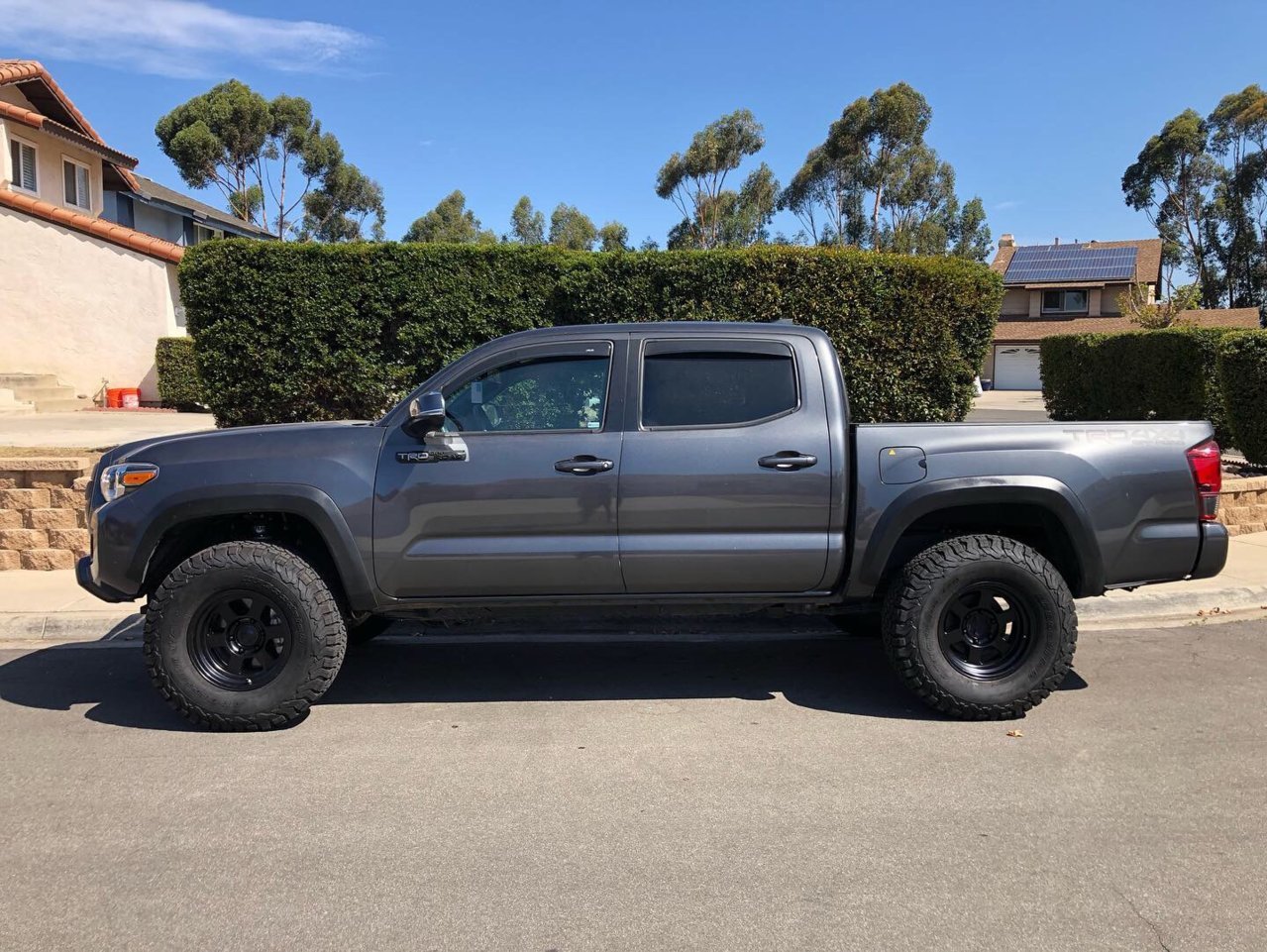

    9C398FEF-9616-418D-9115-D66EA06D92FF.jpg AE31D1BD-FEC0-42C8-8A47-B3ED4814C7B5.jpg 30B41E8B-DE51-4A95-AF61-318BEC044157.jpg Lovin’ these FN Wheels
