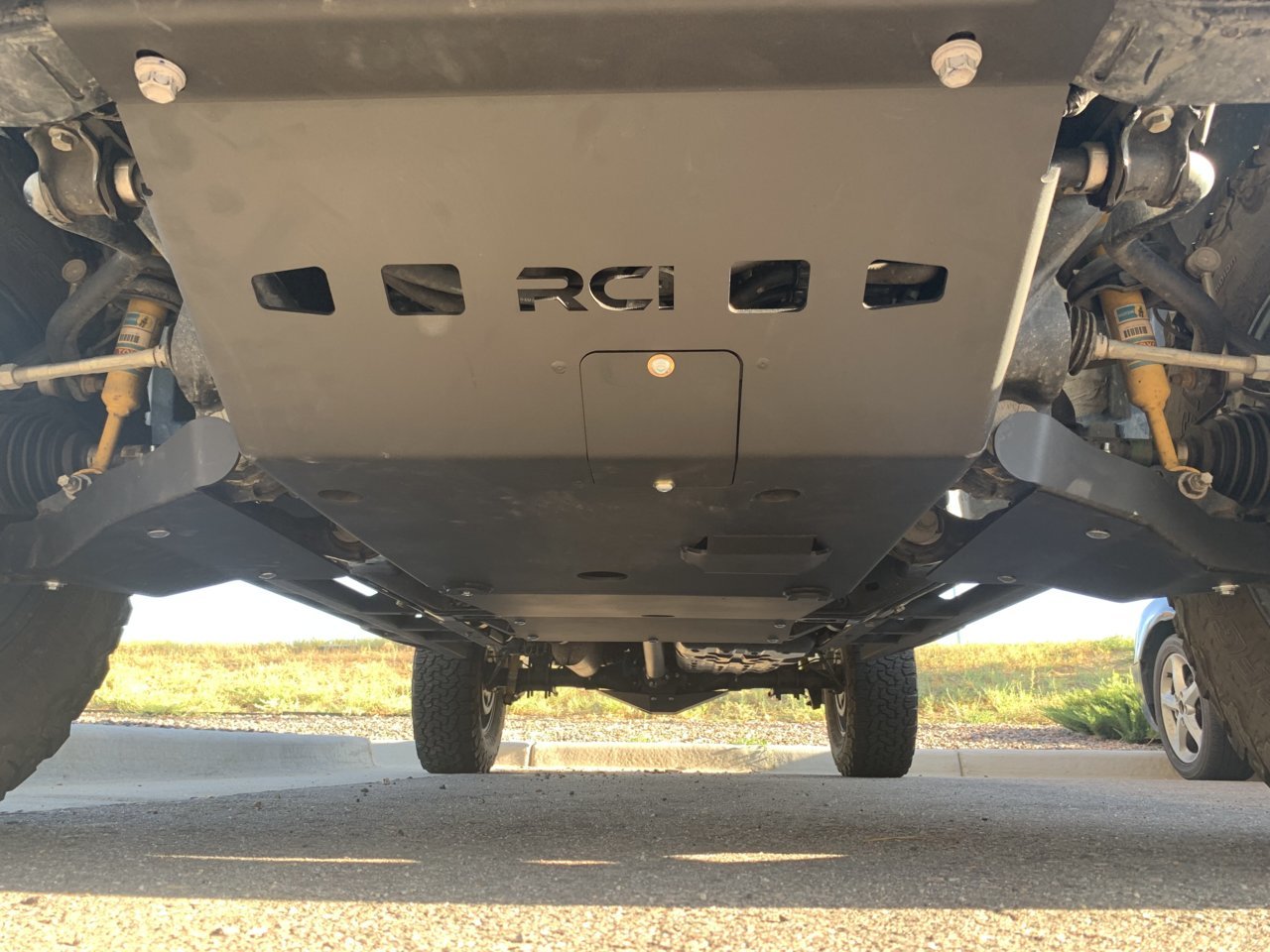

    Those are steel? How thick?
    Holy shit and nice all in one!

    All steel, and 3/16 thick on everything. There are internal gussets and bracing on each piece (belly skids are a 4 piece set) to prevent buckling under load. I am a steel fabricator and I can recognize solid engineering and quality work. Only one hole out of 28 some odd bolts didn't line up and with an assist of a BFH I got it aligned and bolted up tight. The one bolt had an internal tube that goes up to the frame and it got out of square while welding it. The tube just needed a few taps and it was back into alignment with the oem attachment holes.
    Overall I like them a lot and would recommend. I got the whole set (belly skids, LCA skids and rear diff skids for 1000$ delivered. RCI is close to me so shipping was only 60$

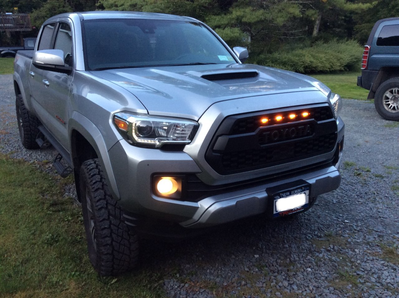

    The TSS garnish just simply wouldn't fit so I dremeled the outlining area on the grill. Kinda bummed I had to spend the money on the dremel tool but I guess I could return it haha. Also I will be shaving slots for my raptor lights and will only be using 3 lights instead of 4. Here's the video showing the concept at 1:11 https://www.youtube.com/watch?v=wlo1MJgI3vg&t=94s

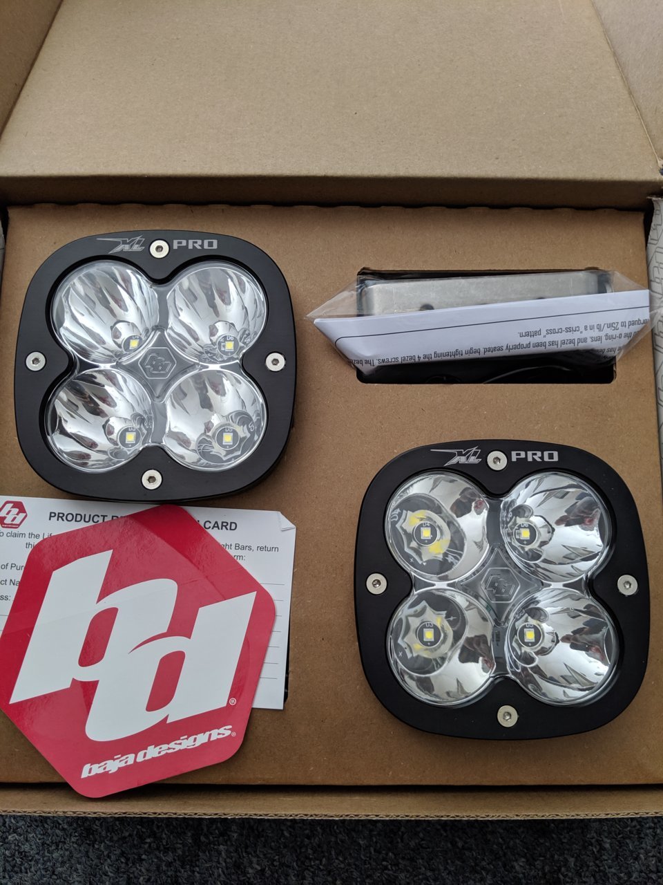

    Got another one. XL Pros High Speed Spot

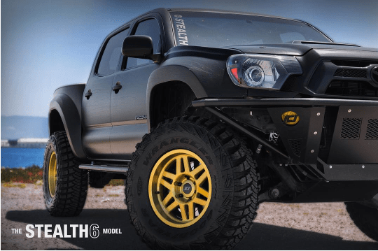

    I did not know this, thanks...
    Oh cool. Loves me some blems. Steath 6s in brushed gold... Hmmmm...
    <edit> Then again, maybe not.
    A tad too bright.
