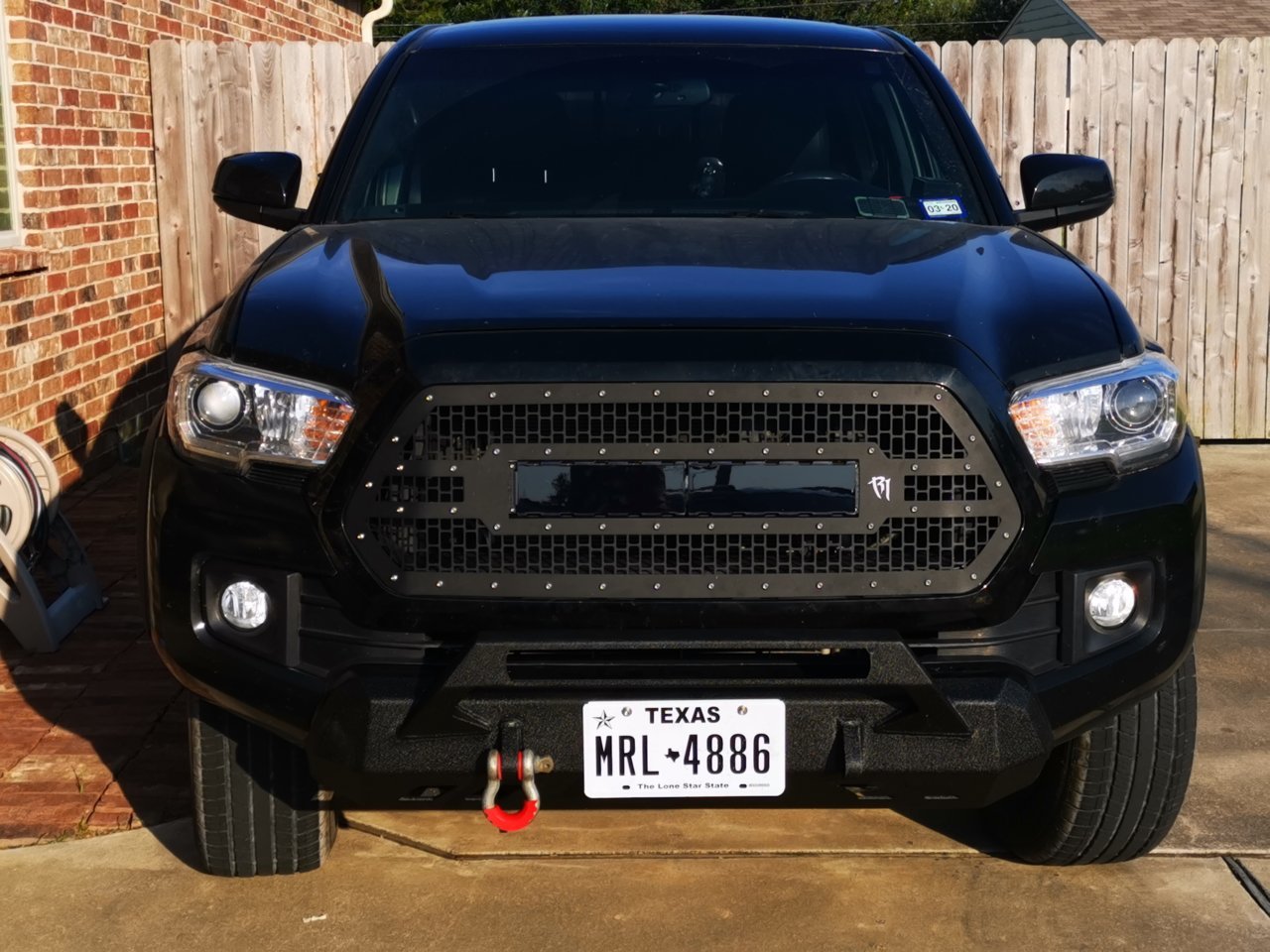

    Added a DV8 bumper cover since I lost mine in the flood. And Finally installed the new grill. Too hot to hook up the lights though.

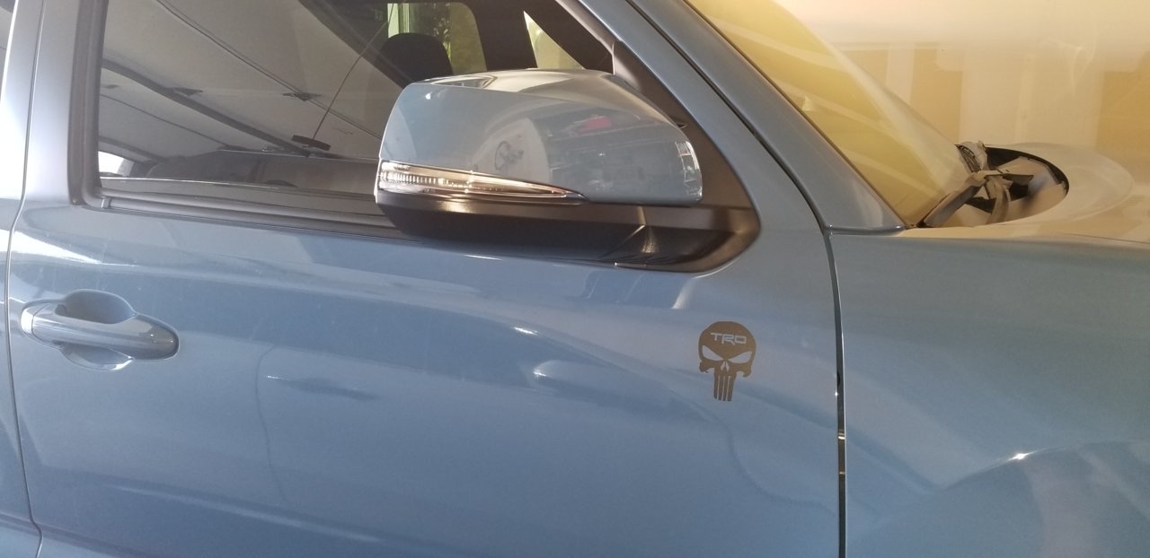

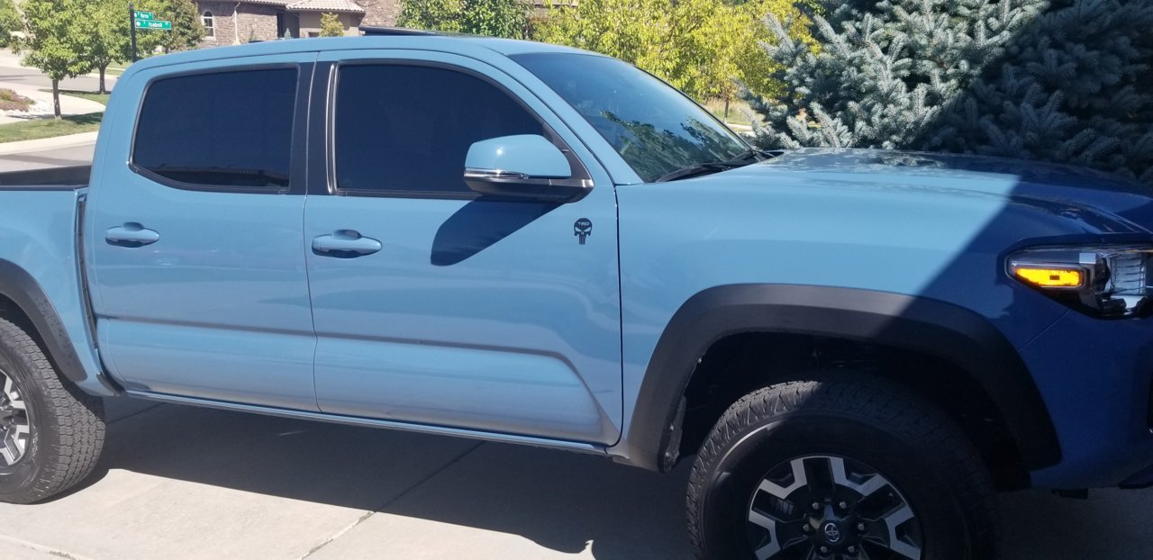

    Had to add some needed stickers

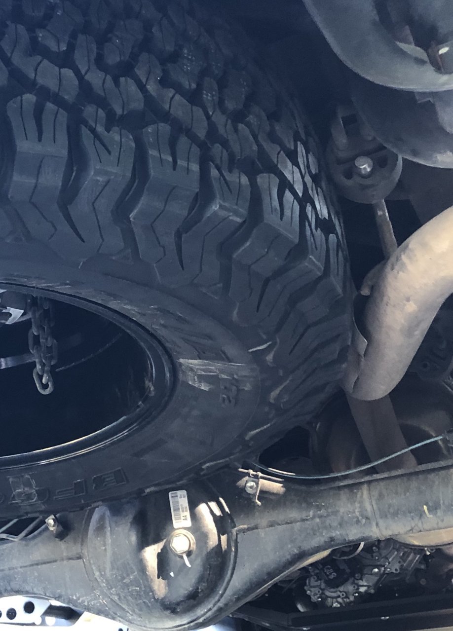

    Thanks, sweet video! That’s a good solid fix, for sure hardware is cheaper than a $230 tire.
    I do have a bit of play available but not much I’ve got a 285/70/17 spare. My 2017 SR5 exhaust has a heat shield welded on the pipe and is part of the shield/hanger thats up against the tire. Since I’m at the farthest point already theres not much wiggle left to work with. So, I’m thinking a bend to the hanger and/or the exhaust will give me enough breathing room to loose the shield.
    Here’s a before and after:
    original spare 245/70/17
    new spare 285/70/17

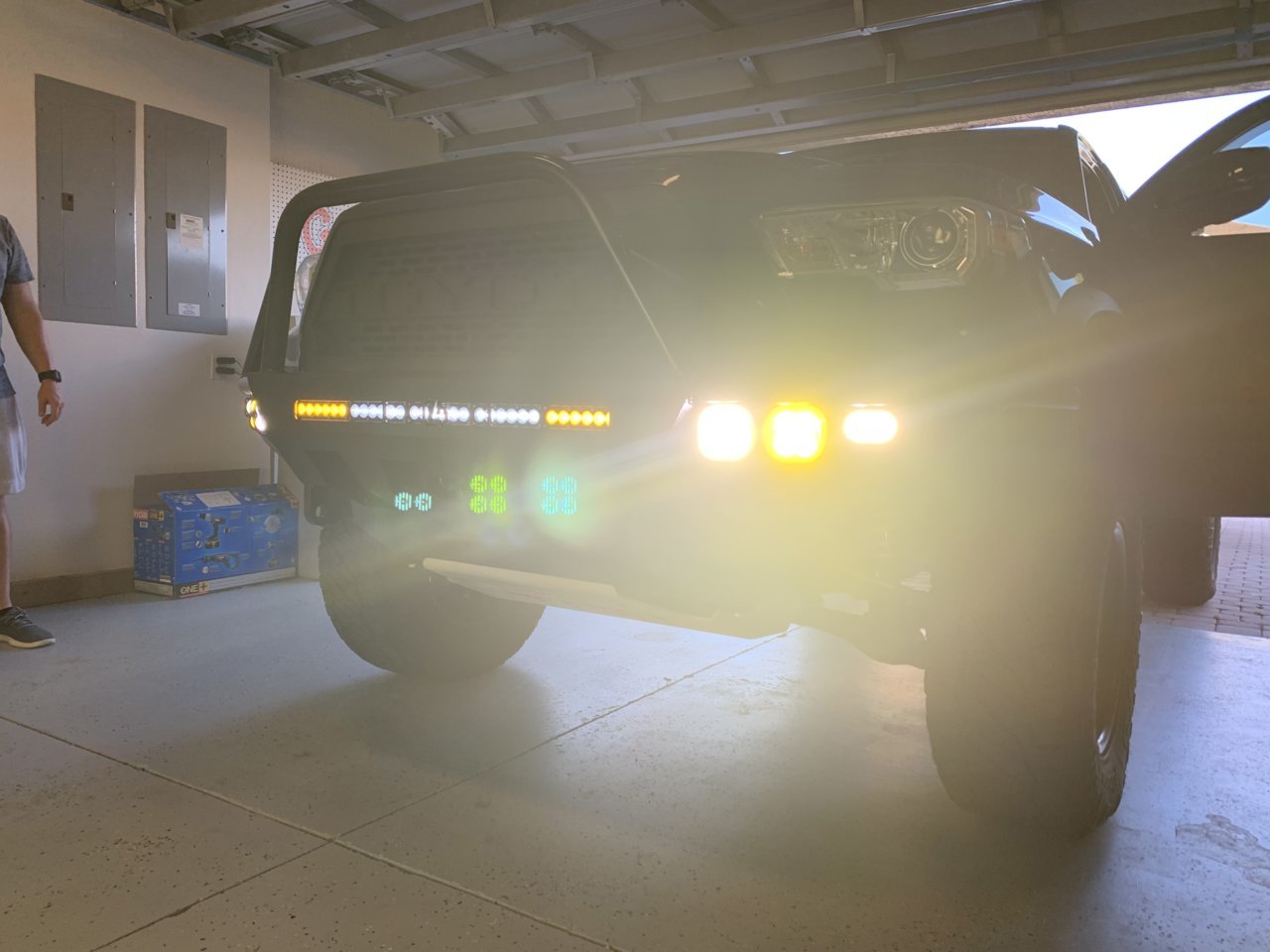

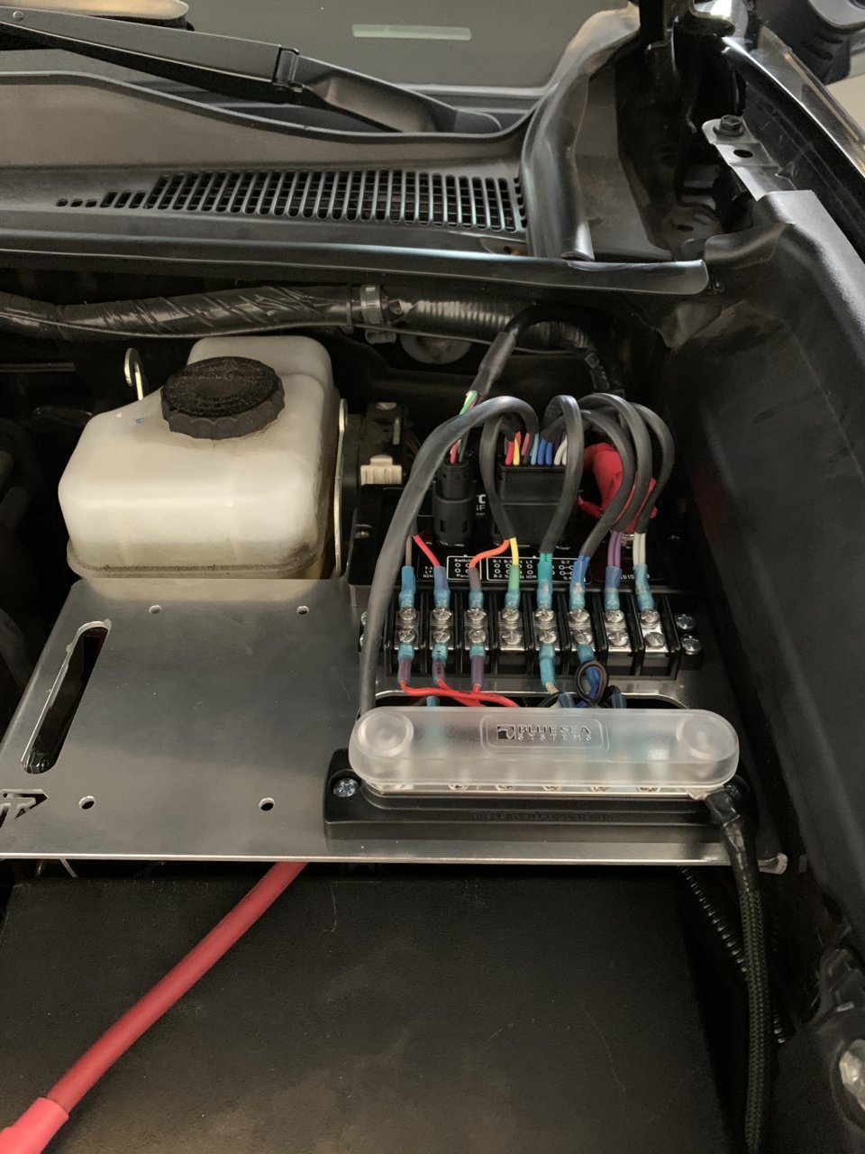

    Installed Switch Pros :bananadance:

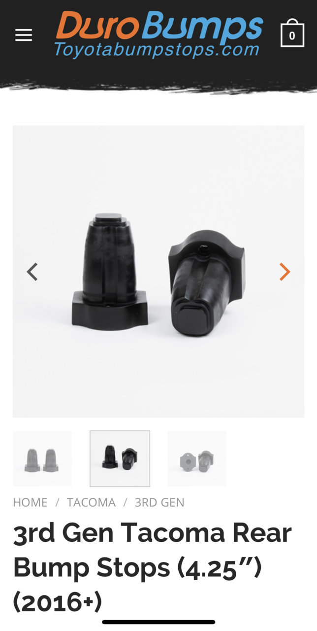

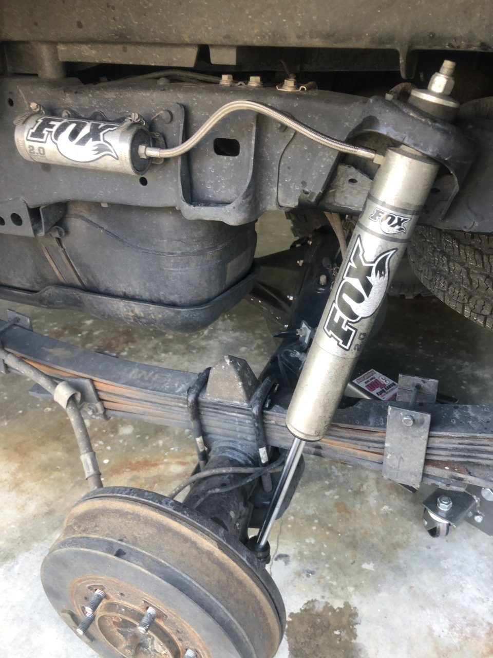

    Stuffed the driver rear tire up in the well and pinched the braided line on the upper shock mount. Shock fluid everywhere. Replaced the line, added more fluid and recharged the shock5EAFA3E9-8B8E-4683-B2FE-640FE25A9574.jpg
    Ordered these bump stops to hopefully remedy the situation before our local TW camp and ride meet in a couple weeks

    That’s clean, dude. I’m about to pull the trigger on that c4 hybrid with no hoop. They're sayin’ 12 week lead. How long did you wait?

    I like it a lot, i got in on the original order back in Feb. It took around 13 weeks if i recall. It was worth the wait though.
