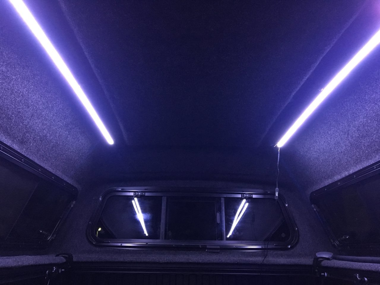

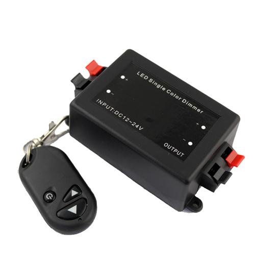

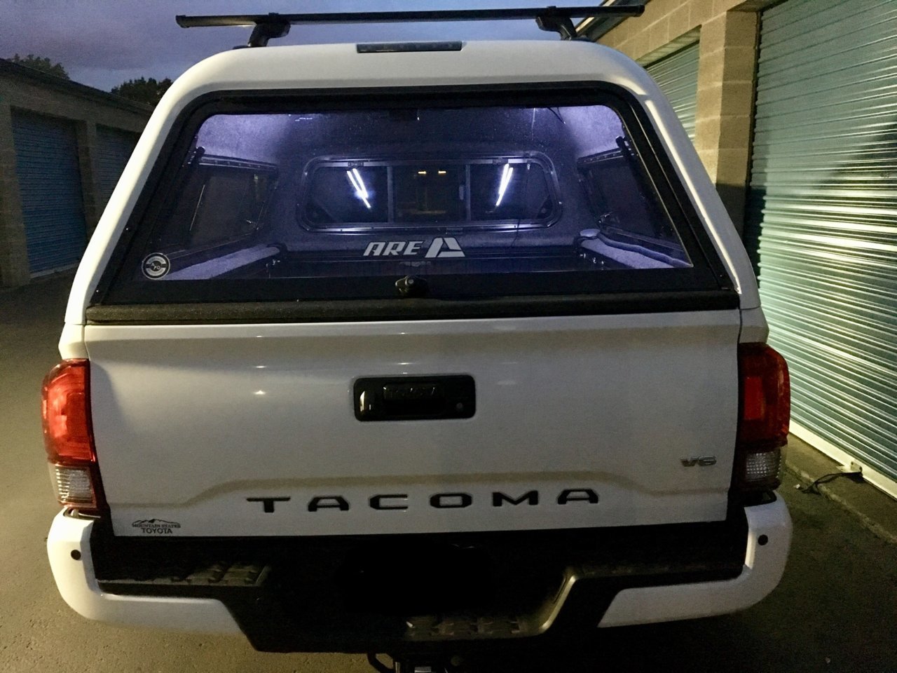

    Finally installed the LED lights strips in my shell. I used the existing bolts from the Yakima roof rack, that protrude down through the shell, and made stand-offs from 1.5" x 1/8" x 1/2" sections of aluminum flat stock. The LED strips are housed in an aluminum track, with frosted plastic cover to diffuse the light. I'm controlling the lights several ways; using the in-cab bed light switch, the dimmer w/ remote control (pictured) and by way of an inline on/off toggle switch.
    Re-purposing the bed light was a bitch! Getting to the rear of the light required lowering the rear section of the headliner, which required removing the plastic pillar moldings; driver & passenger side, which also required removing the driver's side rear seat-back! Then I pulled the wire down through the wiring harnesses and looms, and then routed the wiring down through rear wall pillar, out through the wall grommet, and up into the bed--using one of the already drilled holes. I ran the wiring through some protective wire sleeve, to keep it from chaffing. It was a lot of work, but having the use of the in-cab switch, and the remote control made it worth the hassle.
    The led strips turn on just like the puddles; lock/unlock of the truck, and open/closing of the doors. Also, the cab switch can be left to on, and the dimmer's remote control can turn the lights on & off, and dim.

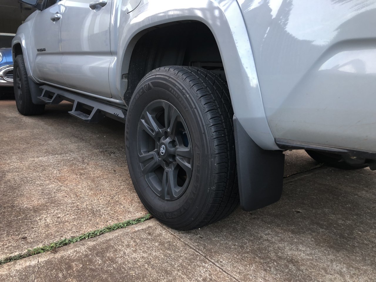

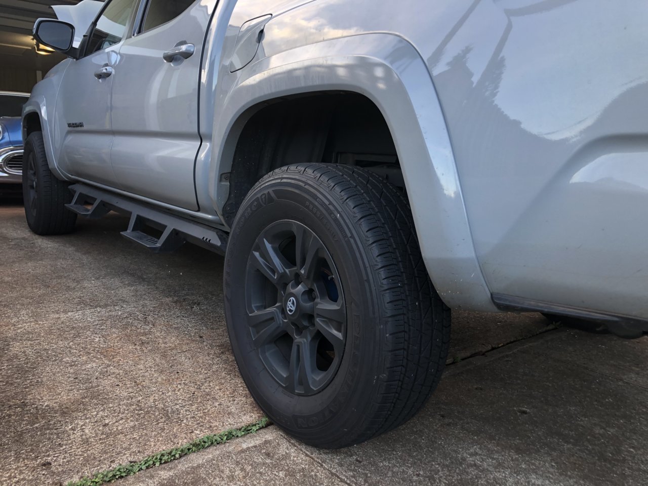

    My buddy pretty much gave me some brand new mud guards that he wasn’t gonna use. Threw em on today... Hopefully the rocks will stop hitting my steps.
    He also gave me his stock black fender flares. Might throw those on this week too!
