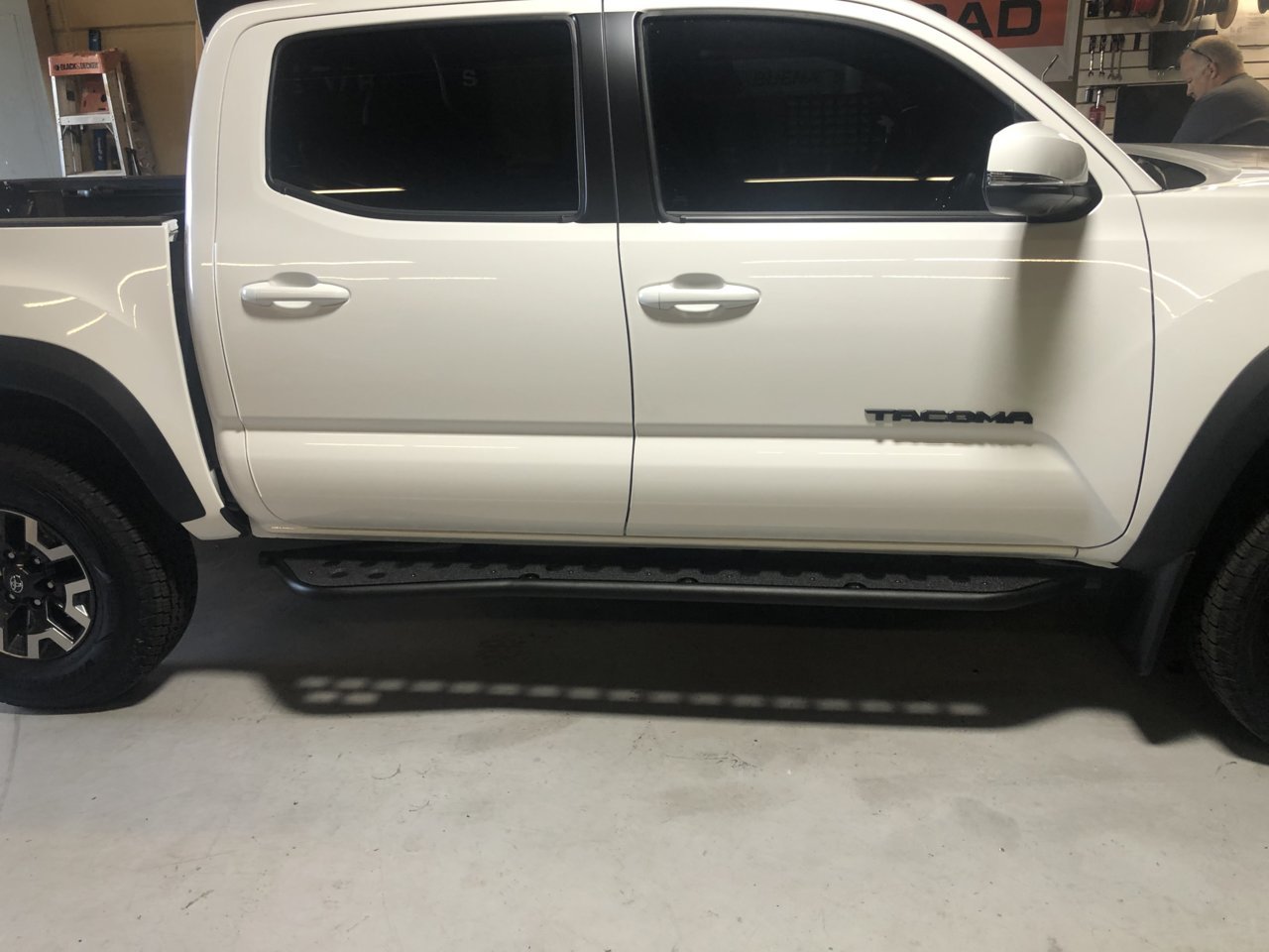

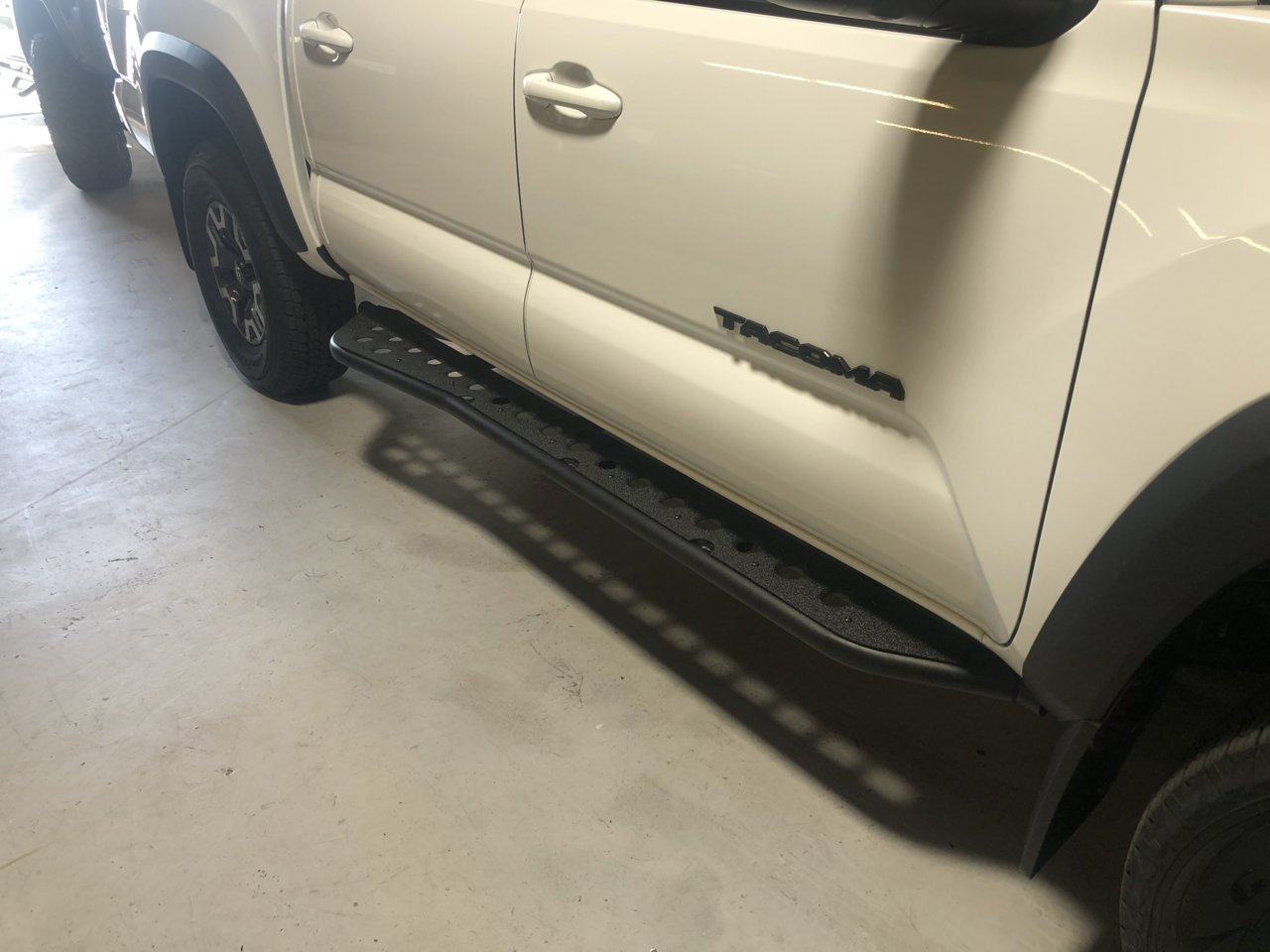

    Really nice!!! I like it!!! I'm still waiting on my SOS concepts sliders. Ordered in 04SEP...How long did it take you with CALI?
    Is that 0 degrees or 15 degrees angled? Thx!

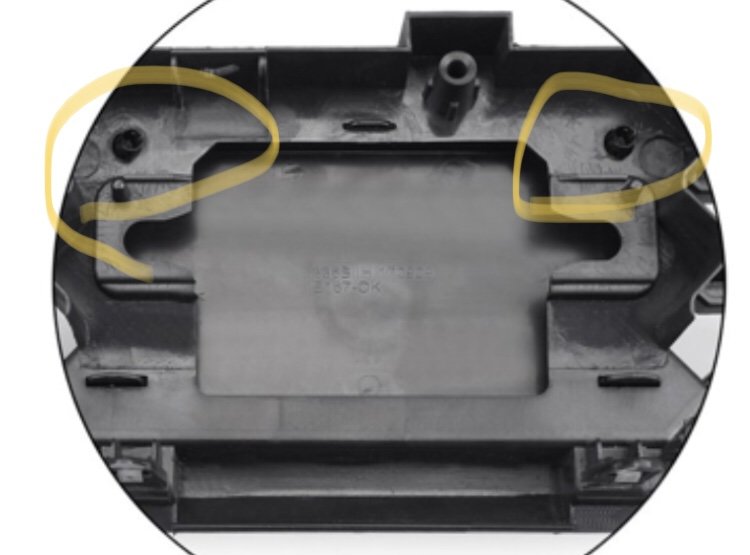

    #301483

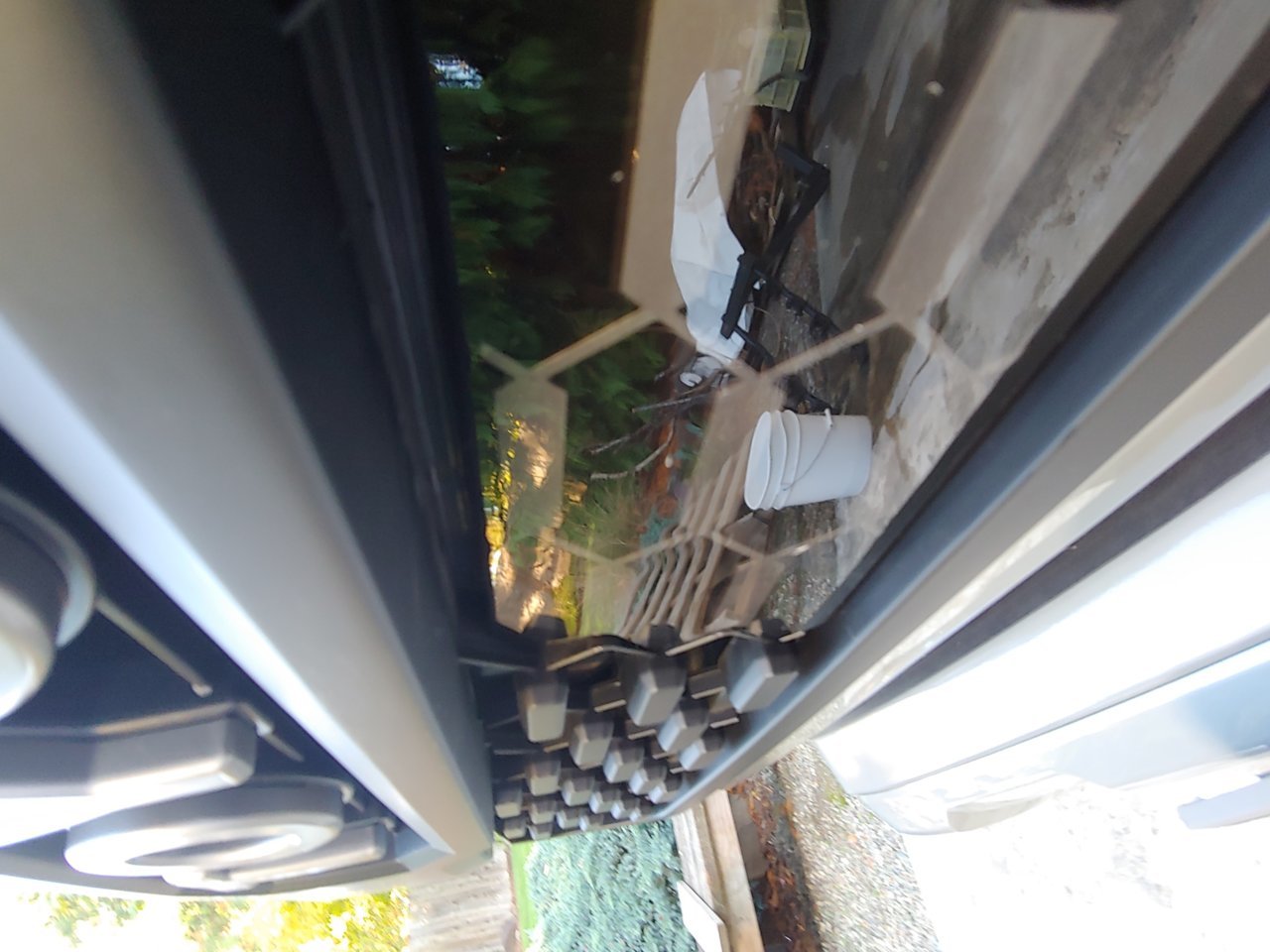

    Went all Progrill. One question, is the face of glass sensor cover supposed to be at an angle? As in the face not perpendicular with the ground???

    Ooh, I really like the red, orange and yellow stripes, I might steal that.
    But I was killing time sitting in my truck and went and looked at my pro grill(which is a knockoff) and the glass looks pretty flush

    So look:

    I guess mine isn’t perfectly flush but it looks closer than yours? I also have safety sense disabled tho. When I went for the TSS recall they said that because I have a non-stock ride height they couldn’t guarantee the calibration was right and set the computer so if I turn it off it stays off instead of coming back on every time I start the truck. I do use radar cruise control very occasionally(MT so it’s usually more annoying than it’s worth because it sometimes slows down and can’t speed back up unless I downshift) and it seems to work fineDD3FF928-AD44-456D-A237-F54E4813B76A.jpg

    Ha haha wash your beast. I do see yours is not perfect. I wonder if it matters

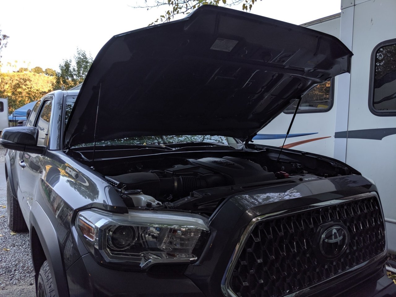

    Just installed the Redline Tuning hood Quicklift. I'm happy! Because I'm short this is so necessary. My 2009 Ram had hood shocks and I got a little spoiled.

    You mean besides just being filthy?
    It’s on the trail or driving on crud covered roads to ski mountains pretty much every weekend so dirty is pretty much the norm haha, I actually washed it last week but then this was last weekend.. https://www.reddit.com/r/overlandin...urce=share&utm_medium=ios_app&utm_name=iossmf
    Ya, idk. If someone with an actual pro is lurking around it’d be nice to see how it’s supposed to look.

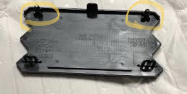

    Got my grill and garnish on mad hornets. Wasn't flush either. Then came the clean sensor warning for a week. I disassembled everything and made the garnish more flush by pulling out the metal brackets on the grill (that hold in the two circular tabs on the top corner of each side of the garnish). Pushed the circular tabs in so it was flush, and put the brackets in from the other side to hold the tabs on place. No clean sensor warning since.
    I think maybe debris get through the gap on the top of the cover and bother the sensor.
