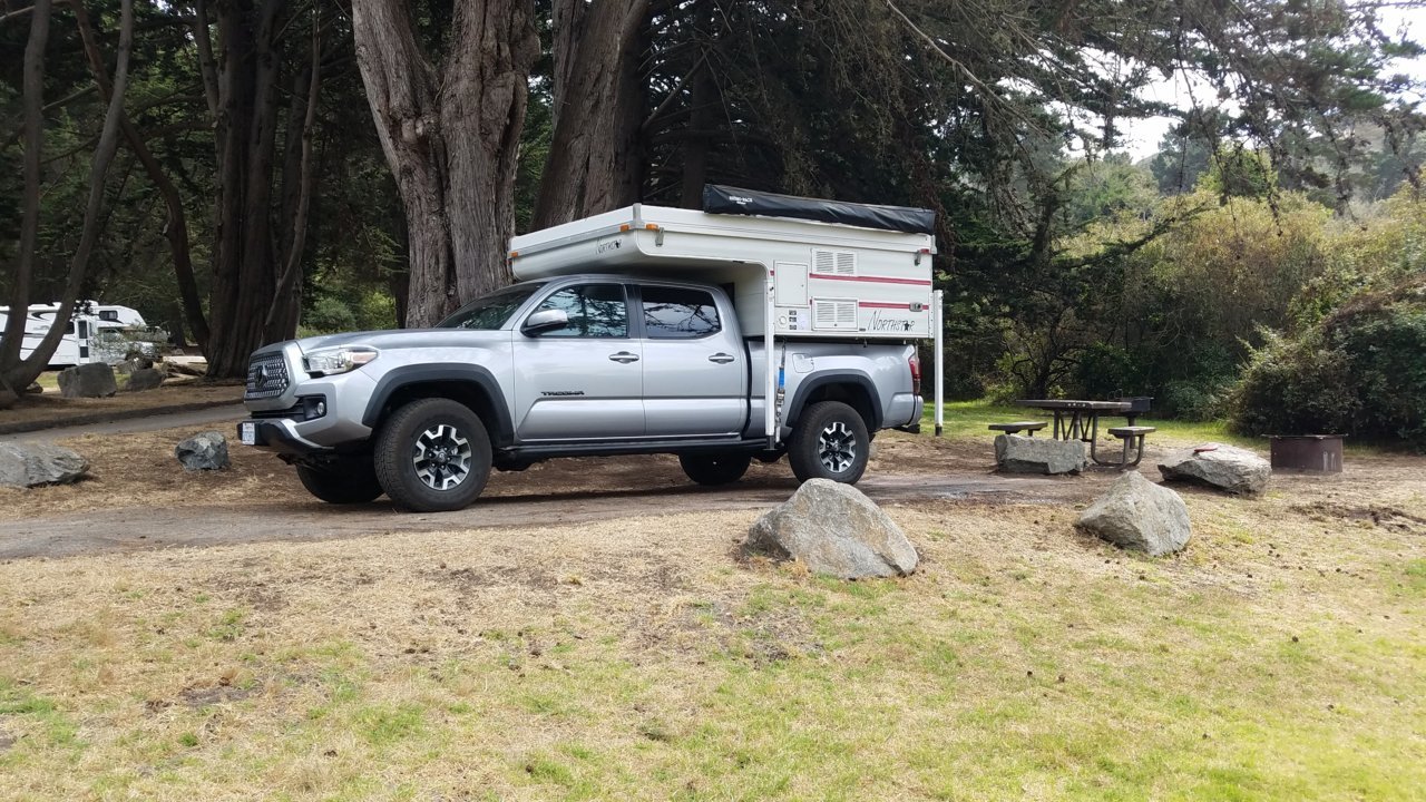

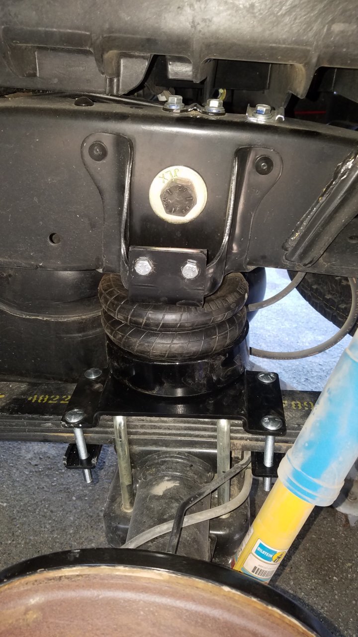

    Installed the airbags:
    Made by Torque here with the Daystar cradle here.

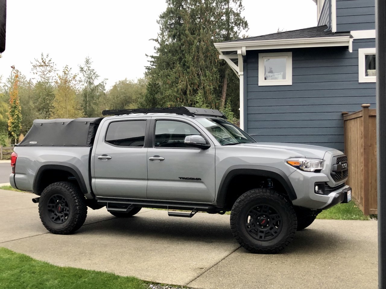

    Car Seats
    Posted about this last week but took the stickers off the taco - looks way more clean imo . Should’ve done this when I first got the truck

    Air bags a cool and work. I know. I put them on my work truck. But I found I needed more. How much more weight would you guess that they are helpful and how much to render them not enough. Hope that made sense.

    I'm still experimenting, but anything over payload and you're looking at replacing the leaf pack (of course, it's not recommended carrying more than payload because of wheel bearings/seals, brakes, etc.). My camper fully loaded probably weighs 1,500 lbs, and the airbags handle the weight just fine with the stock springs, but add my 250lb KTM on the trailer hitch rack, or pull my 14' fishing boat, and I'll be pushing it. I'll probably end up replacing the stock leafs with something like the Icon RXT here in the option 2 position... :notsure:

    You might want to reconsider "PAN HEAD ALL THREAD" bolts for your bag bolts? Just a thought.:hattip:

    I thought about replacing the "carriage bolts" with a better grade, but this is what came with the installation kit. They're not holding any weight besides the plastic Daystar cradle to the top of leaf pack, and there's 4 of them (bolts)...
    All the Firestone/Torque installs use the same bolts as also seen here. When I replace the leaf springs, I'll probably look at getting a better grade with an unthreaded shank... :thumbsup:

    I maxed my ford work truck weight and air bags wasn’t enough. But I like them in addition to more leafs as sometimes I’m even much heavier and the air bags work.
