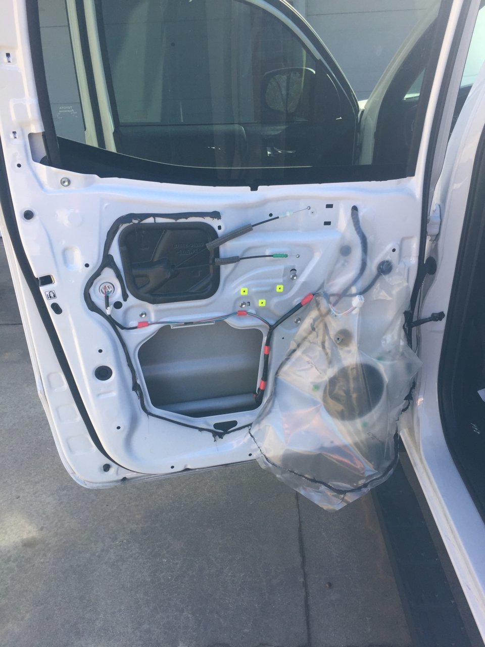

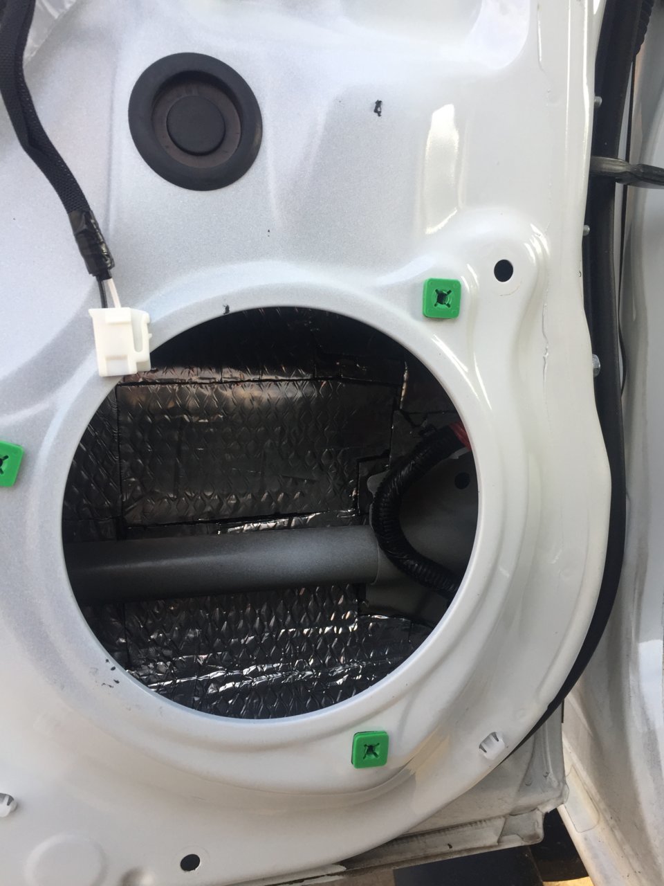

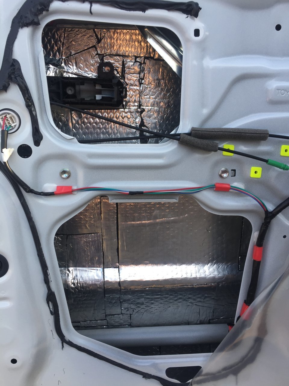

    Knocked out one of the passenger doors with some sound deadening & a new kicker speaker.

    What wiring harness do you need for changing the speakers ? I had a little help from a 2nd gen owner but the harness is different. Ive never really messed with speakers much but I must admit....these are the worst speakers ive ever seen in a vehicle...especially a newer 30+ thousand dollar vehicle. Ive got to do this mod for sure, hehe

    These make it a plug-n-play

    Gonna have to do some sound deadening myself to quite down the sounds of the tires and exhaust. Do you recommend the type you used?

    I have a question that I need help with. If the doors are made to weep or drain water that gets beyond the window gaskets does the sound deadening material
    1.) allow water to get trapped between the door skin and the deadening material?
    2.)is the deadening material capable of absorbing water?
    Absolutely no experience applying deadening material hence my ignorance. o_O

    The sound deadening material is very similar to black tar and covered with an very thin sheet of aluminum foil. If its rolled on correctly water cant get between it and the door. Its basically water proof.

    Pretty much what I assumed but not ever having any in hand had to ask. I'm guessing that you would also apply it as closely as you could below the window gaskets. Thanks Bud for the quick response, appreciate it. Hate being ignorant about some of the mods being done here.

    We all learn new things everyday and easiest way is to just ask. The recommended application is 40-50% coverage with this. I did about 90-95% of the entire interior and both inner and outer metal door panels then covered by dynaliner for heat/cold and a little more sound. Overkill but I had it on hand and why not. Lol
