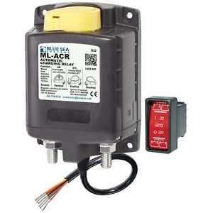

    Look into redarc or C-tek dc to dc chargers....I really think they work better with our alternators and are better for battery longevity over all. Those smart Isolators seem to work "good enough". Im no expert either but im going DC to Dc when I do it.

    I've had these for a while. Really happy with them. Not expensive either.

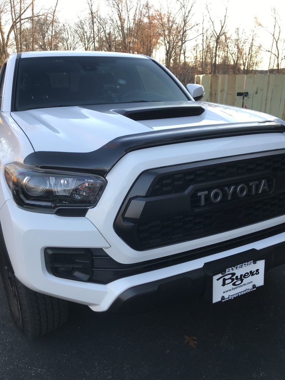

    Quick addition of bug guard to my Storm Trooper LOL

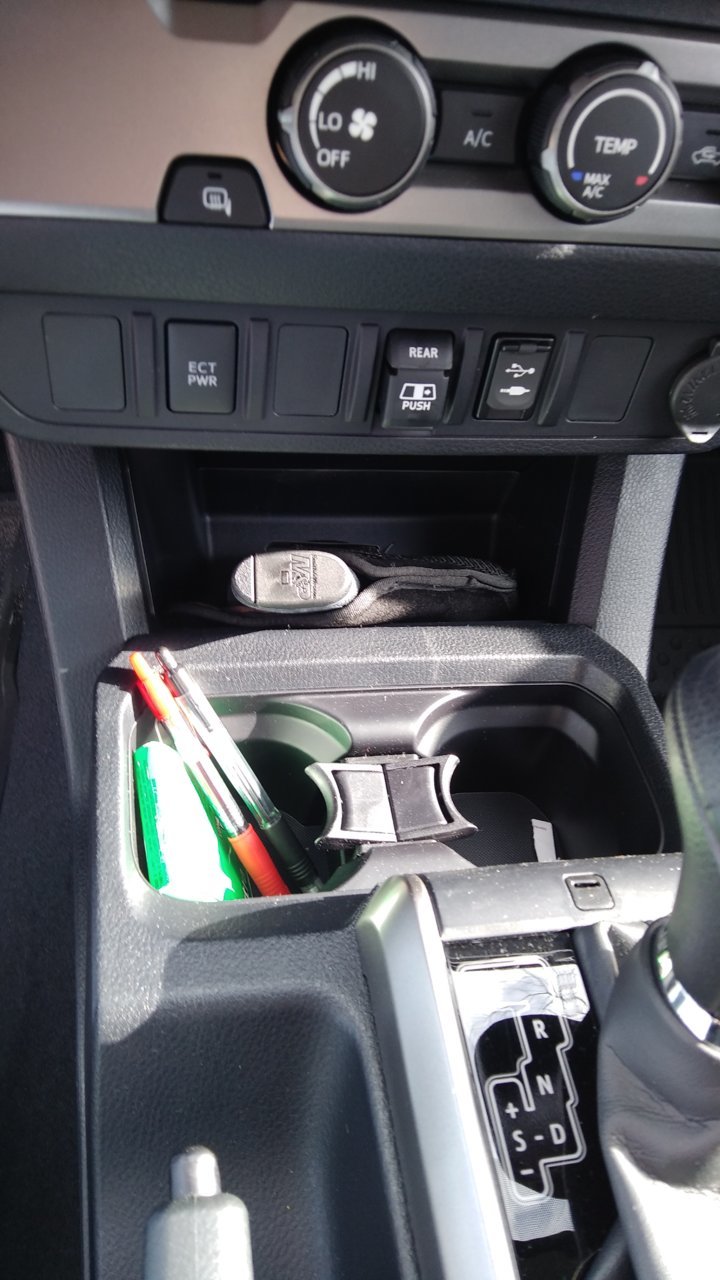

    Added RAM style phone mount
    Geaux Tigers!

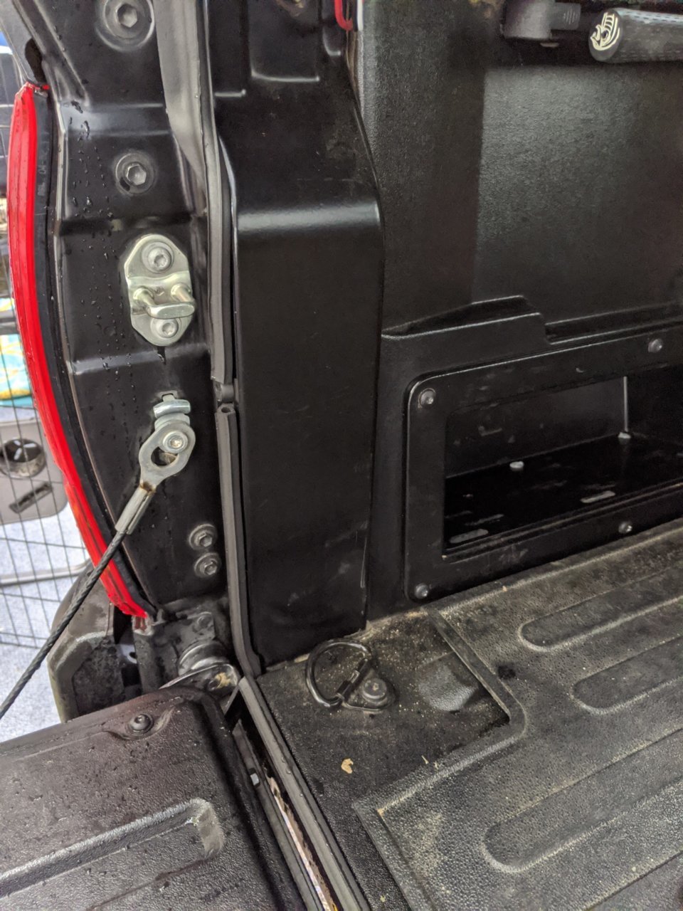

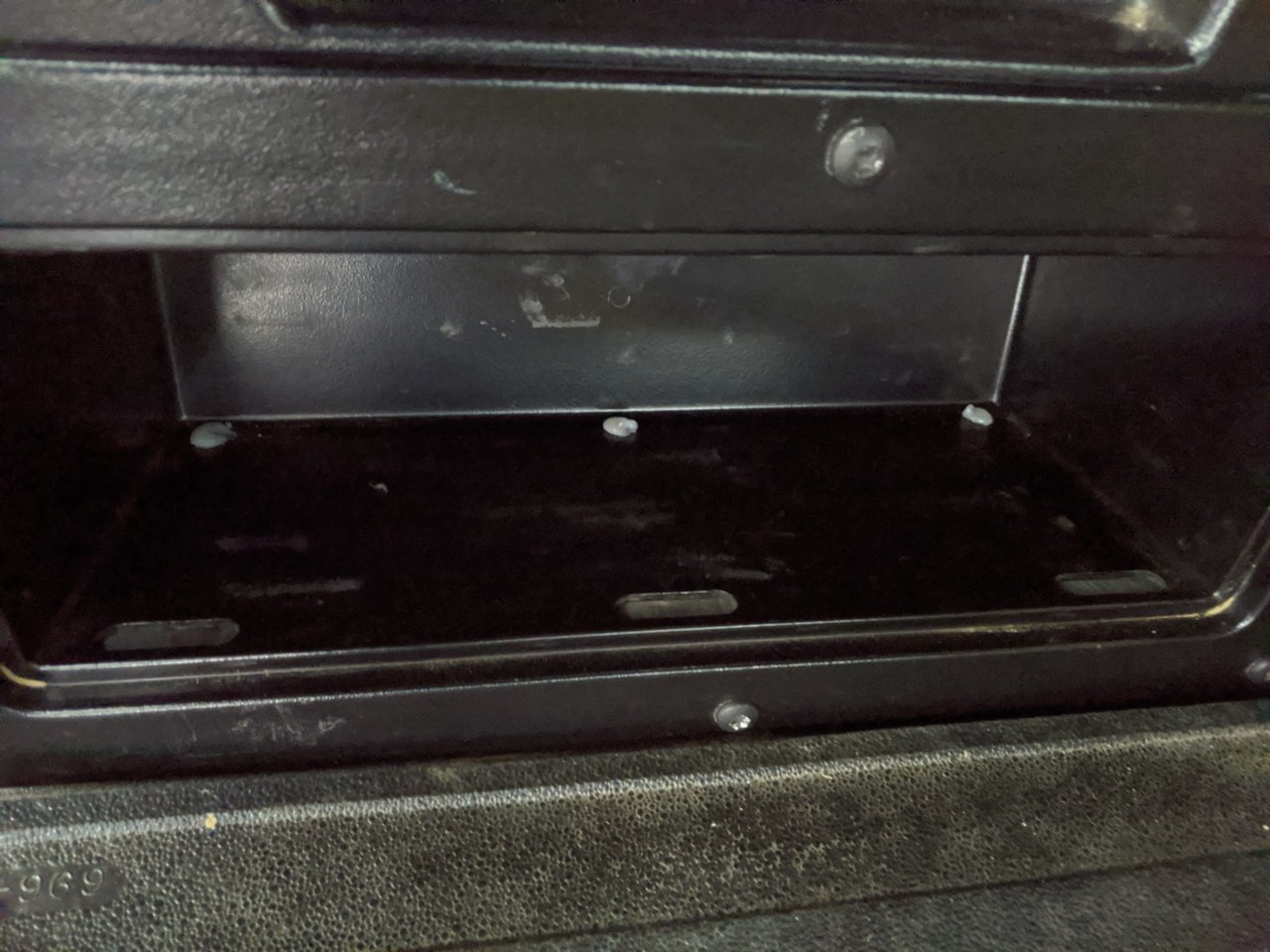

    Meso turn signals, ESI tailgate seal, and I sealed up the bed cubbies. I used silicone to plug the drain holes, then taped bike inner tube to the outside of the larger holes. The bike tube allows flexibility for the latches to move, yet keeps it sealed! Trying to decide if it's worth running a bead of silicone around the outside edges of the cubbies, but dust coming out of there seems negligible.
