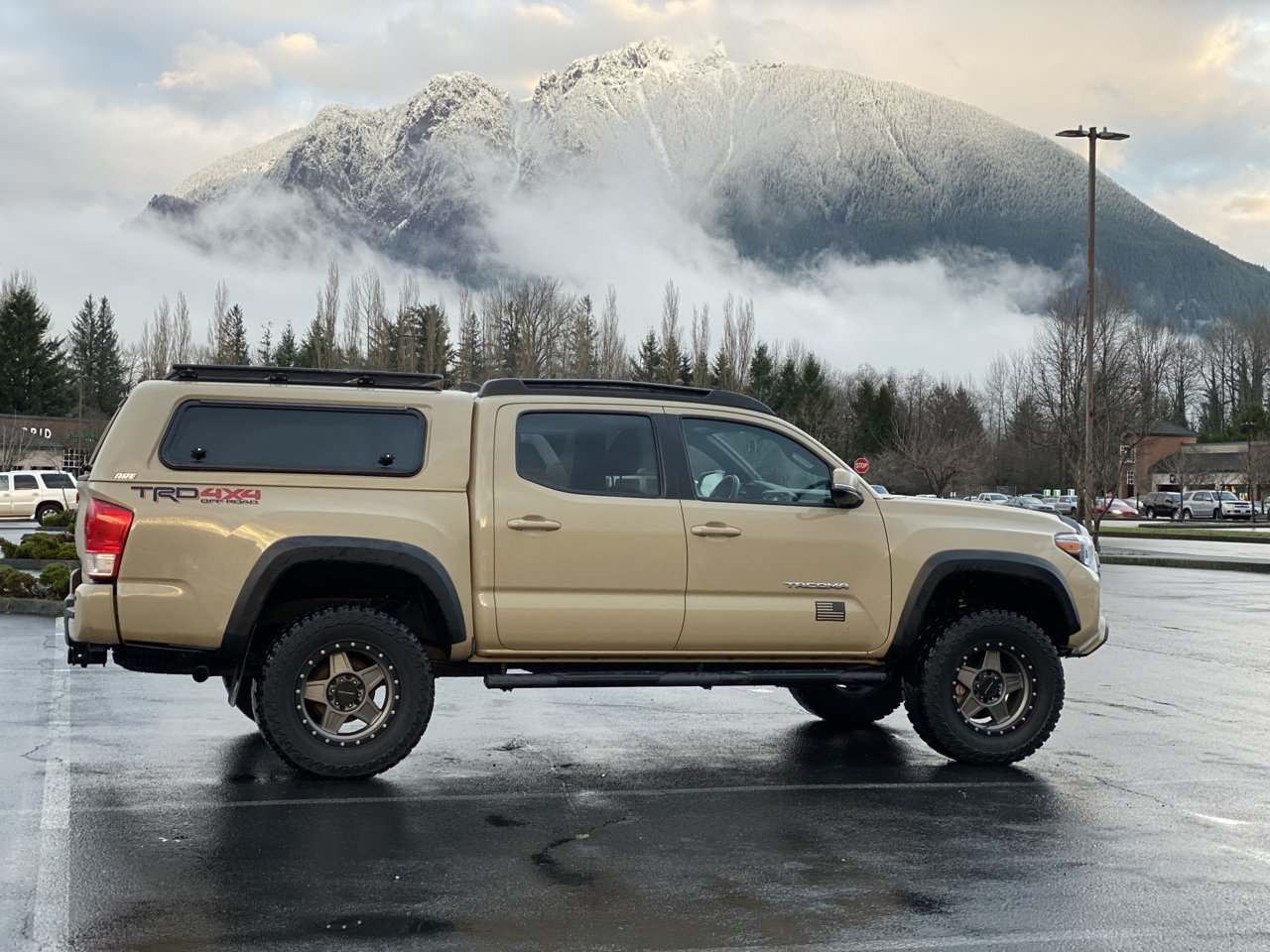

    Took her on a mini-trip and hauled some gifts back from the mountains today! North Bend, WA

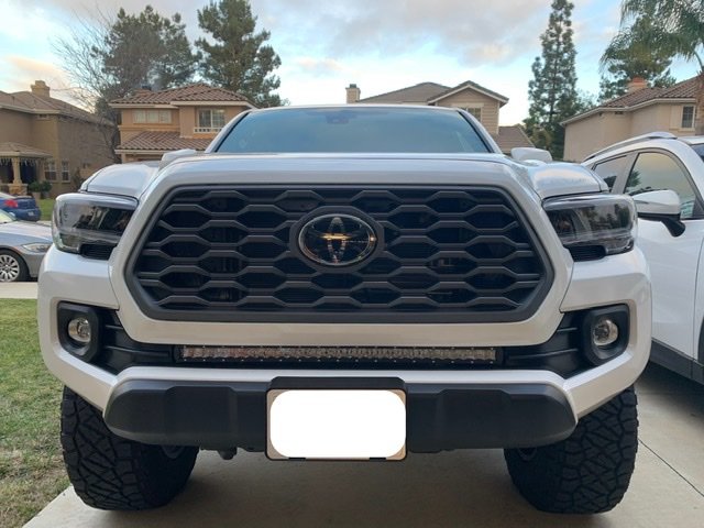

    Information on your grill please. I have been looking for something like this. If all else fails I can just order the black trim ring, and put it on my charcoal greyish/kinda chrome but not, grill. But would like to have an all black grill that accepts the front emblem sensor

    looks like a stock 2020 TRD grille

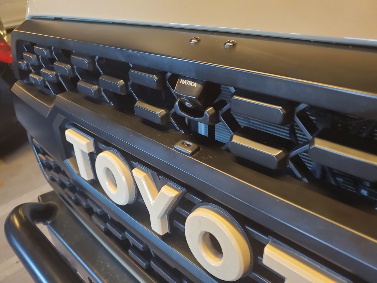

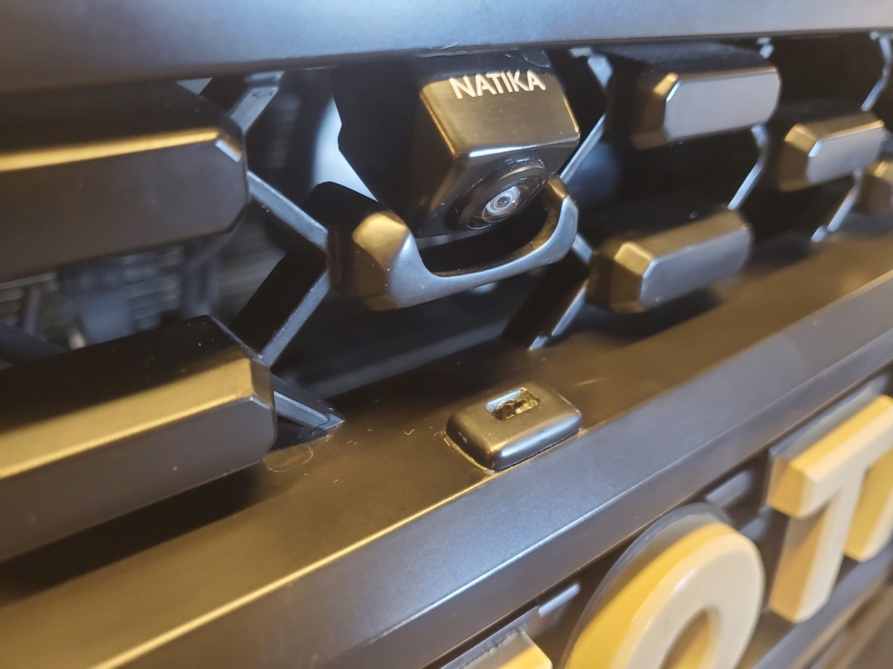

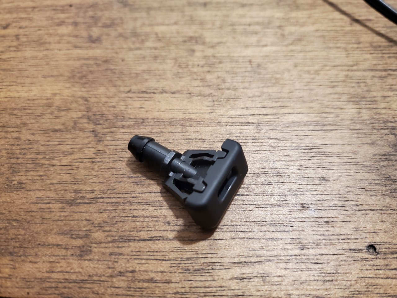

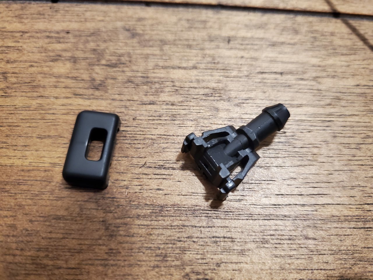

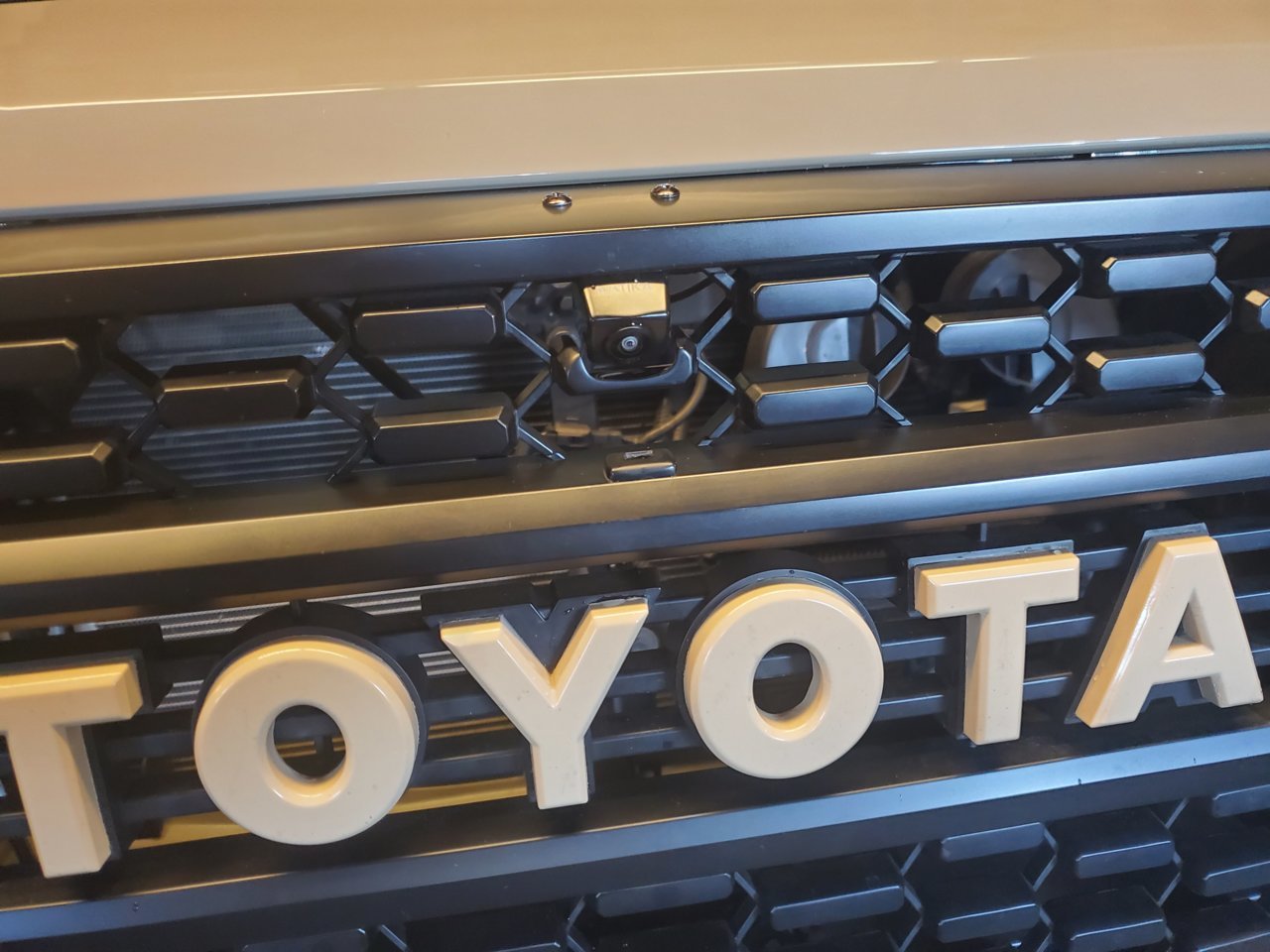

    Have my anytimebackupcamera harness ready to go in. First decided to work on figuring a good place to mount the camera considering I have a C4 LoPro with hoop, and needed to get the camera in a location where the hoop would not interfere, but also hopefully be just visible (similar to how rear bumper is visible in rear cam) since it is the leading edge of the truck and nice to see it for inching up on things like walls in parking garages.
    One of my thoughts about installing a front camera is it'd be great for parking lot and town work (being able to see cresting over parking garage ramps which I deal with a lot), but could spend a lot of time being a hassle off road due mud splashing up on the camera, requiring frequent cleaning by hand. Most of my off roading revolves around hunting season. Which means rain, snow, mud...and lots of it, with a lot of mud splashing on the front end, limiting usefulness of a front cam, or at best having to stop, get out and clean it anytime I'm about to crest a hill and would like to use it. Yeah....like that's gonna happen every time. Problem solved...
    Now anytime I hit the windshield washers, the camera will get a dousing as well.
    May the Toyota gods forgive me for putting a part from a Ford on my truck, but it seemed to fit the bill for what I had in my head, and with a little modifying, worked out just right.
    Front camera washer for Ford Explorer Limited. Didn't measure, but the whole assembly can't be but about an inch tall. Perfect size for where I wanted it.
    Forgive the round head screws...all I had on hand. Will come up with a nicer looking screw head for the camera like a couple nice torx low profile flat pan heads, but this gets the camera on and adjusted for now. Overall am quite happy with how it went in...if not the time spent doing it.

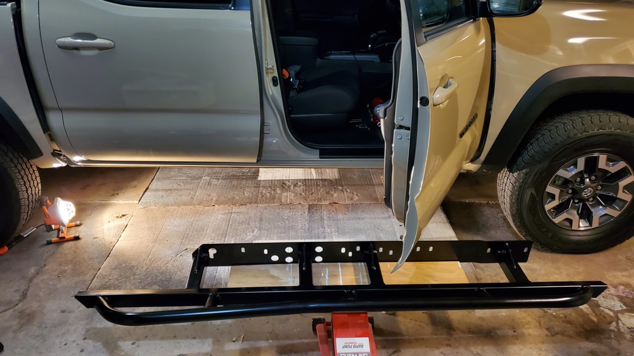

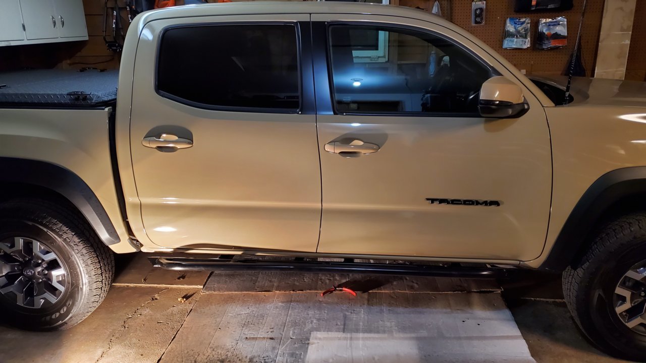

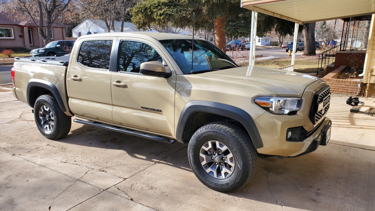

    Painted and installed some RCI sliders. Also touched up a ton of scratch spots on the undercarriage that had already started rusting. Feels good to use protection from now on.
    Also bonus pic of the neighbors Taco

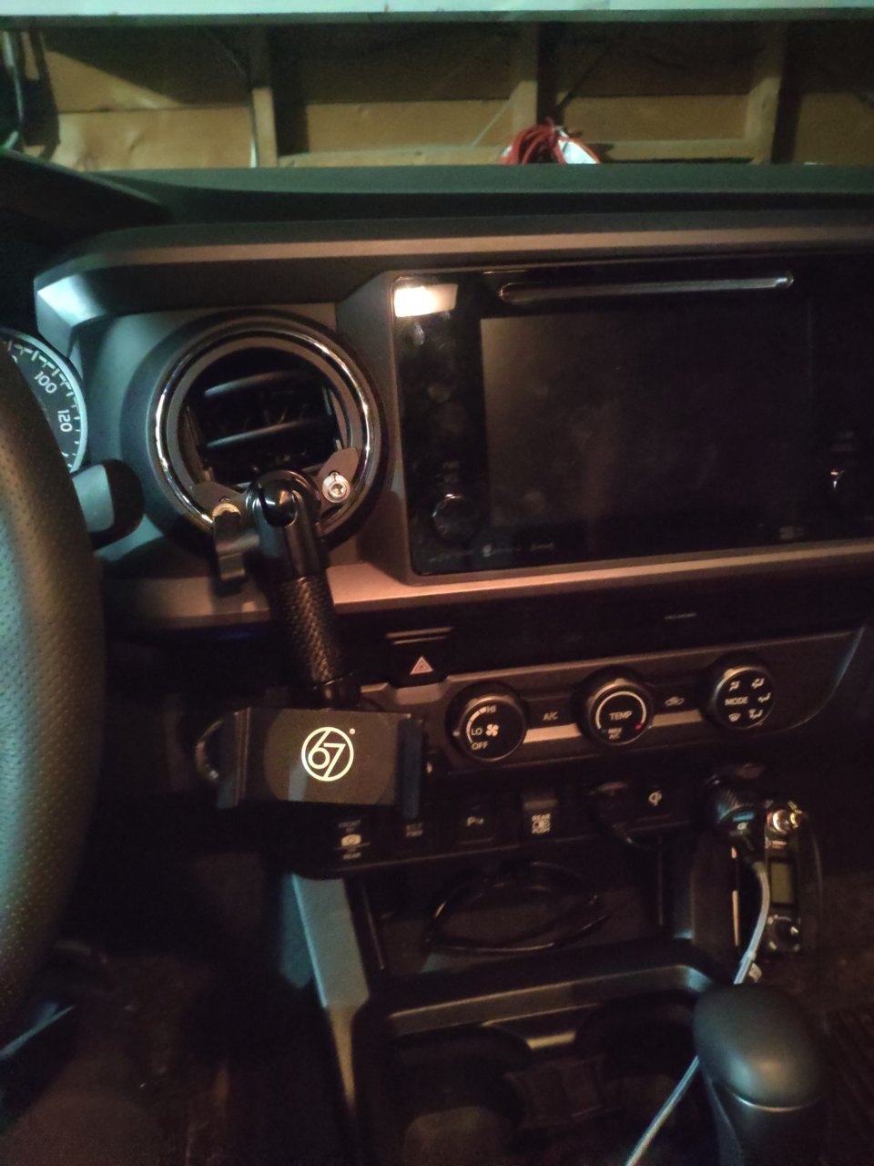

    Also installed this phone mount today. Hondo garage mount with 67 designs arm and phone holder. Love this setup!

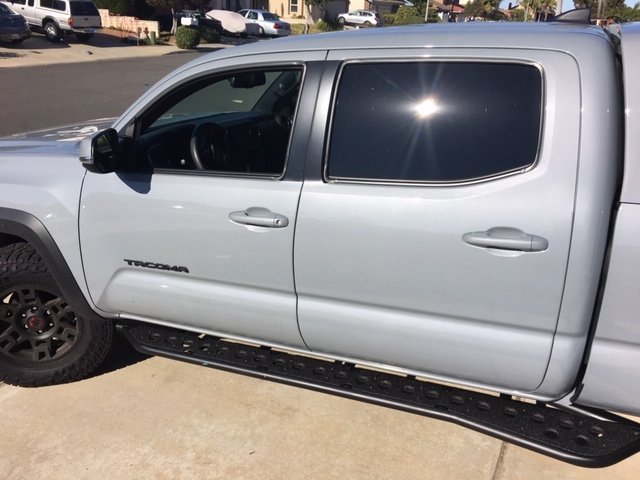

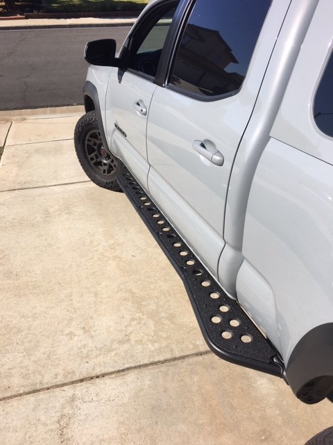

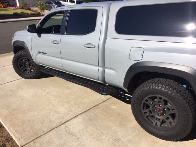

    Got some Cali Raised sliders on.

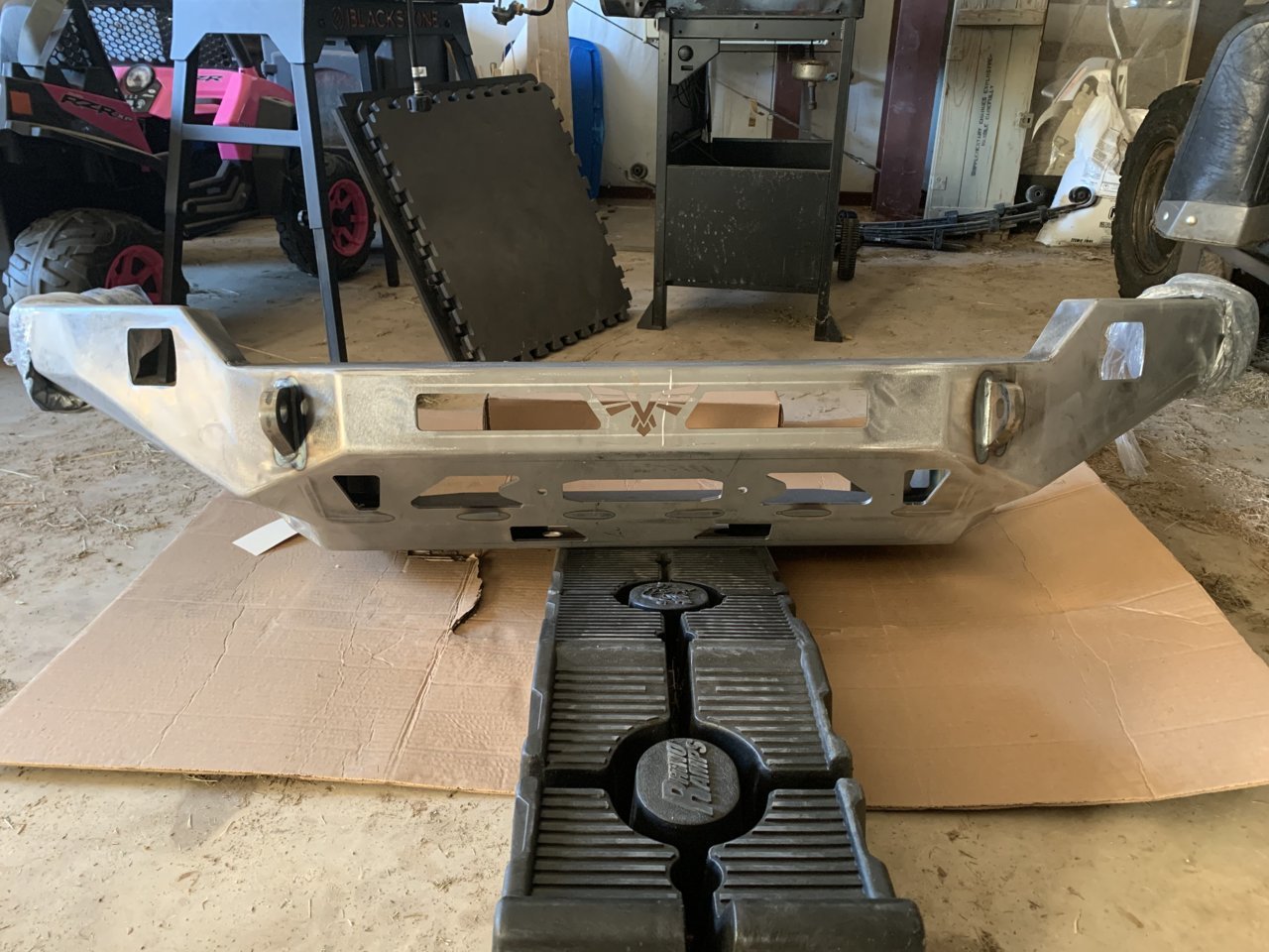

    Bumper and rock rails in from Victory 4x4. Looks like the bumper received some damage in shipping, but I was able to fix it fairly easy with a sander and file. Hoping to get it prepped and coated throughout the week.
