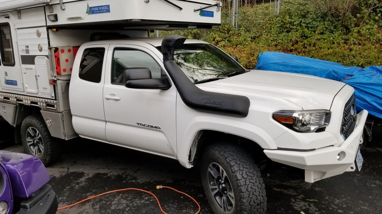

    You forgot your snorkle.

    Yea that may be the next mod on the list

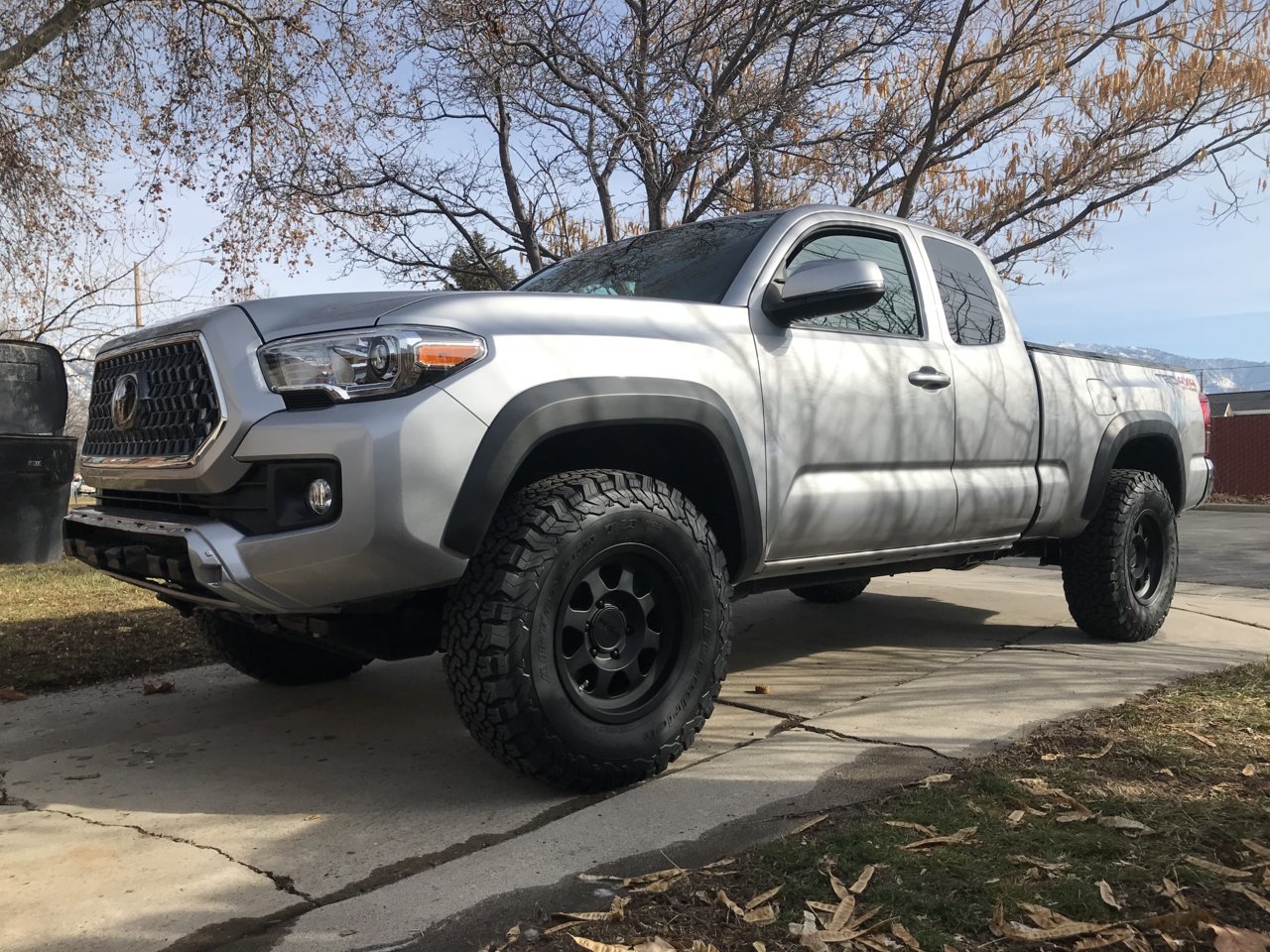

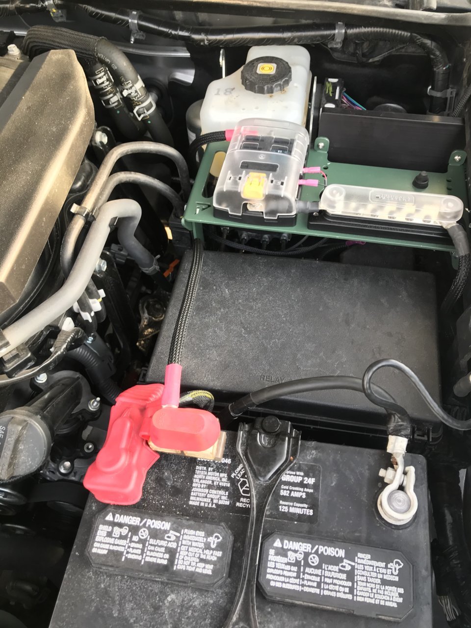

    Started out the day by getting some new shoes 265/75/16 ko2s on method 701s no rubbing with stock or suspension.
    905FD286-BDC5-4D1E-979D-B483F010D8C9.jpgthan got home and was hyping out on the truck so started the install of my PowerTrays

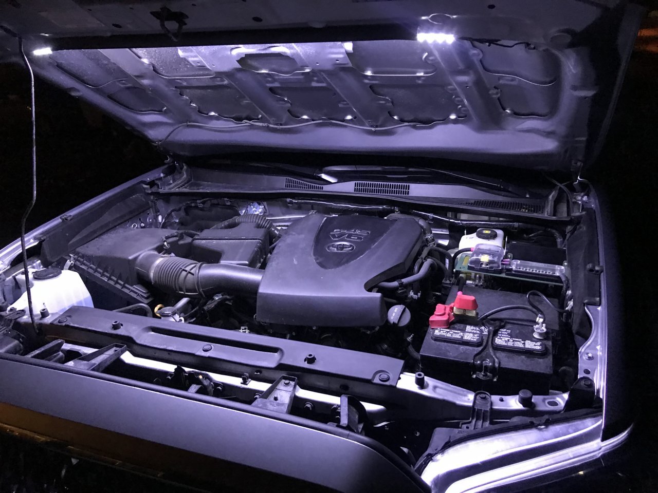

    061E343E-4608-4851-9A14-E50636D26882.jpg Than decided I better install my mattgecko leds So that I could see while I finish hooking up the switch pro and my ham radio DAD67C14-D92F-449A-855A-B79534CC450C.jpg

    Where did you get the power tray? It looks nice!

    thanks! got it during @powertrays Black Friday sale. It is the new vertical switch pro PowerTrays. I painted it green

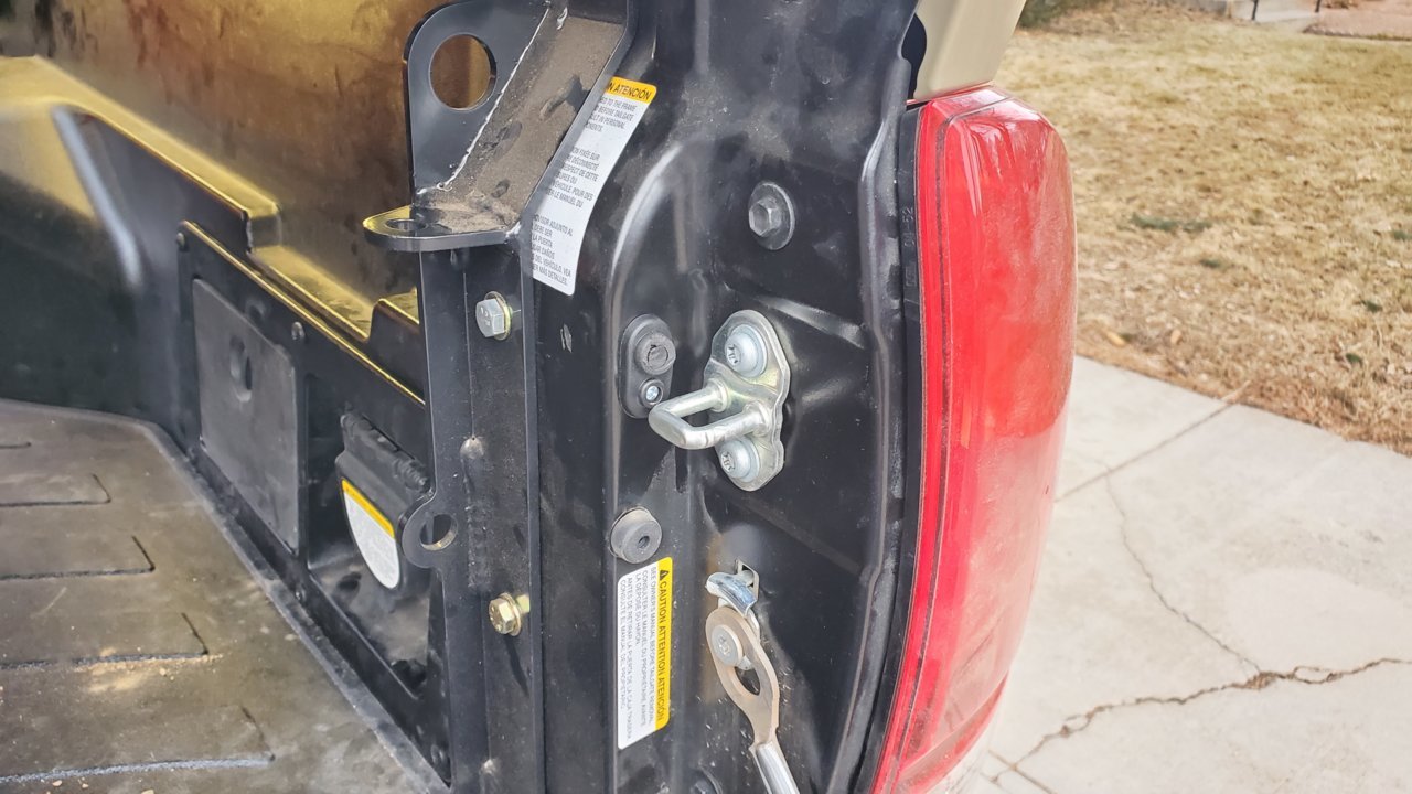

    Here's the switch I used. Had to cut it down super short to be able to fit between the bed and the tailgate. https://www.amazon.com/gp/product/B001TQPM6Q/ref=ppx_yo_dt_b_search_asin_title?ie=UTF8&psc=1
    The bed stiffeners rock! Love the additional tie down points, which have already come in handy.

    Yeah I can't quite picture where you'd put it that would allow it to activate and deactivate on its own. Could you post a pic? I've been looking for a clean way to do bed lighting for a while and this is a great idea :).

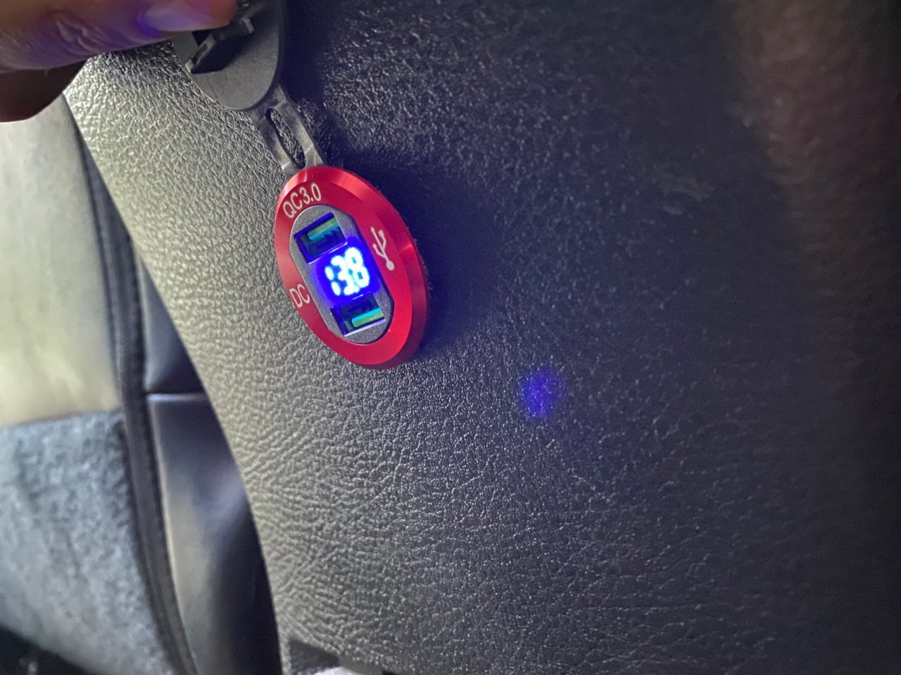

    Here you go: Quick Charge 3.0 Car Charger,... https://www.amazon.com/dp/B07GKK9HZT?ref=ppx_pop_mob_ap_share
    Just remove the console (2 bolts on the bottom) and the shift/e-brake panel and tap into the lines for the outlet in the console. Drill a hole in the back, install, reattach the panels. Bam.
