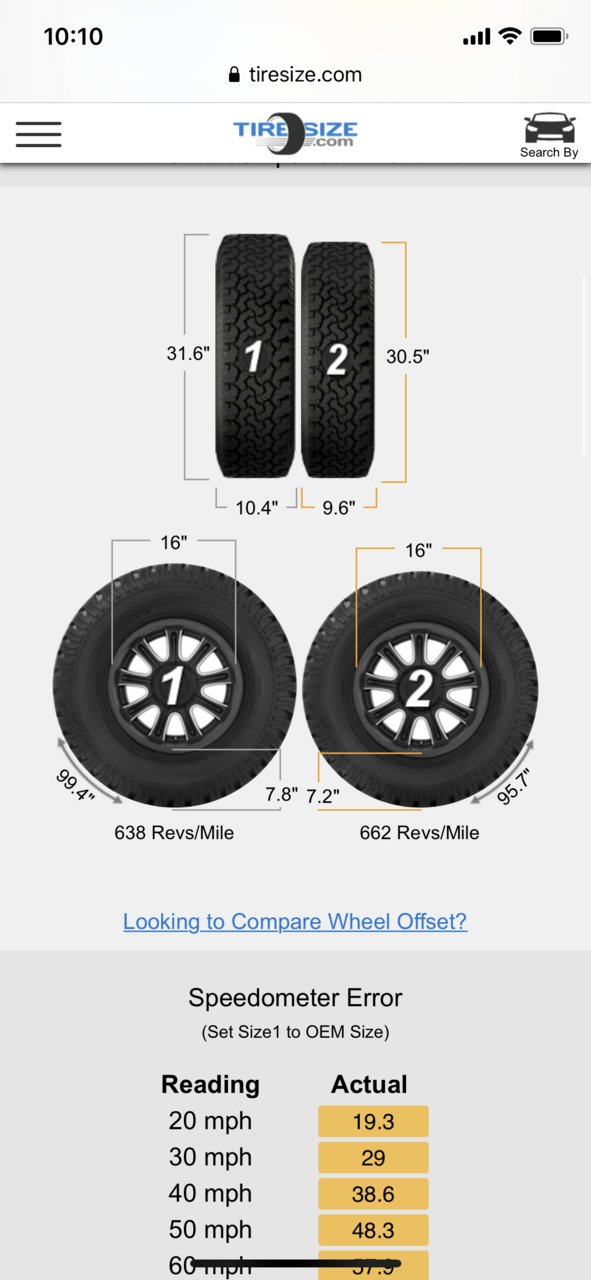

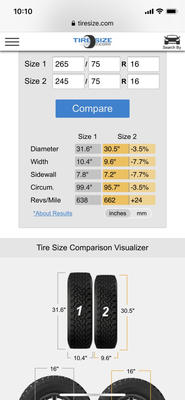

    Just an FYI, the number you have in bold isn’t the diameter of the tire, it’s the aspect ratio. So in your case the 75 means that the sidewall height is 75% of the tire width. So the two sizes you mention are two different sizes.

    Good to know. for emergency purposes i think he will be fine to make it home or to a gas station (primary function of a spare)

    My last truck I ran a matching tire and wheel. In all honesty, when I upgrade this time. I will keep the steel spare and throw on a cheap tire with the same diameter. Why? One, because I rotated the spare into rotations but I think it was Unnecessary. Also you don’t know how far you will have to travel on that spare, especially on a trail or in a rural area. A sub $150 tire should be fine for that, why limit a self recovery scenario.
