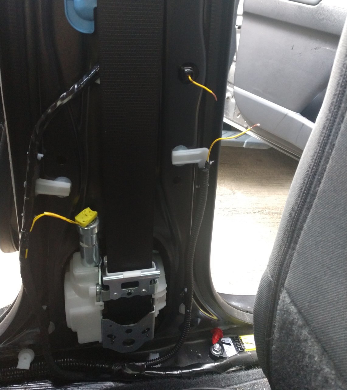

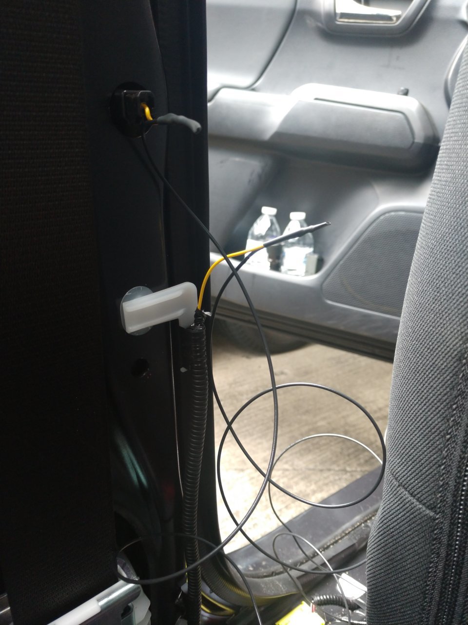

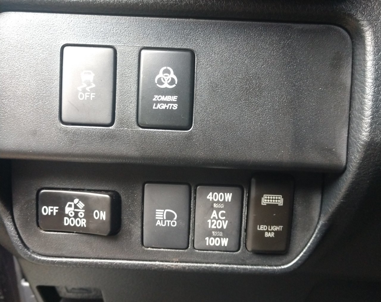

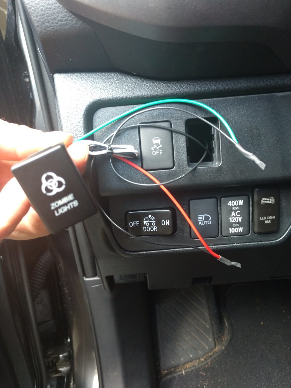

    Today installed a bypass switch for the driver's side door-ajar switch.
    The constant beeping when the driver side door is open and you are in accessory mode is extremely annoying to me. Some people it doesn't seem to bother at all, but I'm one of those people that it drives me crazy. I would just like to be able to hang out, listening to music or having the truck in the accessory mode for any other reason with the door open and not be constantly BEEPED at.
    In my second gen Tacoma I just disconnected the switch connector from the outside behind the actual switch. This made the truck think the door was always closed, and solved most of the problem. In this third gen truck, when you disconnect the switch connector, the truck thinks the door is always open.
    So the option I went with was to cut the wire and run it to a switch. this way I could just turn the annoying chime off when I wanted to, and still have the option of the truck knowing whether the door was open or closed during normal operation. I pulled the trim off, cut the wire, and then ran two wires underneath the trim along the side of the door and then up to the switch panel where I had an empty switch position.
    After looking around, the only switch I found that I liked was the zombie light switch off of Amazon for a few bucks. Nobody seems to make one that says "door chime" so... oh well. I think the zombie lights one looks cool.

    You can order custom switches from ch4x4... just say’n. :D:boink:

    Crap, now ya tell me! I guess now I have to find out what "zombie lights" actually are, and then get some to justify my switch purchase. This forum is getting expensive.

    I wonder if integrating this switch would bypass the auto shut off when you open the door with the remote start?
