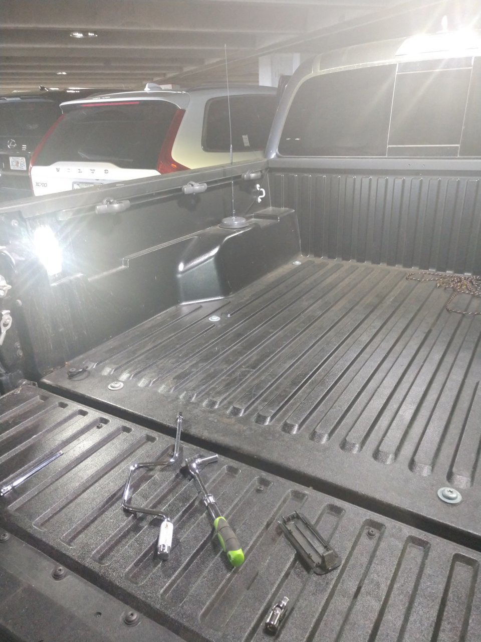

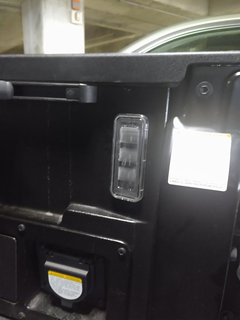

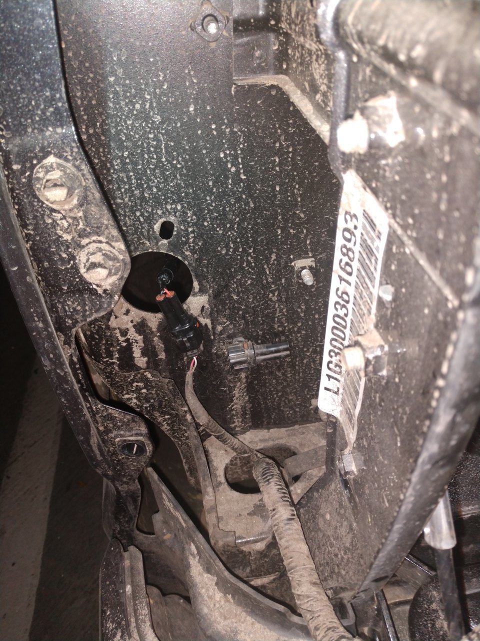

    Installed the OEM bed lights I got off eBay for $60 and free shipping. I have a 2020 OR, and it was the simplest mod I've done yet. Took me 11 minutes, and a 10mm socket.
    For anyone else with a 2020 considering this mod, I highly recommend it. It's such an easy lift. All the connectors on the OEM lights are plug & play with the connectors already mounted behind the tail lights, and already tied into your cargo light switch.
    IMG_20200306_094437754.jpg IMG_20200306_095610213.jpg IMG_20200306_095550106.jpg
