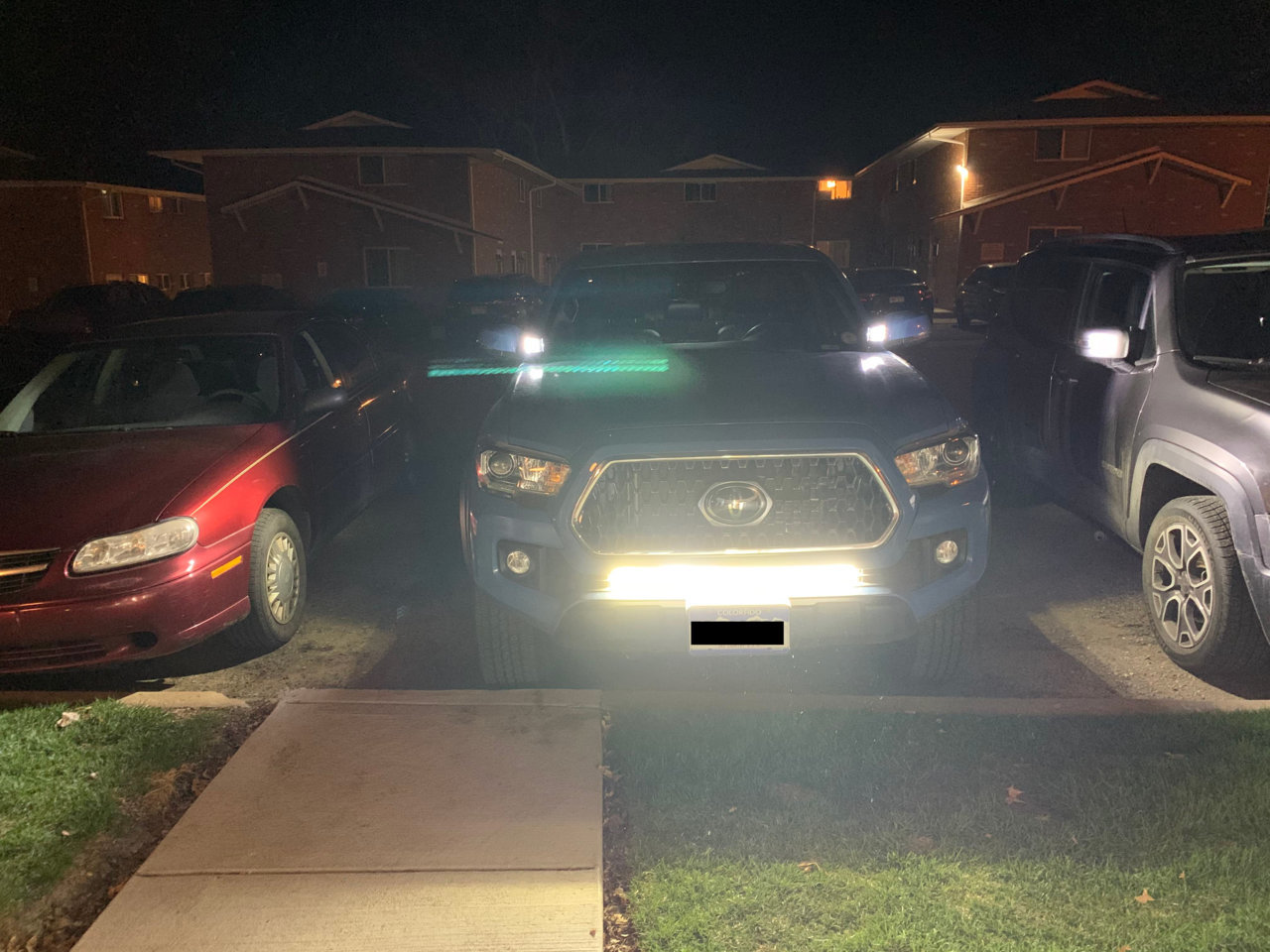

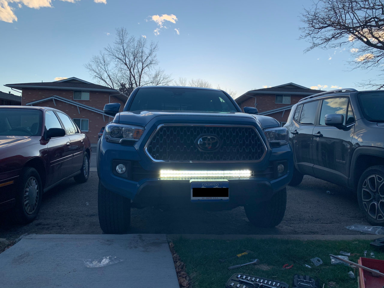

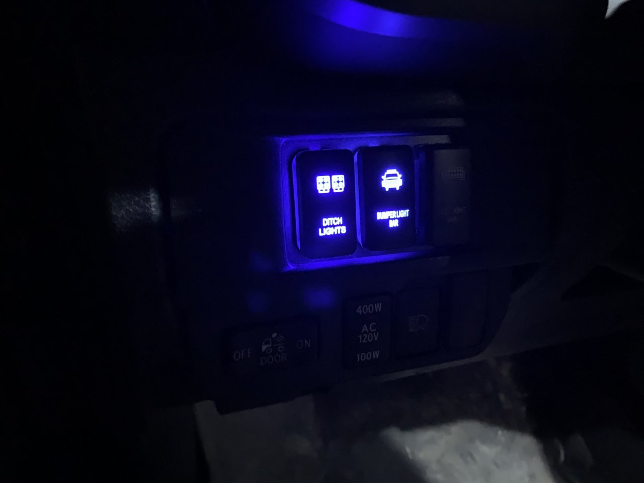

    Finally added some lights to my 2019 trd offroad last night. Went with the @CaliRaisedLed 32" light bar and bumper mounts, along with their 27W ditch lights. Also opted for the OEM switches so things are pretty in the cab. I am not a car guy so an easy/no-modification install was important to me. These puppies all bolted right on, didn't even need help from anyone (so made out to be a great covid isolation project). Took about 3 hours total to install and wire, could have saved some time if I had some wrenches along with my ratchet set. But hey, still got it in there! I am going to go back through and clean up some of the wiring today in the sunlight. Hard to do that in the dark with no garage. But let me know what ya think!

    You should use posi-taps to tap into wires(green and tan) of the cargo or power outlet switch so they can be dimmed. Switches looks kinda bright, and would annoy me in the night. Long term think about an aux fuse box so you don't have to wire your accessories to the battery. Change that pesky grill or dip it. That said you have done a good job! Loving the lights!

    Thanks! Yea I'll get a aux fuse box before adding anything additional, most likely when I decide to hardwire my dashcam - but that's a ways out. And definitely switching out the grill to the 2018 pro grill as soon as I can.

    I'm waiting on them to release the SR version, but they already have one for your model https://overlandequipped.com/collec...for-3rd-generation-toyota-tacoma-2016-present Its plug and play just the way you want it. For your dash cam you don't really need the fuse box. Get a hardwiring kit, some fusetaps and use your interior fuse box. You might have to get an extended fuse box cover if you like a clean appearance.

    Yea I have the stuff to do it with but stopped when it came to tapping the fuse box cover situation. I have a 3d printer and tried printing out new fuse box covers - works but, eh. Just not a fan of tapping wires. I have the BlackVue cam and they offer an adapter where I can just plug it into that large plug under the steering wheel - thinking about just going down that route so it is much more plug and play.
    Thanks for the aux power kit recommendation! Adding that to my wishlist
