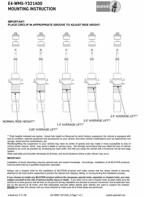

    Who told you that you have to have NEW upper control arms??? I have talked to technicians at both superior and Procomp, watched dozens of videos, and have read hundreds or reviews without a zero statement of having to replace upper control arms. Only question I have was what Setting people put their 5100s on when doing a 3 inch lift

    Do it how you want to do it. Although it’s a bit silly to get a suspension lift, not use it for actual lift and use a spacer lift instead. People are giving you advice to prevent you from wasting money and doing things wrong.
    The 5100s are capable of 2.5”. You will need UCAs to compensate caster, you will also likely need an ECGS bushing to replace your needle bearing. Feel free to not do any of those though. You can and should use stock coils for any of these adjustments. Aftermarket coils should only go on the bottom notch. That’s from Bilstein (Bill Stein/Bistien).

    Don’t you think by now I would already have that information and much more, The truck is getting lifted via the pucks, I’m putting the 5100s in at the same time because they’re a smoother ride and I have a original shock blowen out. I believe I answered my own question before asking on here, Was just looking to see what others had come across.

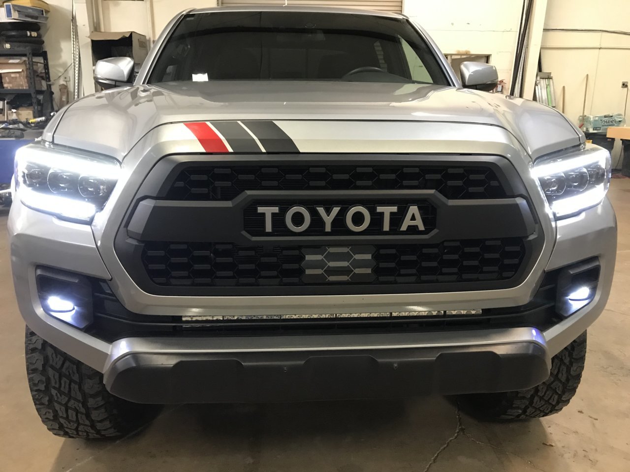

    Where did you get the vinyl stripes?
