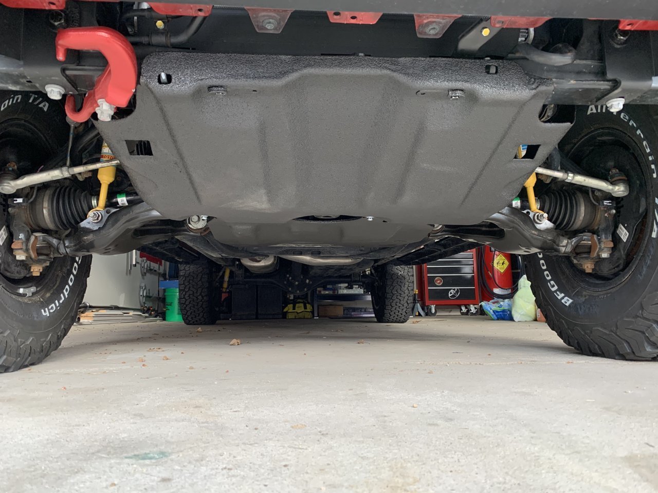

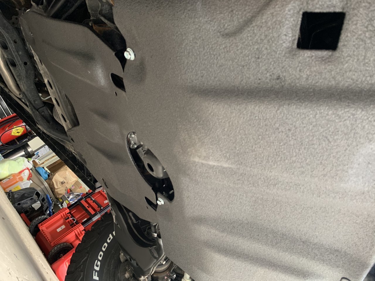

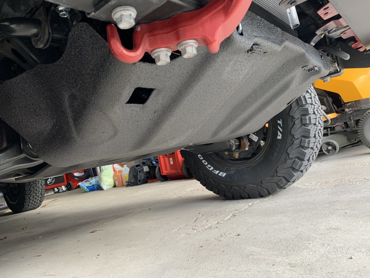

    Got my OEM skid plate LineX coated. I think it turned out good and it should hold up well.

    That's pretty sick, how much heavier is it?

    Nice tail hook. You into carrier landings ?

    What's the deal with the upside down tail hook?

    Clearing logs. It comes in handy

    I put it upside down just in case a rope or strap snaps it has a better chance of going under instead of upward. Plus it comes off and on easy.

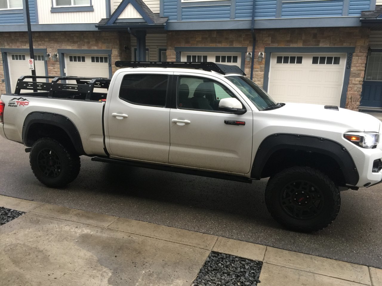

    Put Bushwacker fender flares on today. I think given I'm only at a 31 inch tire a 33 will fill the wells out a bit better. Didn't bolt them on at this point...just feeling them out a bit. As I have spacers and the negative offset by the wheels it does take care of the fenders better.C3A1CABA-FF3A-4DDF-9989-65FFA859B98E.jpg

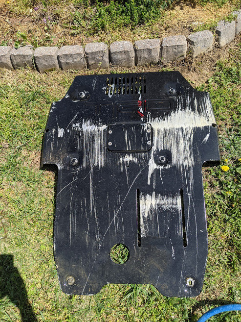

    Looks good. I just painted mine, it did not hold up well to the abuse. While I had it off today, I gave it another coat.
    Also had a pretty productive day wrenching. Pulled my winch line off to change out the traditional steel tube thimble on the end of the line. Went with just a loop to utilize my new Factor 55 load spool. Major pain to get the line off the drum and back on but a little soap helped a lot. Had to remove the bumper and everything, long day... And finished out the evening by installing my extended diff breather. Later on this week I'll be doing a CV axle, I took a stick to the boot over the weekend. I'll be swapping the boot out and keeping the stocker for a spare.
