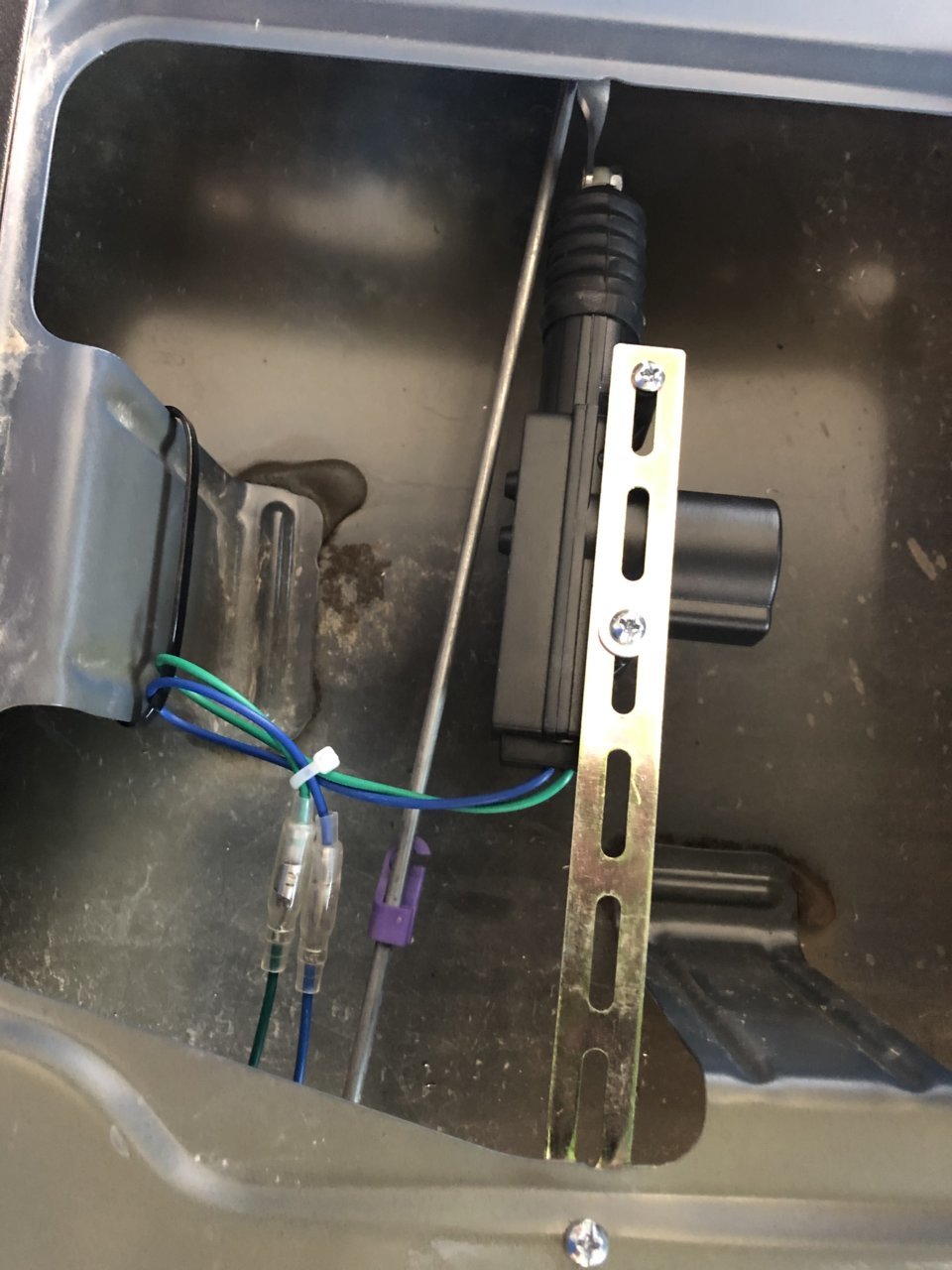

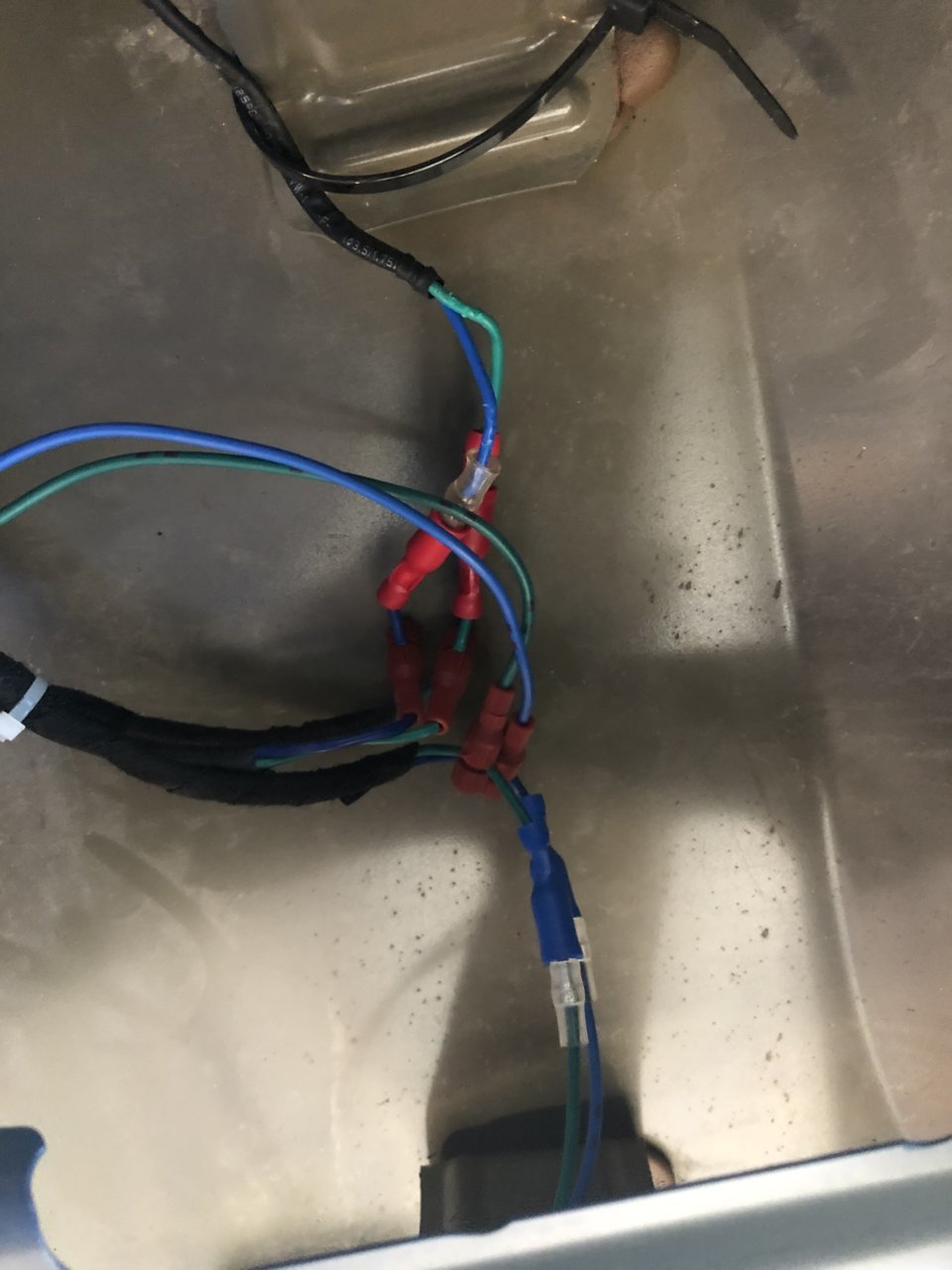

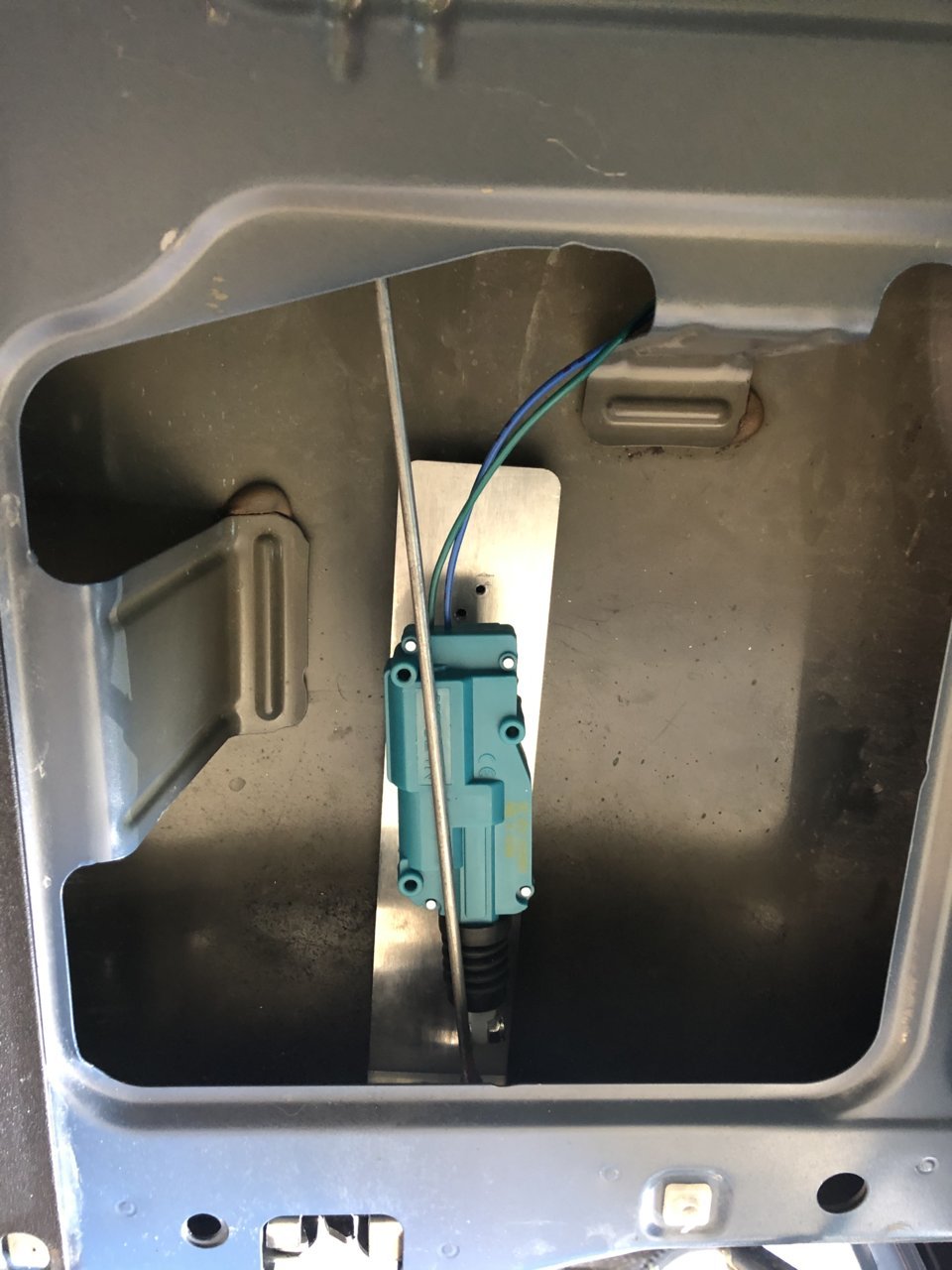

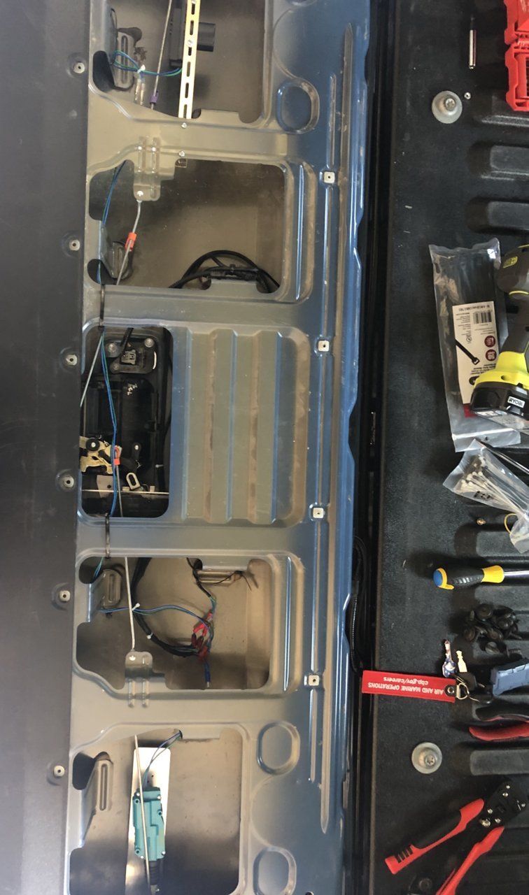

    r IMG_2787.jpg IMG_2788.jpg Reinstalled and added a second actuator to my KTJO Power Tailgate Opener.

    I'm ignorant. Why did you need a second actuator?

    The black one that comes with the kit is too weak to pull the latches. KTJO recommended the blue one from Amazon but after installing it today it still wouldn't pull the latches so I modified the original actuator to use the bracket from the blue actuator for twice the pulling power.

    I did as well but not sure if I would redo as a kit. The actuators are dirt cheap on Amazon and mounting is simple. The brain of the system which mounts in the cab under the passengers kick panel allows a pushbutton to be installed with a safety to insure the truck is in park. That is the more expensive part.
