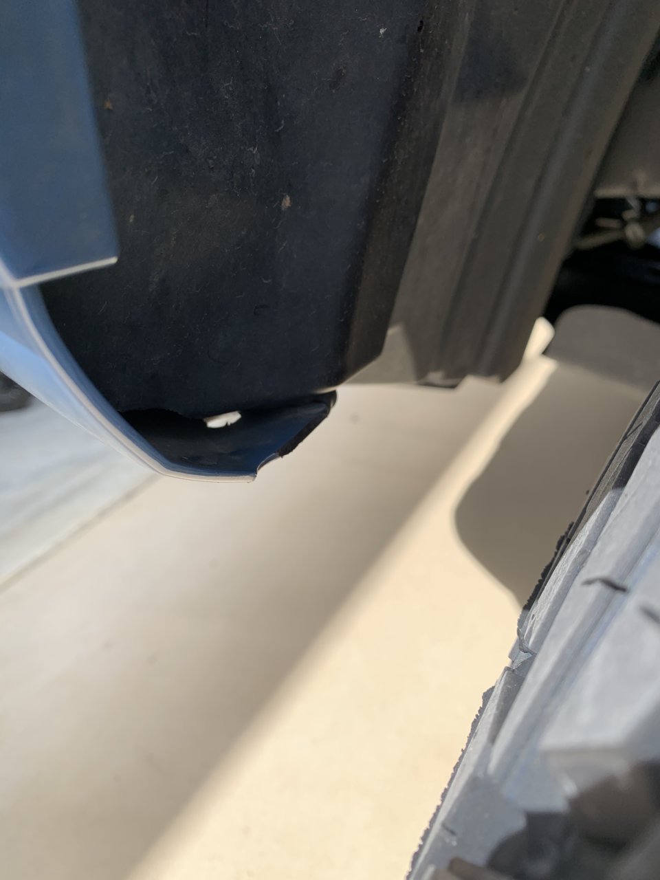

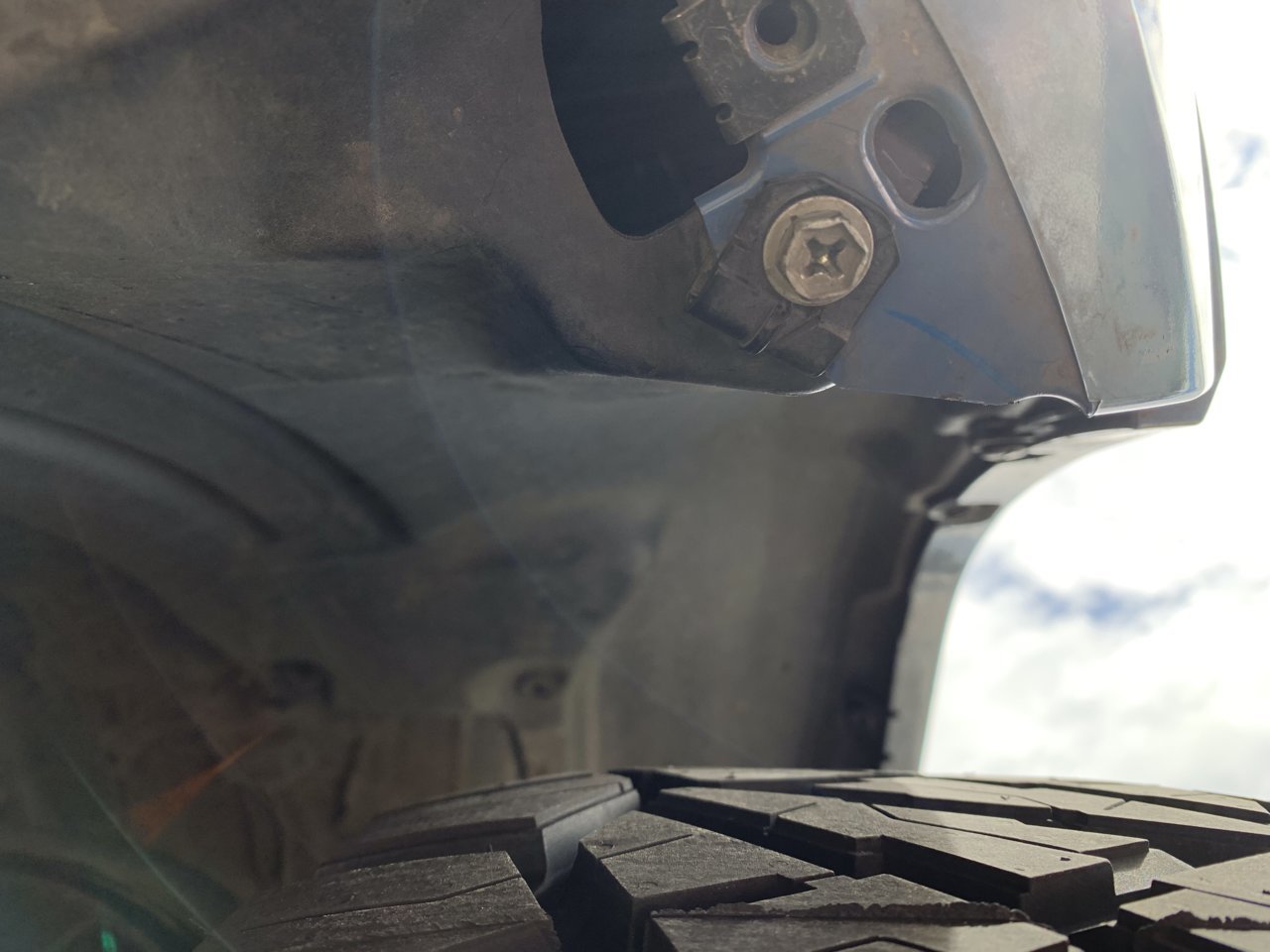

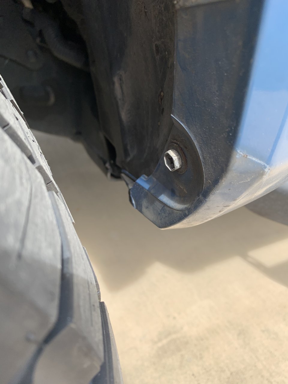

    You’re welcome. Discount tire told me the same thing. I showed them a picture of the guys truck with them on it and told them I was going to trim some plastic afterward. They still mounted them for me and even put them on the truck. I did have to remove the air dam so I could drive it haha

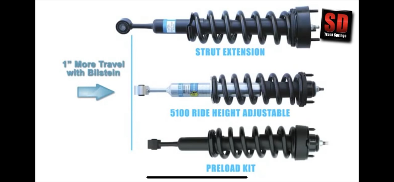

    If you just want a 2/1 lift, go down the middle and get 5100’s and a 1” block.
    While waiting for my last oil change, I found a video that went in to the differences in overall shock length based on spacers vs adjustable strut lifts. bottom line is spacers are garbage; you get more travel and less binding with adjustable struts like bilsteins.

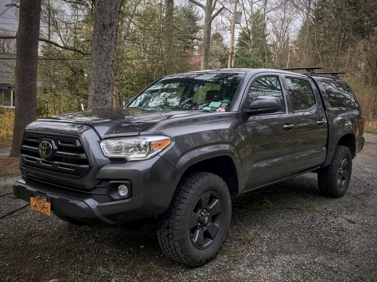

    Washed it. And removed the front valence

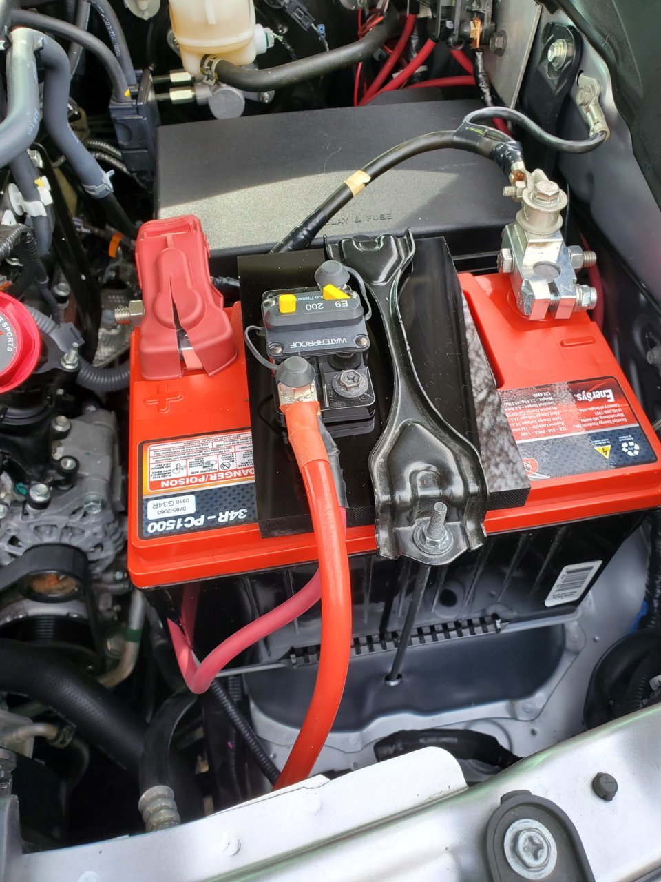

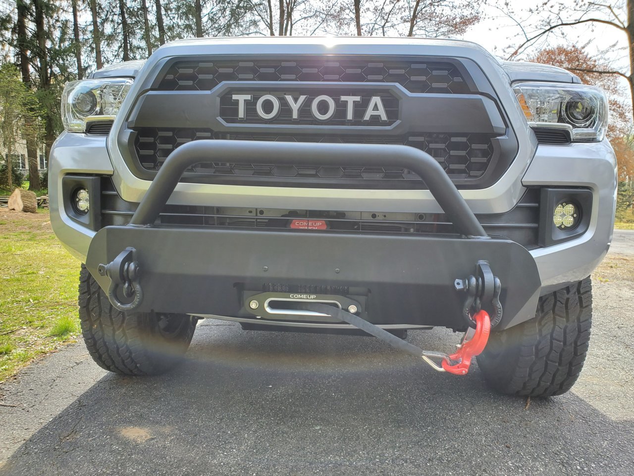

    New winch, long install

    I don’t, it’s on YouTube somewhere. search for spacers vs 5100’s I think. I screenshot that image because that’s the important part of the differences.
    A top spacer lifts the truck by making the overall length of the coilover longer. This puts a lot of stress on the shock and can damage crap.
    A preload spacer and 5100’s effectively do the same thing: preload the spring to make the truck sit higher. They take the same amount of effort to install since you have to take the coil over apart. But bilsteins are longer than the factory shock, so you retain full suspension travel plus have better damping rates.
    To raise the 5100’s set the spring perch at the highest clip for a 2” lift, assuming you have a V6 4x4 Double cab.

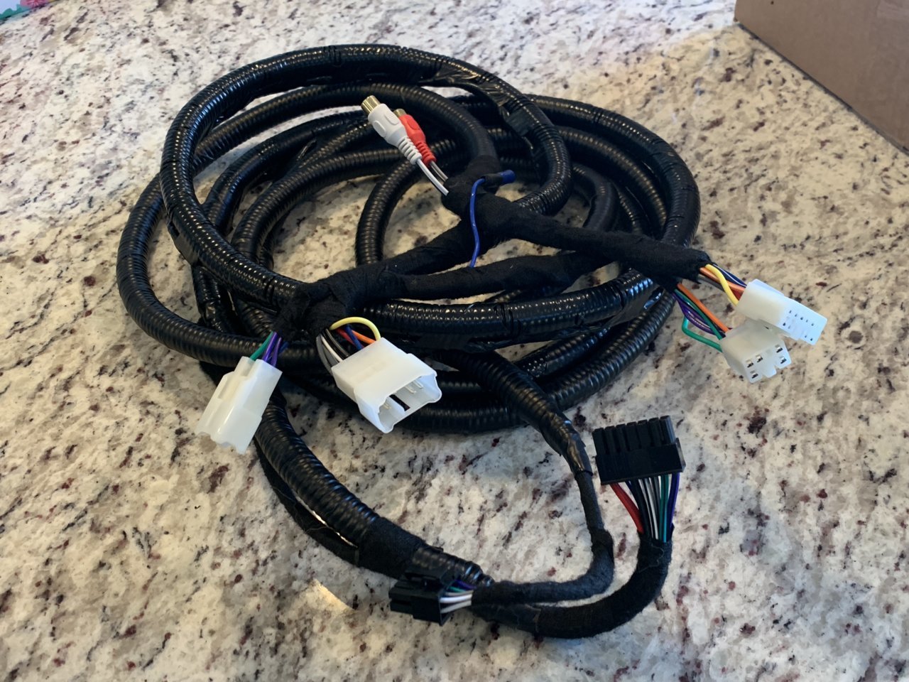

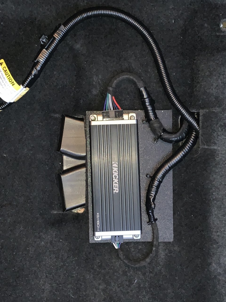

    Did you make the harness yourself? Hooked to the stock HU?

    My air dam has been gone. I have had to trim plastics on all of my other trucks so not a problem. I just don’t want to cut the metal.
