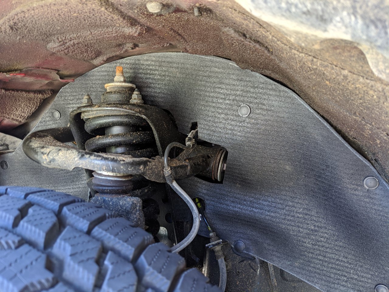

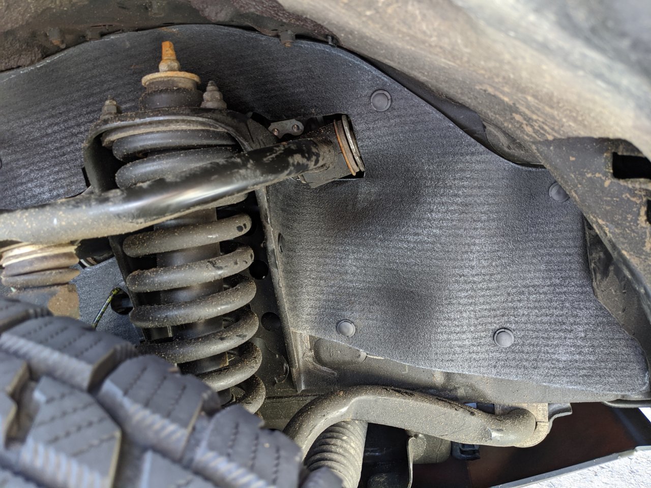

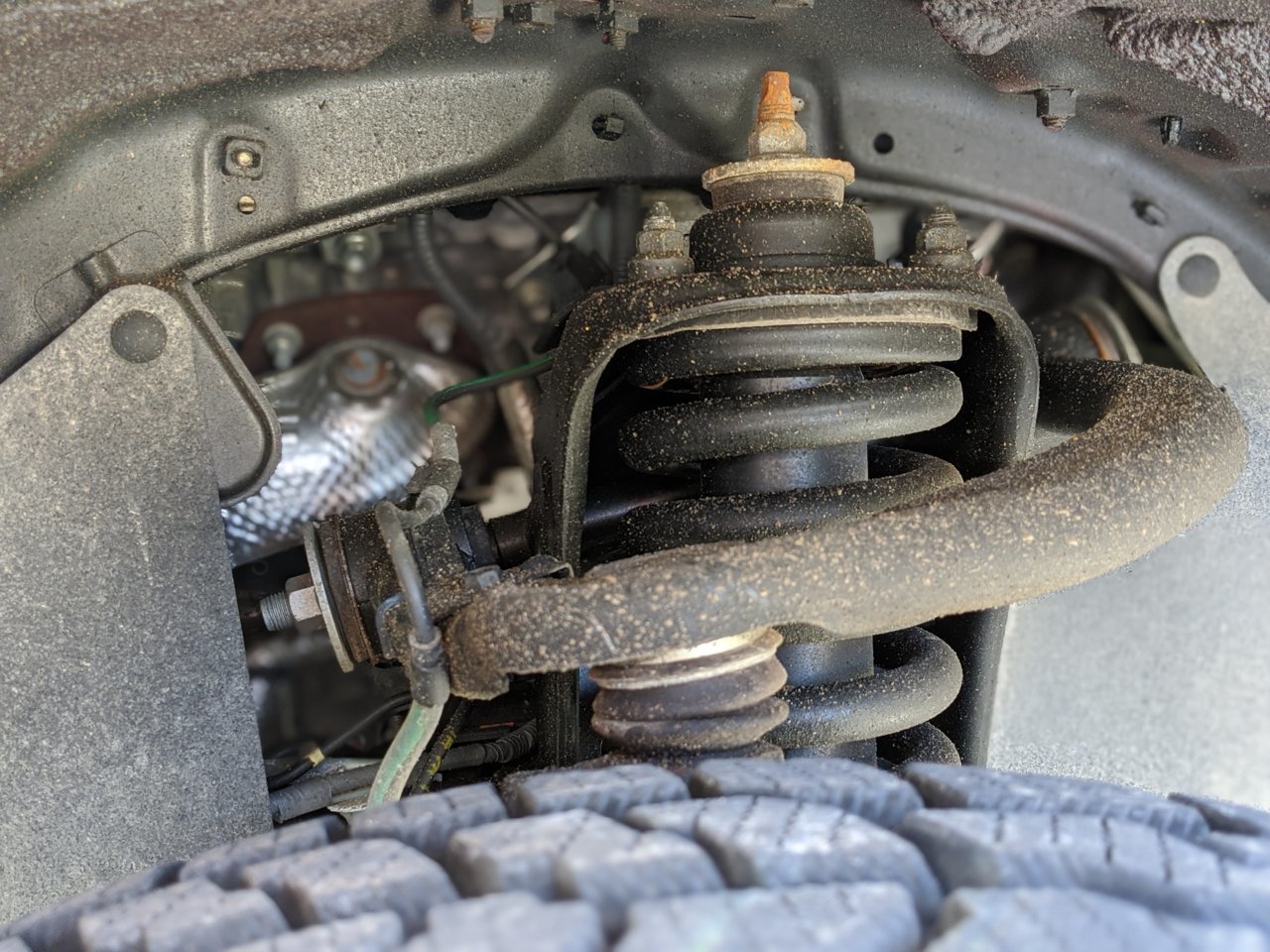

    Did you make your own template for the extended rubber inserts or did someone provide a template? Guess I should have looked at the link you provided already. Doing that now.

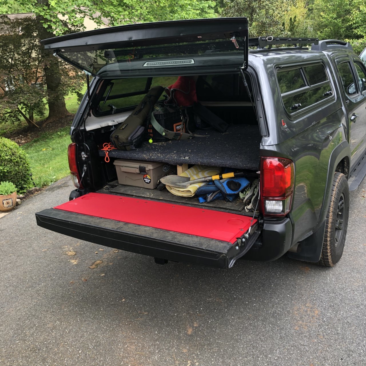

    Nice setup. What type of Cap is that? Looking for something similar for my long bed. Thanks

    It is the ARE DCU. Love it.

    Is it the same template for both sides up front?

    what material did you end up using from Home depot? i'll add it to the list of materials in the thread
    Template can be found in the first link he posted/ my signature.
    most of your questions can be answered there :thumbsup:
    same template for both sides, just one side of the template needs to be trimmed to accommodate a electrical loom of some sort on the 3rd gens

    It was just aluminum. I spray painted it with 3 coats self etching primer, two coats Rust-Oleum bed liner, and one coat semi gloss. Before the semi gloss it didn't quite match. Afterwards, matched perfect.

    Yup. Just flip it over if your material has a particular side you want facing out, otherwise identical.

    Great, I have some leftover rubber sheeting that I used for a fish pond. should be think enough.

    Thanks man! I'm really happy with the results, thanks for putting the effort into this, it must have been a bitch to piece together in the design phase. Great mod for a few bucks. Love it!
    I used rubber mat off the roll at Home Depot one side is molded with thin uni-directional lines the other side flat, I can't find the receipt with the sku# but I'm pretty sure it's an everyday item in the carpet/flooring section, it was cheap less than $15 cdn if I recall correctly. I bought a box of assorted panel clips from Amazon and there were enough of one that fit the holes in the truck. Longer than the stock clips and super positive retention. https://www.amazon.ca/Ginsco-102pcs...eywords=car+panel+clips&qid=1588780502&sr=8-3
