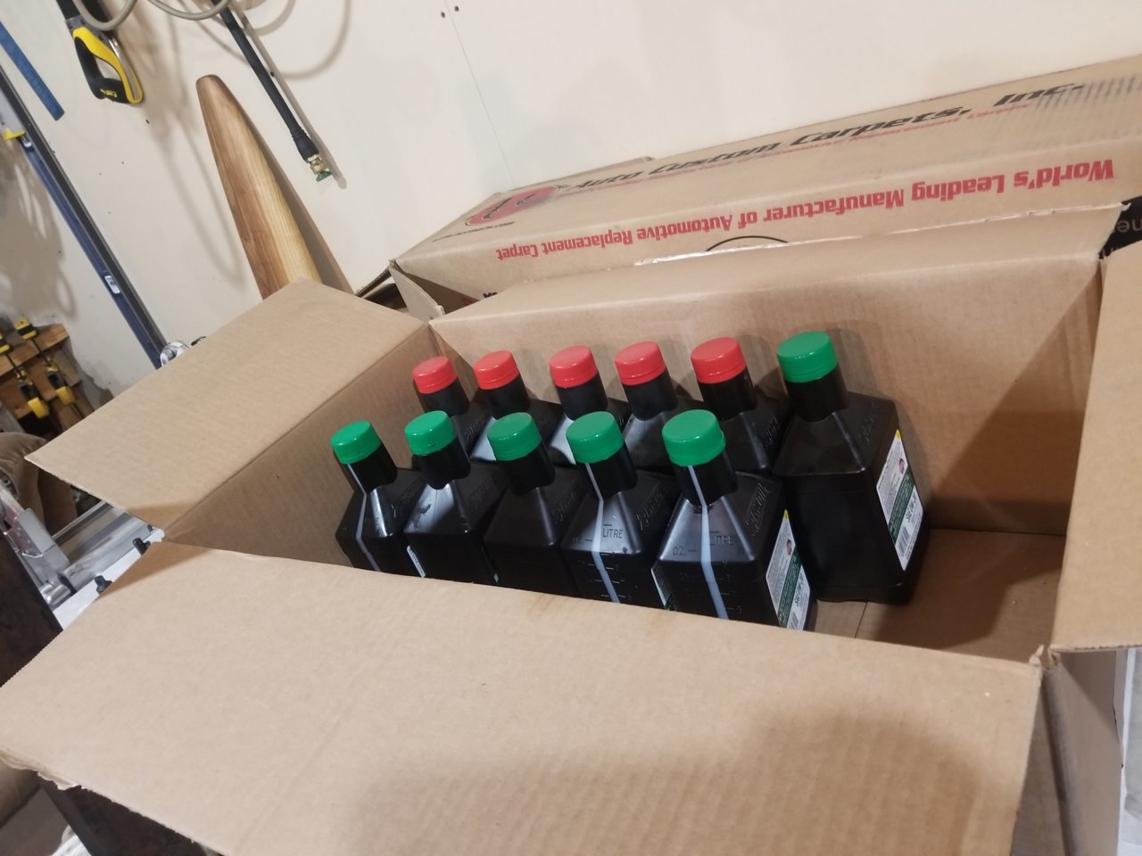

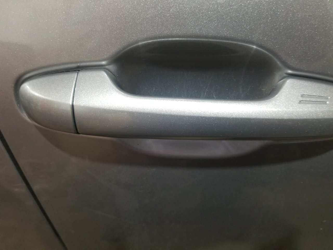

    Started to install pass side smart handle but had to order some more wire loom. then I figured since I'm fixing to roll past 100k, it's time to replace fluids front to back since I dont know the history of the truck. Was clipping along until the damn front diff drain plug. Damn thing is freaking stuck stuck. Cant decide if I'm gonna go buy a new plug and air hammer the old one out or suck out what I can with a fluid extractor and do a couple drain and fills until it looks good. 20200609_211019.jpg 20200609_164949.jpg

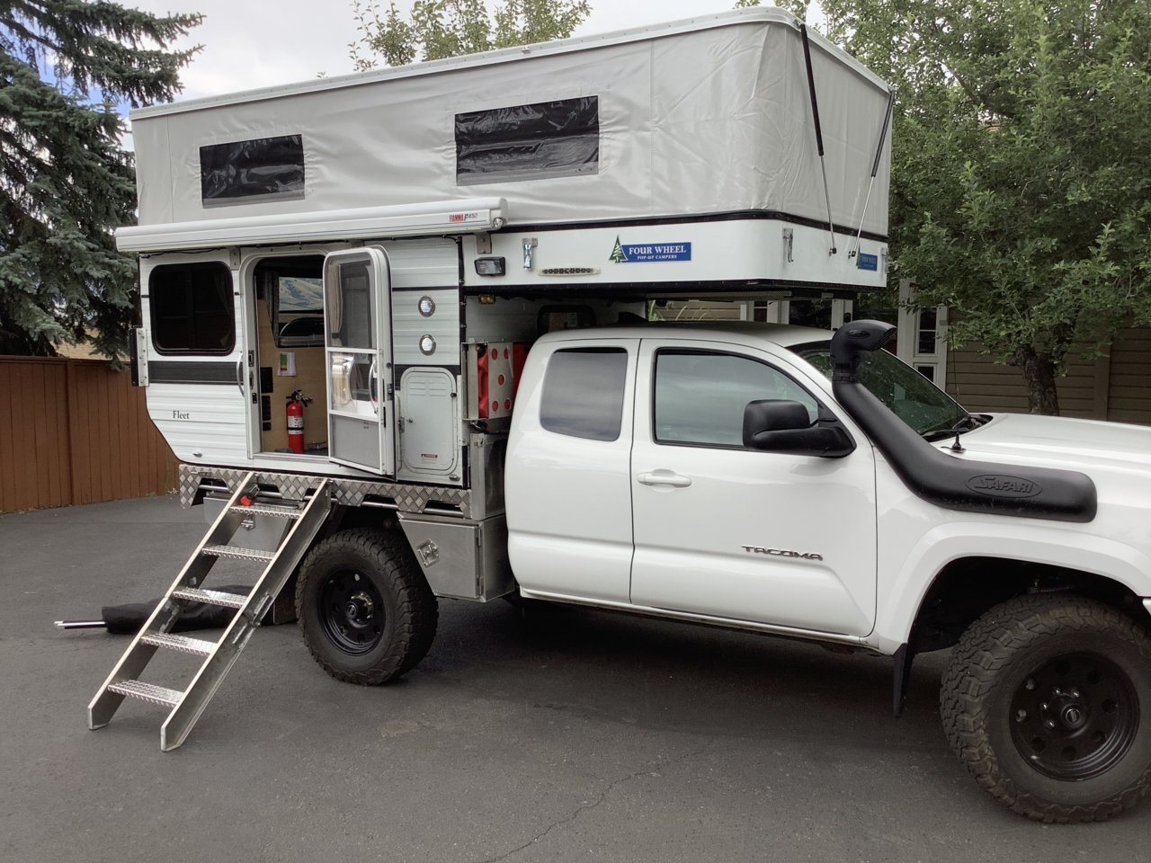

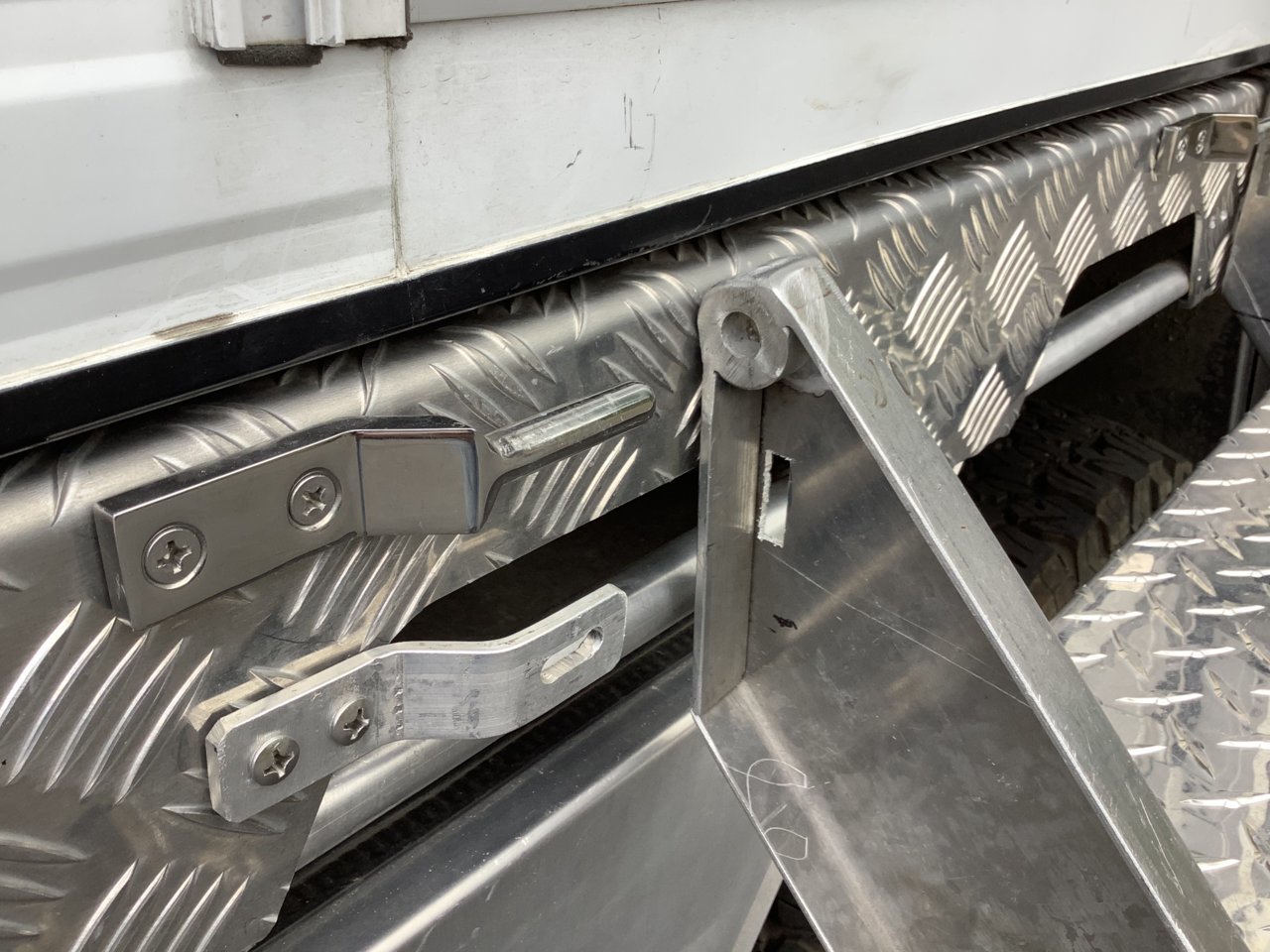

    Put the new stairs on today!
    Made them fold to fit in the camper and can lock them on as well

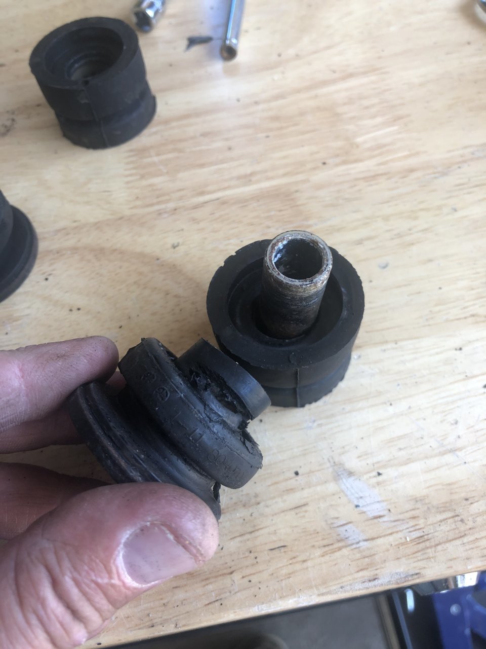

    Not very exciting but I replaced front radiator support bushings. Truck only has 12k miles and they are shit already. When will Toyota stop sending trucks off the line with known problems ??261E7CFA-AA01-429E-9252-95BDB5093BE3.jpg

    Greg...Curious as to what issues you were having that caused you to replace those?
    Is it something that is common? Did you just replace with stock radiator bushings?

    It is a known issue on 2nd gens and it will be a known issue on 3rd gens also because Toyota still uses the same soft crap bushings. I heard a slight clunk in front every so often so I decided to change the bushings. It’s a cheap mod that took less than an hour to do.
    https://www.tacomaworld.com/threads/polyurethane-radiator-support-mounts-cab-also.361346/

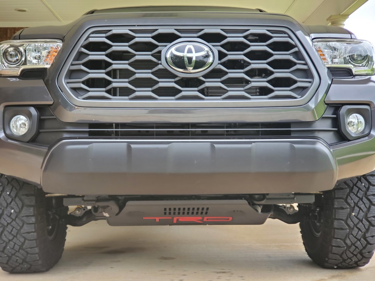

    Finally received my TRD Skid Plate. Delayed by 4 days because of "Civil Unrest". Decided to paint it matte black and keep the red letters. Previous user stated they look great, just have to get low to admire it. Bought it for the access opening for the oil filter changes.

    WOW. I thought Toyota fixed that years ago. Mine went in my 2016 at 5,000 miles so, after a terrible argumentative experience, involving videos to Corporate, they finally did mine under warranty. But they only did the side that was squeaking. Now, 4 years later approaching 25,000 miles, I wonder when the other side will go bad. This is not a new issue. Check out the noise in my video from 4 years ago.
    https://www.youtube.com/watch?v=KVcgYjjbD9I
