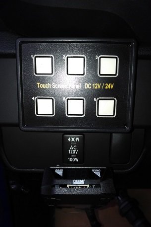

    I built my own and mounted the relays on top of the fuse box in a project box and the fuse panel is beside with plenty of room for running the wiring.

    Wait is that a VGA cable in there?

    VGA cable provides the switching control for the 6x touch panel. The pic is during install. All touch controls are occupied and labelled now.
