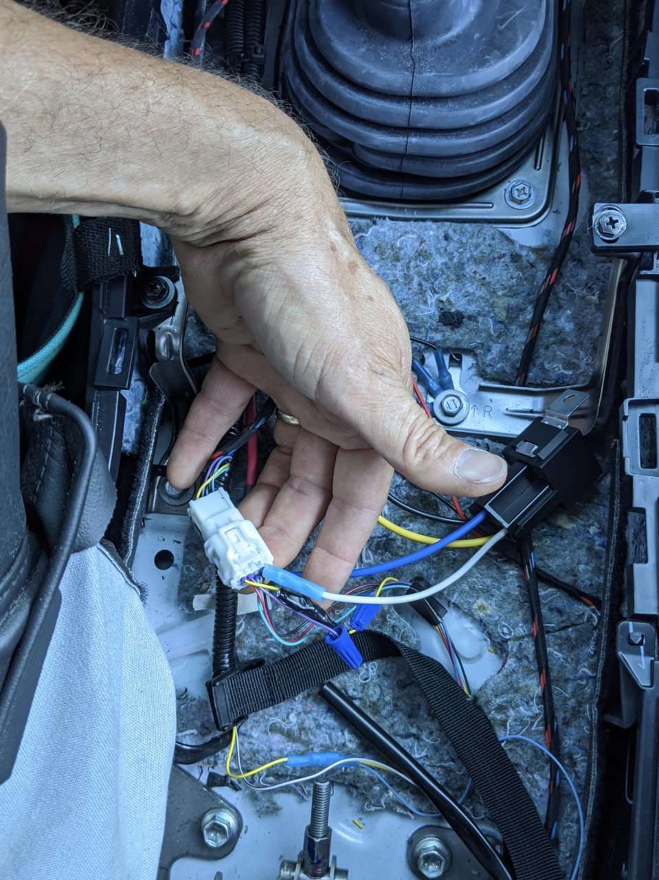

    Oh dang my dad wasn't telling me one of his imagination stories after all lol. Does it actually work?

    It sounds like the power is fed on the "clutch engaged" circuit is a guess. Anyway, I think you should get your money back on the seat heater install. They should be powered directly from the fuse block and each seat heater should have it's own inline fuse. Tapping into an existing circuit for an item that will draw several amps more than the OEM circuit is designed for is a big NO NO and a potential fire hazard.

    They lost money big time on the install. They’re good guys. I think you’re correct in that the relay was switched to the couch start sensor but power is being drawn directly from the fuse block. They said they’d fix it, just bring it in...400 mile drive down the lovely scorching Central Valley of CA

    Perhaps find a local TW member that would offer to fix it. IMO, that is a terrible place for a relay(it is not even fastened down) and connecting it to that clutch circuit just does NOT make any sense. It should have been connected to the Aux circuit directly at the fuse block.

    I agree with you there. No reason it couldn’t have been at a minimum zip tied
